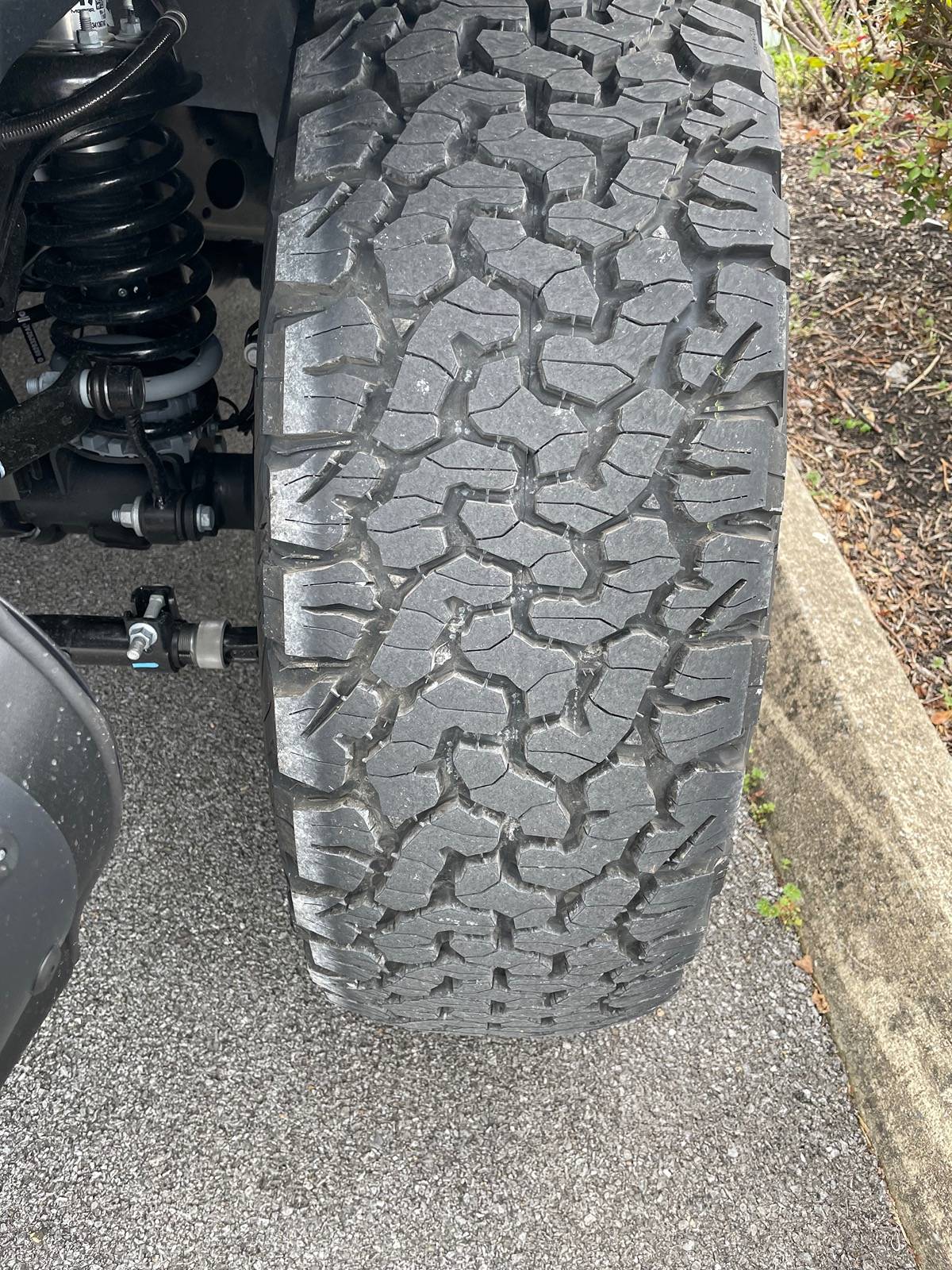

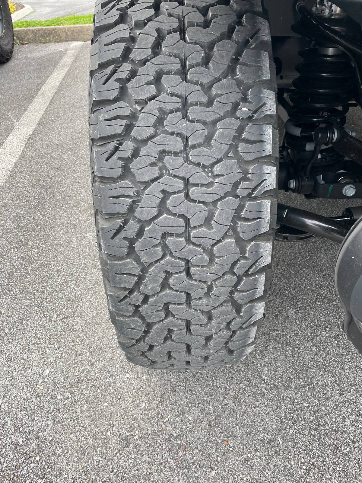

I have 37” BFG KO2s on stock rims. The dealer put 40 psi in them which was obviously too much right away. I’ve went down a lb each time down to 32 psi but still have this small ~ 1/2” patch on the inside of the tires that doesn’t touch the pavement (see pics). At 40 psi, it was both sides of the tire. Im Not sure if I should go even lower than 32 psi to get the whole tread to touch or if it even would eventually? Also a little concerned if it’ll affect mpg and/or tire wear? Not sure if the 7.5 wheel width is the problem and it won’t get fixed by lower psi? TIA for any helpful info.

Lower pressure will definitely cost you MPG. Higher pressure will definitely prevent even treadwear. Both cost you money (more fuel vs premature tire replacement). Up to you to do a little testing to see where the balance is, as every combination of tire and truck will be different. It's not hard to run a few tanks at different pressures and see how big the MPG impact is
In my previous experience with much smaller and cheaper KOs (not KO2s) on a smaller truck, the shit MPG cost more than shorter tire lifespan (since I mainly had to toss the tires with giant rips in the sidewalls). So I ran them at like 60psi on pavement (they were also E-range, waaaay too heavy for that truck). Totally different experience with different tires on that same truck.
What about the pics I posted above. Is it odd that its only on the inside? Does this definitely mean that it just needs lower psi? I am surprised its just on the inside of the tires like this and not sure what to do to correct it?
