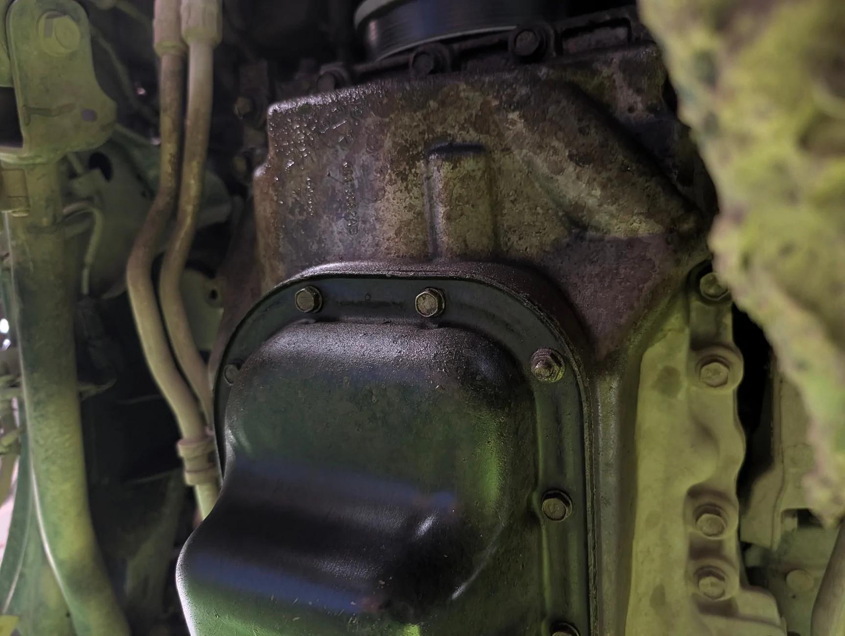

Have you looked underneath? I'm experiencing an oil leak again, and it's coating the underside of the engine without leaving a puddle, just a drop on the cardboard.
Jeep Gladiator Oil leak PXL_20260815_235550473

Most likely it's your RMS if it isn't leaving a stain, check the inspection plugs under the engine. If it's super light I'd just run with it. Mine develops a slight RMS leaked every 2 years like clock work, now that warranty is up it will just live with 2 years from now when it does it again.

$129 seems a little stiff for a bottle of dye and a lower engine spray down! If it’s been years and no drops on the floor as the previous poster said…..I’d just go with it! Not enough loss to worry about. I’m sure life has presented challenges to prioritize and this isn’t one of them. If you have some kind of extended warranty that needs dealership documentation then the $129 bottle of dye( I guess) would be necessary.
