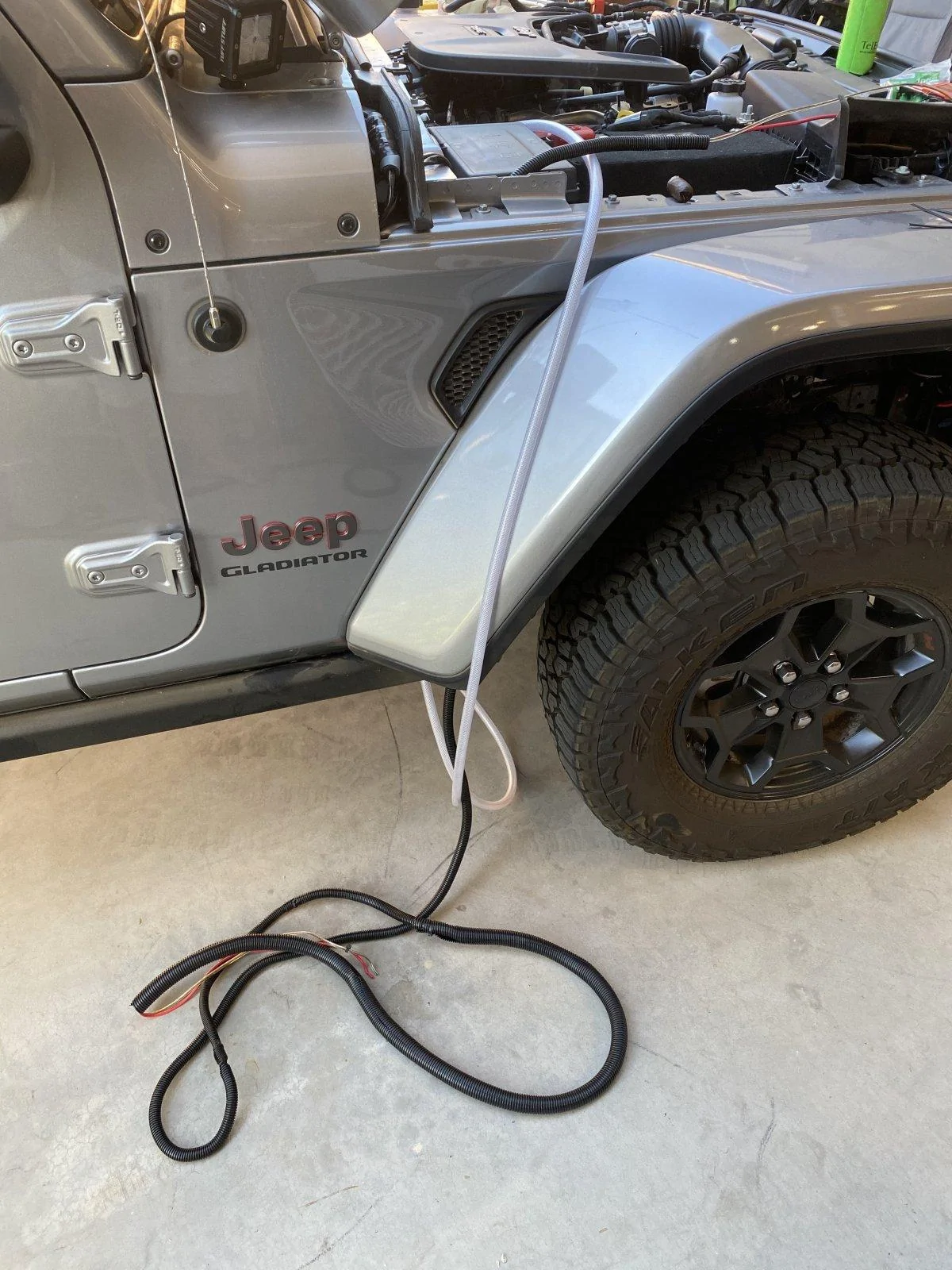

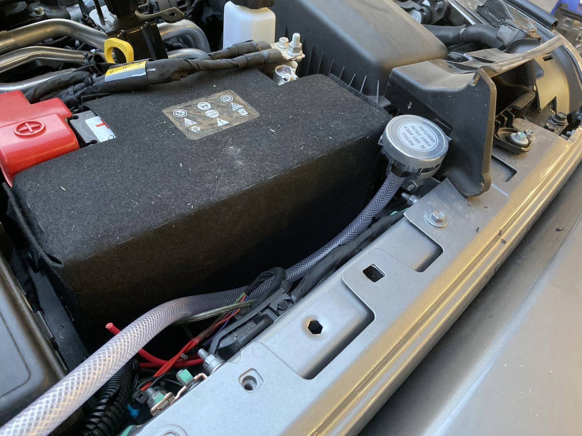

The trick to the dual selection is using two different pressure switches, and then a latching relay on the built-in aux connection. I'm still working on putting together a build list and URLs, I bought stuff here and there plus I had some parts around from previous projects. The latching relay basically switches mode every time it turns on. So the aux switch works like this: Press and get full pressure, press off, press and get tire pressure, press off, press and full pressure....etc.

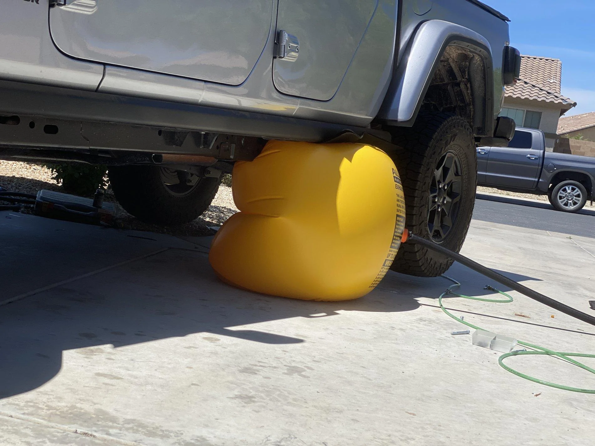

This also works well to fill up my air jack (big inflatable jack, review to come on that soon too). I set it to tire pressure and it fills to a safe volume. Then set to full pressure and it continues filling, but it must be watched at this point since it would be over-inflated if not stopped manually.

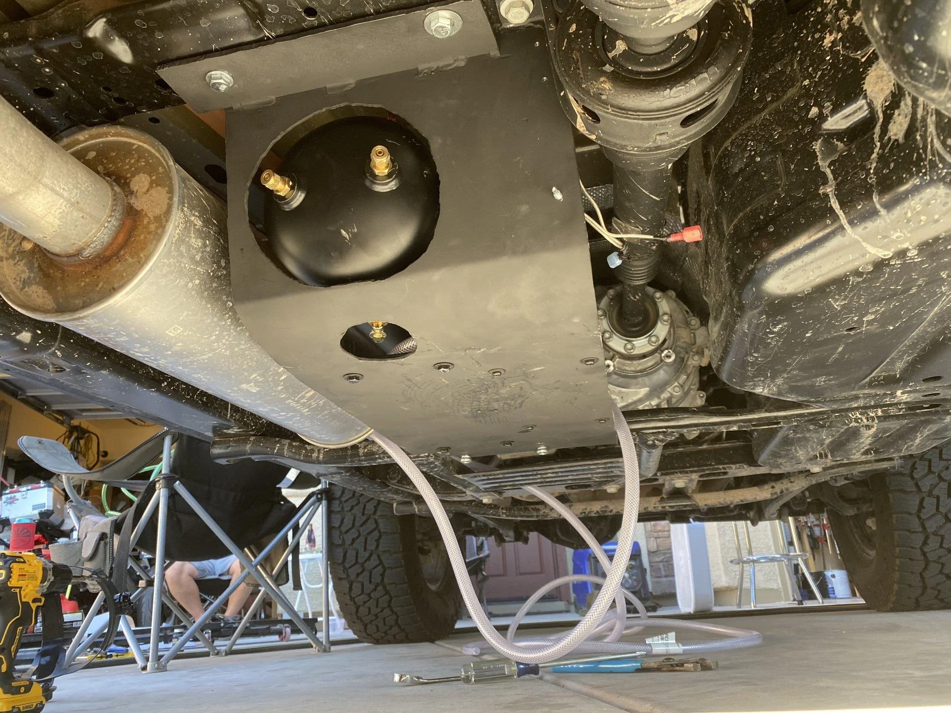

I built the plate from scrap steel I had laying around, using a plasma cutter, welder, and grinder. Standard metal tools. Measured out to fit between the crossmember behind the transfer case and another member about two feet behind that. I used the stock 8mm holes in the forward crossmember, and had to add my own hardware (5/16") for the rear one.

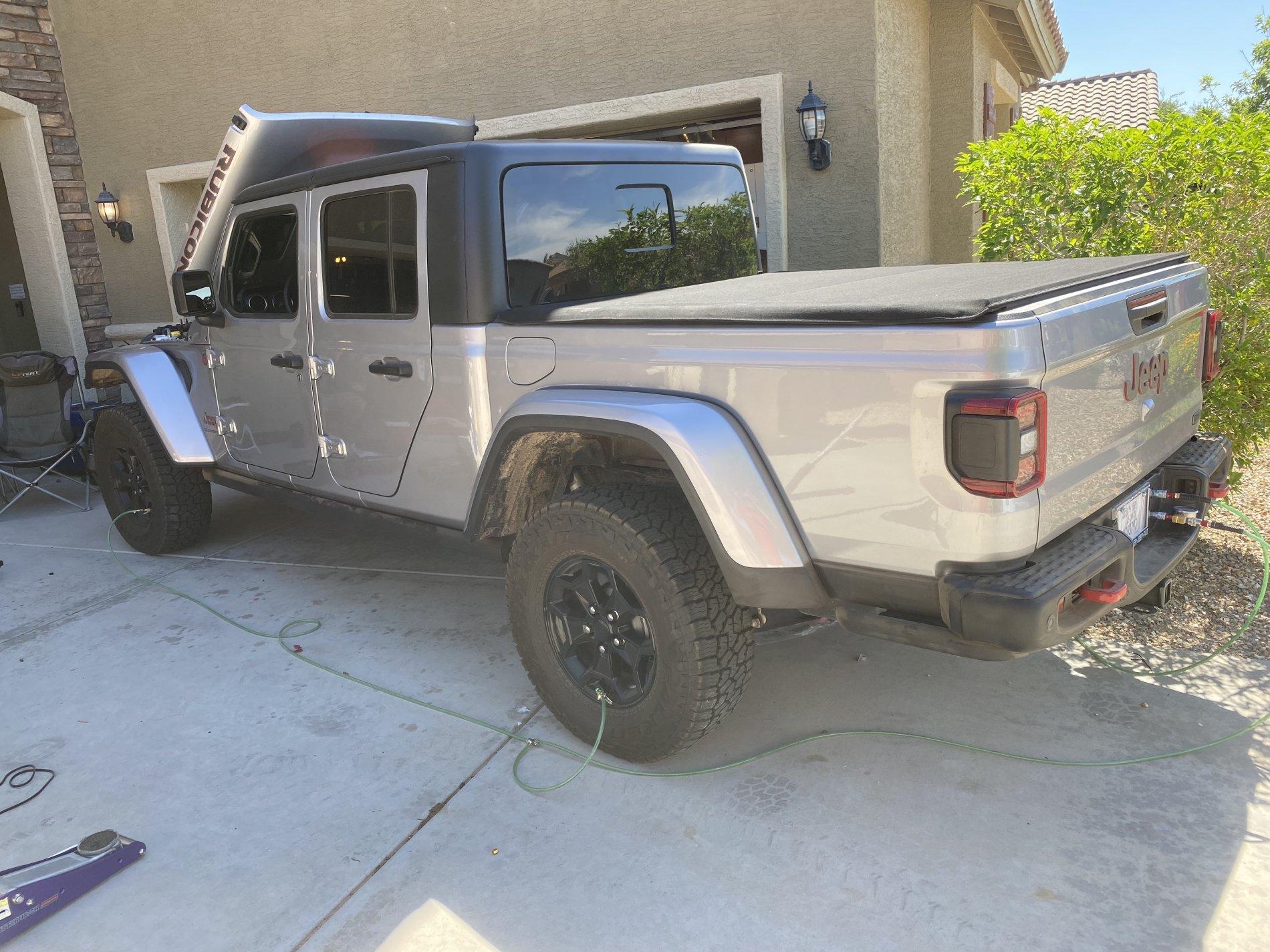

hey man i was gonna ask since i get paid on tuesday and my question was,how long does it take for the compressor to fill up the the tank and at what psi does the tank fill up too,also another thing once the tank is filled how long does it takeThe only "trick" to inflating all the tires at the same time is building out a couple of hoses that connect to two tires each, and to the air chuck. Or if you do a single air chuck, you build one four-way hose. I bought two 25' small air hoses and cut them, adding a T connector at each tire, and a clip-on air chuck. That's it. See the photo below.

Alrighty man thanks :DThis particular system is their high pressure option, 200 PSI. This is slower than their low-pressure options, but gives you more air from the tank. I've never really paid attention to time. Probably five minutes to fill the tank from 0-200, just guessing. Also never really pay attention to fill time, the point is to plug it in and forget about it while I do something else. So I'd say more than five minutes and less than ten I think. It's the Viair 200 Ultra duty system.
