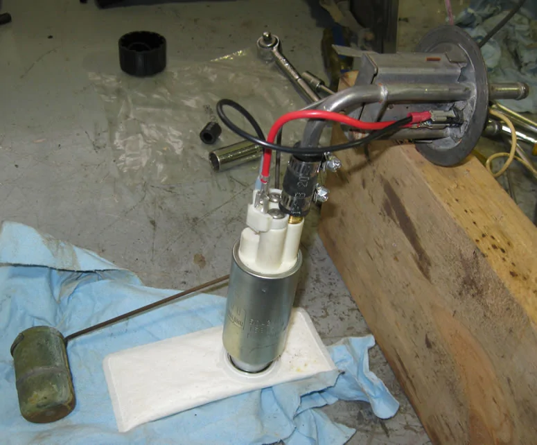

Totally strange as even the old 4.0 the pump runs for roughly 1 second and has pressure built up.
It doesn't really matter if pressure leaks down - sounds like you've got fuel totally leaking back.
Most will drop to no pressure with time. With those where you can hear the pump, you have to listen VERY carefully during the start process because the pump runs such a short time, you'll miss it. What I'm saying with all of that is - it takes but 1 second to build pressure. And I'm talking a vehicle where the pump is the entire length of the car behind the fuel rail.
If it acts like being described here by folks - there's some problems going on...........
This tiny pump here, sitting in the tank at the very back end of the car runs such a short time and has pressure in the rail within a second or so. And that's after swapping injectors.
