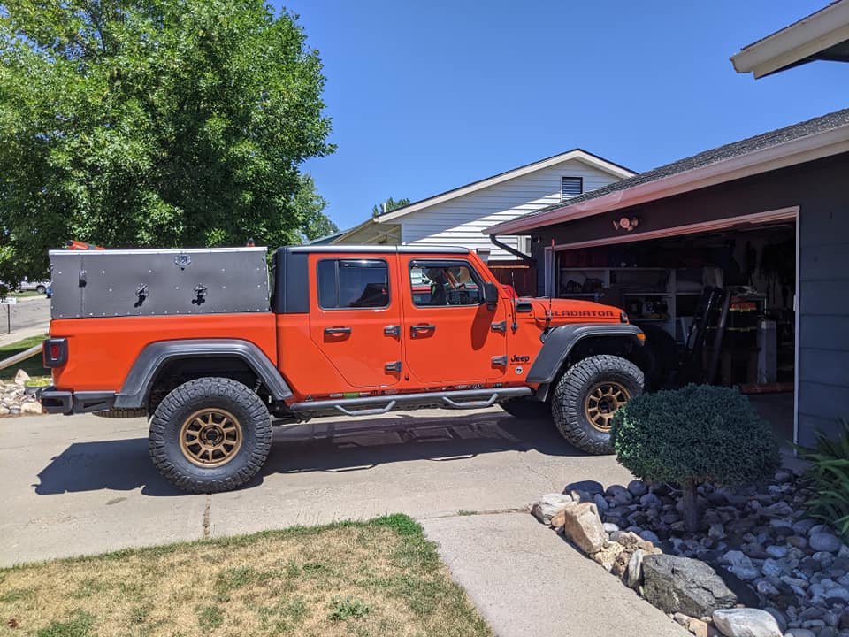

It even fits in the garage after the lift... this is what I had planned on when I designed the build of this topper- that the height comes in after my lift- of under 84 inches (my garage door height!) . It is 82.5 tall... so 1.5 inches to spare!
Looks fantastic. Very utilitarian.

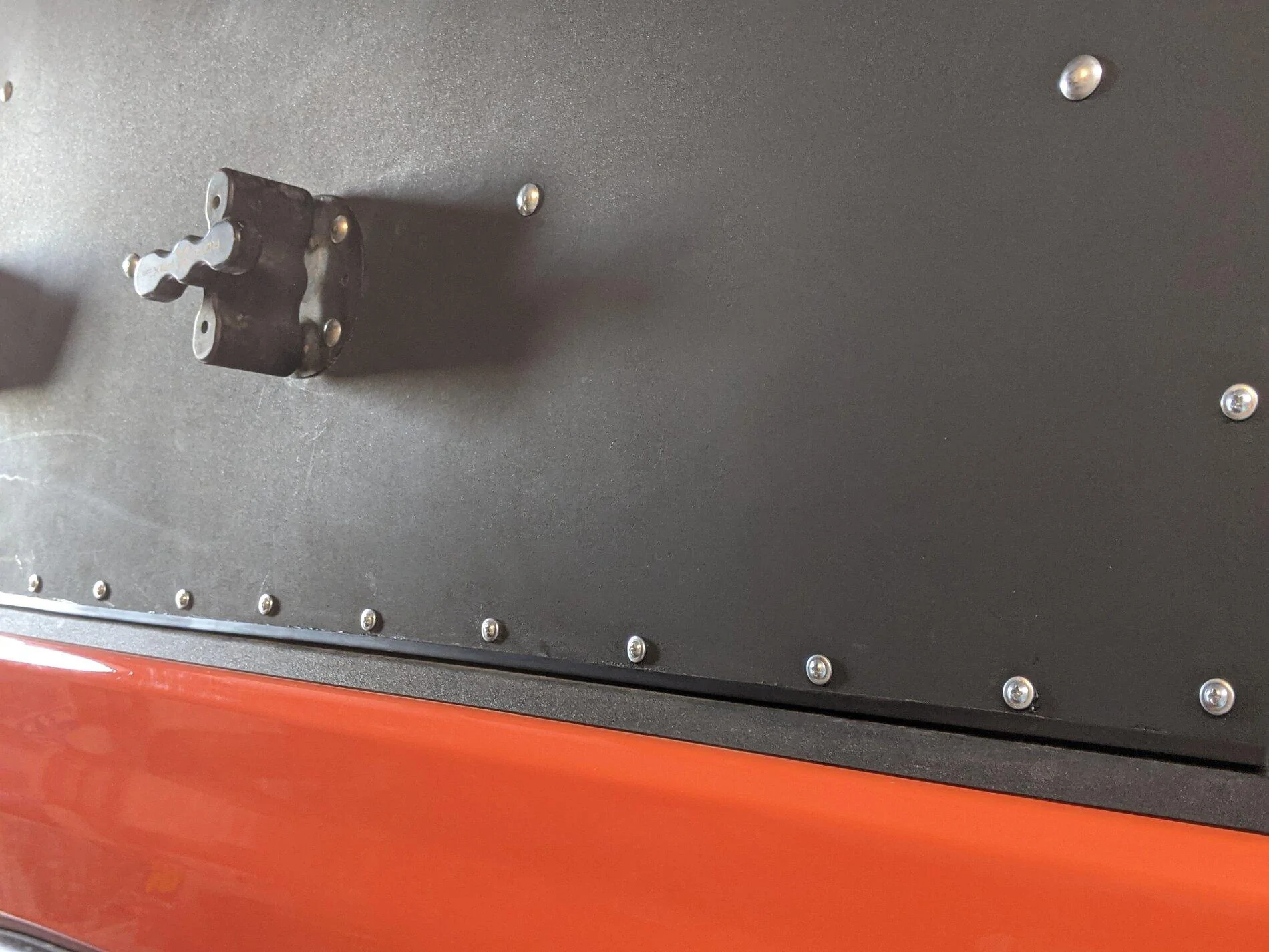

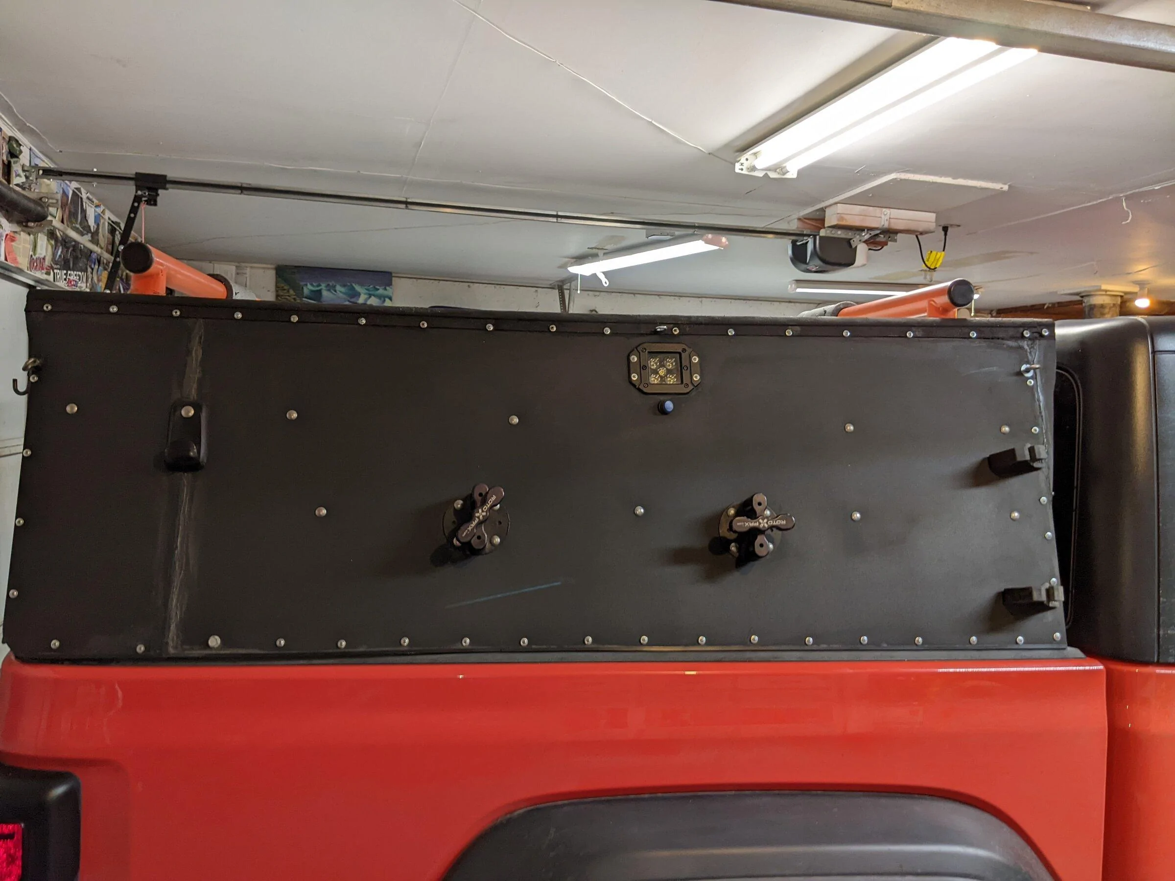

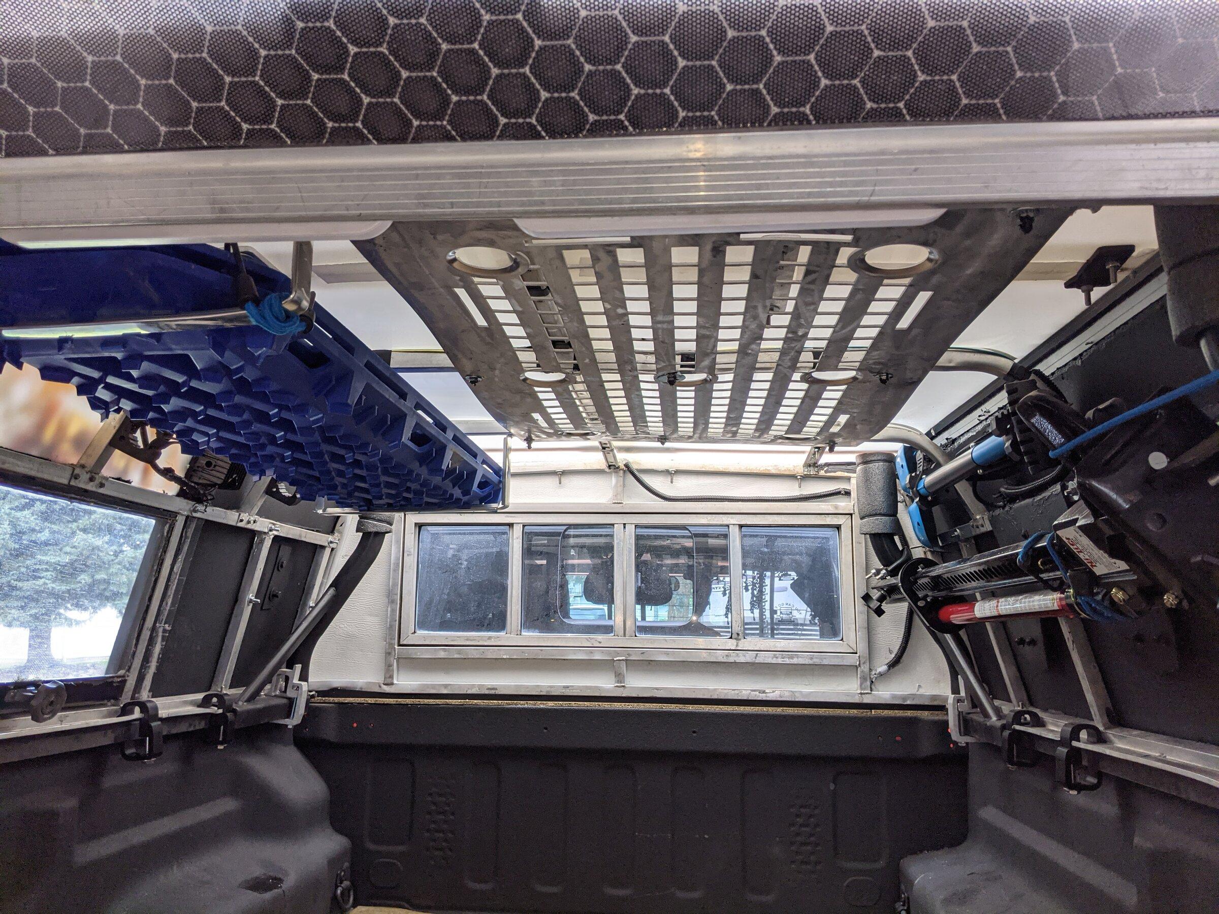

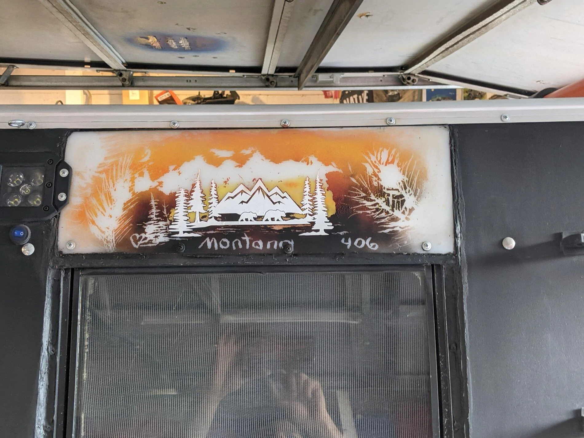

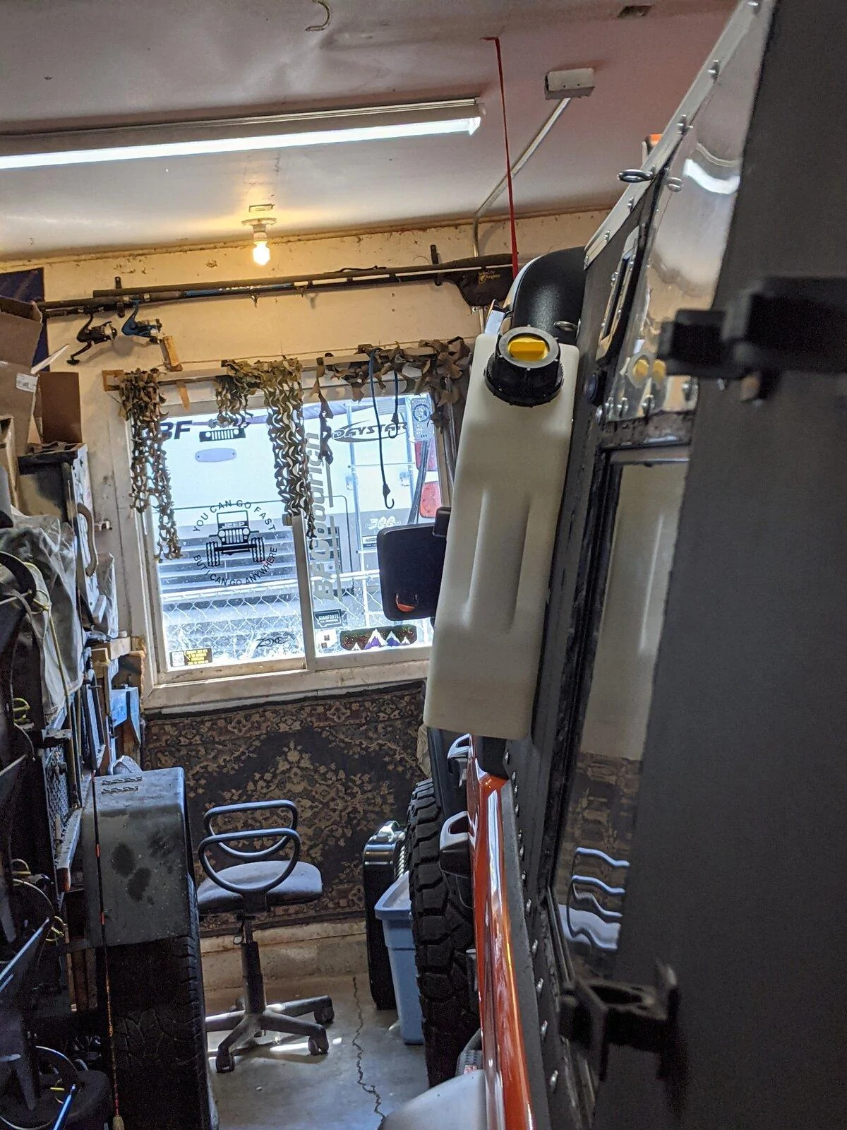

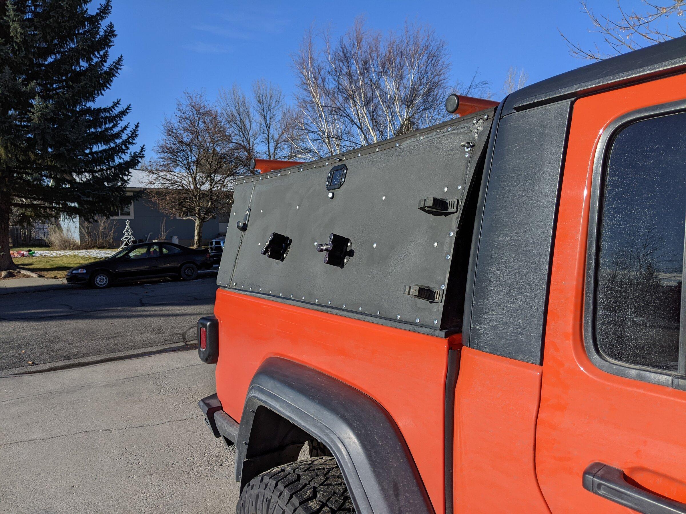

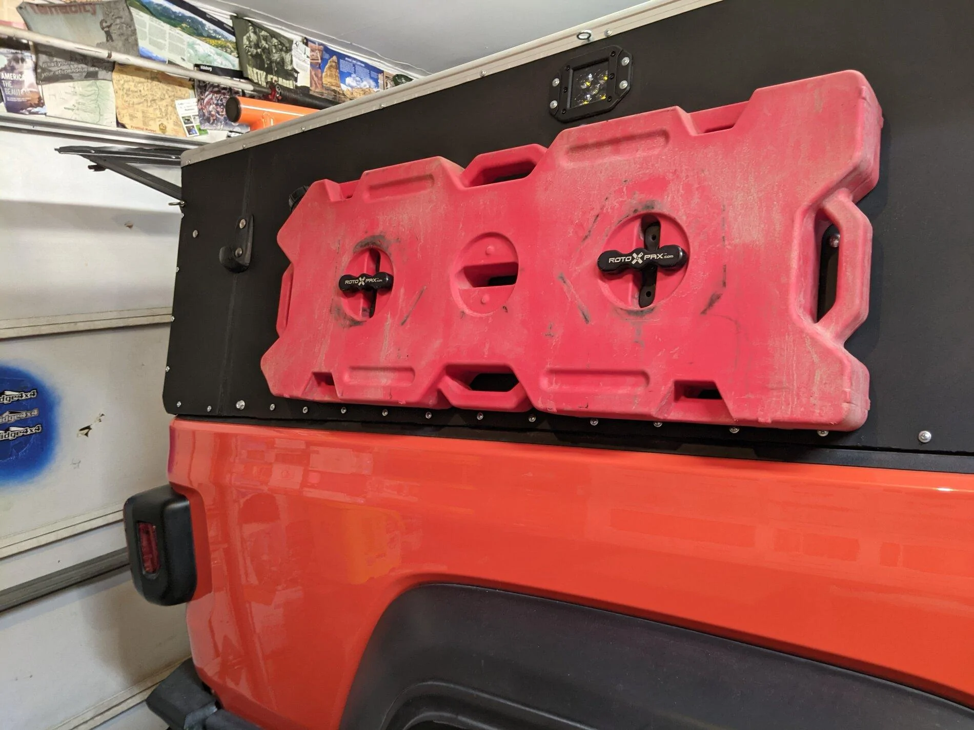

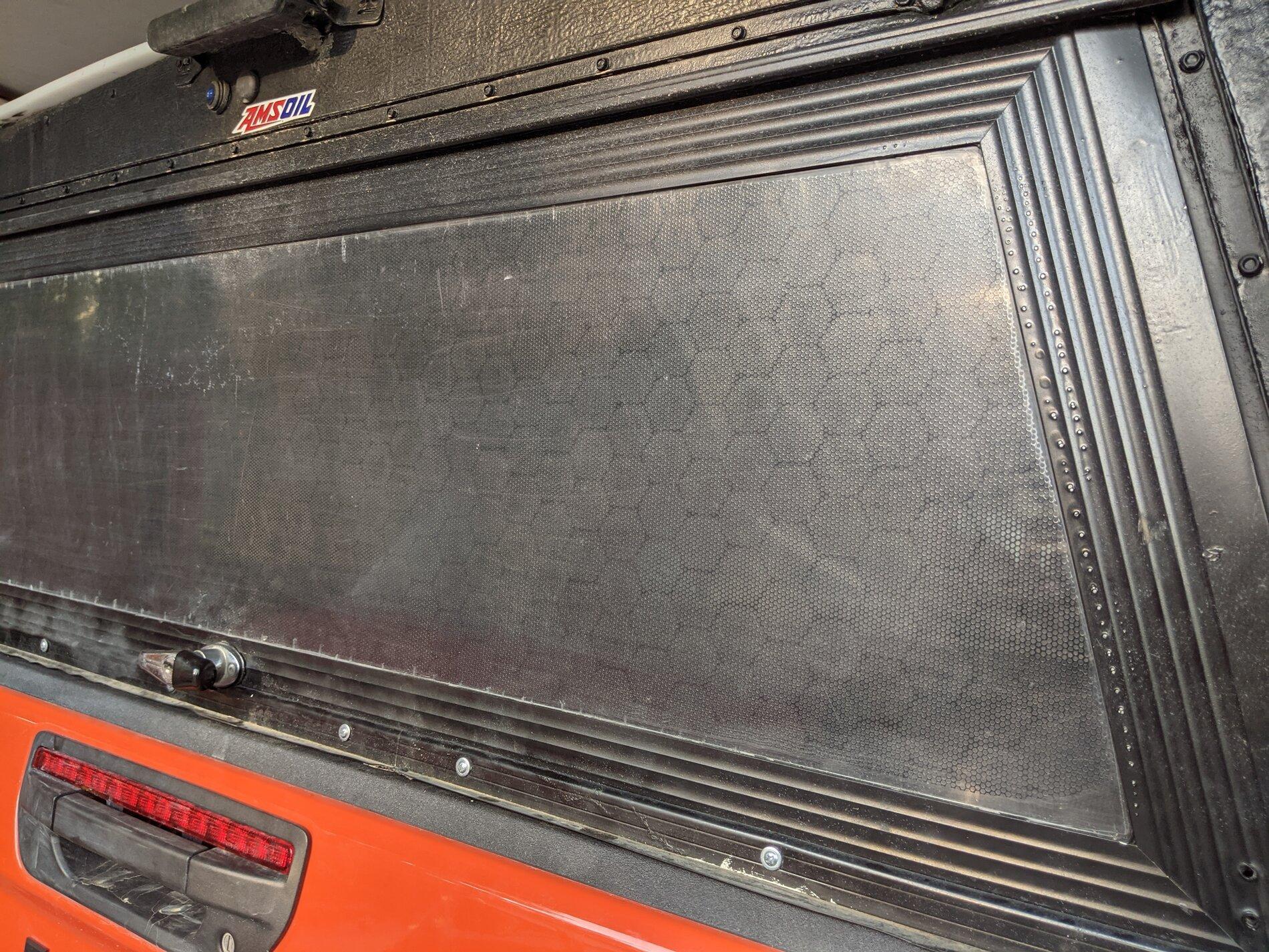

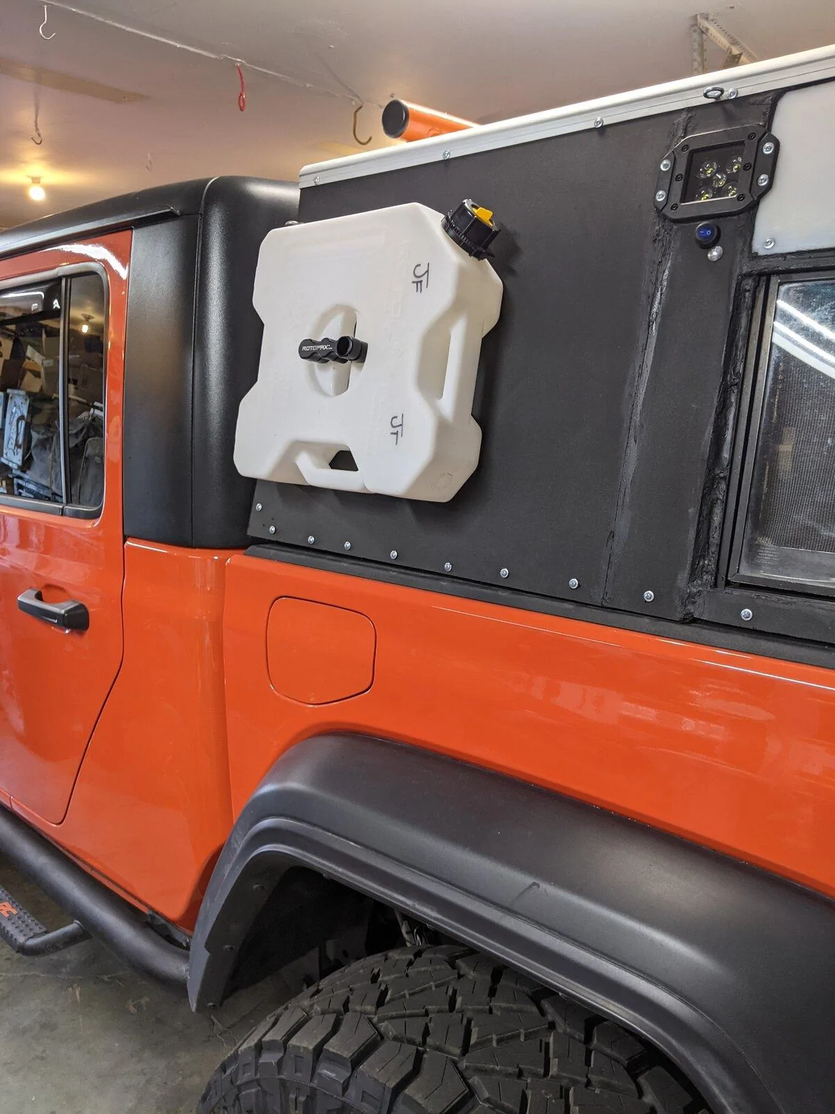

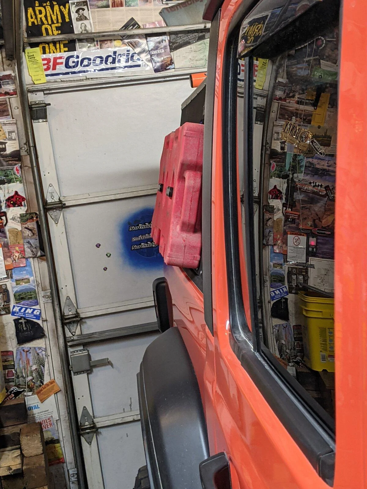

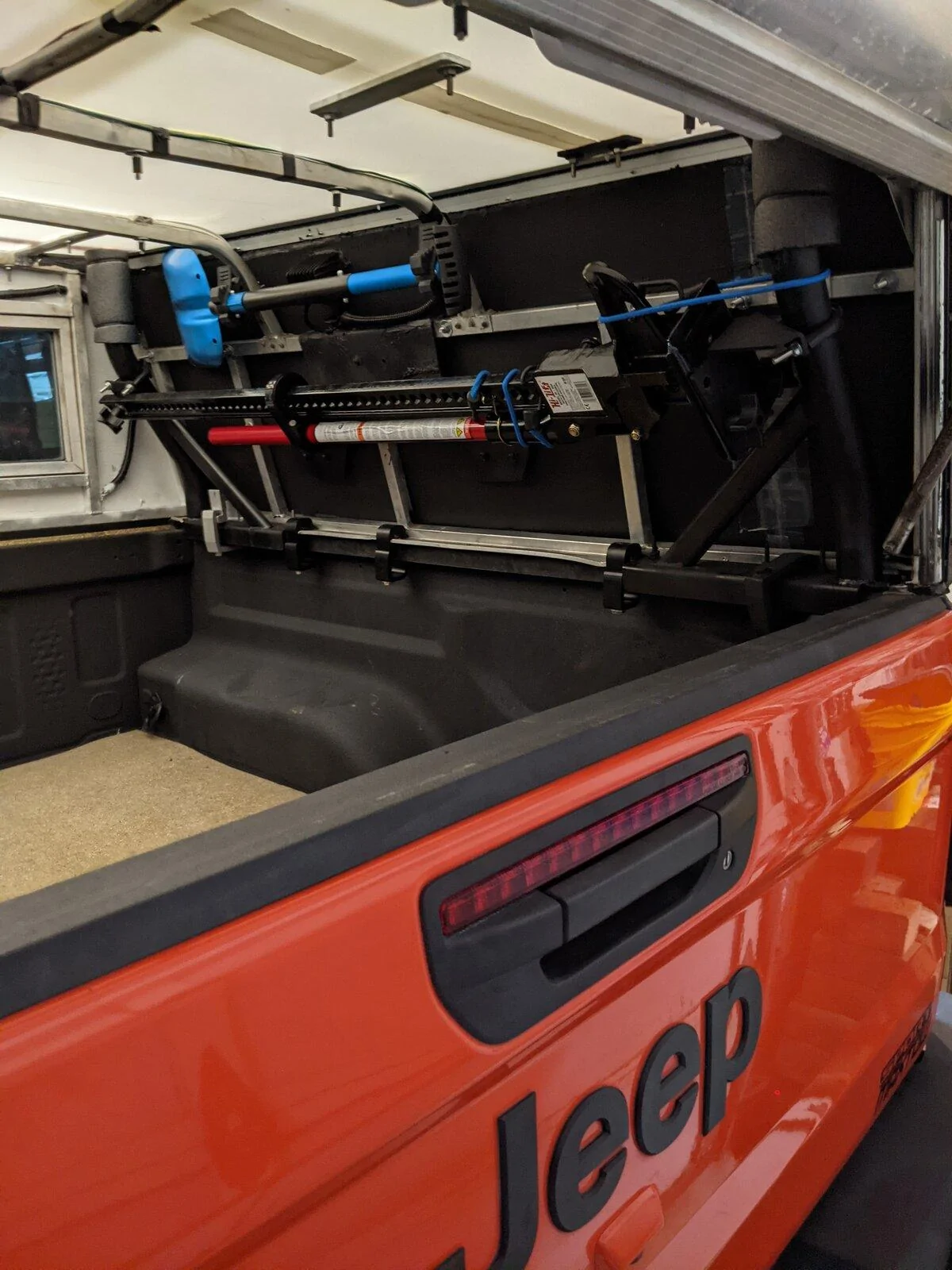

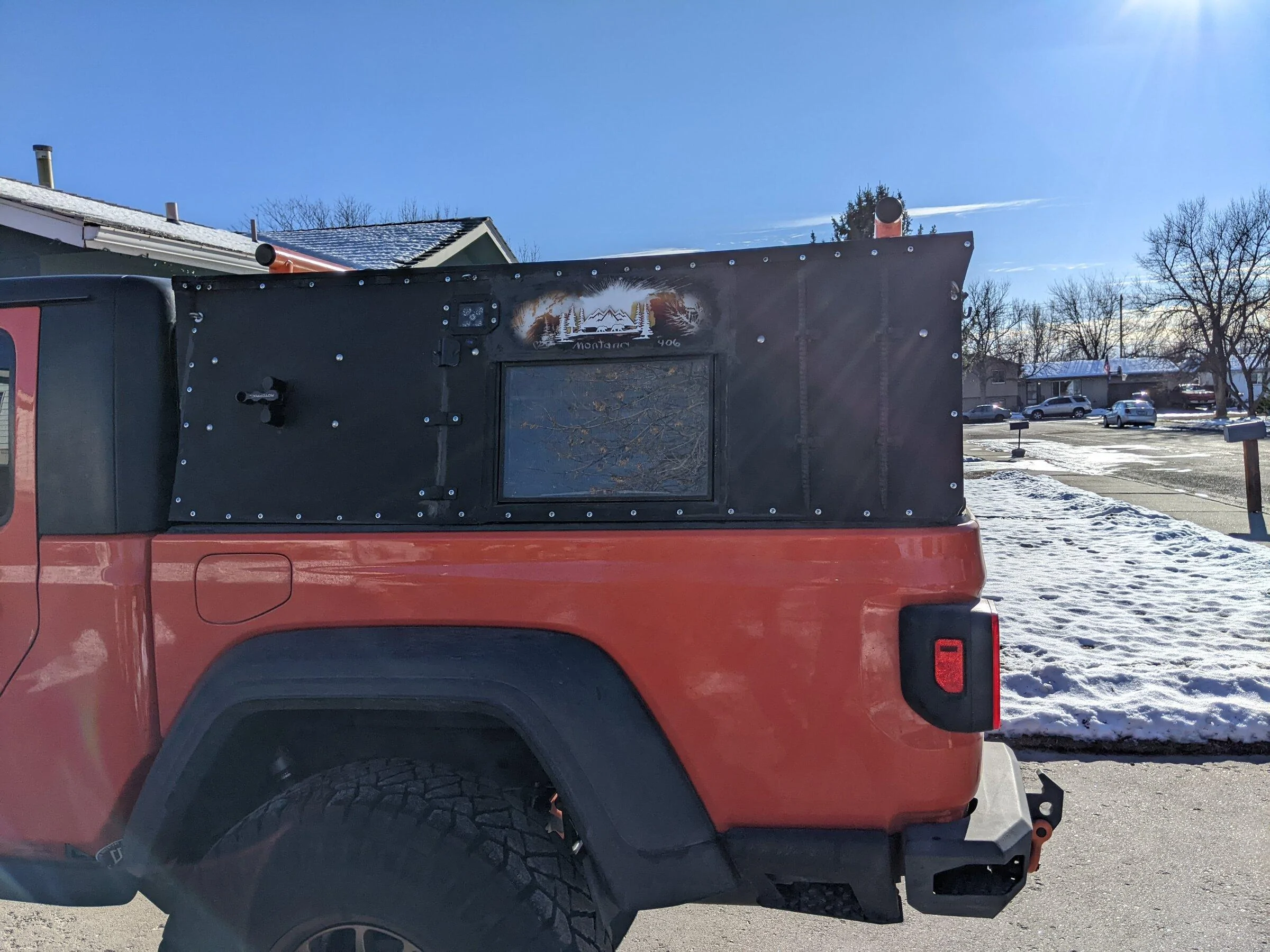

More pics of the final touches... Hi-lift Jack mounted, water roto-pax, gas roto-pax, side pics on how they are tucked in to the body lines ,honeycomb rear window treatment, Montana mural on white piece, last bit of finish trim on bottom edges. I took it on a shakedown run... about 70 miles on gravel with tons of dust, tires fully inflated to be sure anything that would rattle would be found. It did good, dust was very very little.... but the hi-lift insolator worked its way up the handle and came loose allowing the handle to rattle... duck tape stopped that problem! LOL! I'm happy with it! 500 bucks... functional, weather proof, quiet, and removable. 800 weight limit on roof, fits in garage... has a window. Molle panel is still not finished... but it will be easy to mount when its ready!

Jeep Gladiator Operation  "Cheap topper": Warning... this is in process... PXL_20211211_234947069
Changed up the edges a bit... and painted the top rail black...added some screws for the rivited look. Molle panel inside now. This works great!
Great Job. I'm impressed and motivated now. Any idea what truck it was originally designed for? What are the dimensions of the original? I'm looking for an old topper frame as we speak.
I think it was a century topper... for a ford courier... or chevy luv. C-21 number was on it... but I have not been able to find much online... it had 4 large plastic black bubble windows (all broke) and two glass windows that were tip out design (one broken beyond repair)... I had to cut quite a bit off of it... my top bars had to be re-bent a little and the door had to be moved up. It is very solid and quiet now... had it on there a few months!
