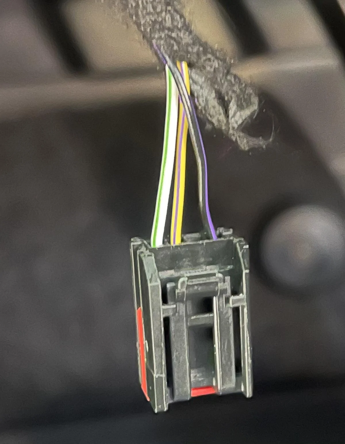

For others, if you go with Oracle’s footwell LEDs, JP walked me through it by PM. Yellow - 12v
Black - Ground. I used posi-taps on mine.
Driver side Yellow/Purple 12v—to oracle red, Black/Purple stripe Ground—to Oracle black.

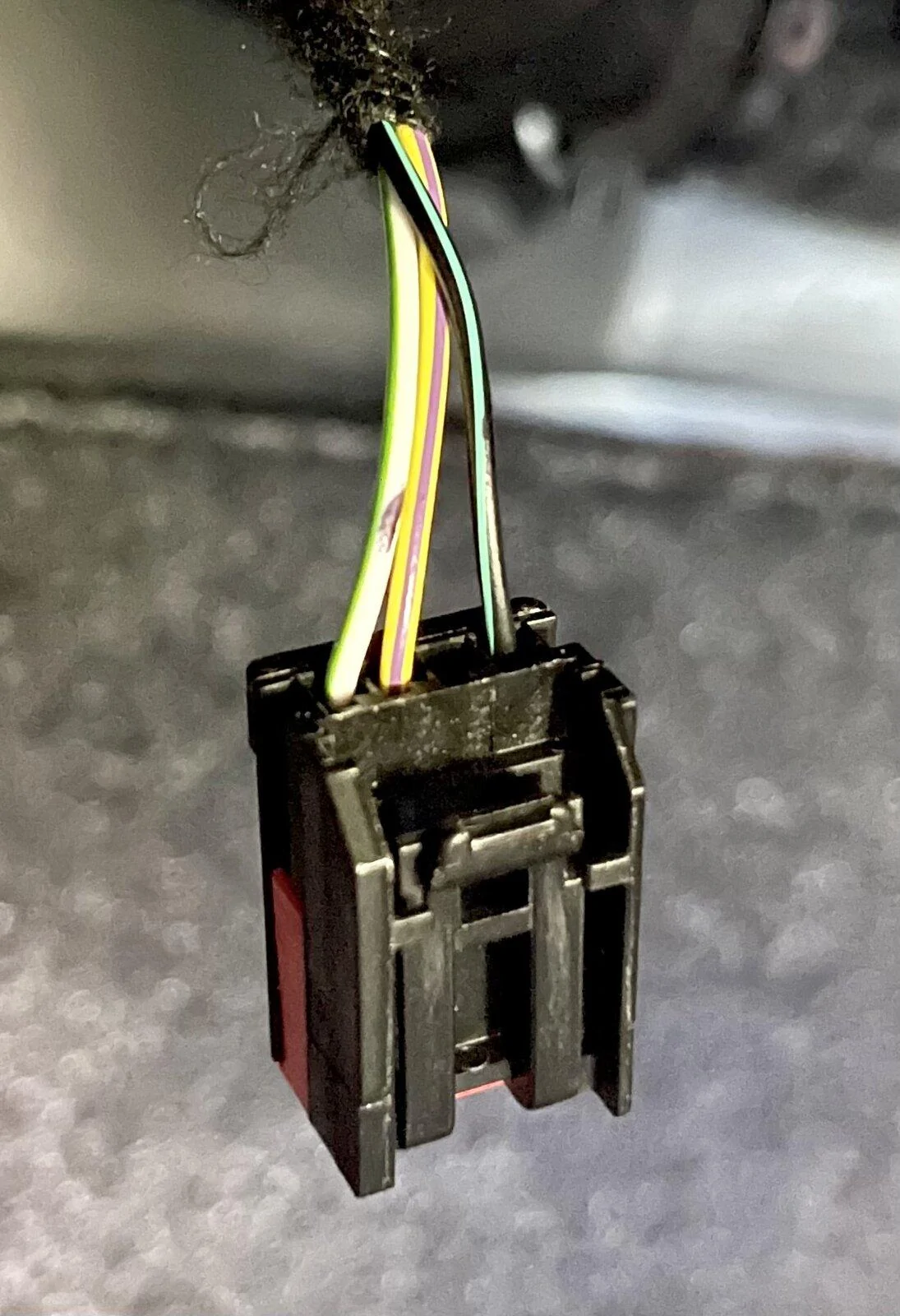

Passenger side Yellow/Purple 12v—to oracle red, Black/Green stripe Ground—to Oracle black.
