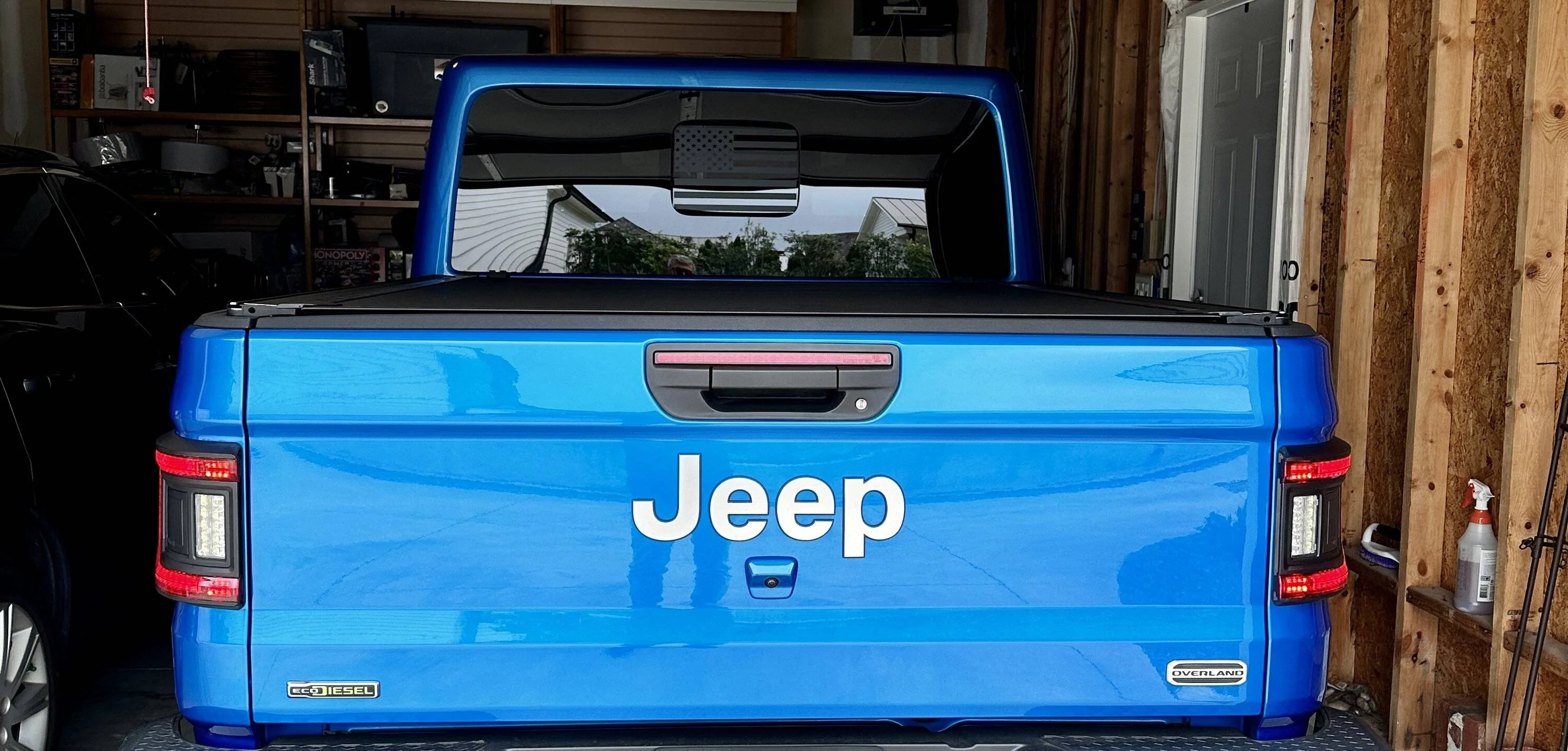

Received my lights from Oracle a couple days ago and finally got them installed.
work fine with the BS sensors. Only issue is a small gap between light and bed. I wish they provided a rubber gasket around the light.

Hi, this may be due to overtightening. I have a trouble shooting guide here is you want to go through it.
  • First, position the tail-light where it is flush with the body panel on all sides.
  • Second, while holding the tail-light in position, fasten each bolt, careful not to overtighten (This can warp the tail light and cause it to be uneven around all edges).
  • After doing this, if there are still uneven gaps, slightly loosen top bolt then push the top of the light in & fasten. Repeat on bottom. Please see the video below explaining proper fitment install -
I did what is shown in this video and the lights fit more flush.
(I used some wire/side cutters though )
Thank you for sharing! Wire cutters are definitely the way to go for that, guy had me holding my breath with that sharp knife.?
Please feel free to reach back out with any more install questions.
Still do not fit right and did what was stated.
