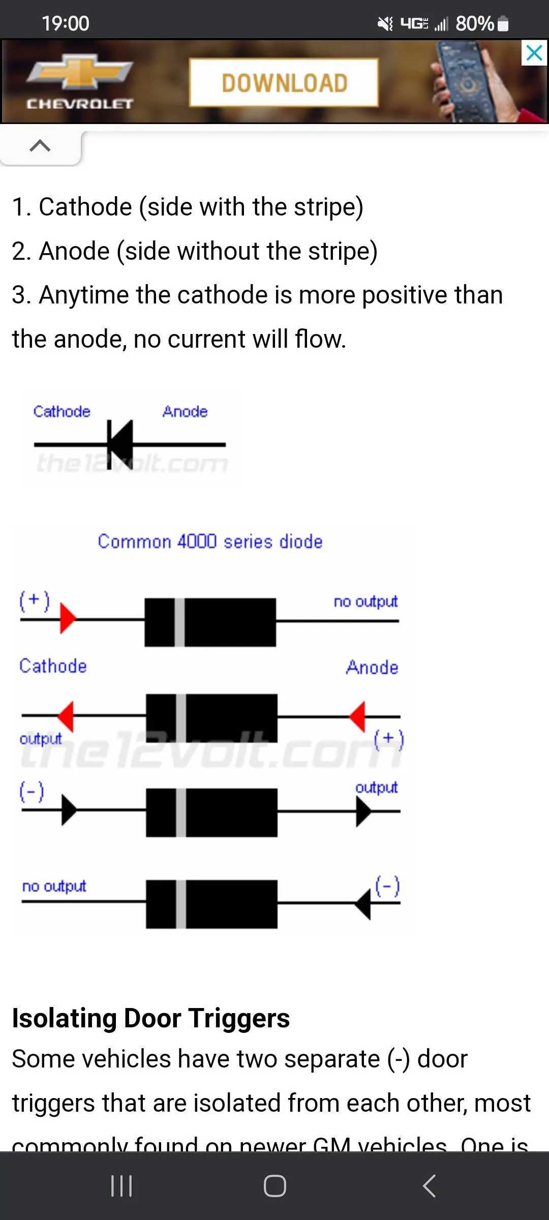

I am not new to wiring things up but have never done anything with diodes. Any way you could share a link to what you are talking about?

something like this?
Hopkins 48955 Towed Vehicle Diodes Kit https://a.co/d/1cPUssR
Just saw your post. I’ll go read up on that. Wondering if this link would do the same thing so I could use connectors instead of soldering the little diodes in. Thank you for the help!

Yes, those look like they should work. As long as they are set up for 12v + input, they should do the trick.

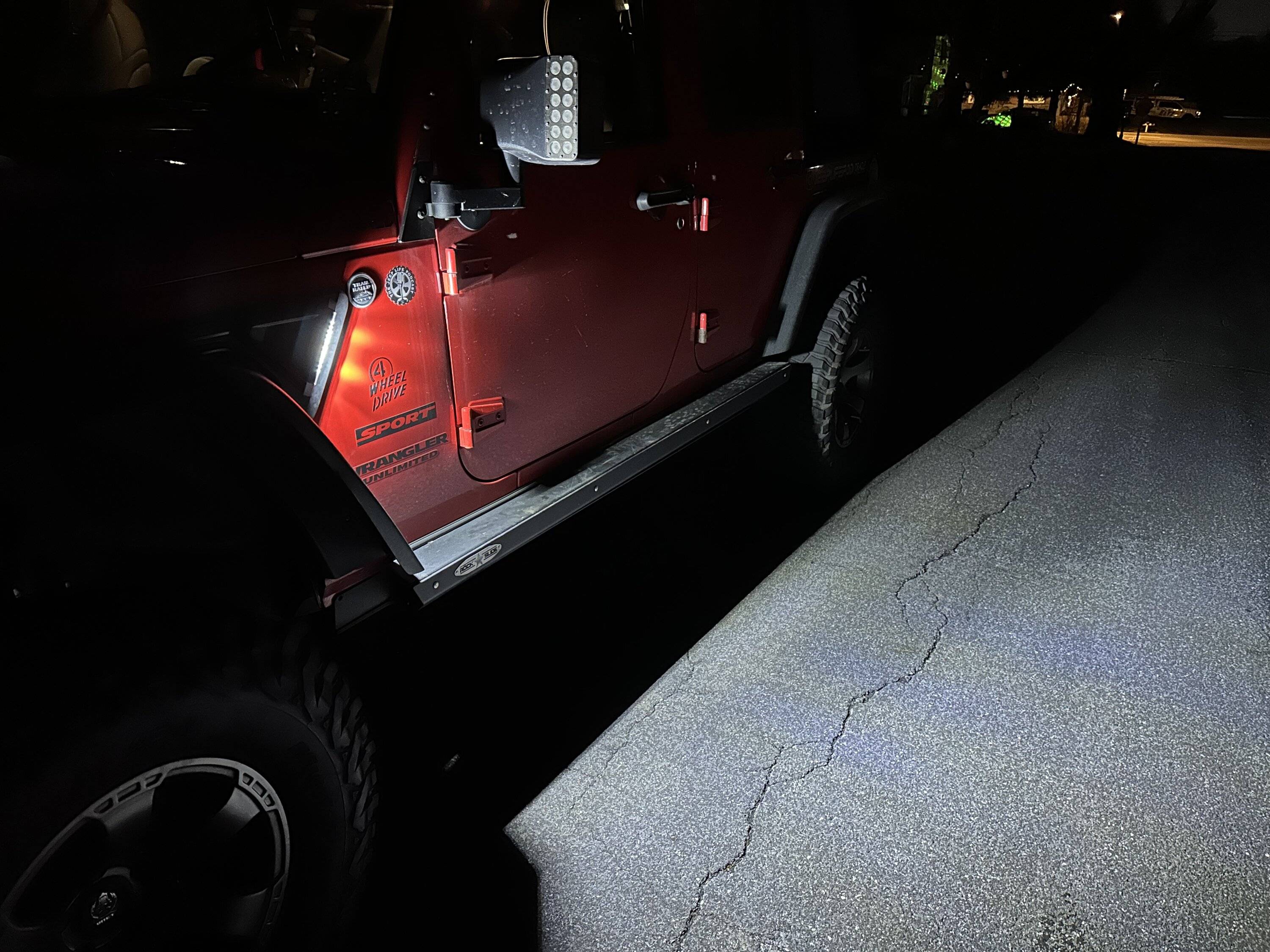

The wiring for the side track is three smaller wires; one to ground, one to the interior light; one for turn signal. Like stated before you can add your own materials to make each light dual function. As for bright enough, these are very bright...but the picture demonstrates how the light is thrown. It is quite a bit. I would recommend the Oracle Flush Mount Taillights or the Reverse Lights as the reverse on each of these is extremely bright. https://www.oraclelights.com/products/flush-taillight-jt
