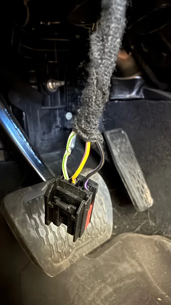

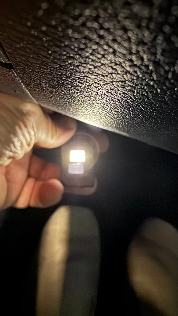

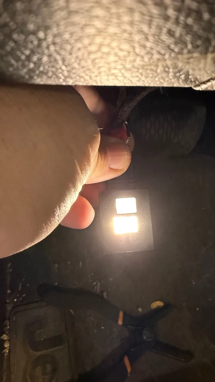

Ok I finally got back to this issue. I do have three wires and this is because there are two lights in the footwell. One that is turned on with unlock and one that also comes on with unlock, it also comes on with running lights and stays on. Neither are controlled by the ignition. Pictures below.
This is a 2025 Gladiator Rubicon X
Yellow with Purple line - right light temporary with unlock or door open
White with Green line - Dim light same but also stays on with running lights
Black with Purple line - Ground
To get the Oracle puddle lights to work correctly connect to Yellow/Purple.
I was on White/Green.
