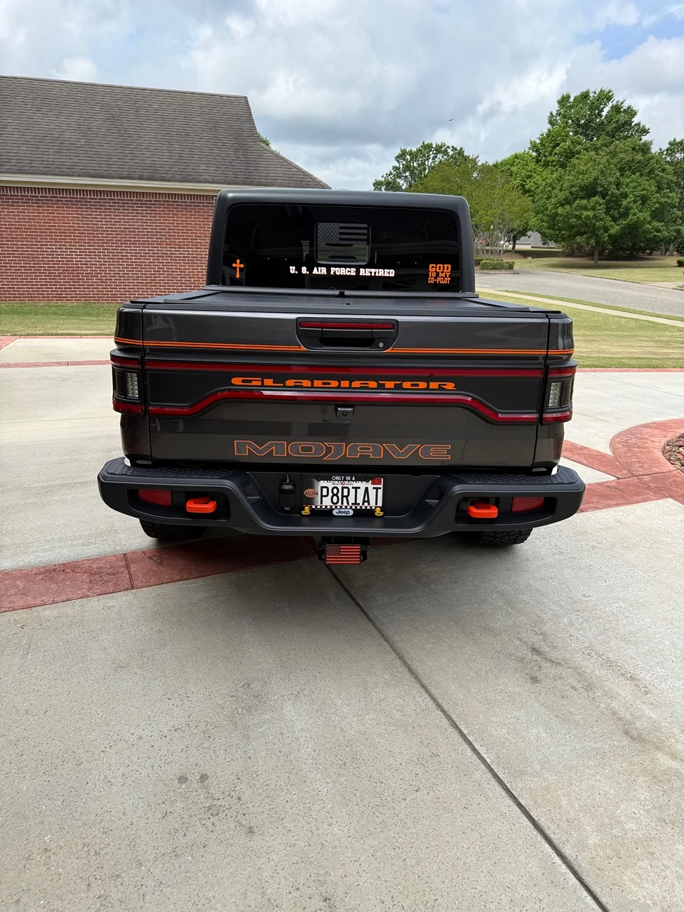

Hey guys, I could write a book on my experiences with Oracle and the garbage they produce.. It's a shame because it seems as though their lights do work great but they screw up on the production side constantly. I ordered three different lighting kits and had issues or regrets with each one.
First, was the Pre-runner lights that snap into the grill. I loved the concept and ordered the clear lens lights. Three days late received a post stating the clear was no longer produced and I would have to take the tinted lens. I took the tinted lens against my choice and qs a result, they are very hard to see in the sunlight. Strike one!!!!
Secondly, I ordered the flush mounted tail lights but as the OP noted, the grommets had to be modified, and for the fastener problem, I just swapped the fasteners from the factory lights and they worked like a champ. Strike two!!!
Third, I ordered the Race track light that runs across the tail gate and works in concert with the taillights. A great concept and looks great once installed. However, several problems developed with it. First, the backing on the double stick tape was cut at the factory in two places, leaving a 15 inch piece in the middle that did not come off when pulling the tape during install. This was the case both top and bottom. This meant a total of 30 inches of tape not stuck to the tail gate. In addition, I had to cut a two inch notch out of the bottom of the light assembly to clear the rear camera housing, in order for it to fit flush on the tailgate and align with the tail lights. I fixed the screwed up tape problem by removing it and replacing the entire tape with my own 3M tape and then added two metal screws into the tail gate on each end to make sure it stayed. The install now looks very good, but should never had to go through all that to achieve satisfaction. Over the years I have heavily modded numerous Jeeps, trucks and Hummers and never had all those problems. However this was my first experience with Oracle. BTW, their customer service was embarrassing, the lack of assistance made them look like embezzles! A pure waste of time!
MY APOLOGIES for the long post, but believe me, this was the Reader's Digest version. Happy Trails...
