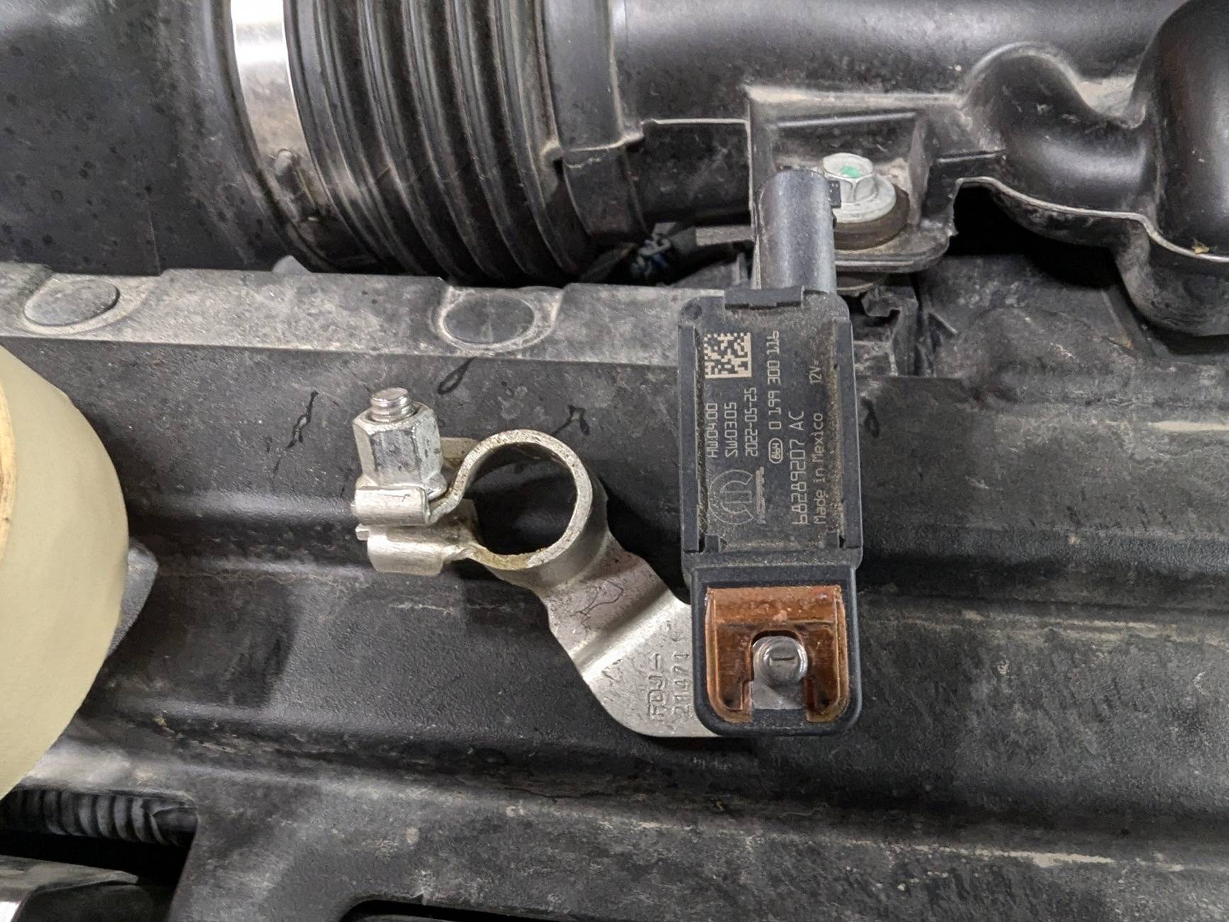

Were the batteries damaged? Perhaps, but a lot will depend on how long that went on. Maybe not if they didn't get too hot. The IBS is supposed to watch the temperature and the system will cut voltage to prevent over-heating the battery.

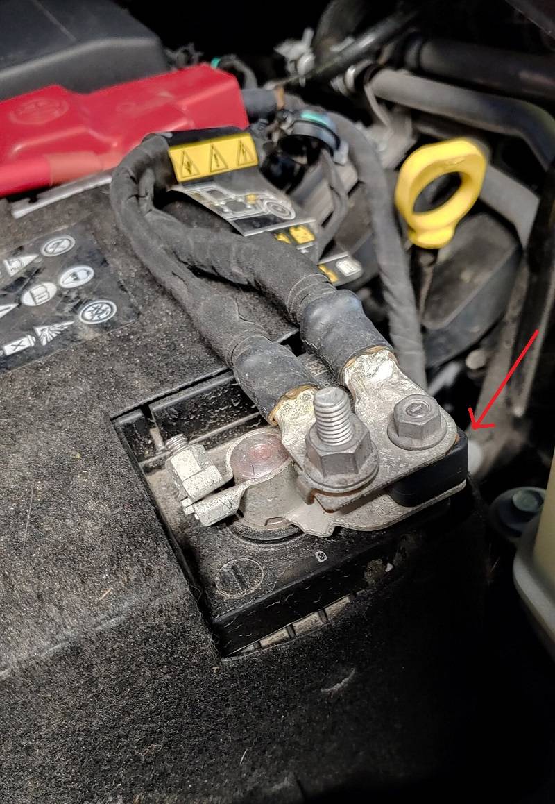

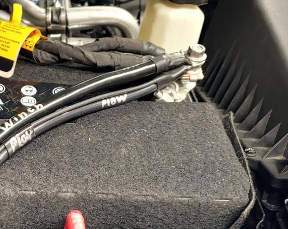

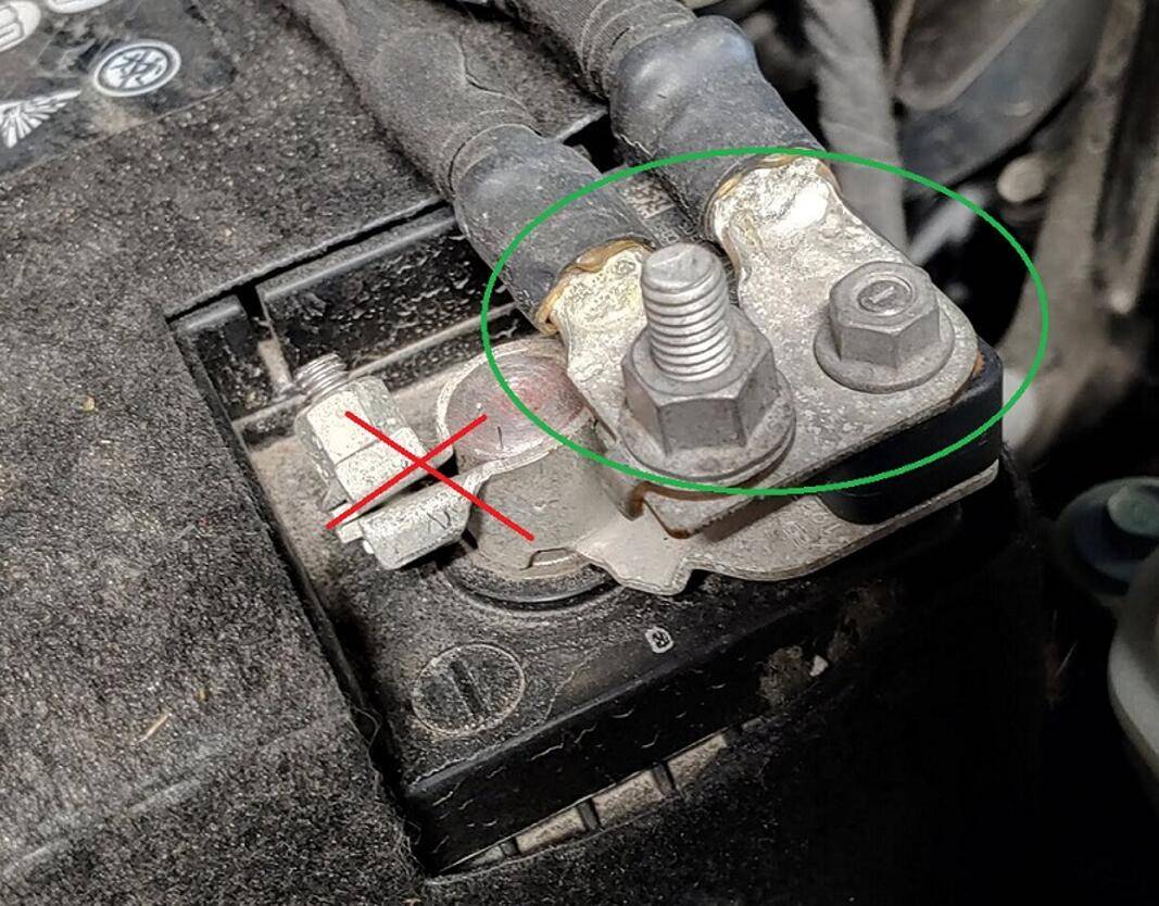

However, now we get back to - was his system connected into the Jeep's system properly???
Which "alternator" was being referred to - that got tangled since the stupid DC/DC system stupidly is named "Alternator" but there's nothing AC about it.
