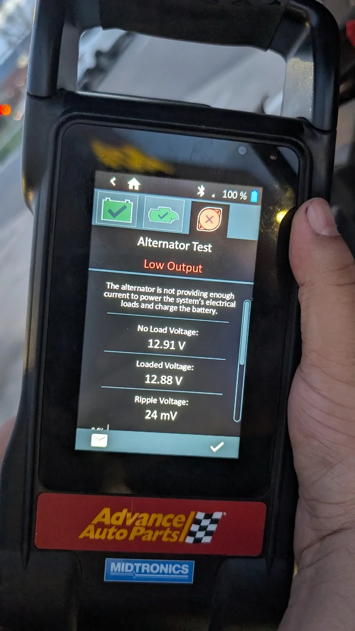

My 240 amp alternator is failing unfortunately. I had a sneaking suspicion but the dealer had only checked the batteries (I still have a warranty with them). More recently I've had some hiccups while hauling uphill from time to time, and it was emphasized while going over Monarch-- but I relieved it because my voltage would jump up to 14 while going downhill without load.
Long story short, I went to an auto place, they tested it and it's only outputting about 6 volts now. The big question is in the title:
Can I move to a 400 amp alternator without replacing the big 3? Or is the gauge they offer on the max tow package too small for that? The alternator I am looking at is recommending 1 or 0 gauge.

Do you need the extra amperage though? Sounds like the 240 amp was just failing and replacing it with another 240 amp that doesn't have such a short life would be the solution.
it is a variable output alternator but shouldnt ever be as low as 6v. How did they test?

Your alternator is pcm controlled it will only show 12.6-12.8.
It charges to a higher float voltage based on load and engine rpm.
