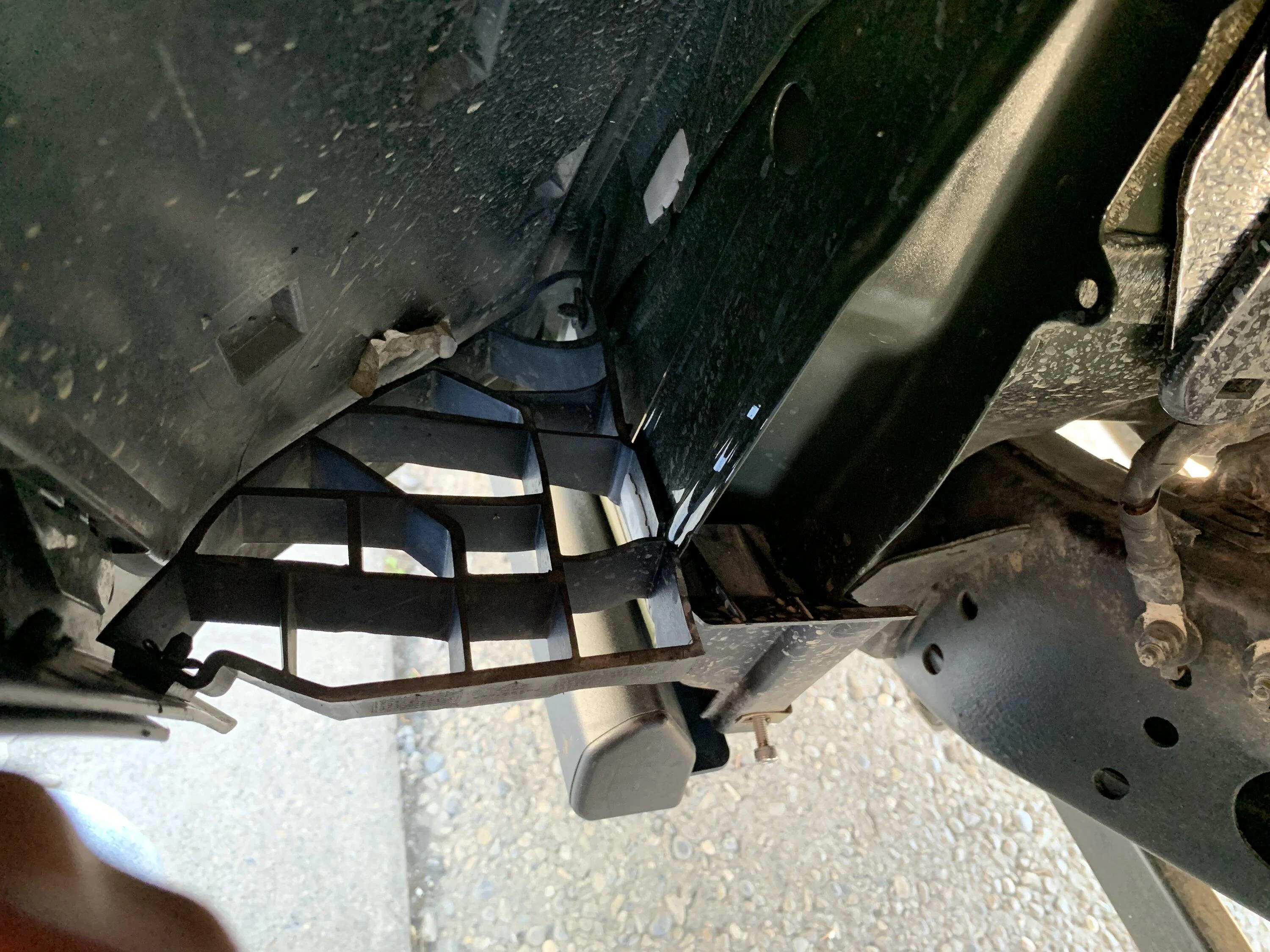

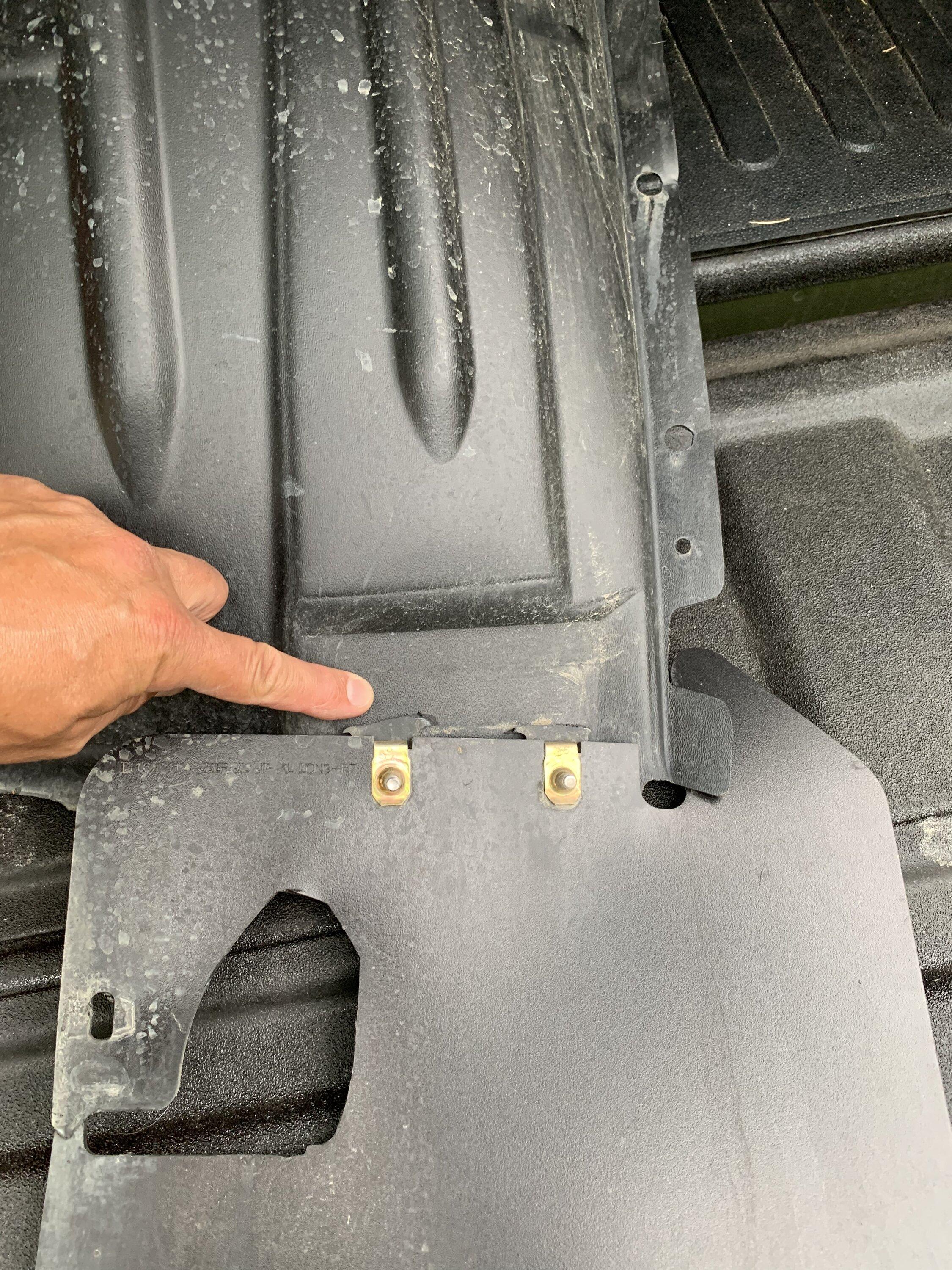

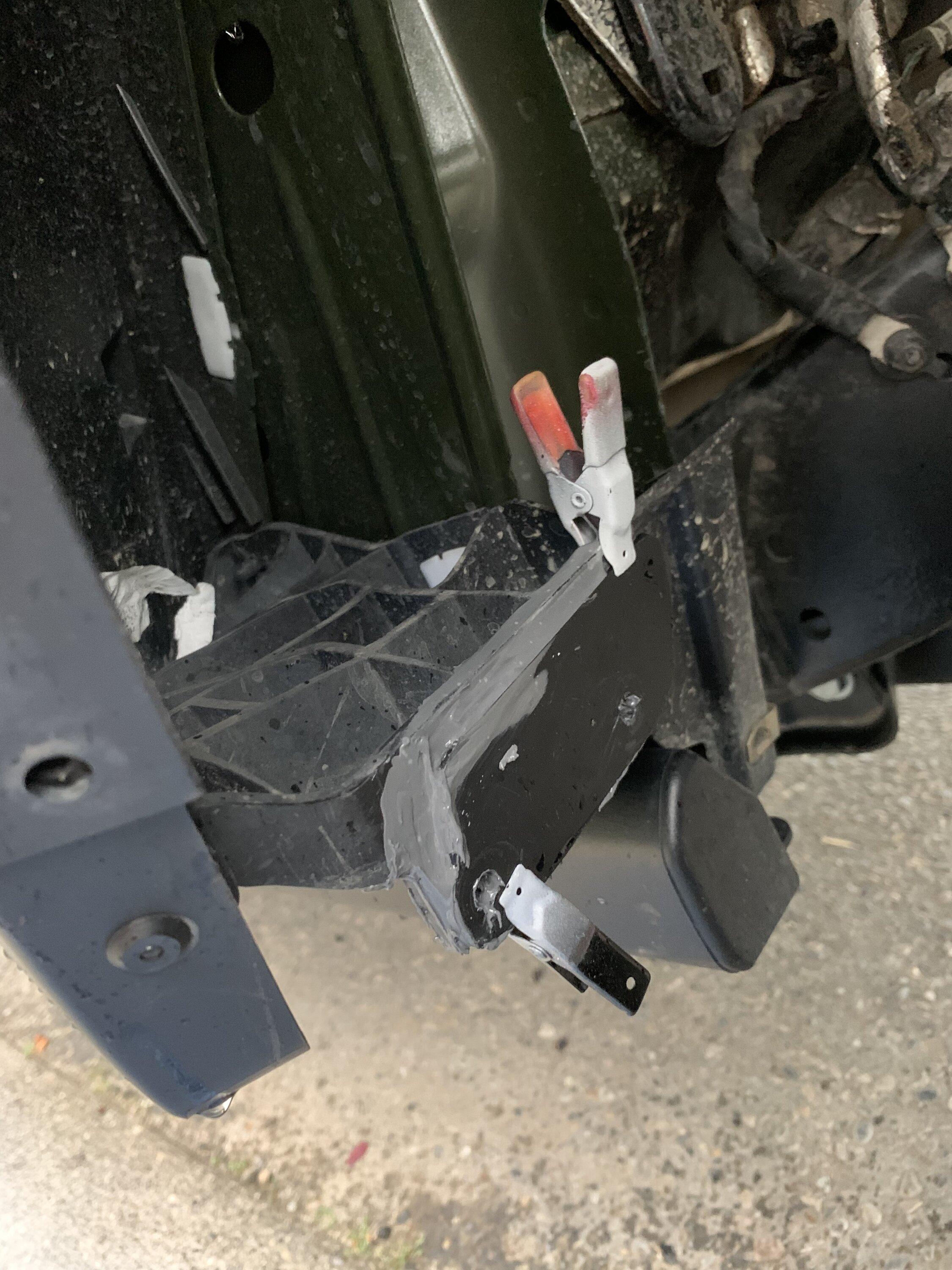

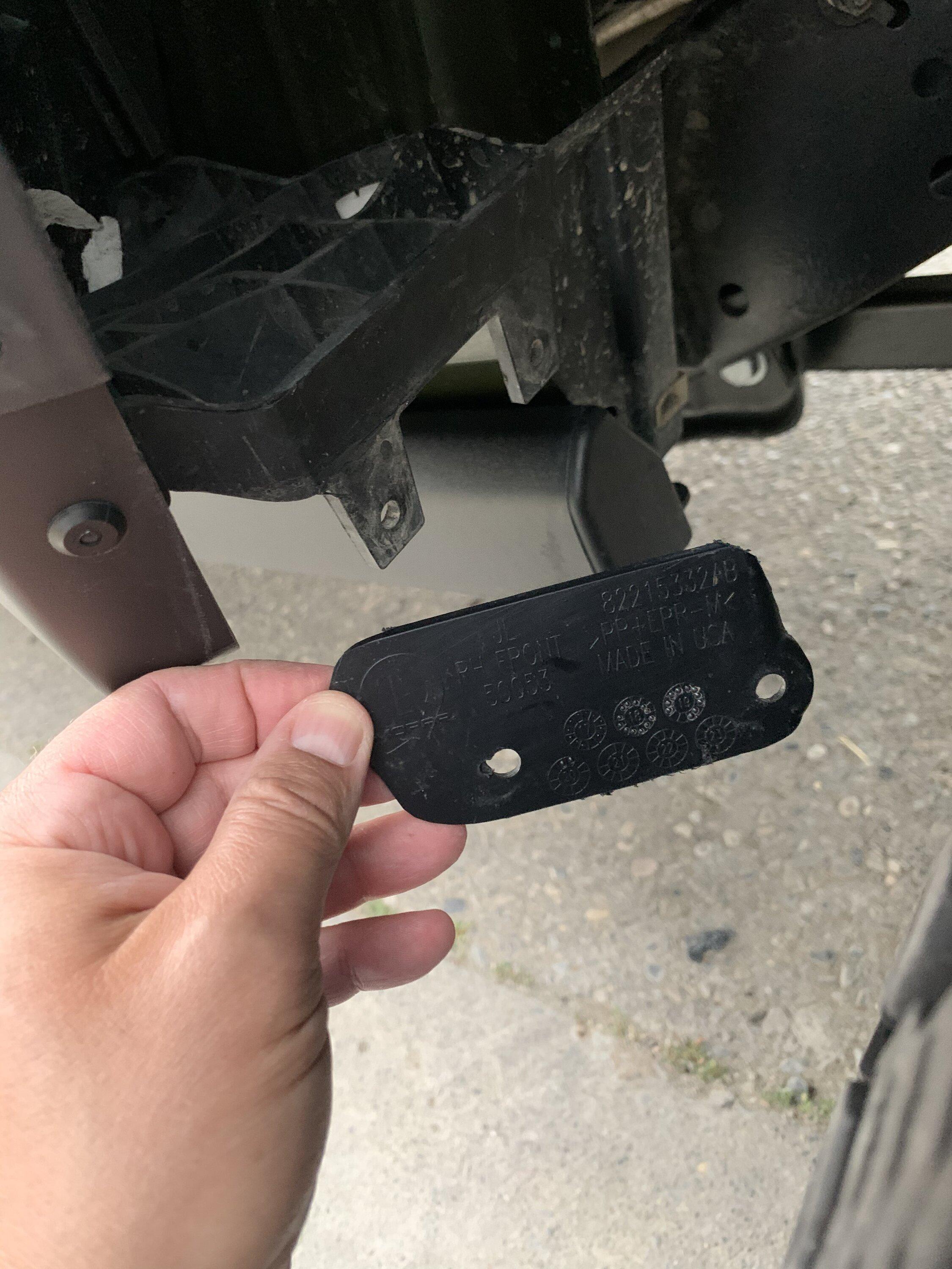

So as I was backing up on a sloped driveway the mud flap got coughed under the wheel and pulled out the inner liner clear our. In the process the flap stayed attached to the liner and broke off two mounting tabs that were a part of the lower fender brace/bracket, that provides support for the inner fender. Local dealership was unable to find the part. Can anyone help to identify this part. It is triangular plastic piece with a grid like reinforcement,,,
thank you in advance

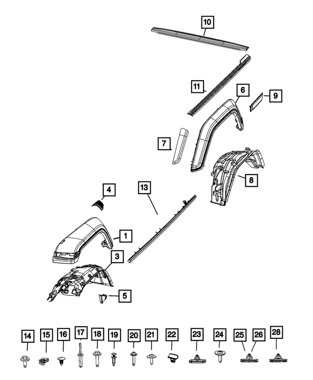

Nope. This is the fun part of the story. The piece I am looking for is not on the Mopar diagram

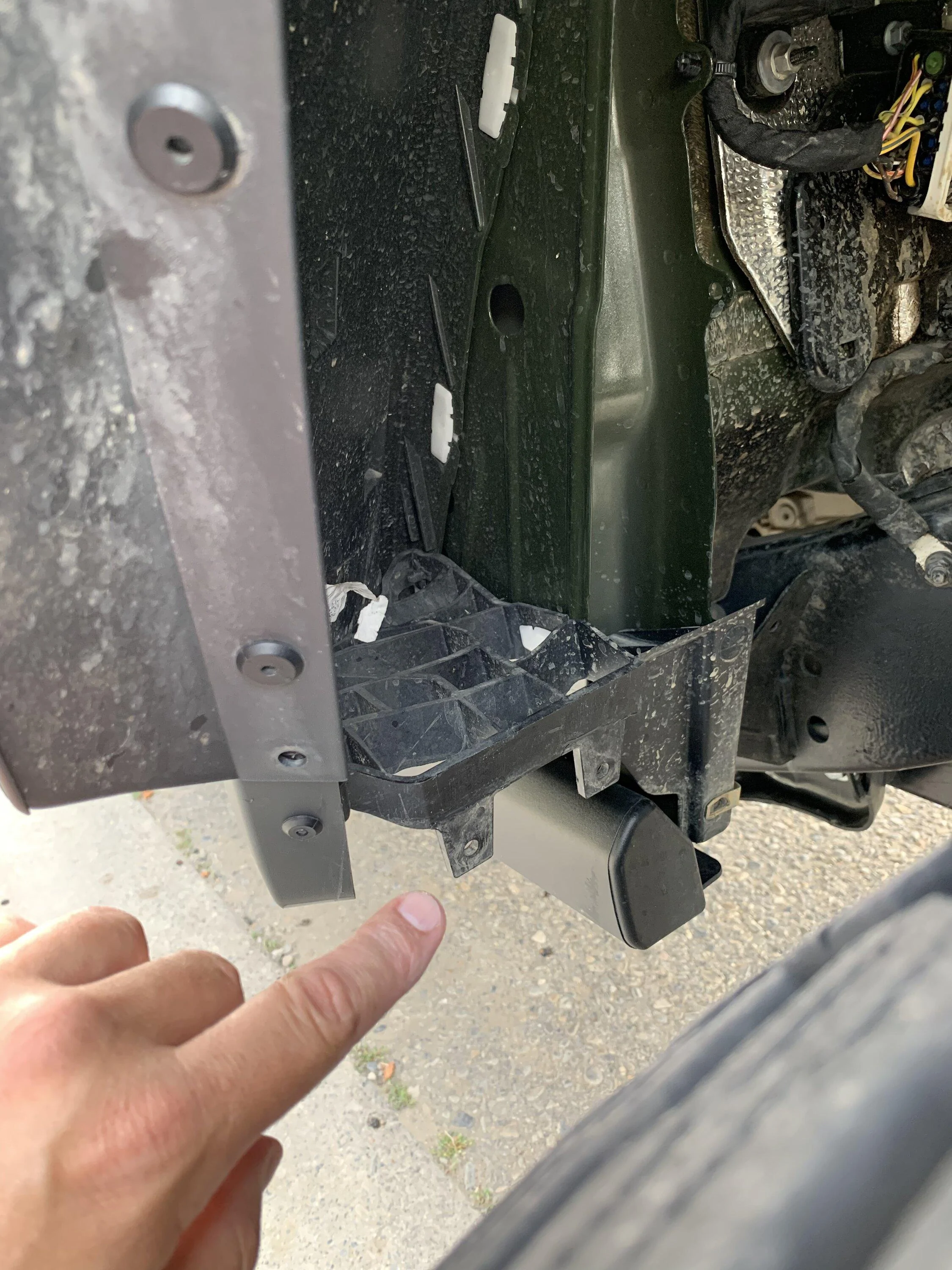

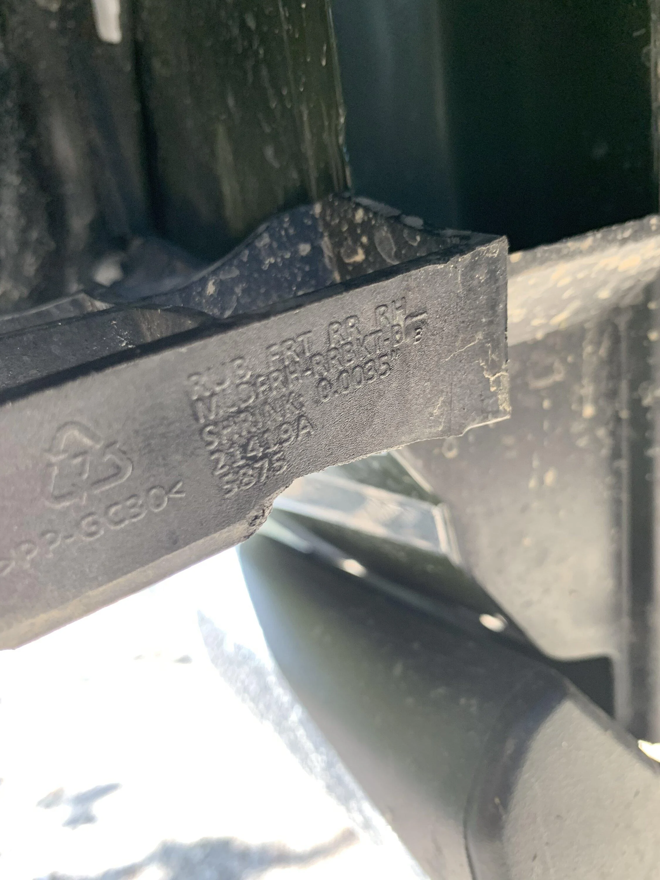

Thank you I’ll give it a try. Here are some more shots of the part in question.

Duh, I'm not thinking. Go to body shop and ask them IF the part is something that can be ordered separately. Show them your pictures, specially the ones showing where it mounts.
You KNOW they've had to have worked on that area on at least one JT.
*** I may have found it. Looks to be part of the actual front fender flare.
Look at Item 1 (fender flare) and look at back bottom. I believe the small part going from flare towards where frame would be is your part.
https://dz310nzuyimx0.cloudfront.ne...b3672968/600774145bf2787094a85cc8f6c6a0b8.png

Don't know if you guys have self service junk yards up in Canuckia, but if you can find a JL or a JT at one you might get the part cheap.

I’ve already checked nothing this new in the area. I might have to try to fabricate an extension.
thank you for the help?

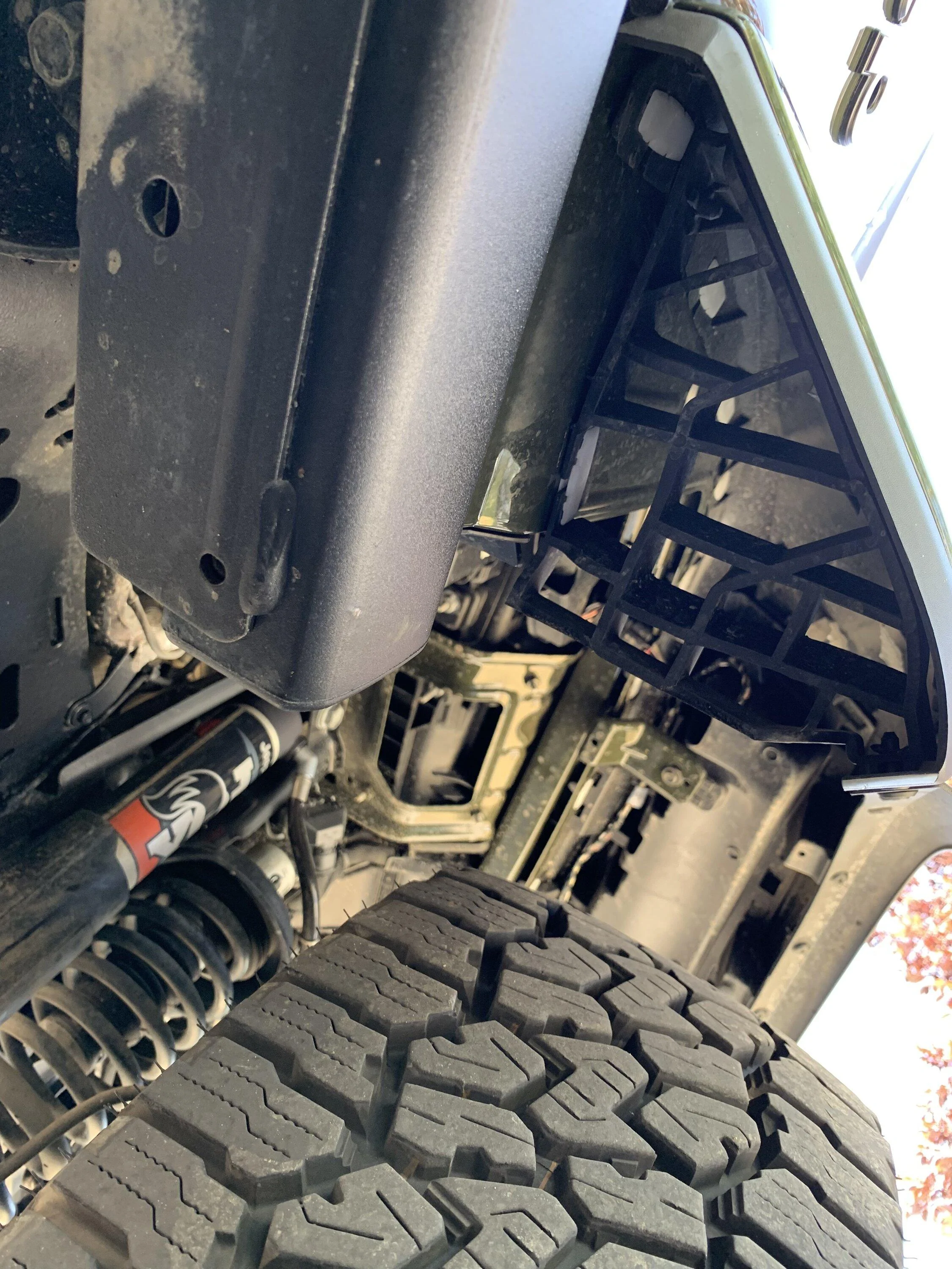

Just a quick update for the sake of future references.
Apparently you can purchase this piece only as a part of the flare assembly.
so I decided to utilize Wrangler mud flaps and create a support plate and simply JB bond the heck out of it on the original brace. Should work for now.
also a big shout out to Kevman for offering me his help with the replacement piece , since his fender was just damaged and he is wanting for a new replacement flare. Thank you ?
