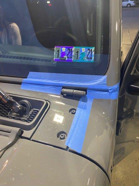

I don't mean to bump an older thread but I purchased my gladiator two weeks ago and I'm suffering from wind noise from the drivers side over 30mph. I started to painters tape all around including the panel next to the side mirror but this is coming from the lower windshield seal OR the cowl under the hood. I contacted Jeep customer service and they opened a case. Short of the dealership keeping my car and trying to find out what it is does anyone have any idea? See pics
A couple weird things I did notice. Those torx bolts on the top of the hood area are already rusted but they don't even look used. And I have not removed the windshield yet.

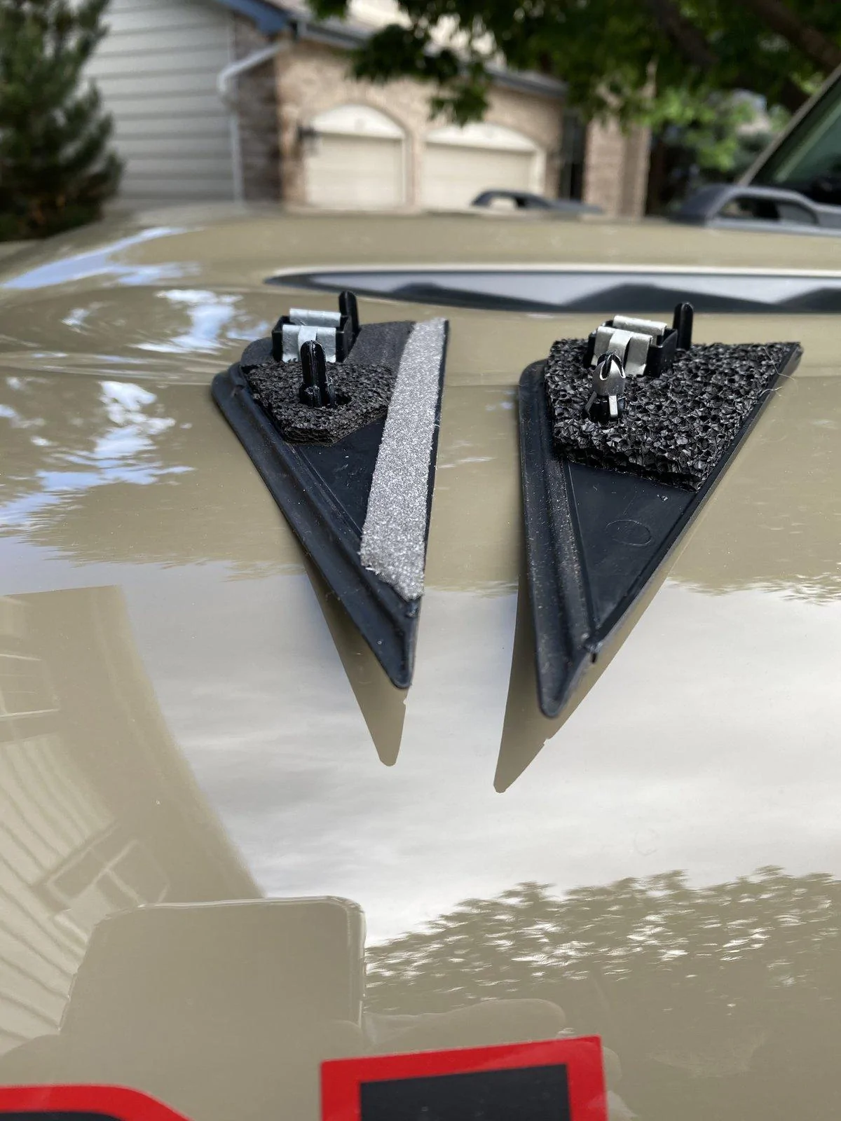

I have a wind noise in the right door that sounds like a window is cracked open. I have been chasing this leak since day one. I pointed it out at the dealership when/as i was buying it. Salesman and mechanic drove it and decided it is "characteristic of the vehicle", which is bullshit I drove two of them before I ordered this one and neither one makes the noise. Worth mentioning the left side is quiet as a church mouse as it should be.
I've remounted the freedom panels, lowered and inspected the windshield twice, no change.
Today as I was obsessing over it and inspecting the window and door seals yet again, I notice that on the passenger side (where the noise is) the little sail shaped piece of trim/molding at the front corner of the window kind of behind the mirror fits like shit.
So I took it off completely and put Gorilla Tape over the holes and went and drove it. Probably 80-85% better. So I stopped and cut the tape to allow re-installation of the trim and put it on. Immediately the noise was back although maybe diminished slightly.
This part is a poorly designed piece of crap, and looks like it is also out of spec. There is one central fastener and two guide pins. When it is installed by virtue of the centrally located spring clip fastener, the plastic piece of shit folds up like a taco funneling air off of the mirror mount into the mounting holes in the door (despite the soft/spongy/thin/inadequate and generally shitty weather stripping bonded to the back of it.
So having said that, I can't find a parts diagram showing this part, or the part number, and I don't even know what it is called, other than plastic piece of shit. I need the part number so I can order one or two.
I'm going to initially try to secure the thing with 3M two sided tape, but before I go to work on it I want to have a replacement original piece in hand. If 3M doesn't do it, the next step is screws.
I am 100% certain that if I try to get the dealer to fix this it will drive me into a dimension of frustration and general pissed off-edness that will rob all the joy out of my life and may result in my lapsing into a stream of profanity that would make a Mexican prison guard vomit.
So help me out, does anyone know what this part number is, or have a parts diagram with it shown, or even what it is called?
That's the offending part right there
My windshield was actually leaking water where you have the tape at the bottom of windshield. They broke the windshield taking it out and replaced. The “technician” that replaced mine destroyed my windshield frame and tried to hide it from me. Not only that, the new windshield was off center and seal was hanging out. The dealer was just going to use body filler and paint the frame. I blew a gasket on them. Two weeks later I get the truck back. Still leaks and the paint doesn’t match the rest of the JT. From all the water leaking in, I’m having radio issues and the traction control pulses at ransom. Not to mention my misfire and transmission shifting issues. I’m trying to get FCA to buy this pos back. They don’t want to fix anything properly. Just keep putting bandaids on it. I’m giving FCA another two weeks to come up with a solution before hiring an attorney and going down the lemon law route. I hope you have better luck with yours

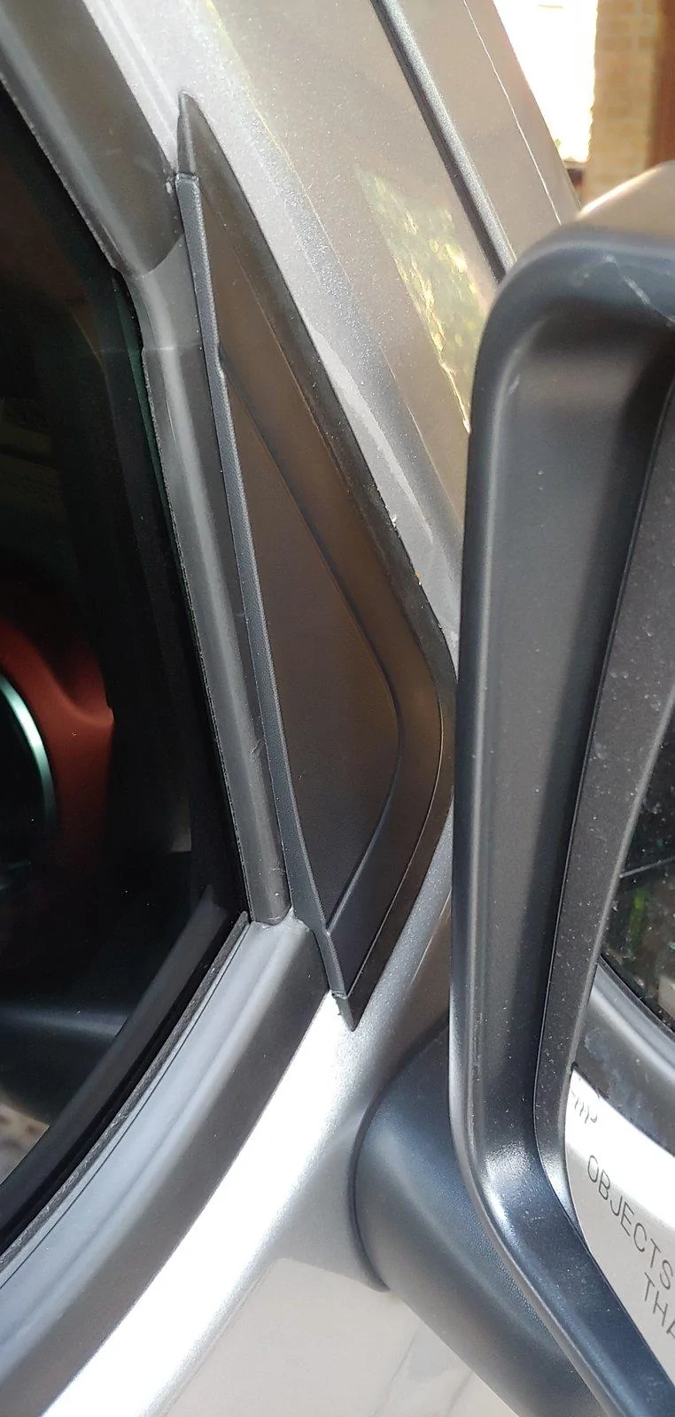

I wrestled with the "flag" component and its noise a bit today. "Crackle" is a good description of the symptom. First I put on the Silicone bead which was like a 80% solution to the noise. But clear Silicone was shiny and hard to get smooth and it looked odd. So I removed all that with Isopropyl before it cured and tried to remedy with weatherstrip. I have successfully fished the upper clip out of the door 3 times so far taking this apart... the fourth it got stuck in there someplace and with the door removed and shaken around I can't get it to even rattle anymore. Meh... BAM wholesale I have both sides parts ordered for another go. It is a Jeep thing, in a total BS kind of a way but F I should just throw some black sealant on around the whole triangle and call it good. Someone in Auburn Hills should be slapped upside the head.

FWIW... I replaced both the “mirror flag appliqué” right and left. Search BAM Wholesale, enter your vehicle and keyword “flag”. The new
parts had incrementally thicker weatherstrip. The new parts work better to reduce noise than my attempts at Ace Hardware weatherstrip. I’d call it 80% improvement, well down in Jeep normalcy range. The parts are like 5 bucks each.

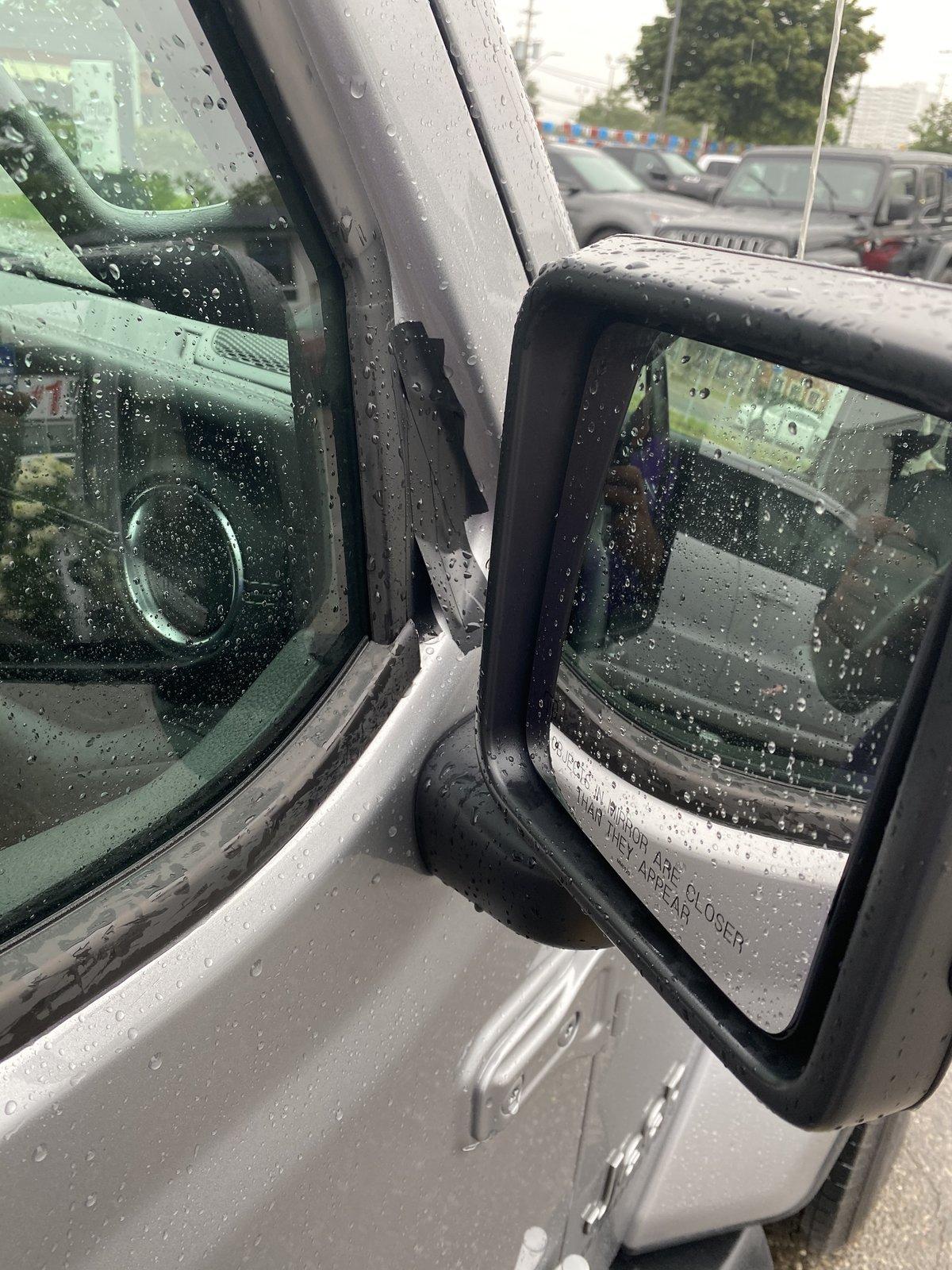

Mine flew off while I driving on the highway!! The dealer replaced it without issue. I covered it with electrical tape until they fixed it.

Thank you for this thread. I have 7k miles on mine and the noise started last week. Driving me nuts. Took off antenna, took of freedom top and made sure to put it back on with none of the weather stripping folded. Checked the mirror position. Stated thinking about taping gaps. Glad I checked here first. Now I'll address the piece of shit part as you nomenclatured it, and proceed from there. Thanks for all the leg work and followup.
