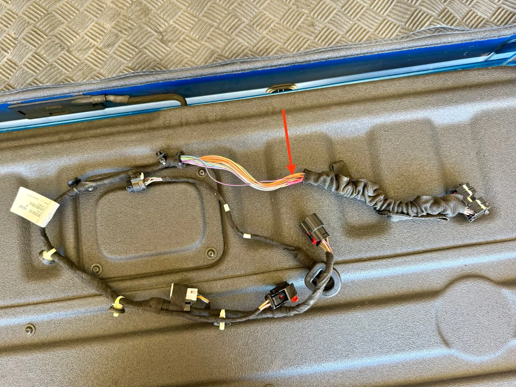

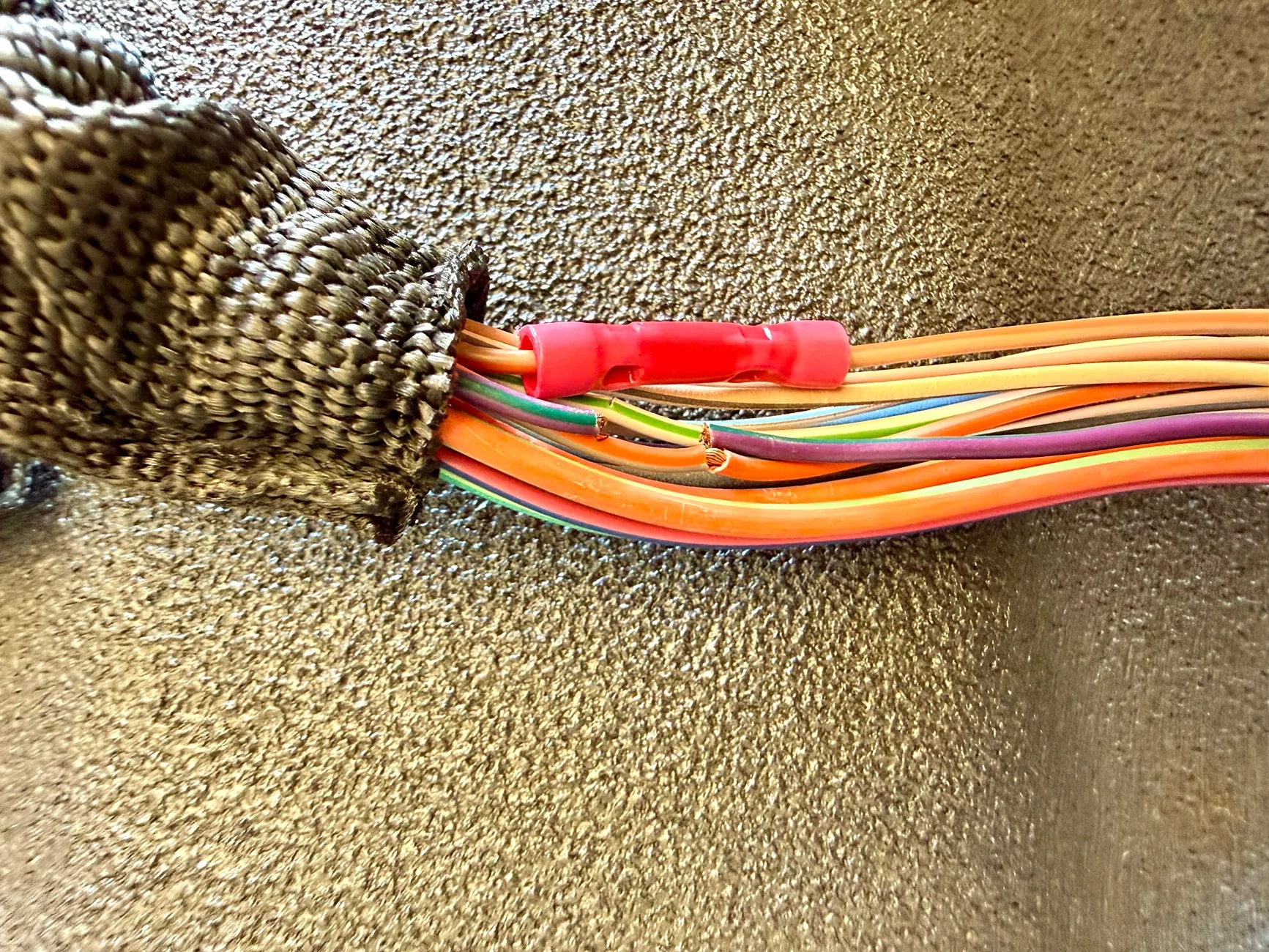

I replaced the passenger door wire harness and the problem was not corrected. Today I found the problem. There was a broken wire and two nearly broken wires inside the driver door limiting strap. I replaced the driver door wire harness and everything now works. I should be good for another 4 years or so.😀😀😀

As a temporary repair, I removed the tape on the driver door side of the limit strap and was able to access and splice the damaged/broken wire in the driver side door wire harness. The wire that caused the failure in the horizontal movement of the passenger side mirror was gray with an orange stripe. Since other wires were also about to break, I replaced the entire drive side door harness about a week later. Other wires in the old harness broke when I removed the old harness for the permanent repair.
