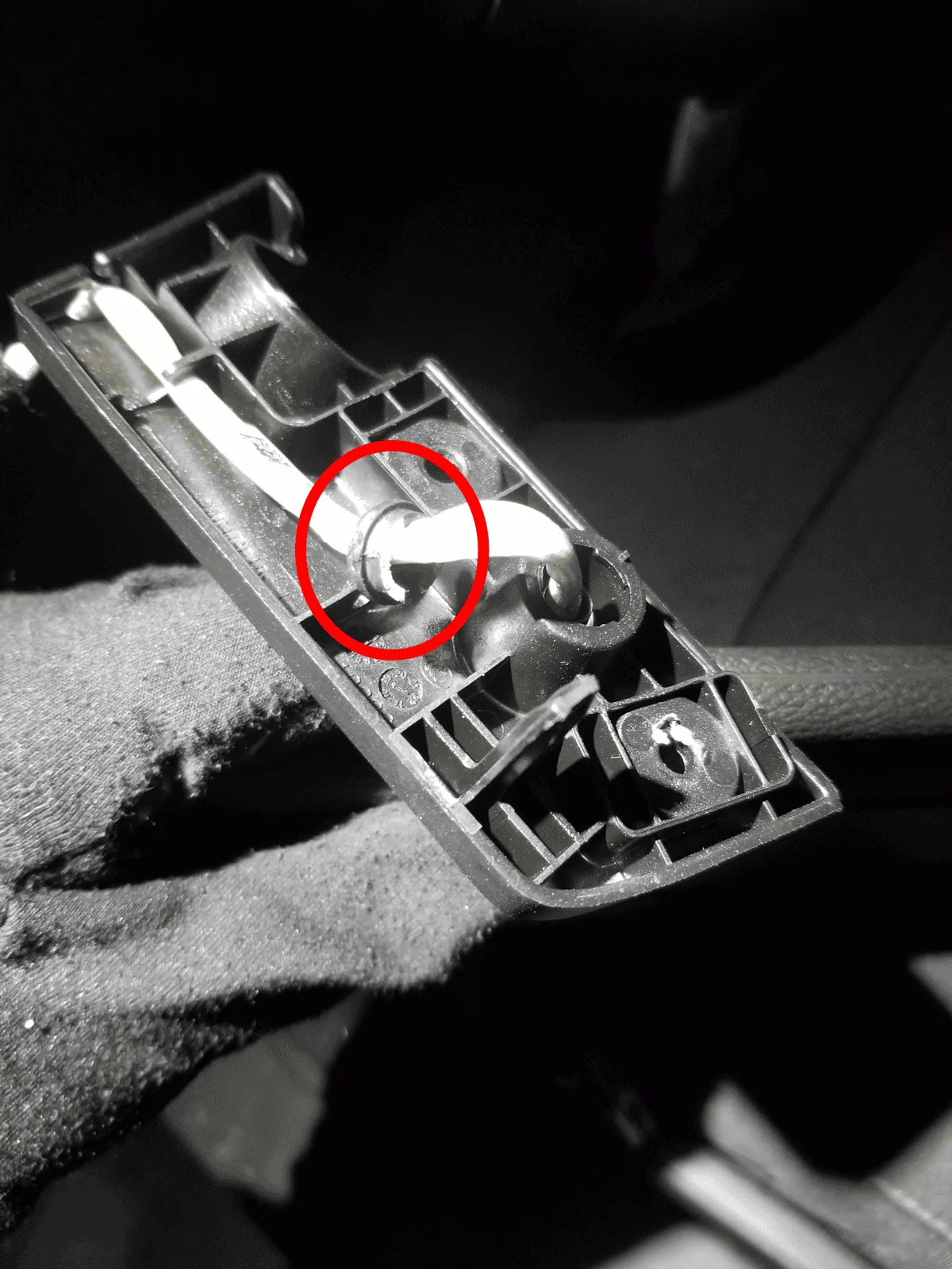

Did you use a metal split collar? Any issues with elec. shorts using the metal collar?
I used an aluminum split collar. I haven't had any odd contact issues that I've seen other people having. Not sure if I cut the plastic down further such that the collar sits lower or what. Garage door opener and mirror light work just fine.

A couple of guys reported an issue or an electrical short when effecting the fix..
Probably best bet is before you place the collar, place a piece of shrink wrap tubing / and shrink over the metal tubing before you place the split collar.... or a couple of winds of black electrical tape on the metal tubing.
Do this for insulation and thus no current flow from the tube to the collar.
