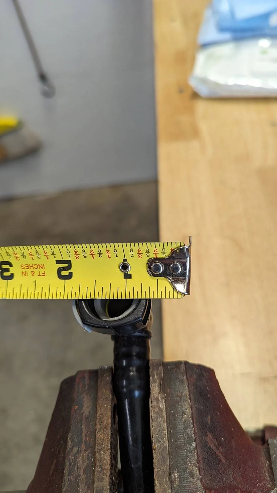

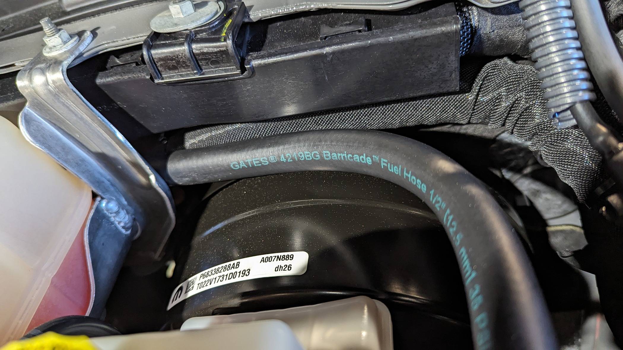

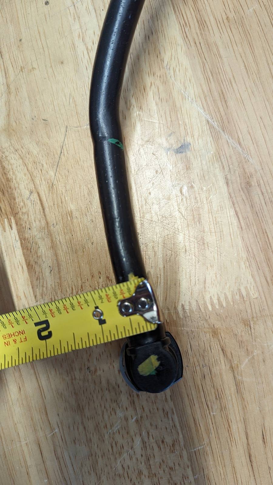

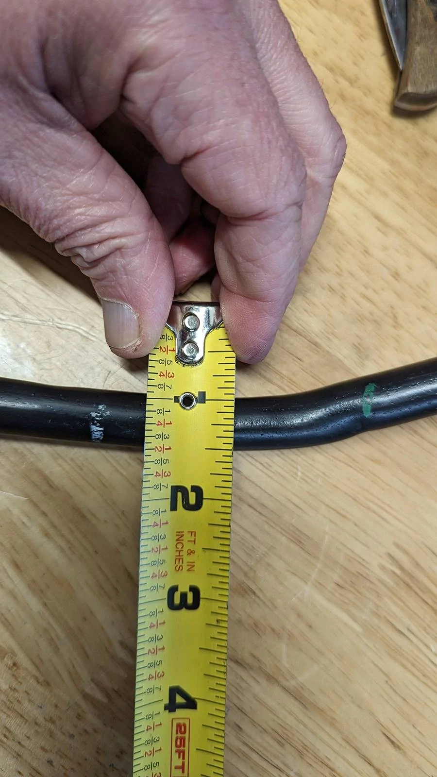

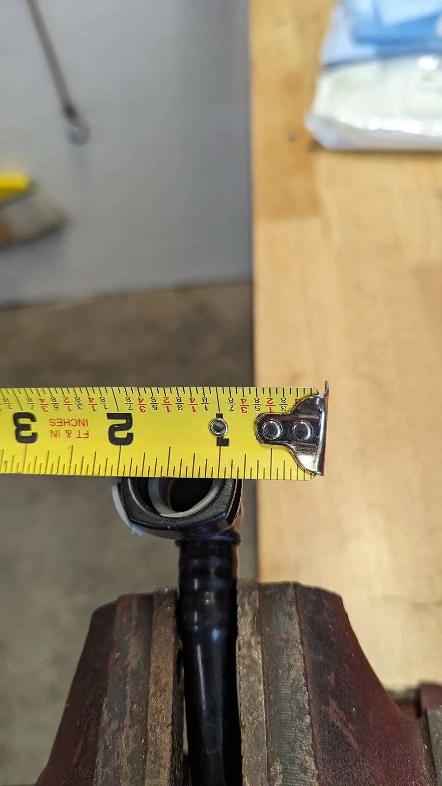

Being not quite sure what you're planning, I tried to be thorough.
I'd say the OEM hose itself is 3/8 ID and 1/2" OD.
The hose that came with my catch can kit is slightly larger - GATES® 4219BG Barricade (1/2")
Jeep Gladiator Pcv hose PXL_20240325_140434160
Jeep Gladiator Pcv hose PXL_20240325_140437282
Jeep Gladiator Pcv hose PXL_20240325_140547196
Jeep Gladiator Pcv hose PXL_20240325_140628008
Jeep Gladiator Pcv hose PXL_20240325_140815568
