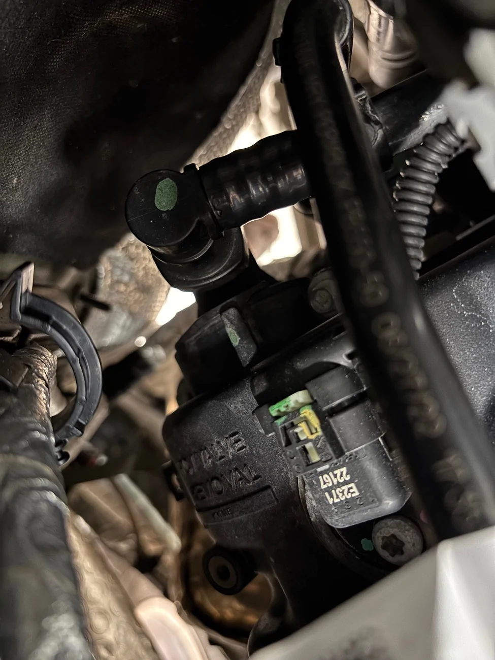

I own a 2022 Jeep Gldiator 3.6 and attempting to replace the PCV. I believe removing the PCV will not be a problem but i am having an issue with the hose. Some have mentioned a gray clip on the hose, not seeing that. Do I pry off the hose? I included a picture showing the hose. Thank you

Sorry figured it out. Turned out to be an easy maintenance item. Thank you
The clup slides sideways grasp both sides of the clip move sideways and hose literally lifts off. What zi had trouble with was getting the new O-ring back into the valve cover . I have big hands and there is but a few scant inches there. . I literally struggled for hours.. finally figured out it was the new O-ring was too thick used old Oring and it went right in. Been okay ever since loosen the 19mm bolt so you can turn the pCV valve out of its notch.
