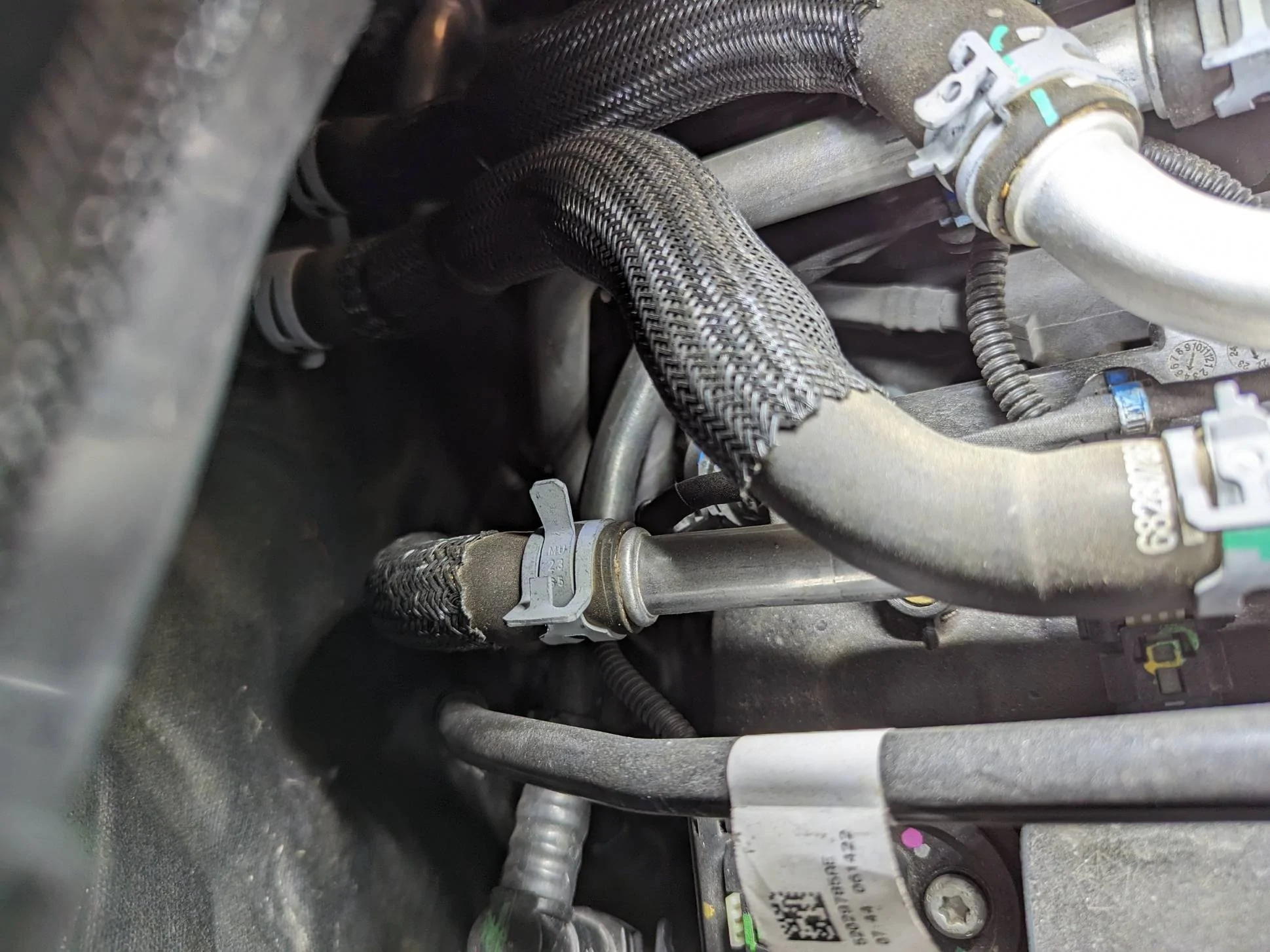

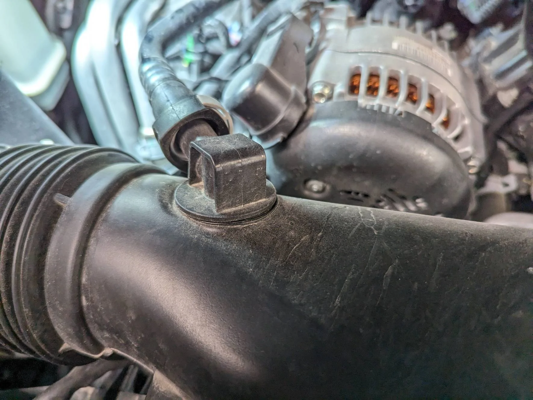

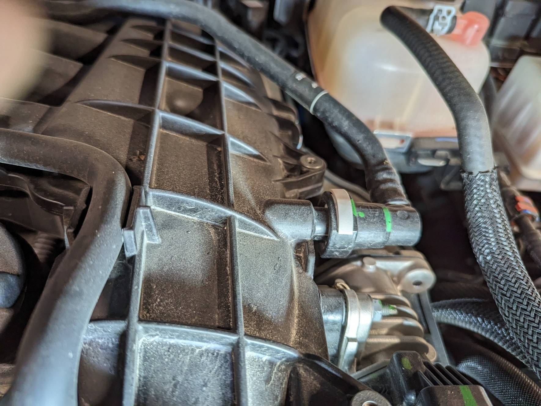

I have to admit I have not looked too hard at the engine, components, etc. but @ShadowsPapa isn't this the PCV line? Maybe I'm thinking of something different but I have consistent oil here as well and pretty sure I have seen many others on the forum talking about oil coming from here.
#1 being the PCV line, #3 being the makeup air going into the crankcase if I'm looking at it correctly (power out here, storms, dark, no lighting, things on minimal battery power)
What some are seeing is not really a leak per se, but a wicking of a tiny bit of oil, collecting dust, making it look really bad and like a lot. No, it really shouldn't be there, but how precise is the surfaces where the o-ring seats, how much pressure is there against the o-ring and so on. Maybe they didn't see it as a critical seal area?
Either way, under typical conditions, there should be low pressure in the lines - lower than atmospheric. Not always, but typically.
The line for makeup air should be seeing a lower crankcase pressure pulling air from the tube shortly after the air filter - so clean air gets into the crankcase. There shouldn't be any pressure higher than atmospheric.
The PCV line itself should almost always see a vacuum in it - or at least lower than atmospheric pressure. The point is the vacuum or lower pressure of the intake should be pulling air from the crankcase - the crankcase pressure should never exceed the intake pressure.
All that being said - I see these as possibilities -
For some reason crankcase pressure is exceeding the pressure in the filtered air tube - makeup air (if the 1/1000 of a drop of oil is at the makeup air line fitting)
For some reason crankcase pressure is exceeding the pressure in the intake - and PCV line, (if the 1/1000 of a drop of oil is at the PCV line to intake manifold fitting).
Is the PCV valve itself malfunctioning?
Is the driver forcing quick downshifts dropping intake manifold pressures abnormally low for a long period?
I've not seen such dusting around the sealed areas on any of our Jeeps - WK/WK2, or JT, including my 2020 I traded at 27,000 miles.
My current JT has over 21,000 miles..
Sorry, still can't lean over fenders and sharp areas for a while for good pics, but mine is dry as can be, everywhere -

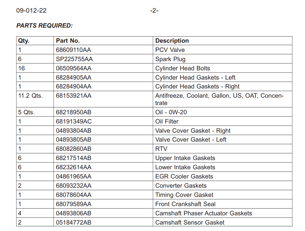

Interesting, because the updated PCV Valve seems to retail closer to $100 at the online dealers like @AllMoparParts.com
68609110AA
https://parts.allmoparparts.com/oem-parts/mopar-valve-68609110aa
See TSB I just posted above.
68609110AA
Funny thing is if your were to look up the current PCV valve on the MOPAR part websites, it will list the legacy 68210345AC part number. For whatever reason, MOPAR is not listing that new TSB part number as a superseding one.

Man that is one intrusive TSB. talk about $$$
Lunentucker
Apr 24, 2022
253
5,949
15,689
2021 Jeep Gladiator Mojave
People Work?
I meant to reference the discussion of oil inside the PVC hose and going into the intake just downstream from the air filter. I'll see if I can snap a pic of mine later today, but I know it was a discussion here in the past.
No doubt. I was expecting "Remove old PCV Valve. Install new PCV Valve" ?
At that cost it should be covered for free IMO especially if it is due to a design flaw.
