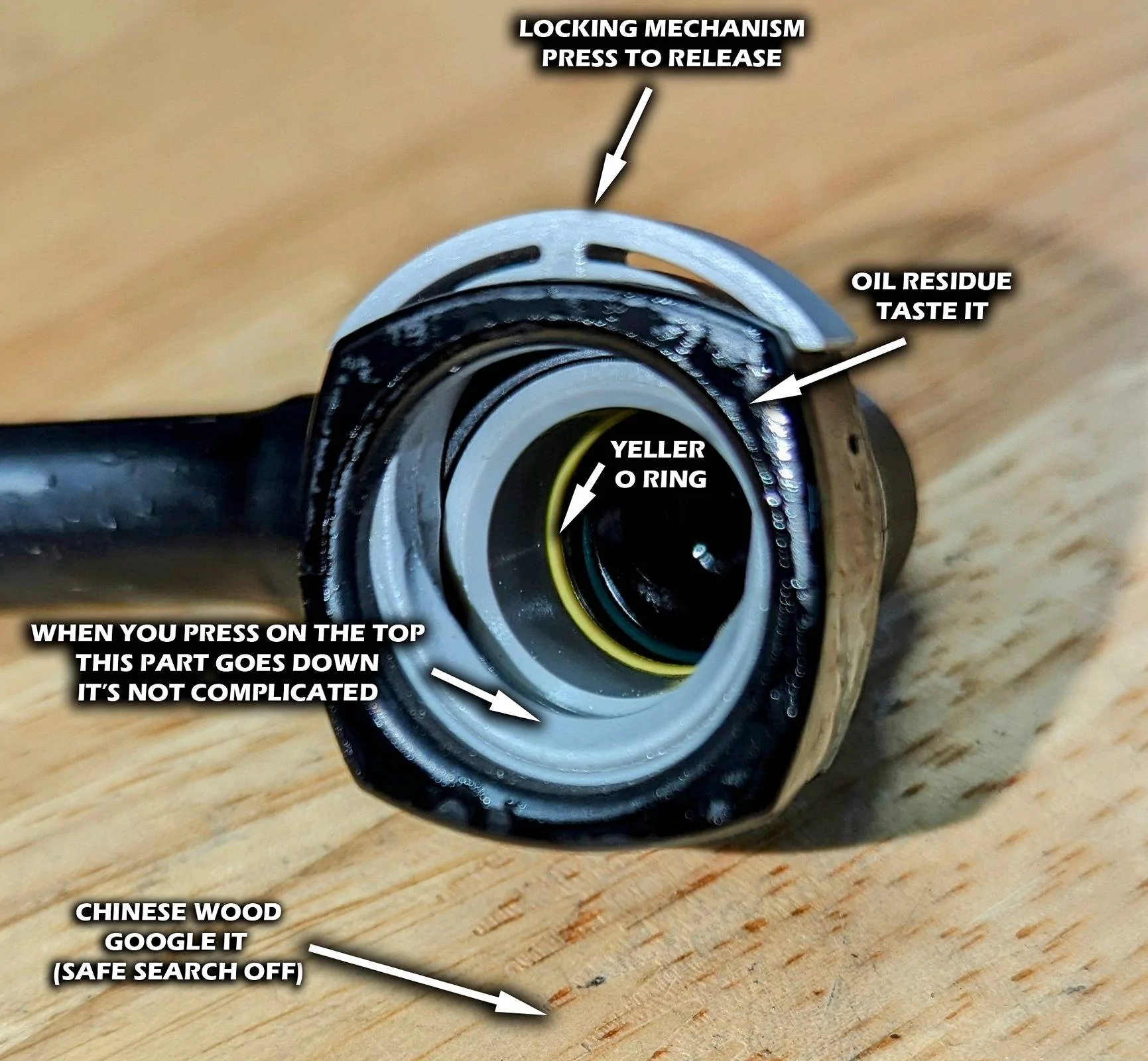

Nope.
You may be seeing the offset on the locking mechanism.
You had oil seepage too? I wonder if that’s how they all are. Might making trying to fix it kinda pointless.

I noticed it when I took that cover off to have a look underneath. The part of the intake near that connection has some oil on it. I’ll fix it.

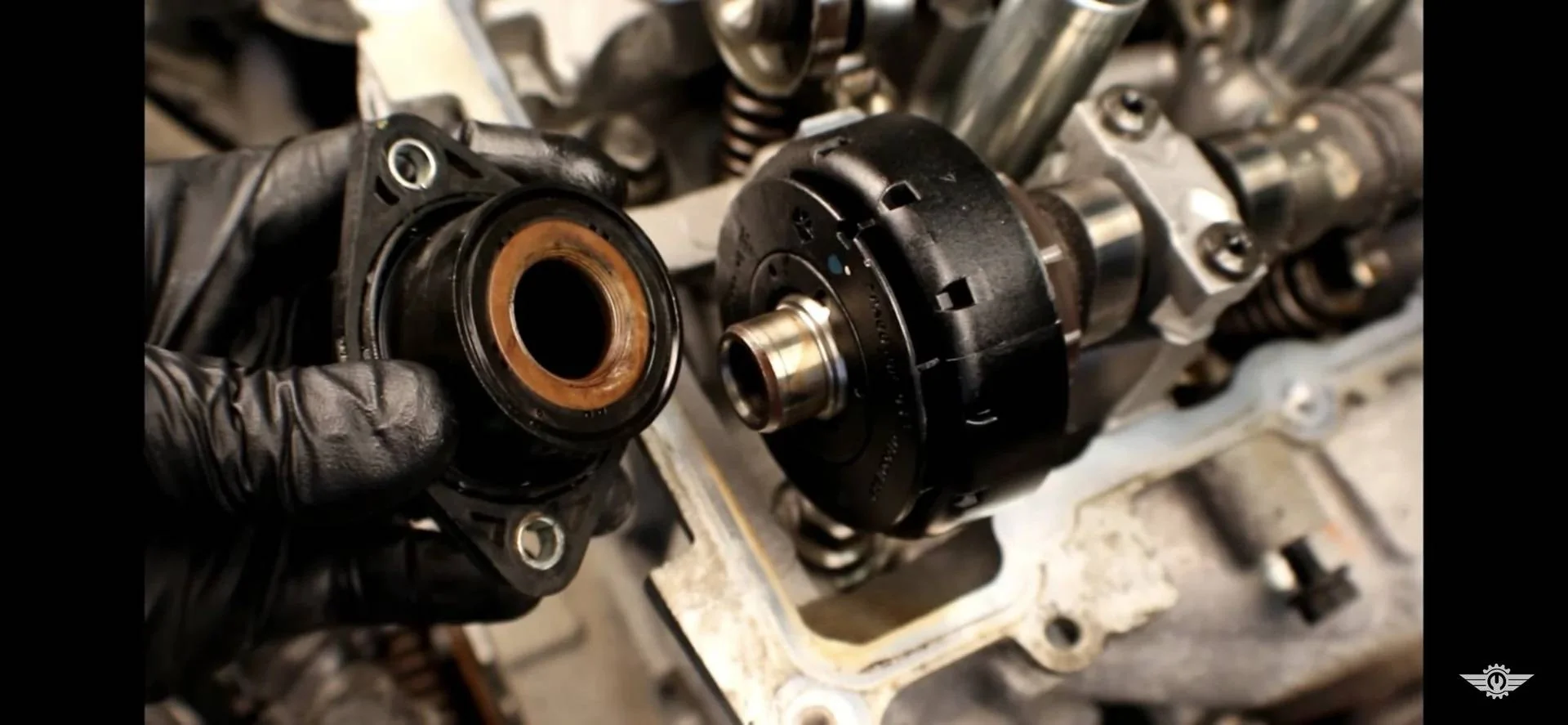

Since these aren't truly a valve, unless I'm missing their function and design, a "smaller hole" means less air pulled from the crankcase.
These are mostly a cyclonic air/oil separator.
Hootbro
Apr 13, 2019
10,172
19,936
2025 Gladiator Sport
I saw somebody on you tube or another forum that changed there PCV valve with the newer one and said hole was also smaller until they checked it again after it was installed and the hole was then the same size as the older one ? Can’t verify if this true ?
Sounds about right. It rides on the end of the exhaust camshaft that has a air/oil defuser forward of it..
Edit: Here is a picture of a first gen Pentastar PCV set and the oil separator it attaches to through the valve cover. Pretty much the same setup on our current PUG generation engines.

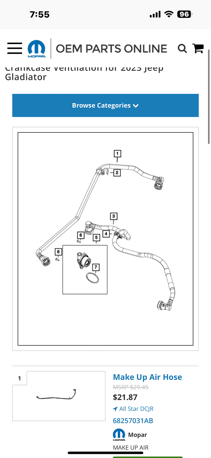

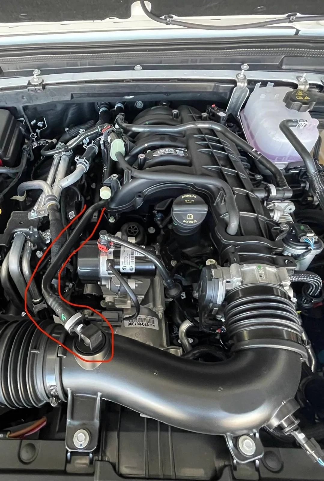

After some further research, the hose im talking about is actually the “Make Up Air Hose.” There is oil coming into my intake tube from this hose, it connects at the back of driver side valve cover, and connects just after the air filter on the intake tube.
I have to admit I have not looked too hard at the engine, components, etc. but @ShadowsPapa isn't this the PCV line? Maybe I'm thinking of something different but I have consistent oil here as well and pretty sure I have seen many others on the forum talking about oil coming from here.
