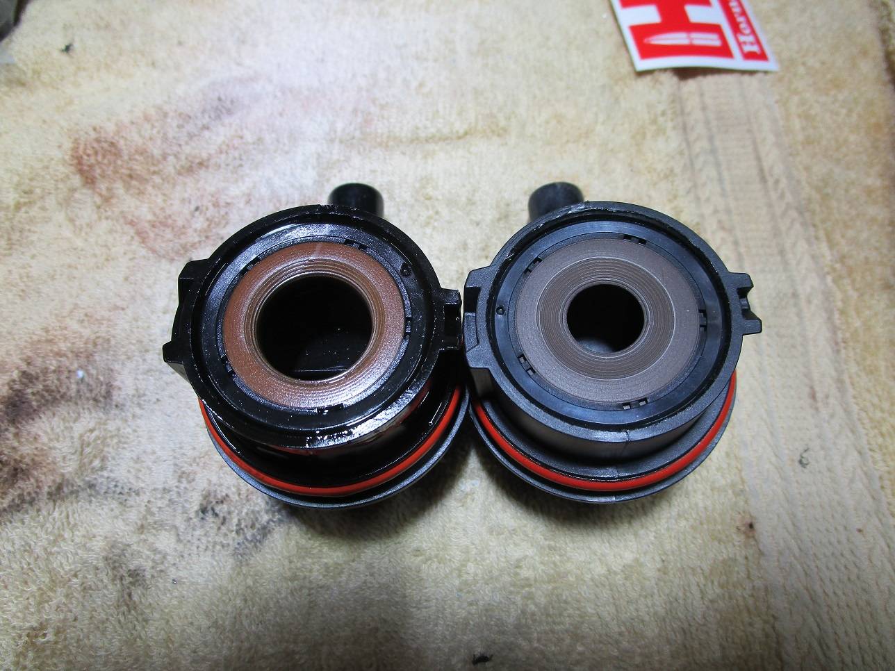

Side by side - old and new
(also, prison vs no prison)
The size of the opening is deceptive. The uninstalled valve has a smaller opening, when installed the opening conforms to the outlet on the end of the camshaft. This creates the best seal possible.

I'll pull mine off and look. There should be no oil there.
if you or anyone else recalls about a year or so ago there were a handfull of people I saw posting about this. Mine has been like this from day one.
Jeep Gladiator Pcv valve IMG_4500
40,440
53,853
Having my laptop back again, that's just a rubber seal. So your comments make total sense.

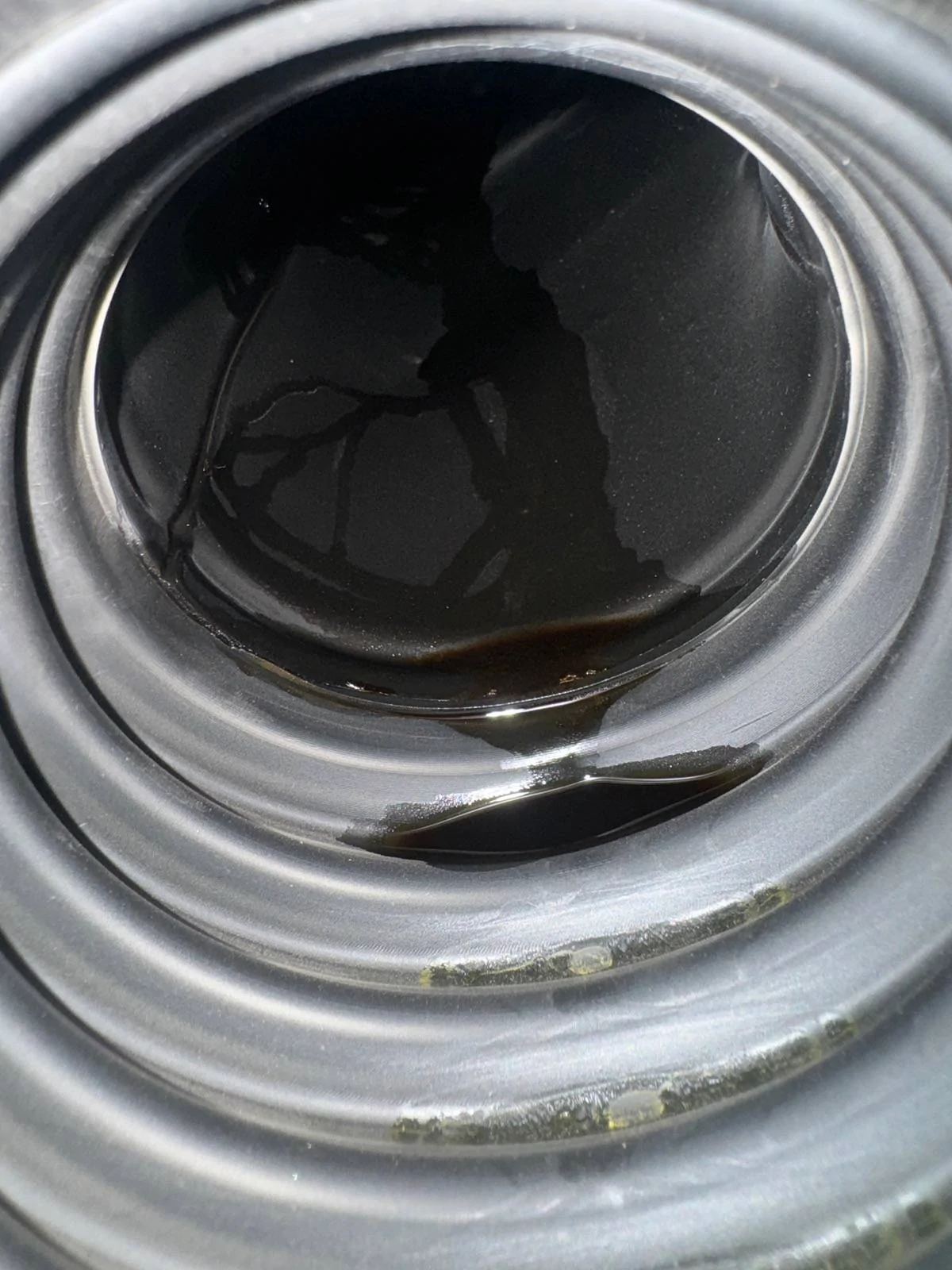

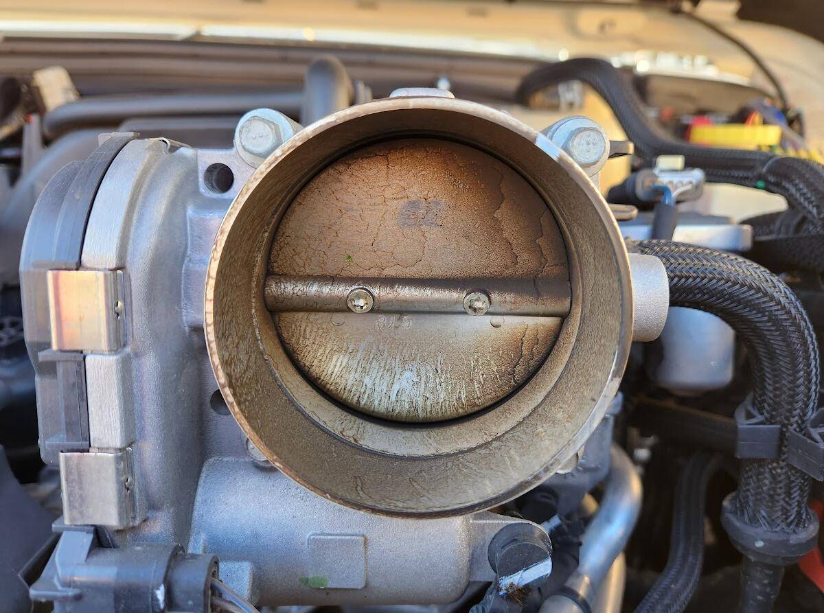

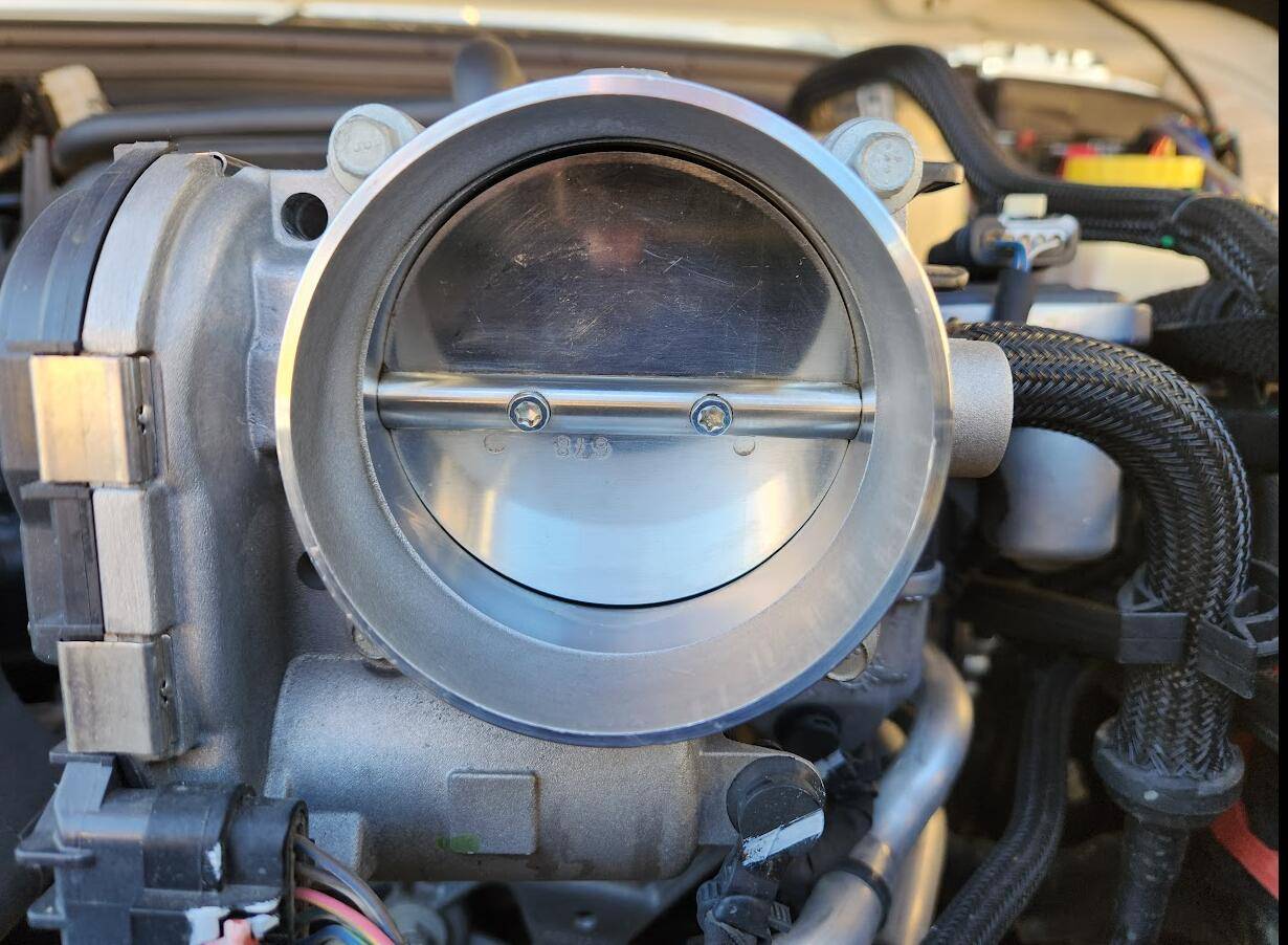

Reviving this as I'm at 61K miles and diving deeper into some maintenance... my intake tube has standing puddles of oil (@chorky style above) and the TB is pretty wet. I only use OEM air filters and oil changes every 5K miles.
Is the TSB version of the PCV valve (68609110AA) for $43.68 the "new" one I should be looking to order?
Please and thank you.
gross... yes, I took it off and cleaned it after this lovely discovery. I'm basically going to check it every oil change from here on out.

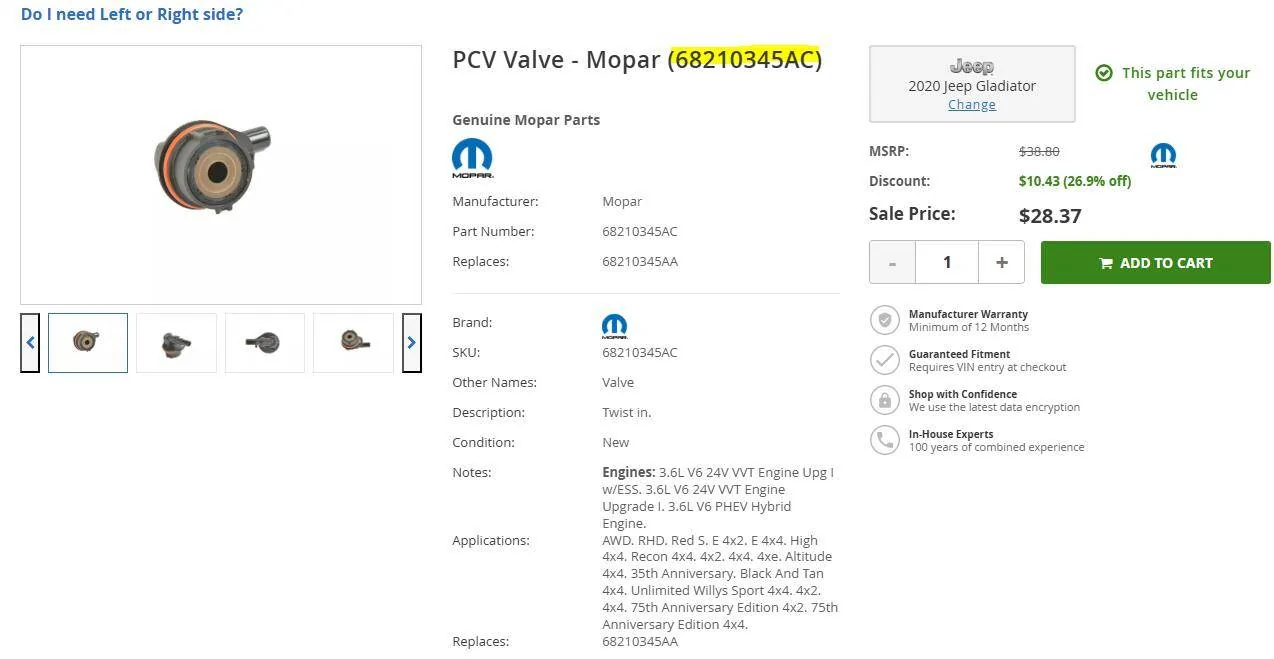

If the pvc tube and the valve cover are the same part across the fleet, why are the pcv's different parts between 20-22 and 23-24? Just wondering because I looked at the updated pcv for my 2020 and it didn't cross. The 2020 has it's own updated part number.

Could be the pintle shape (longer or shorter taper), the metered hole (larger or smaller where the pintle nose opens and closes the opening) or spring tension inside the PCV valve itself.

I mean, I completely agree as the 2020 PCV part number is different and the vehicle fitment according to the website is 2016-2022... grrr, I don't know. All I know is that the PCV hose tube is wet and where it connects to the driver side valve cover is REALLY wet. Plus both of my camshaft position sensor seals on each valve cover are weaping (I wouldn't say leaking) something terrible. At this point, if I start tearing apart the intake and valve covers I'm going to do lash adjustors and rockers while I'm disassembled... yeah, I've been reading too many "ticking" threads lately and my 3.6L with 61K miles feels like it just knows it went out of warranty :(
Done ranting for the night... thanks folks.

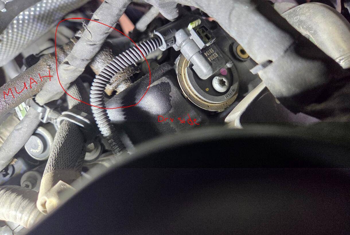

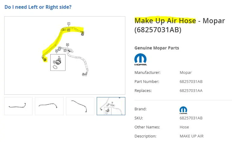

@Maximus Gladius thank you for asking the clarifying question as I'm referring to the "Make Up Air Hose" and was calling it (mistakenly) the PCV hose. My "MUAH" has oil in it, the plastic OEM intake tube where the "MUAH" connects (yes I only use OEM paper filters) has a stream of oil in it, and that oil has pooled up in the rubber ribs right where it attaches to the throttle body. I also attached a pic below of a very wet connection of the "MUAH" at the back of the driver valve cover. If anyone can enlighten me why this could be SO WET I'd greatly appreciate it. Regardless, I'm going to tear into the top end and go thru the passenger side "tick" procedure, replace all valve cover seals/gaskets, stick in a Dorman alloy oil cooler, water pump... etc. I really want to keep the Jeep for another couple years or (30K miles) before going to something new. For the $1500 bucks outlined below I hope that will do the trick.
Jeep Gladiator Pcv valve 1743545132853-o9
"MUAH" super wet at connector at back of valve cover (driver side)... why?
Jeep Gladiator Pcv valve 1743545952491-yz

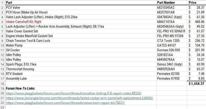

2025 Plans...
Jeep Gladiator Pcv valve 1743546028854-xd
