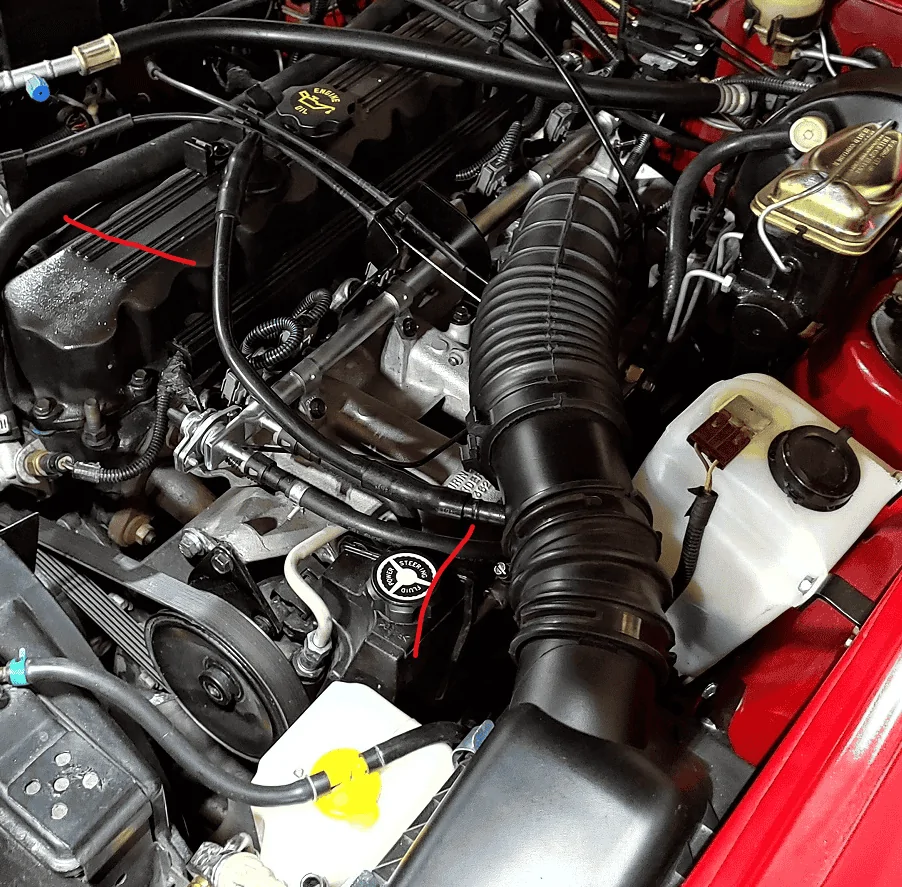

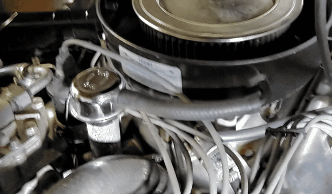

Here's an example of a makeup system and hose of the past - any oil showing up here meant excessive blowby or a defective PCV valve.
Jeep Gladiator Pcv valve 1713889031719-06
