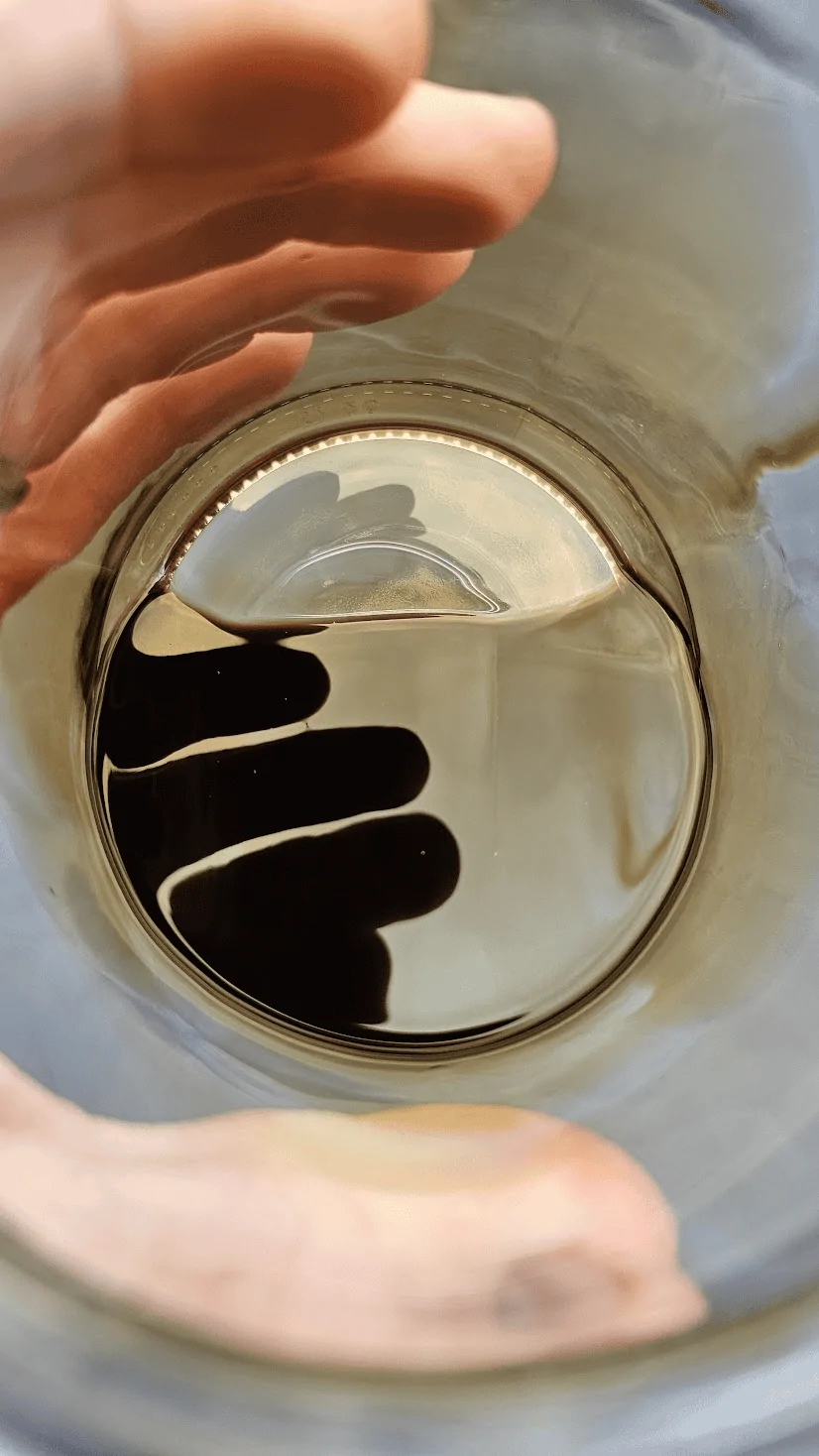

I just got back from a trip to Windrock and put about 1000 miles on my JT, mostly highway but also about 10 miles of trails (I only had one day, sadly). As I was doing my post-ride inspection I also checked my catch can... it was almost full. So, roughly 2000 miles and about 3 ounces of oil:
Jeep Gladiator Pcv valve 1712788248710-ft
I was reading on another thread about how lower temps cause catch cans to emulsify - that the water isn't coming from the crankcase, but is a result of the catch can condensating.
When I checked at my first 1000 miles I definitely had the "latte" look, but with the warmer temps, the oil in the can just now was ... oil!
That looks like oil, not an emulsion like so many post when bragging about their catch can (and that's really what some of it is in a few cases).
Might be cool to keep a log of the miles and the ounces recovered and then when you reaches 16 ounces total recovered, it should be down 1/2 quart on the stick.
Yep, just oil... and no emulsion/mud at the bottom like what @Lunentucker saw in his. Not sure why, though.
Probably because of his orange trim?
Could probably list a few reasons but won't matter much - yours got oil, there's no question.
