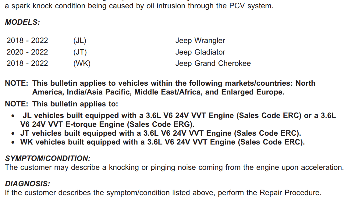

Probably with the 3.6 PUG and that means before Gladiator.
Otherwise, they'd not be able to simply put in the new version of the PCV in earlier Gladiators - it wouldn't fit.
Remember, for every ounce of oil you think you catch in a can, the pan level has to drop that same amount. So if you think you've caught 32 ounces of oil in 4,000 miles, your JT is a quart low or more.
The earlier design didn't separate out the oil from the air being evacuated from the crankcase.
No other reason - and there shouldn't be any performance issues unless you had excessive oil getting into the chamber.
You can look at spark plugs to help determine what's being burned in there......
