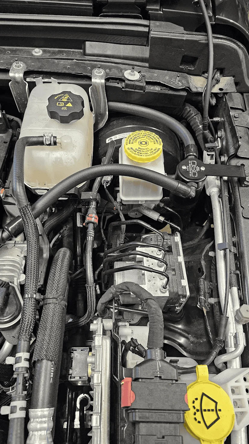

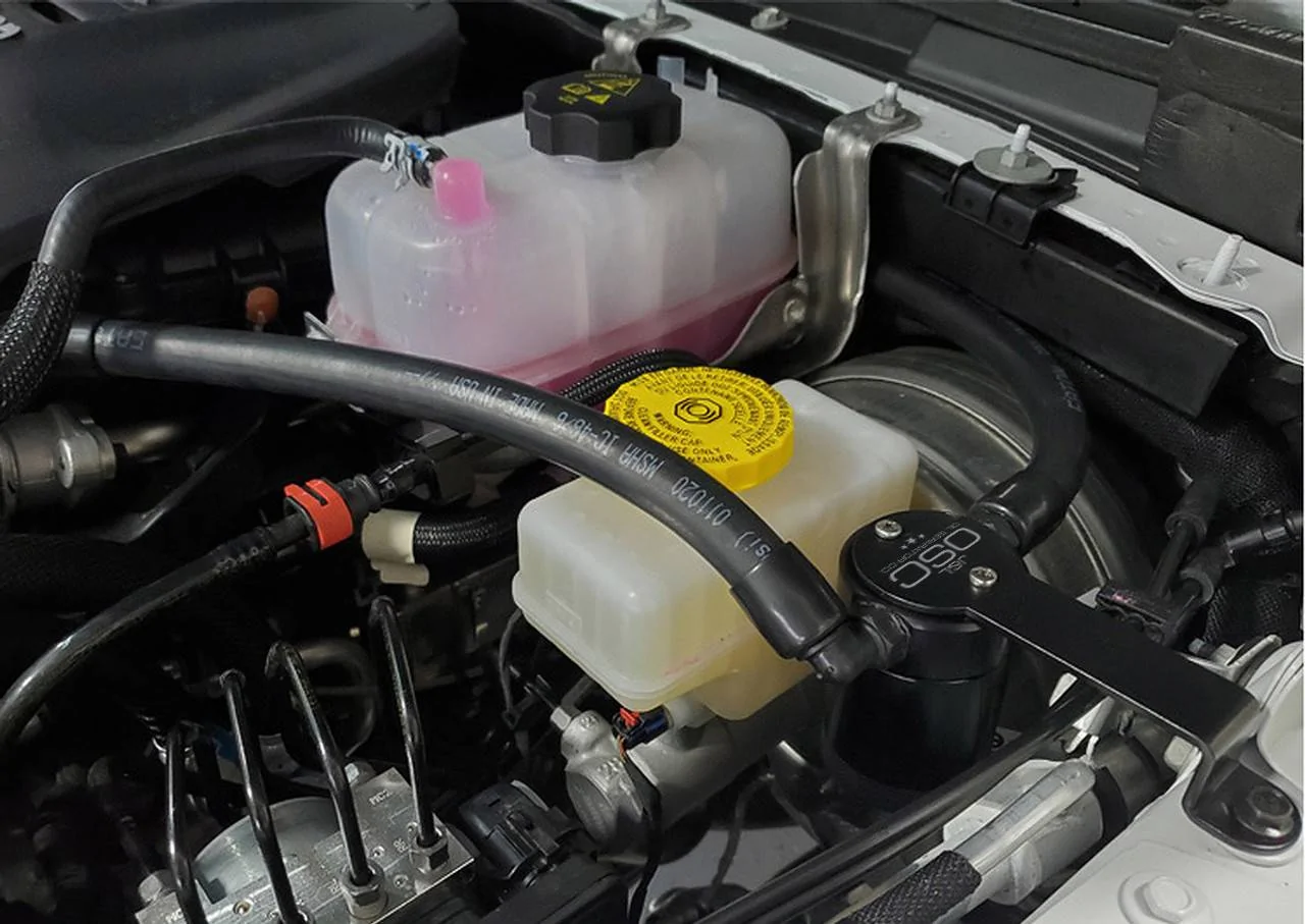

I think I like where this one mounts better than right on top of the filter housing.
https://www.jlosc.com/JL-oil-separa...20-3-6l-jeep-wrangler-jl-2020-jeep-gladiator/
I just installed the J&L OSC this morning. Was about to pull the trigger on another one, but I also really like the location of this one. Took me all of 15 min.
For anyone else using this one, I moved the mount from the one in @Lunentucker's post, above (I think he posted that from their website). Looking at theirs, they used the bolt hole just in front of the cowl pinch seam.
I moved mine to the one just forward of that, it routes the hose more in front of the brake fluid resevoir. Their location routes the hose over it.
Not a huge deal, but I just liked mine a little better:

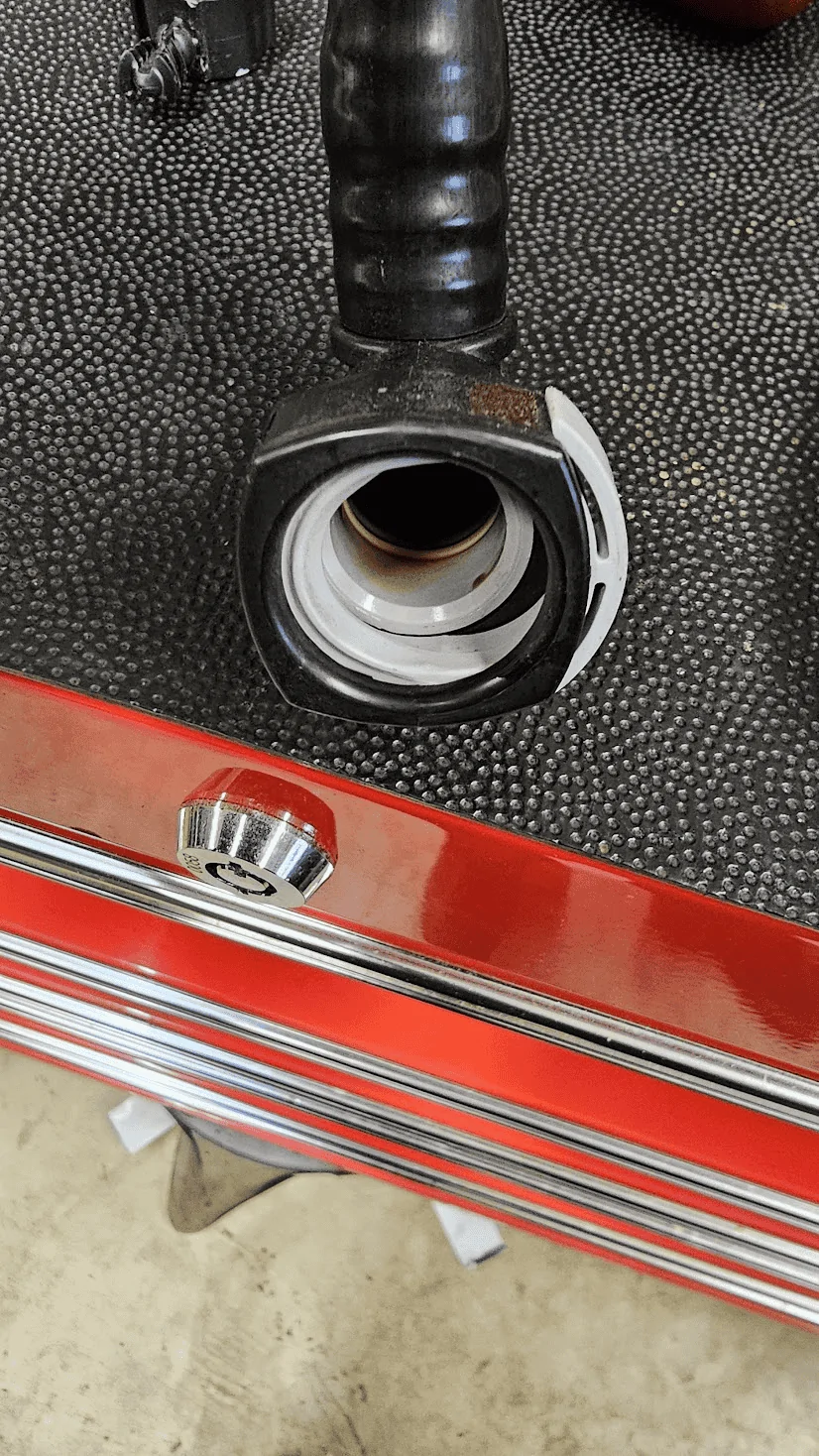

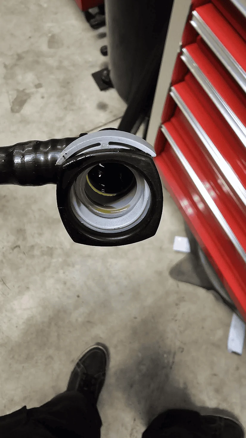

Also, not really easy to see, but here are 2 pics of the OE PCV hose from both ends. I have just a hair under 24k on my odometer:
I had the same, it was loaded with oil, did you change your Pcv valve
I did not. Wanted to see how the catch can performed on its own. If I changed both it wouldn't be a good comparison.
Plus I was too lazy to do the PCV ?

No. That was my photo. I did consider using that bolt though, and I still may move it when I install the allen screws I ordered to replace the stock Philips head screws they supplied.
I can't stand a Phillips head.
