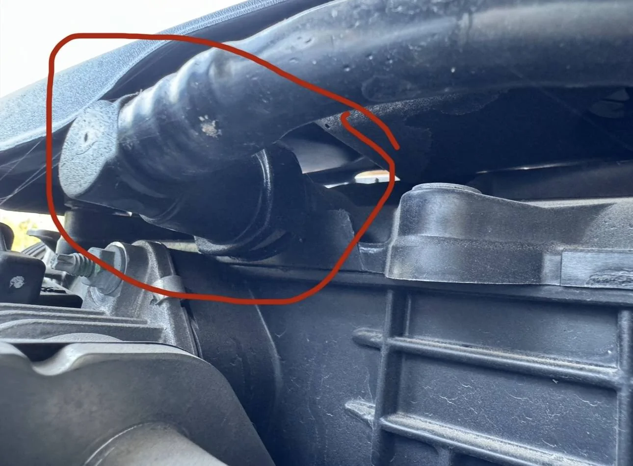

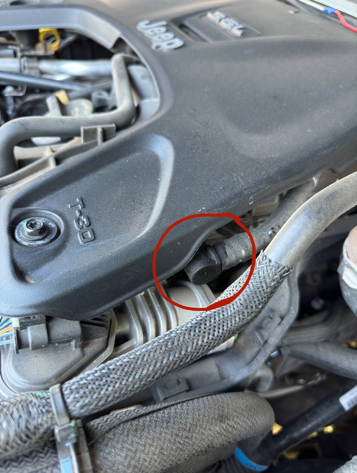

I’ve got what looks like a leak coming from where that #3 hose connects to the intake. Is there an o-ring there that I could replace? Hard to tell from that parts diagram.

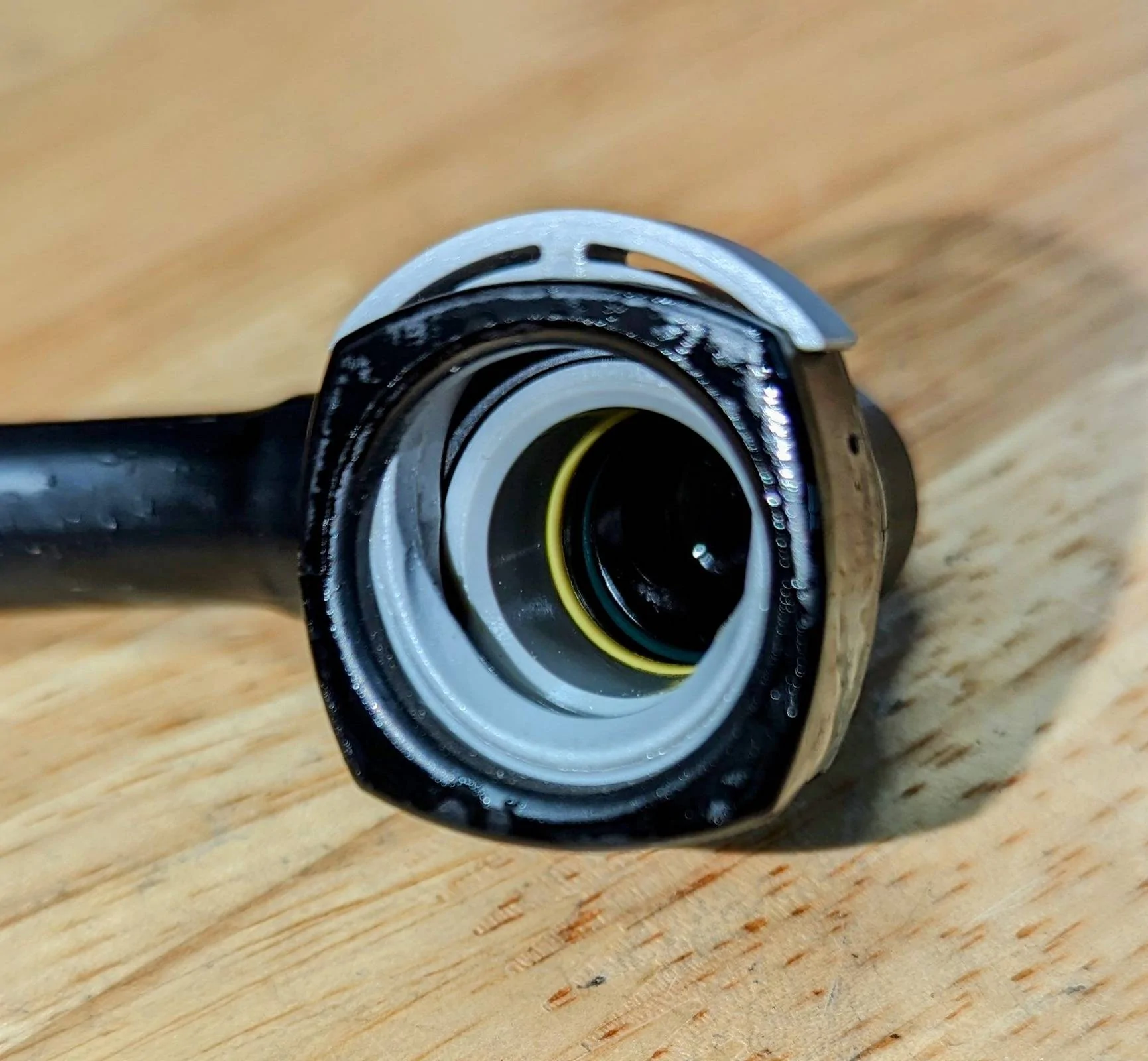

Pretty sure you have to buy a new hose to get the o-rings. Only separate o-ring replacement I have ever found for the PCV system is for the PCV valve itself.
or bring it here and I'll go through my assortment of o-rings I've collected over the years from transmission kits and so on.
One thing that could be tried is to remove the fitting, clean everything thoroughly and insert it back in place with a bit of the MOPAR RTV on the o-ring and let it sit several hours to cure.
Looks like a very slight seepage over time. Takes only a part of a drop of oil to cover an area several times that large.
The ones I have seen remind me of AC line o-rings. Sure there is a common size out there, just trying to figure out which one it is.

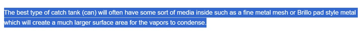

The idea of the most simple/cheap type is to provide a large chamber where the velocity of the air is slowed to the point it can no longer hold the oil or other vapors, and it "condenses" in the cooler, slower air movement area.
And the best also have a filter - it's a whole lot like the system AMC used - with some small success - in that the air went into a chamber in the bottom of the intake manifold where there was a brillo type of mesh that was supposed to catch the oil and let it connect and drop back down into the valley.
Trust me - leave off that baffle or leave that mesh out from the bottom of the intake manifold on those and you'll be sorry.
