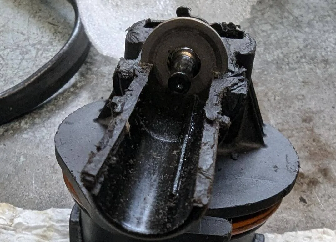

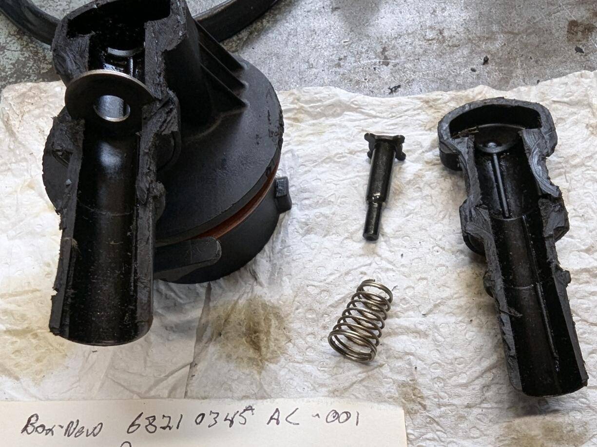

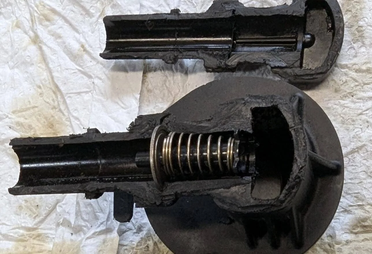

All you can check is that it's not sticking inside.
Jeep Gladiator Pcv valve 1743547584240-ai
Jeep Gladiator Pcv valve 1743547704245-g
This pic shows the part number of the one I took apart -

I swapped out for the newer design. I was already in the engine doing a spark plugs change. Can't say if it's better or not. But 100k miles maintenance and a few extra $$ to get a new one didn't hurt.

Would you break into a new one so we all can see the difference., maybe test the spring strength and tension on both. You’d earn a special star that only you could get if you did that.

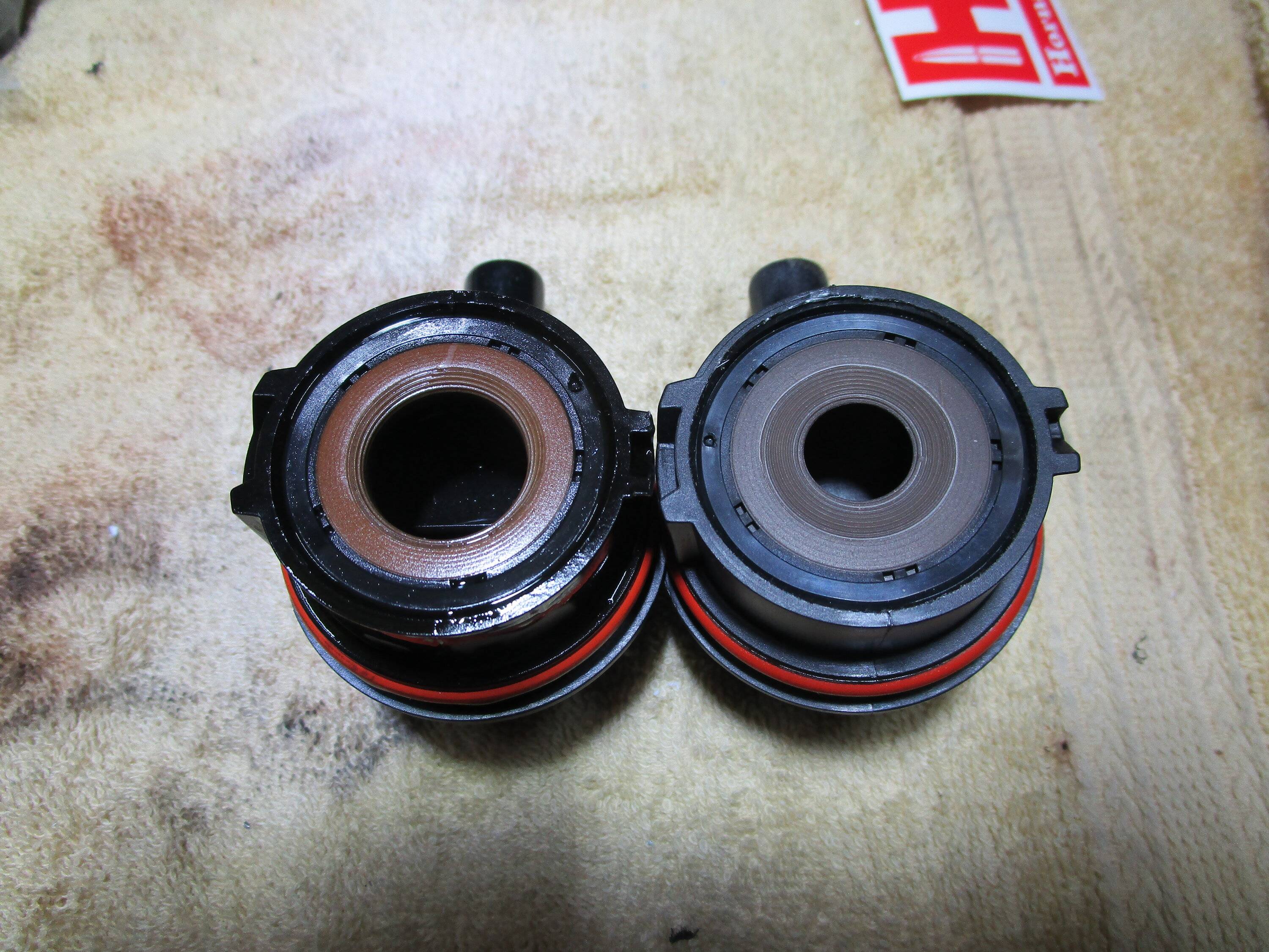

Was it ever determined when Jeep switched to the "new" design PCV?
