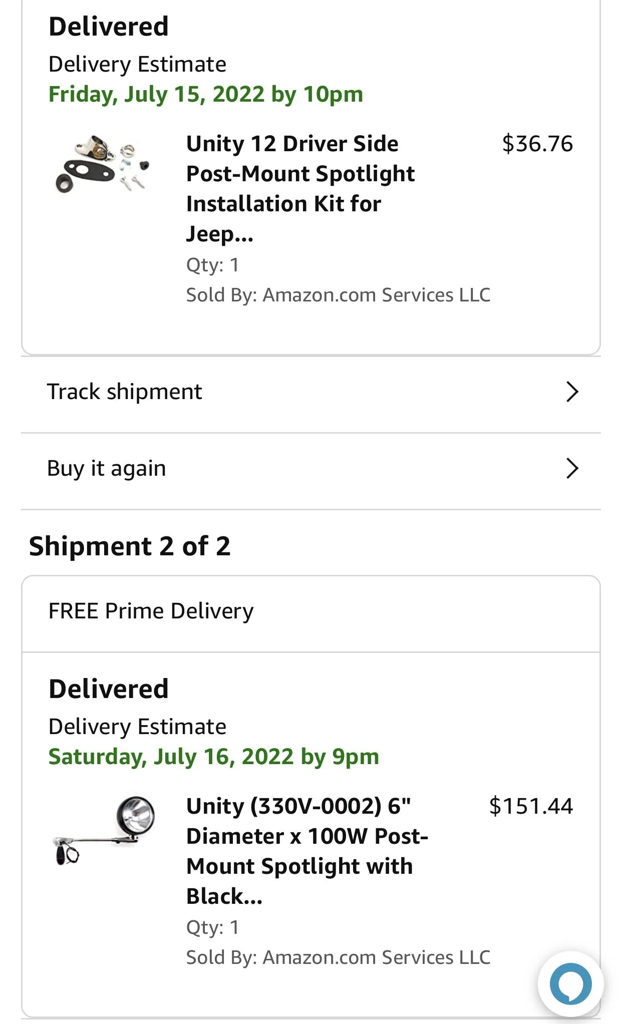

So after going back and forth doing some research and seeing if it’s possible, I’ve decided to take the risk and attempt to DIY the unity spotlight for the JK onto my JT. I have purchased a unity spotlight and the mounting kit for a JK. I know it will require some careful measurements and drilling into the driver side A pillar but I think it will be worth the risks. Hopefully it turns out well! More updates to come!
Did you get it installed?
Phan7omk7
Phan7omk7
Jul 31, 2020
39
80
Santa Clarita
Jeep Gladiator Overland
Engineer
Unfortunately no, I contacted the manufacturer of the spot light and was advised not to do it. It would involve drilling into the roll bar on the Gladiator and would be a safety risk.
