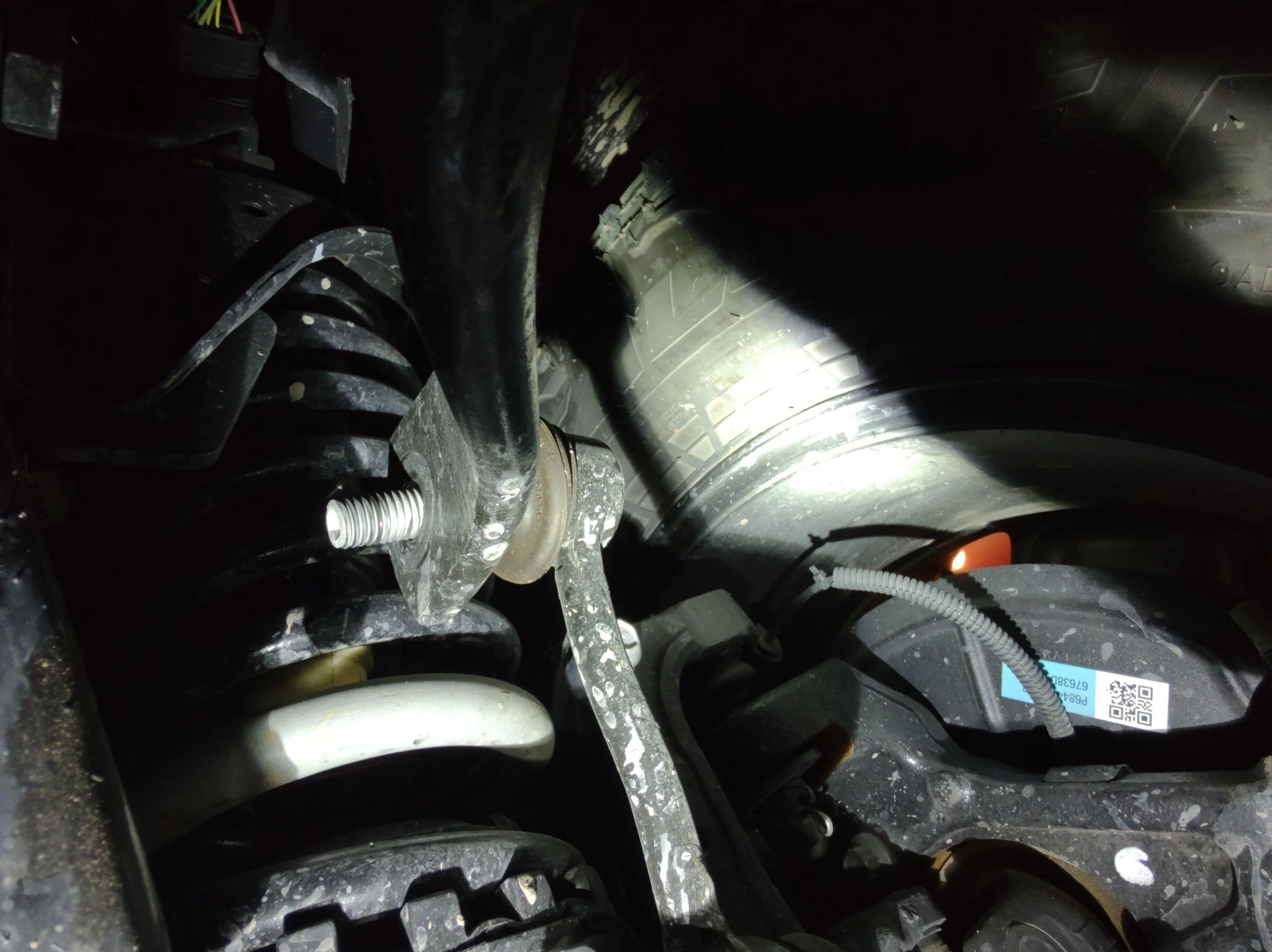

I lost one of the nuts on mine lat week on a trail after that every time.i hit a bump I heard a clunk. Found it went to dealer. Under warranty. Will be fixed this week I hope.
no need to go to the dealer, its a m12- 1.75 hex nut. you will need a washer to match. home depot has them both. make sure its stainless so it doesnt rust
Threads are trashed. Under warranty. I'll let the dealer deal with it. But thanks for the heads up.
