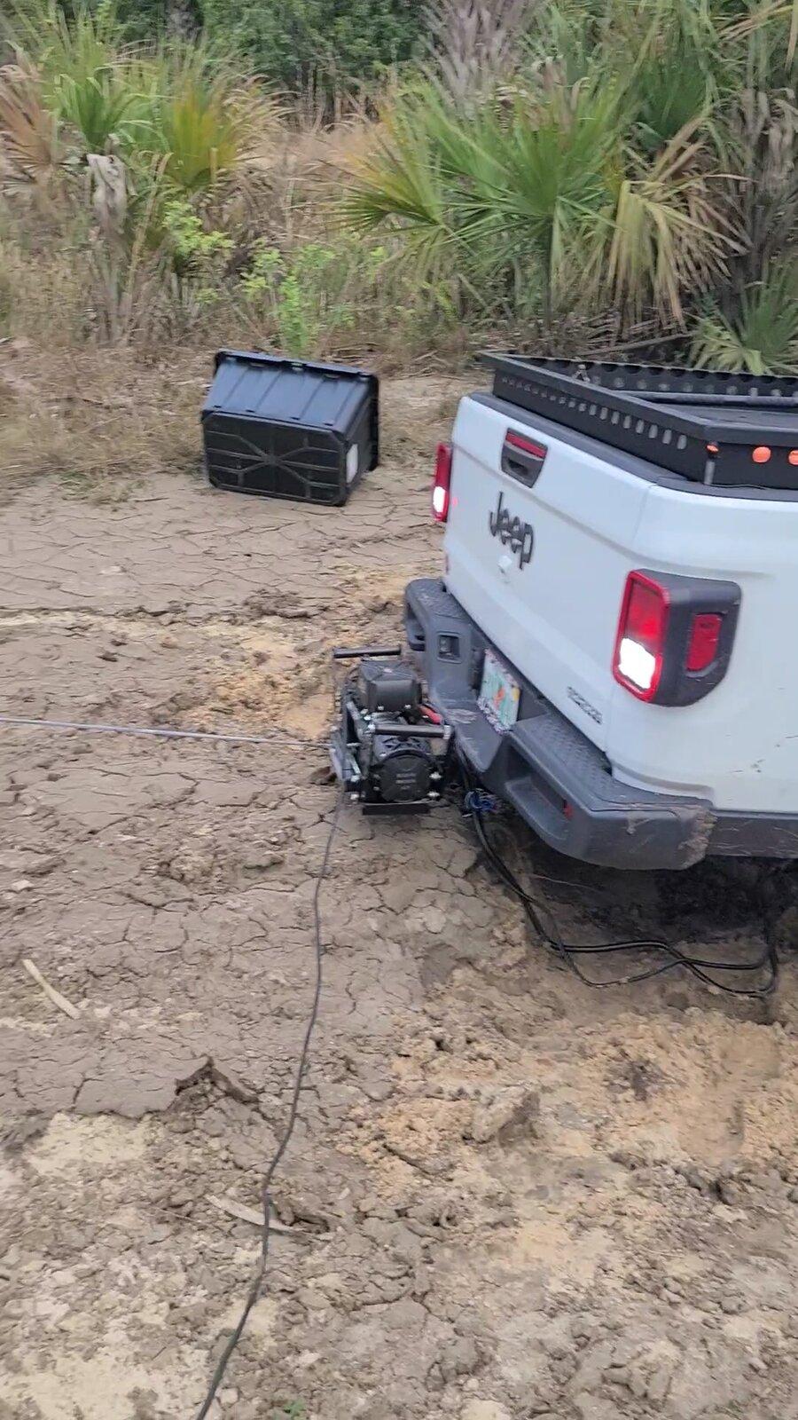

You do have to drill some holes and install some nutzerts, but after I figured out how to do it, it wasn't too difficult. I didn't follow their template for the holes in the plastic cover, they were fairly big. I measured and made them just big enough to fit.
There's some pictures here. https://www.allmoparparts.com/sku/82215428.html
This is a picture from when I installed it.
