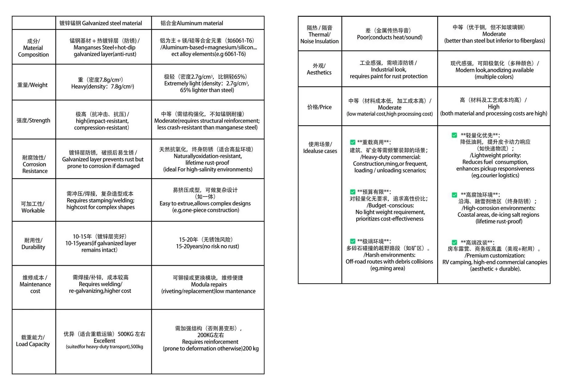

If those were dynamic weight limits, then the static would be 2 or 3 times higher.
But if that was static, then the dynamic would be awfully low.
Static, sitting still.
Dynamic, traveling down the road.
I assumed they are static as it was phrased as “load capacity”, so for a truck bed rack if it’s a 1100 lb static load I roughly figure a 660 lb dynamic load which I’m good with.
The 480 lb static would only give around 160 - 240 dynamic which is awfully low, I agree.
Hence why I’m not taking the risk on aluminum and going for the steel as I want it to be load bearing and not just a “canopy”.
Here is the comparison sheet they provided me:
Jeep Gladiator Possible group buy cap opportunity? IMG_1756

As an FYI, these below are the prices for steel caps. Type 1 is solid doors. Type 2 is solid doors with one of the three types of exterior panels, and Type 3 is with windows.
I'm doing the Type 1 in steel for the same reasons as @Cattywumpuss wrote above. A RTT, especially a larger one is going to be at the limit of the static weight on the aluminum.
