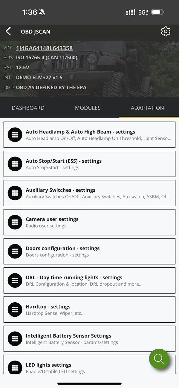

Here are screenshots for JScan under Adaptations

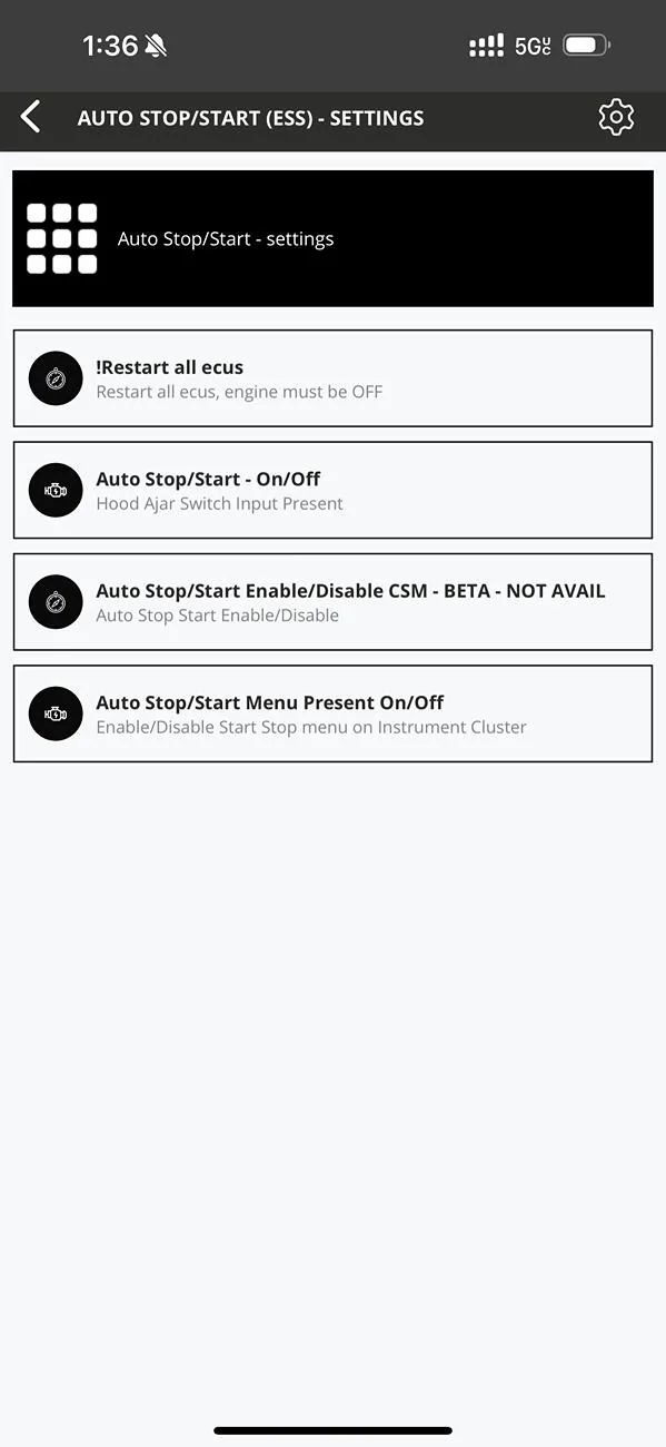

I think you’re supposed to disable ESS when deleting aux. I believe the aux is what powers your accessories while on ESS.
Wrong - BOTH batteries power everything the whole time.
No, you don't have to disable it.
The batteries are tied together, in parallel, during an ESS stop and are only separated for a split second during starter engagement for a restart.
Both power everything all the time, otherwise.
You can deactivate ESS with JScan?!
Everything I read said I need the other tool, could you elaborate please?
No, it doesn't really work. I wish JSCAN would remove that because it kills other things if you try to use it. IT was a test that failed and was never removed from what I read on the JSCAN FB pages.
There is a module where you can activate or deactivate the ESS. At least my JScan did!
Doesn't really work unless you want remote start, etc. disabled.
Go buy an autostop/start eliminator device or whatever, don't bother with jscan.
