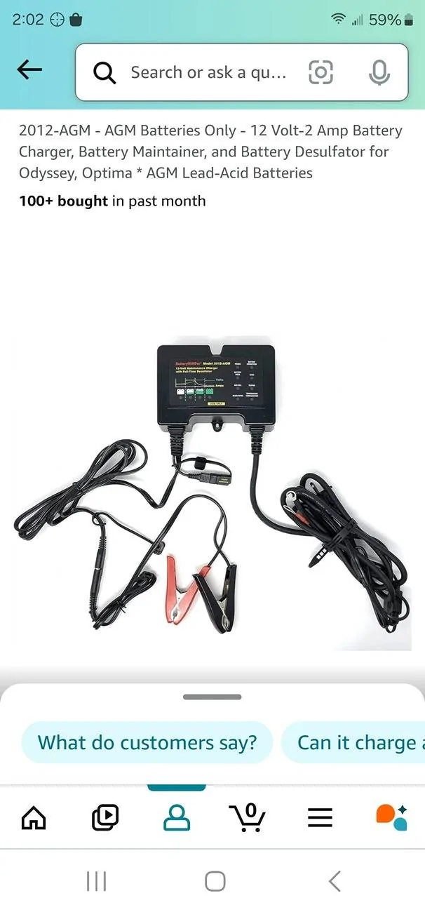

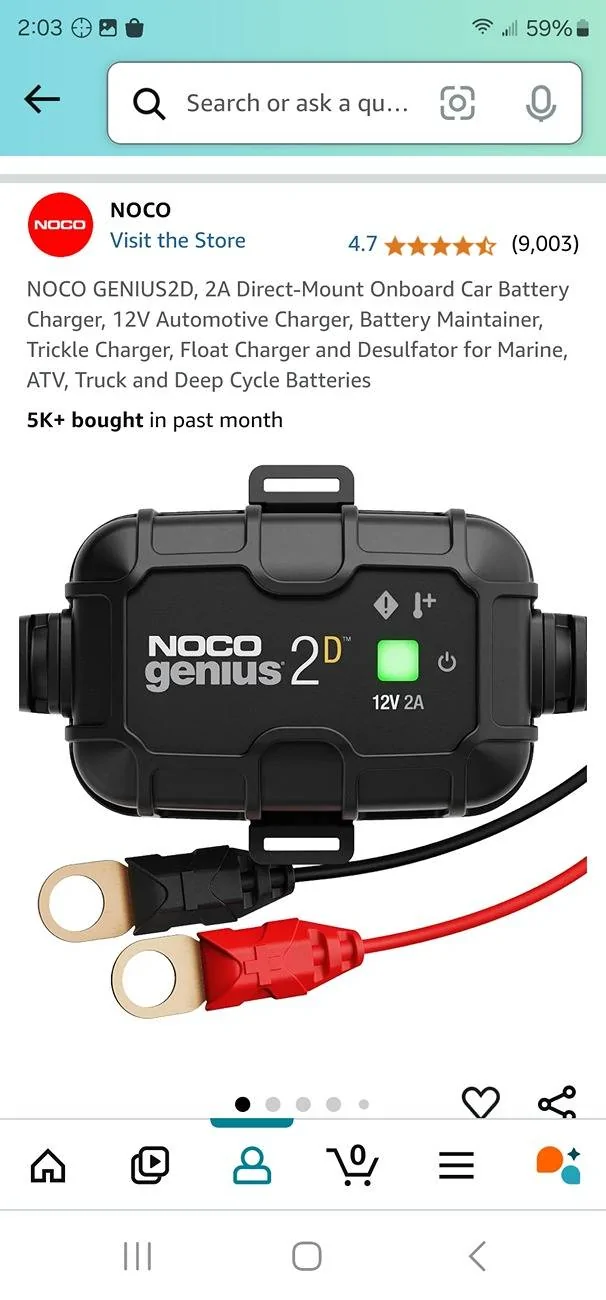

This is great info, thank you. The tech at Autozone certainly didn't disconnect the two cables at the main negative post when he "tested" the battery and told me it was fine. Wondering if there is an affordable AGM charger you would recommend.

The NOCO above is what I have permanently installed in all of my AGM vehicles.
The Battery minder will give you a better idea of the condition of your battery, but not so much on load capacity. I use this to charge a battery before I install it.

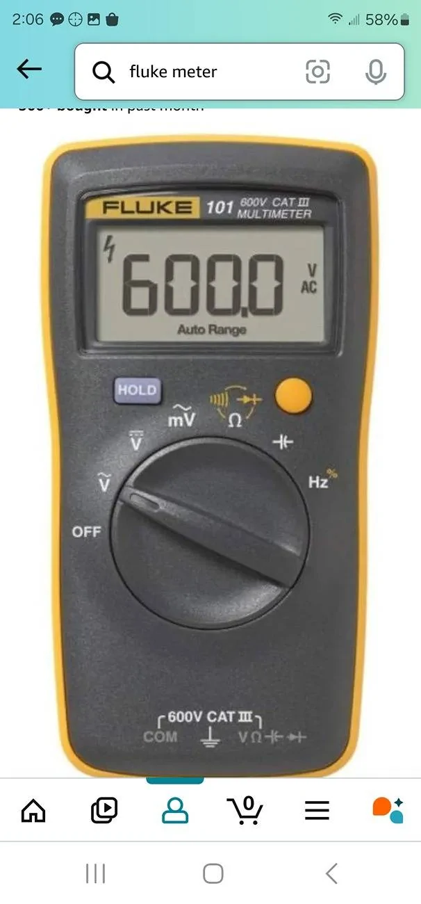

The Fluke meter is what I keep just about everywhere. It is accurate and is great for troubleshooting. At the time I bought mine they where only $40. I have one in several vehicles. You can use a cheap one, even HF Centech meters. They don't seem to last long if you leave then in the vehicle. I think moisture, cold and heat play hell with them. No issues with the Fluke leaving in the vehicle. Except, they disappear when someone uses it. HF meters tend to make it back.
