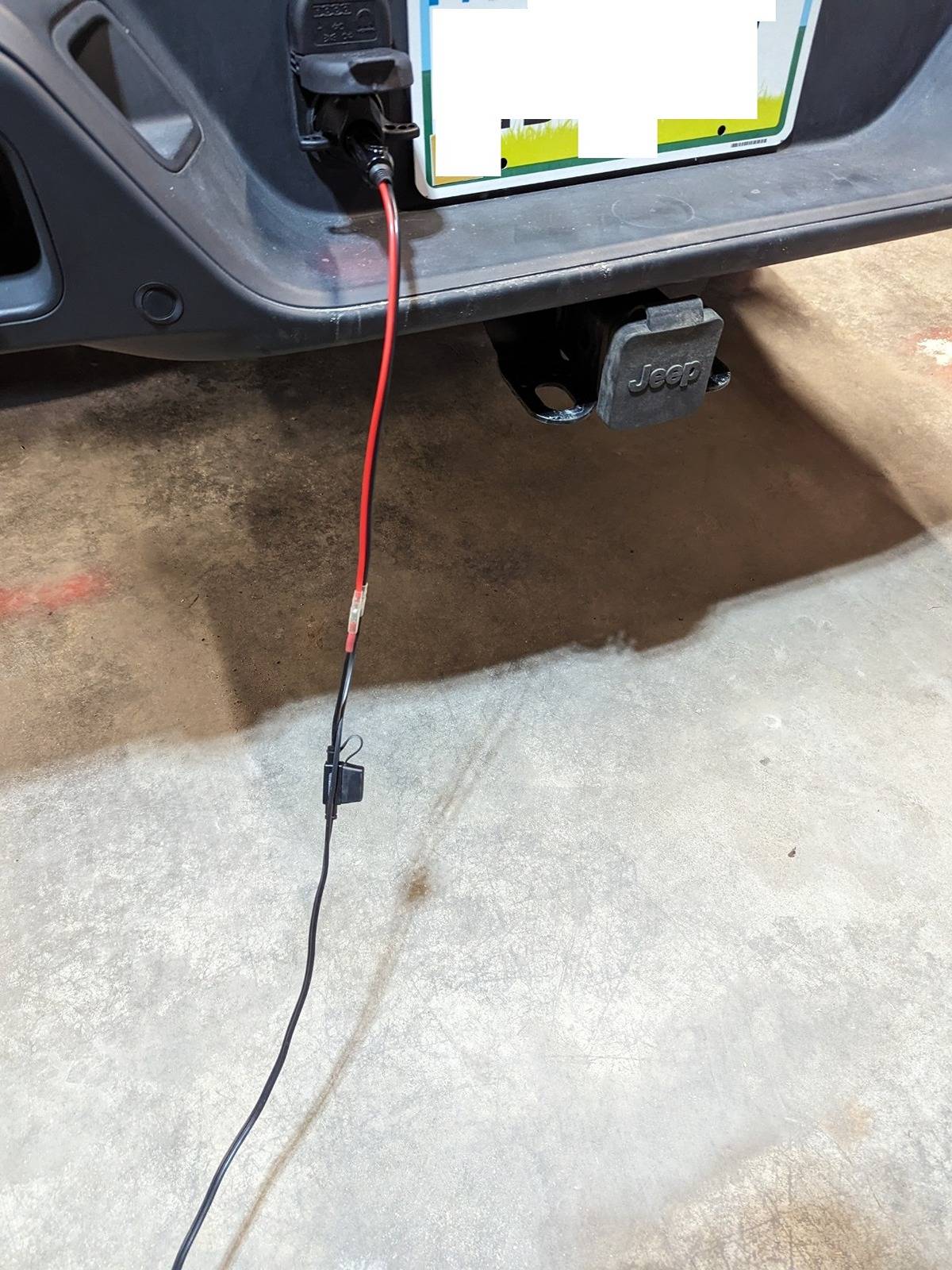

Another option is a plug-in maintainer, but then you have to connect it every night and remember to unplug it before leaving.
Not really if you plug into the trailer connector - I forgot the other day and it simply slid apart, hurting nothing. CRAP. Nothing harmed, worked as I'd hoped. Pulled out of the trailer plug to 12v outlet adapter and dropped to the garage floor.

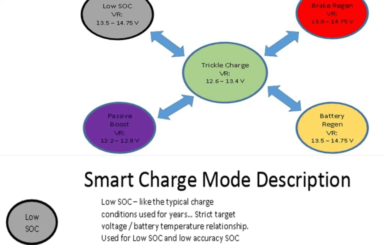

On a normally operating system, you'll see anything from 12.6 (if the batteries are hot and/or fully charged) to 15.0 (cold weather, batteries not fully charged) and anything in between.
On a system where the batteries are at full state of charge and the IBS is up to snuff, you'll see lower voltages as the system adjusts to battery state of charge, temperatures and engine load.
