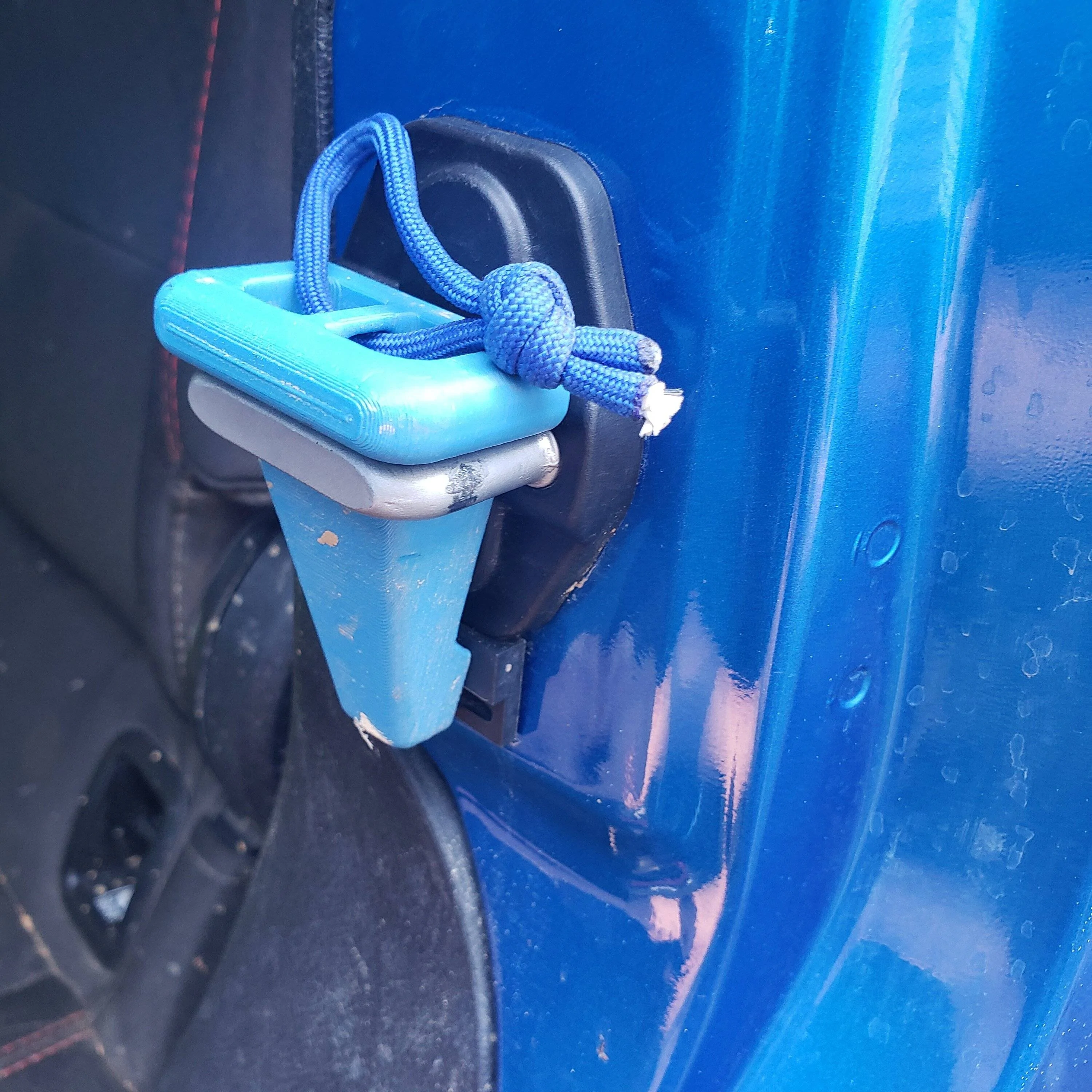

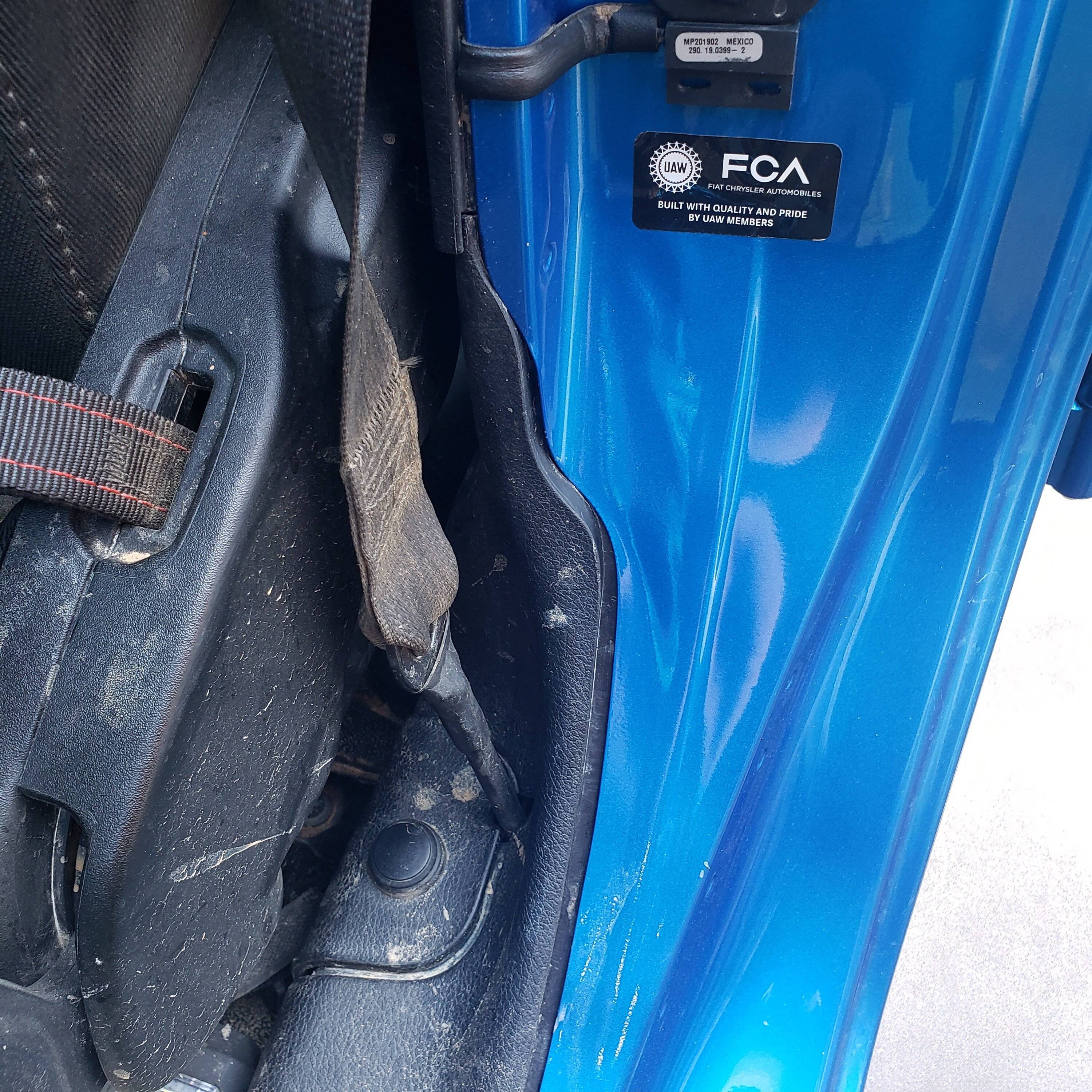

Would you have any pictures?
Interior is still a little dirty from last weekends Uwharrie trip.
First is of the 3d printed magnet holder I designed. Second is the RSE switch I put in the removable sill panel by the seat belt.
I really like those magnets you made. How do they hold up on the road? or off road for that matter?
I have had no problem with them either on or offroad.
I glued 2 magnets in each one. One for the switch and one against the metal latch itself.
That's exactly what I'd do - set a magnet over the magnetic switch. So easy it's silly.
A magnet to keep the other from bouncing out of the striker.
Any means of holding a magnet near the switch will work.
