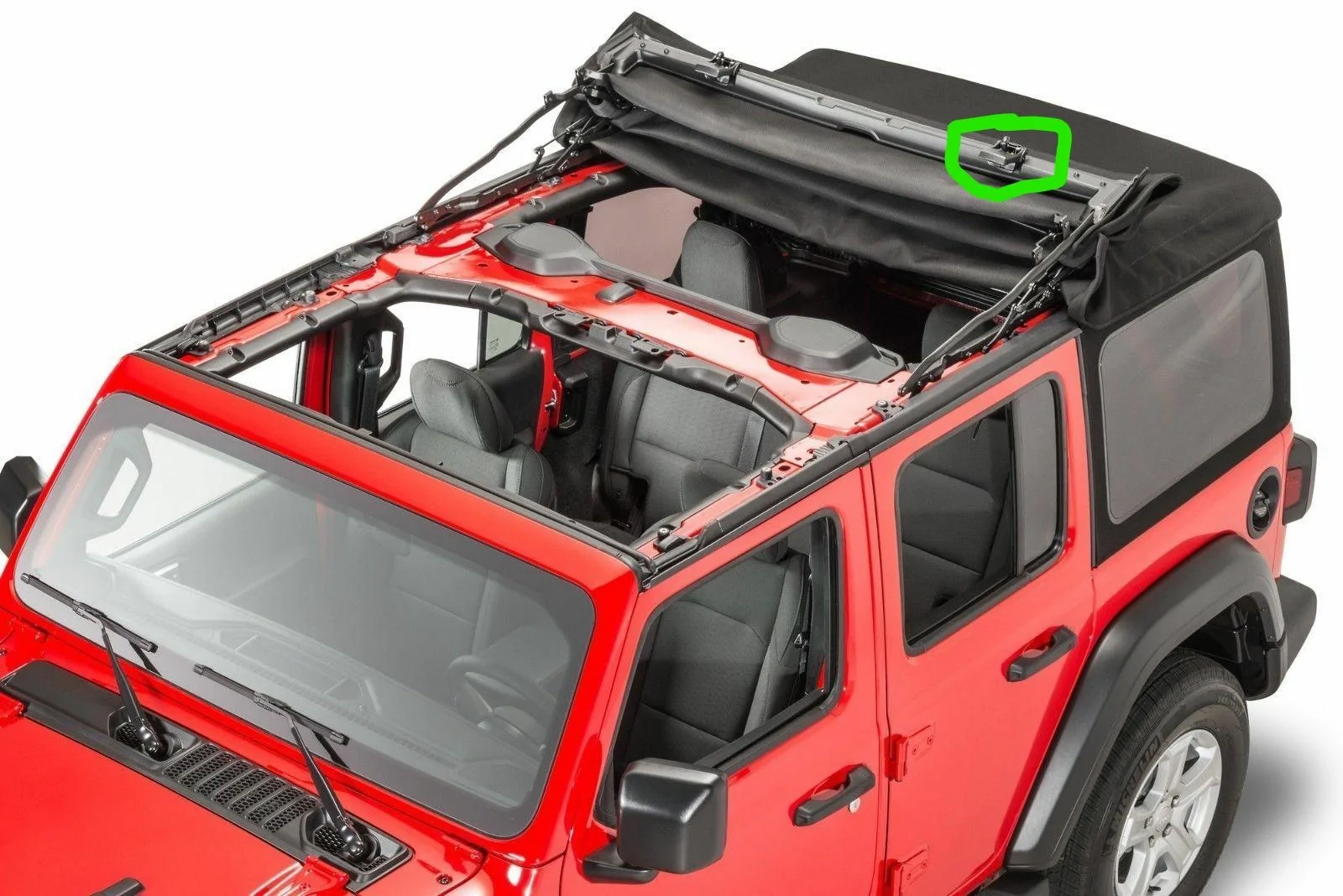

i had the same problem unlock the latch and you will see two screws holding the lock to adjust lessen screws move latch towards the back bumper (when roof is closed) and tighten screws took me 3 trys and 20 minutes to get the same tension on both side (pic to show lock)

Thank you for the fix. JEEP also tried, supposedly, an adjustment, possibly the one you suggested, Through JEEP, however, there is actually a FIX or Service Notice, supposedly. At least I was told. Regardless, they replaced both locks after trying to fix one with little success. I have not had a problem since the new locks were installed only a couple of weeks ago. Stay safe.
