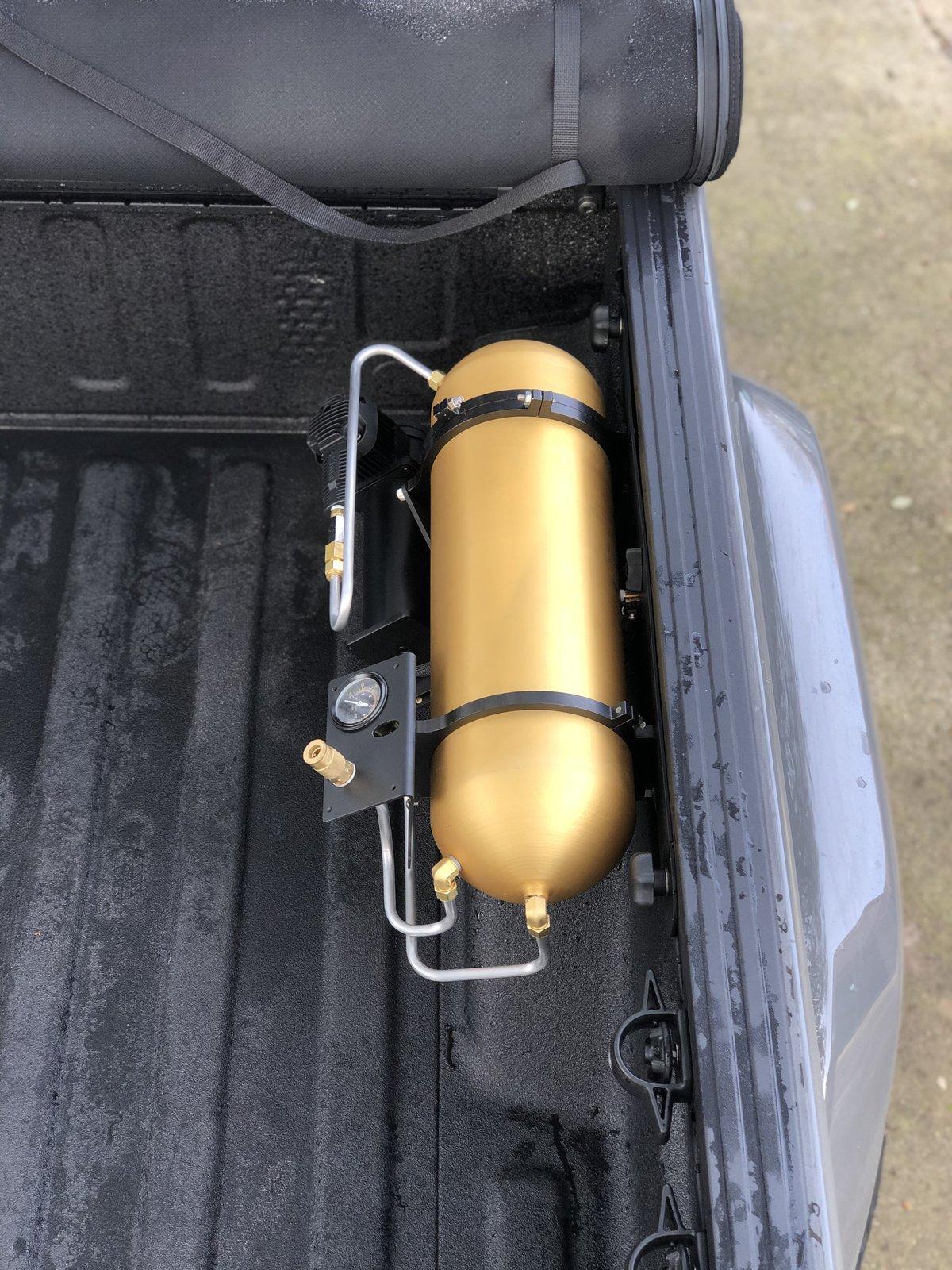

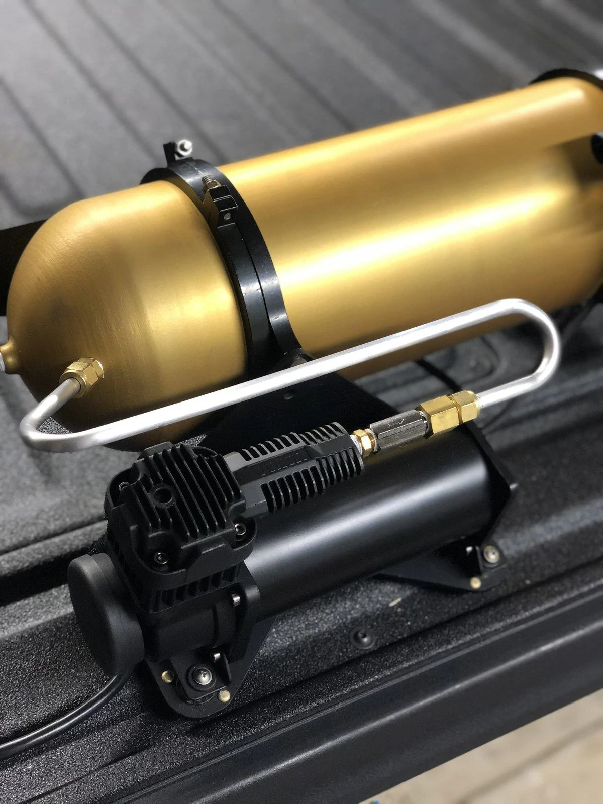

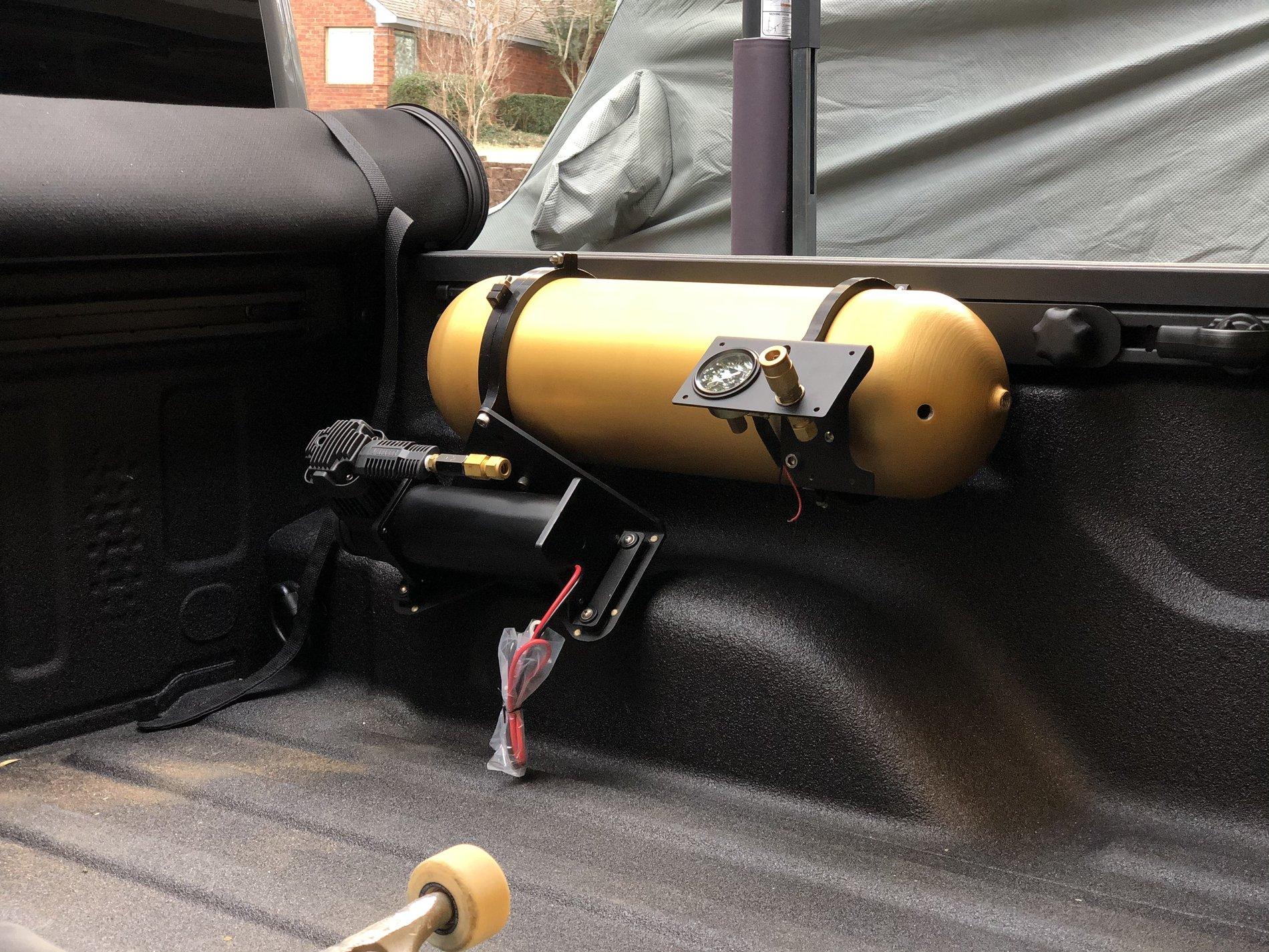

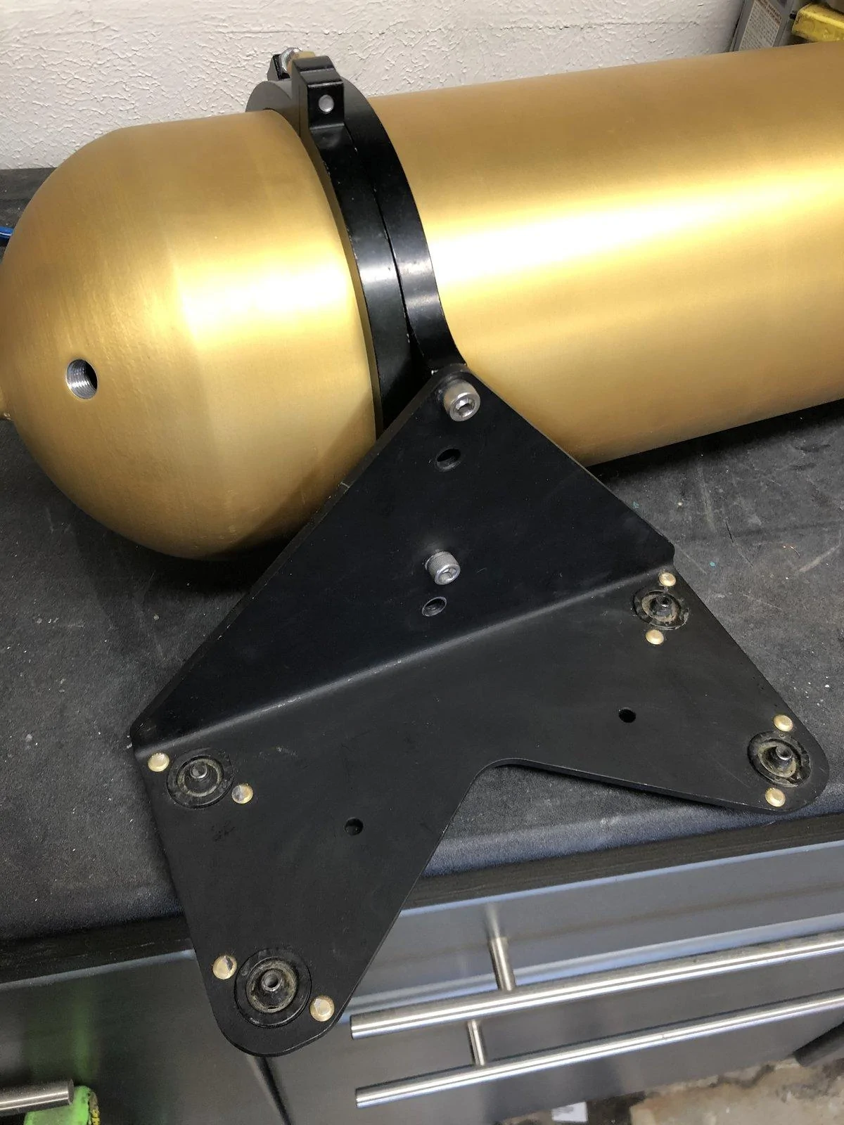

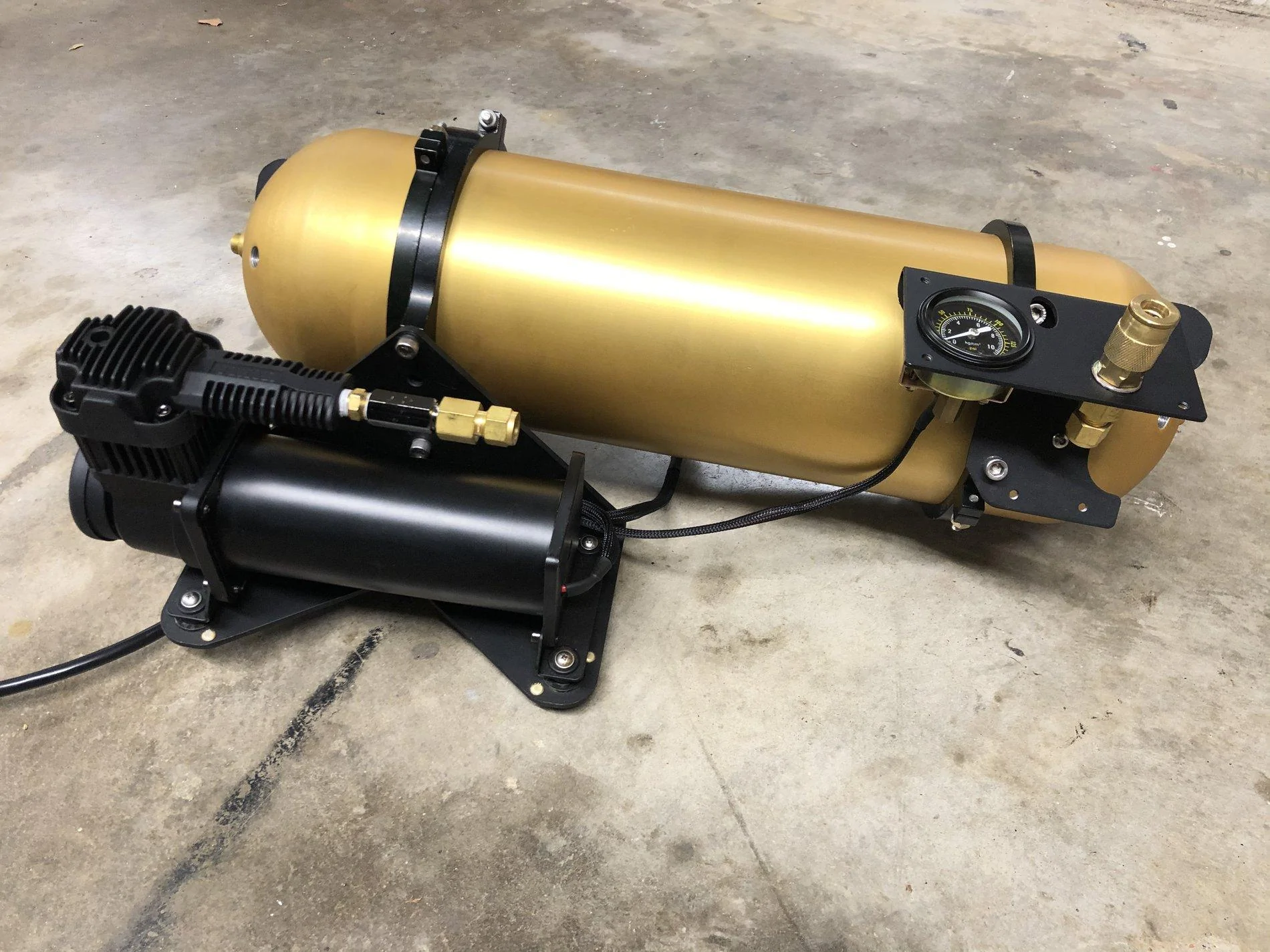

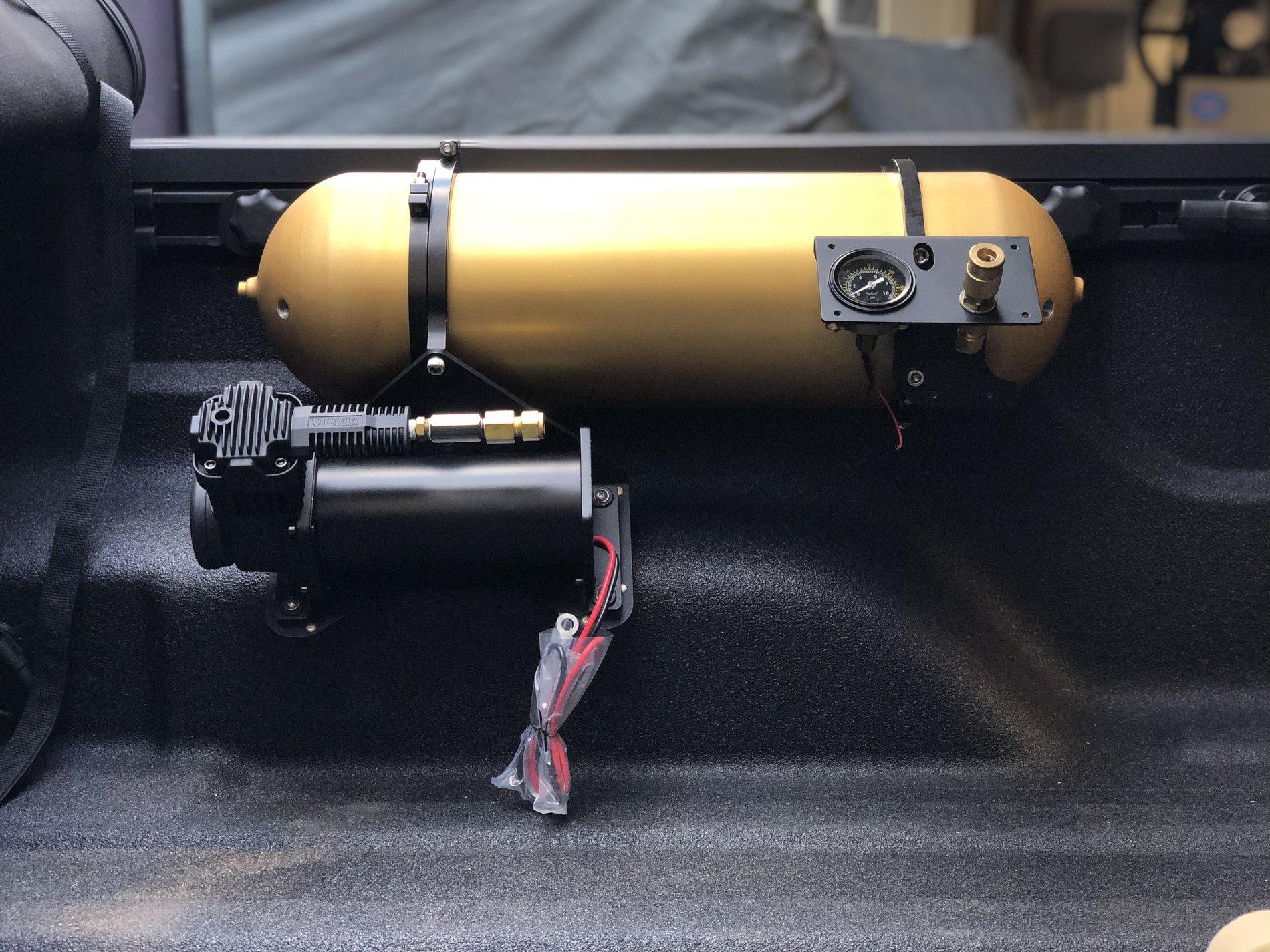

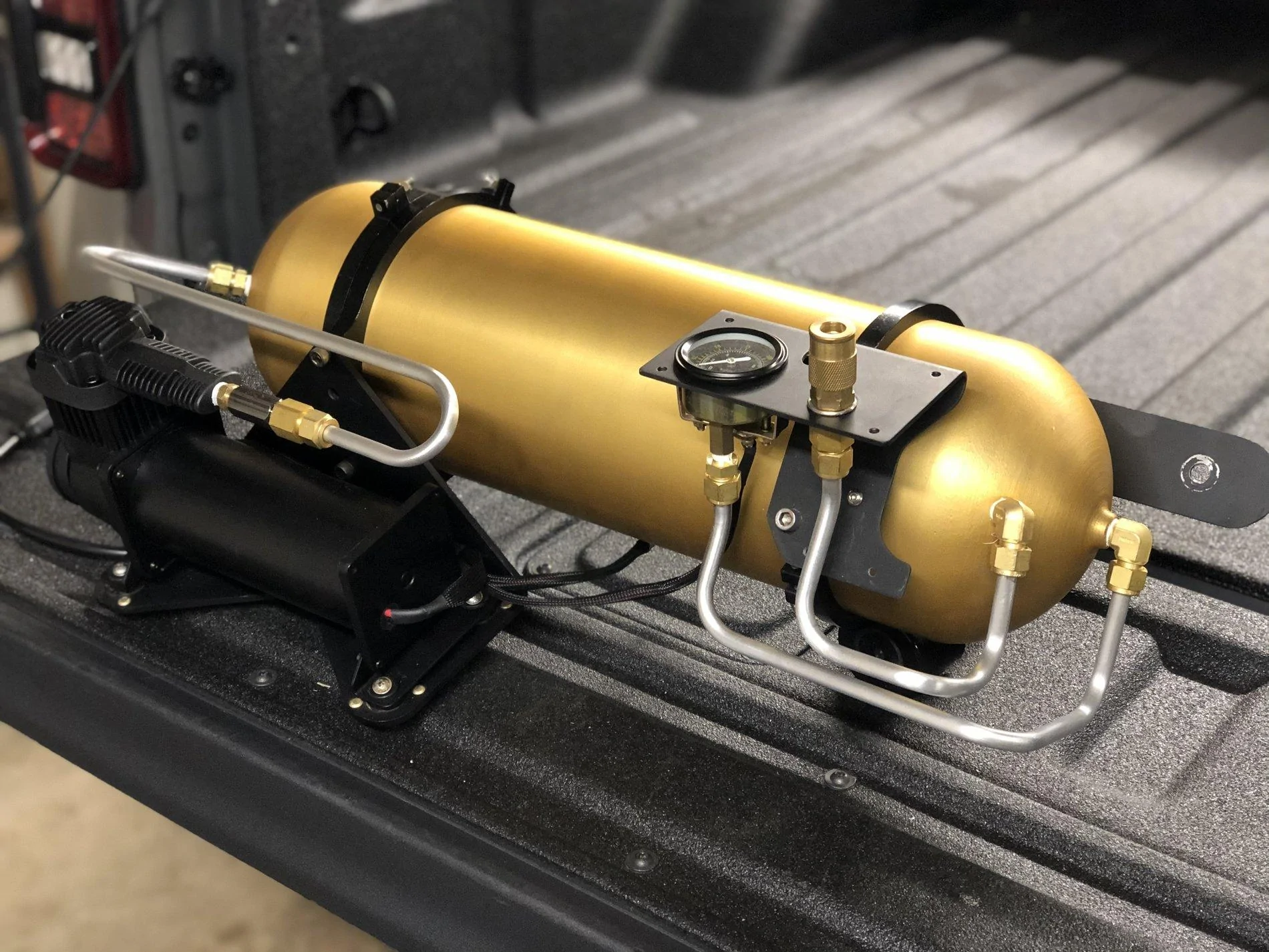

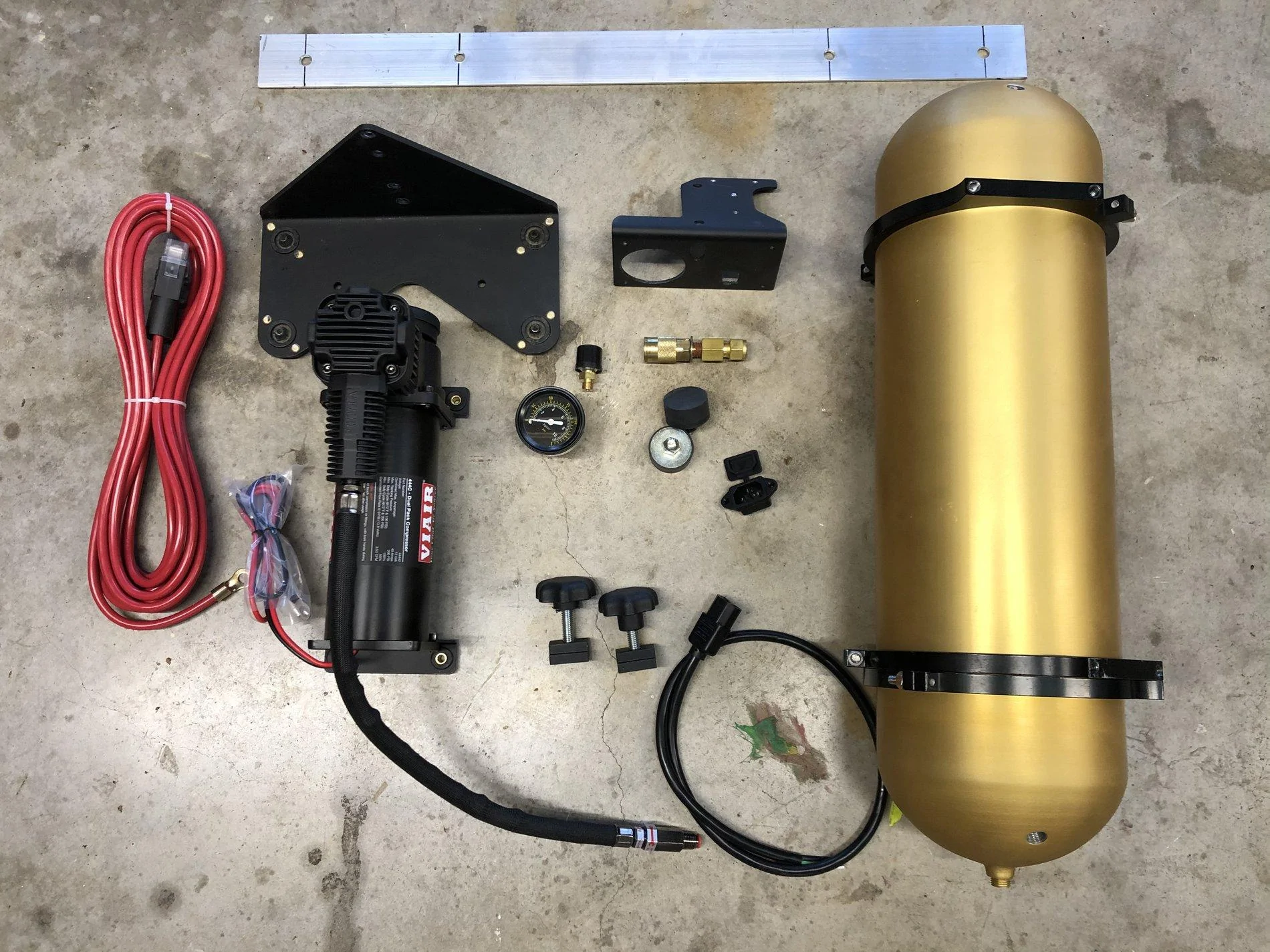

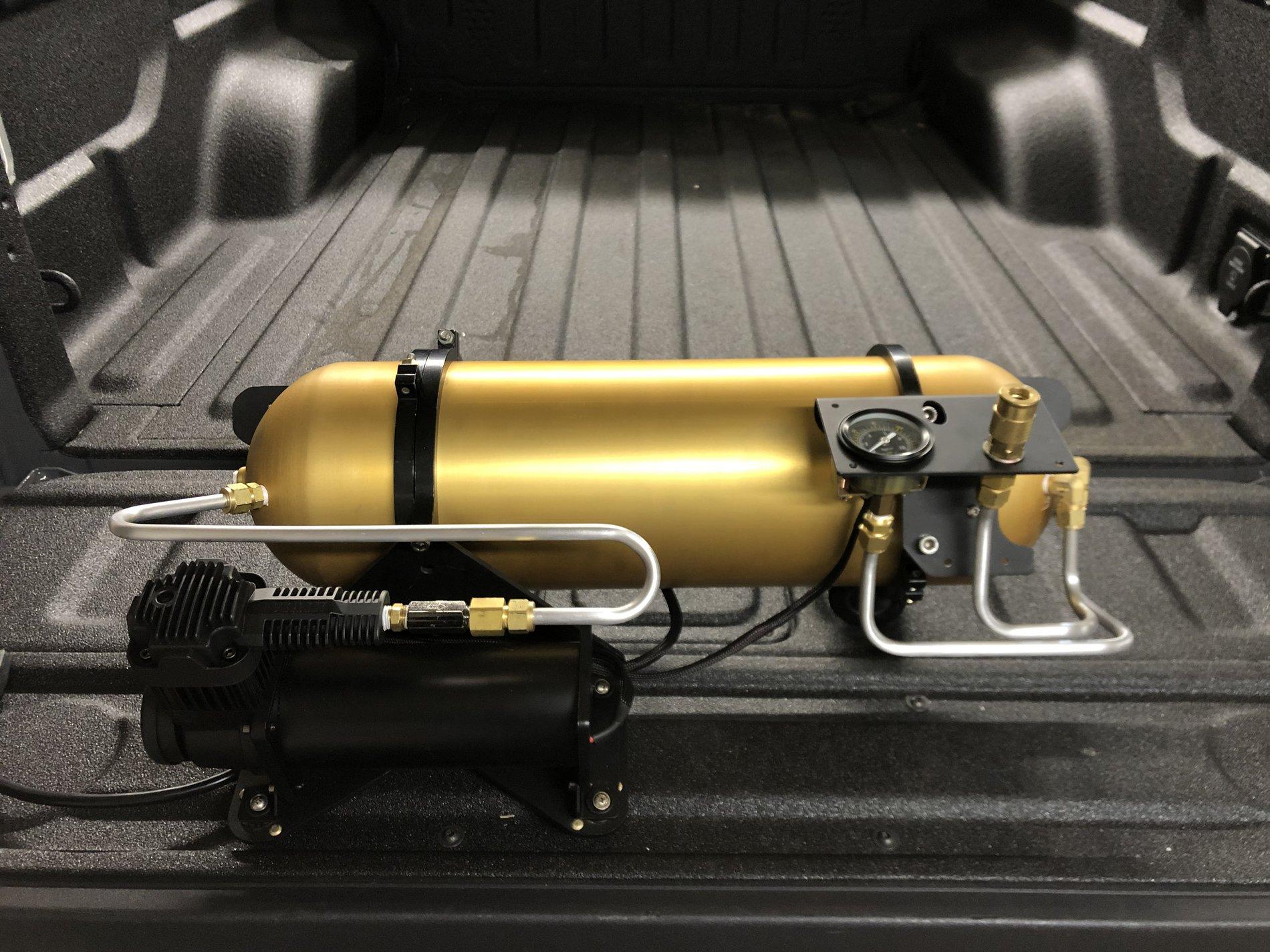

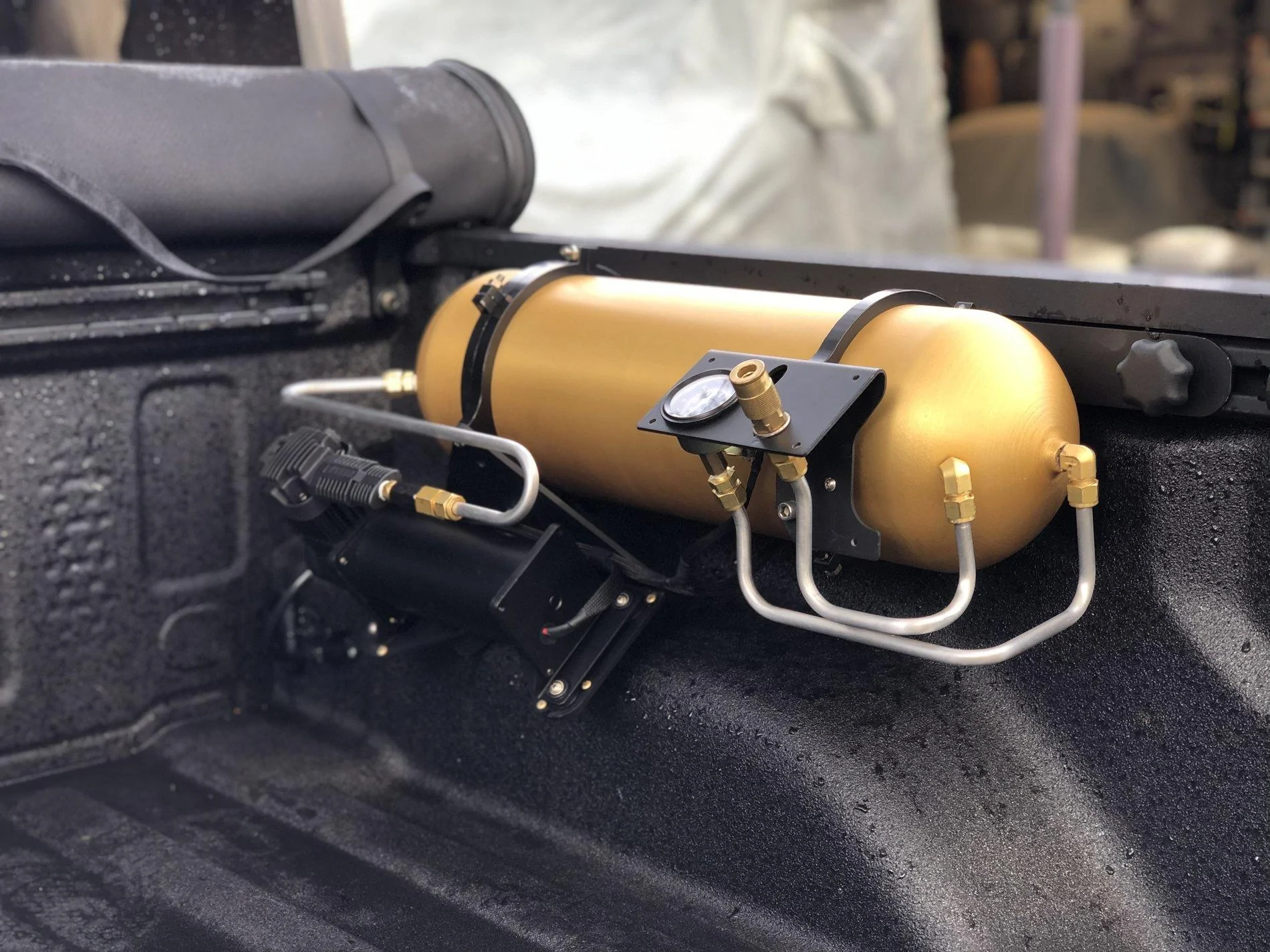

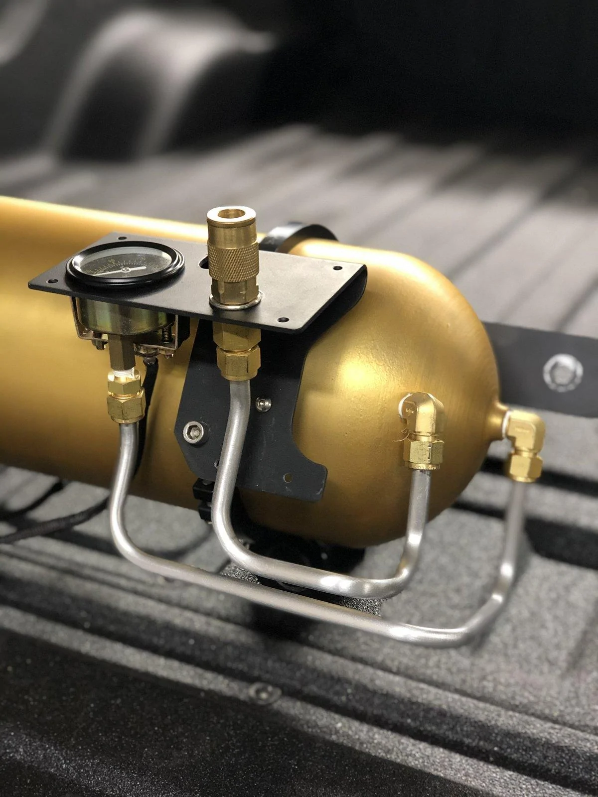

Working on my On Board Air system using some items I've had for a bit. I wanted something removable and portable when needed.
using a 4 gallon seamless tank with a Viair 444 compressor.
Just waiting on the Swagelok fittings to come in so I can wrap it up.
Jeep Gladiator Project “Fools Gold” DD217D7A-9F85-4383-97AF-D7FCD38BDDEE

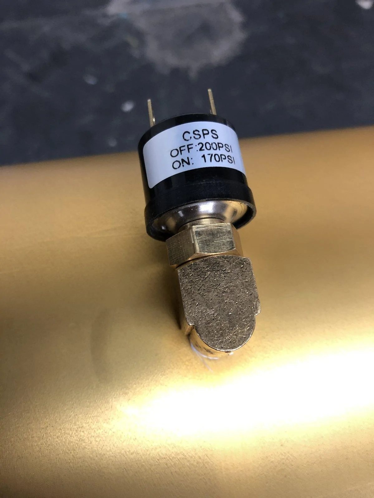

Using a 200 psi pressure switch. The Viair 444 has a max 200psi. 100psi 100% and at 200 50%.
Jeep Gladiator Project “Fools Gold” 899345D1-8F7E-4571-A7F1-39F522FA9351
Jeep Gladiator Project “Fools Gold” BECDC87A-D4F9-41F9-A336-D2203FE1D612

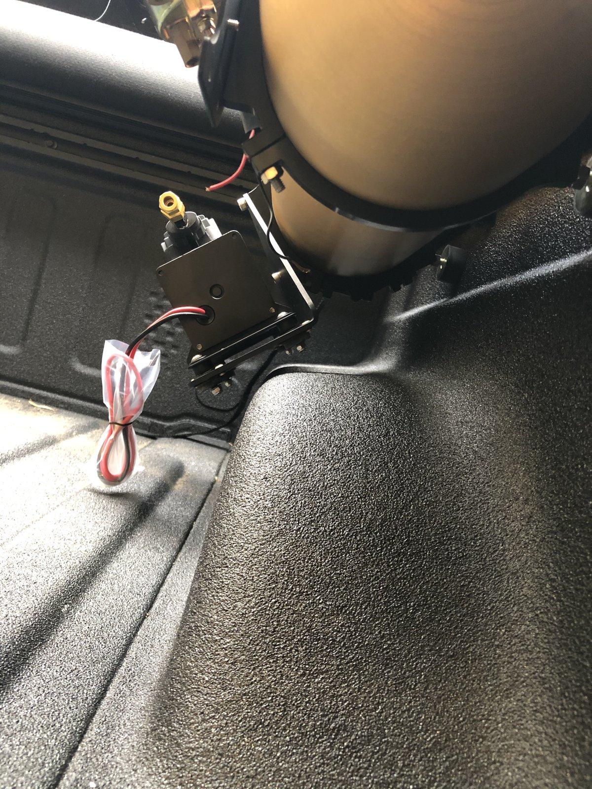

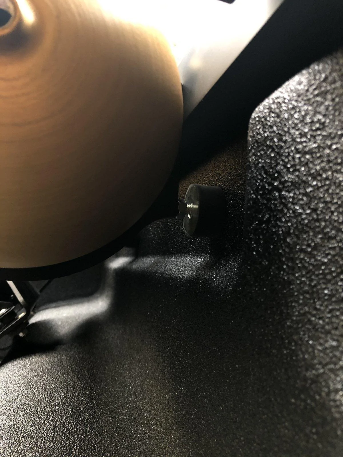

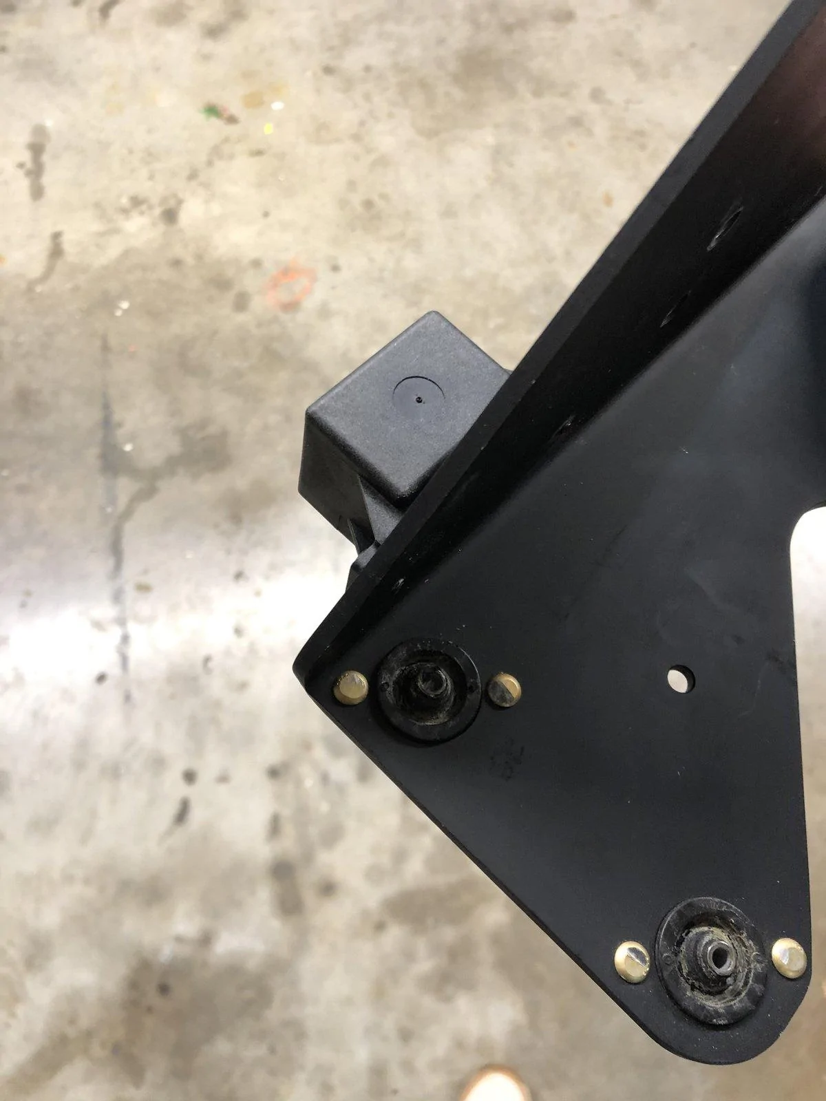

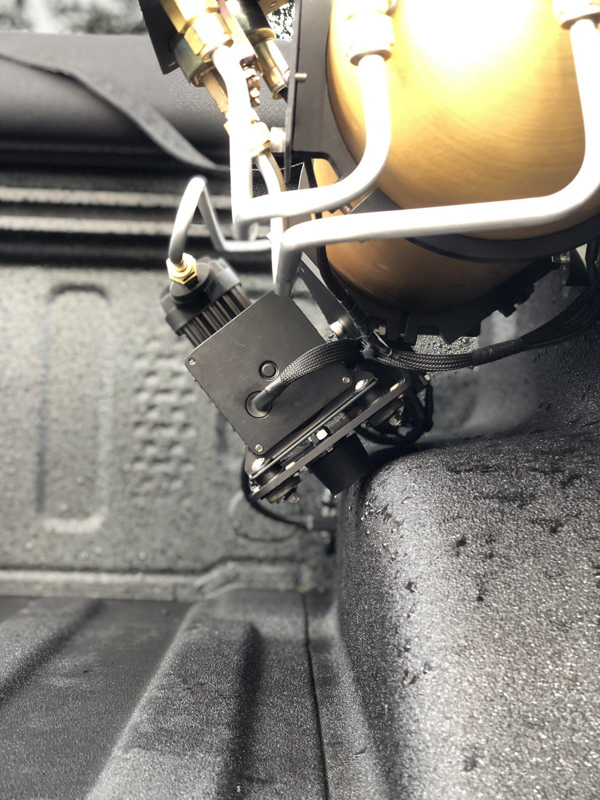

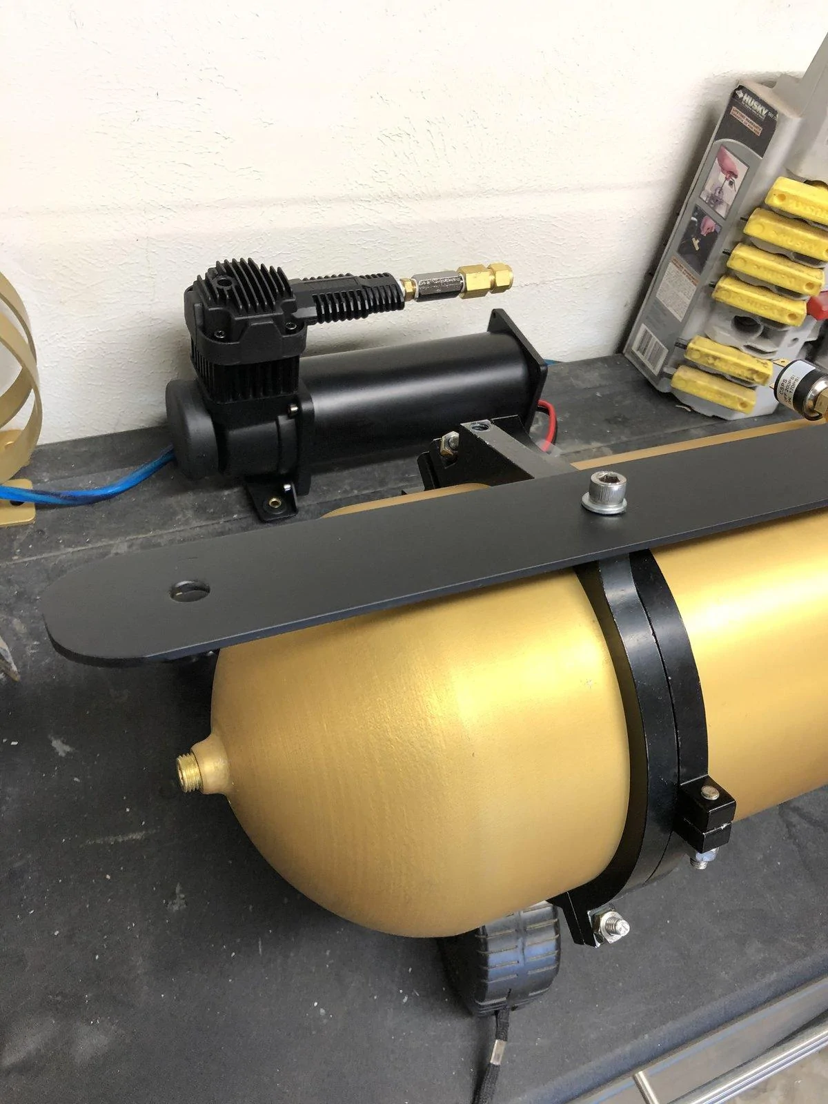

Compressor mount.
Jeep Gladiator Project “Fools Gold” F44876C1-69E5-4489-B63C-AB52D17598A2

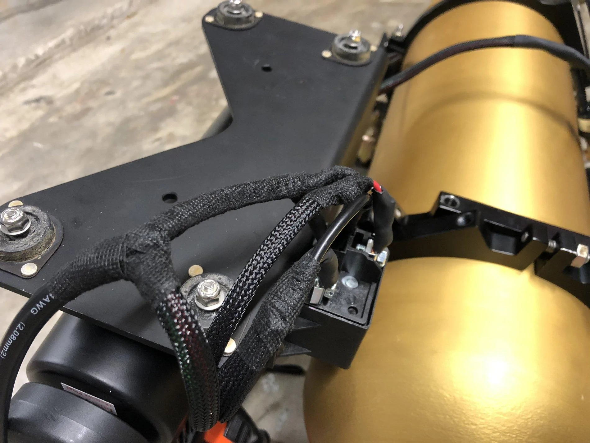

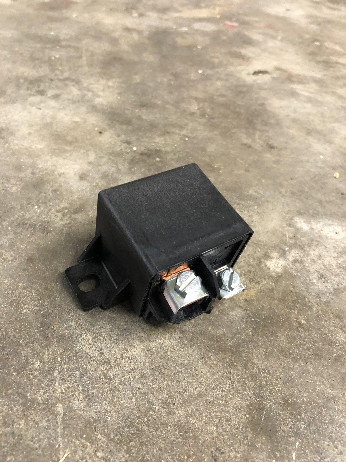

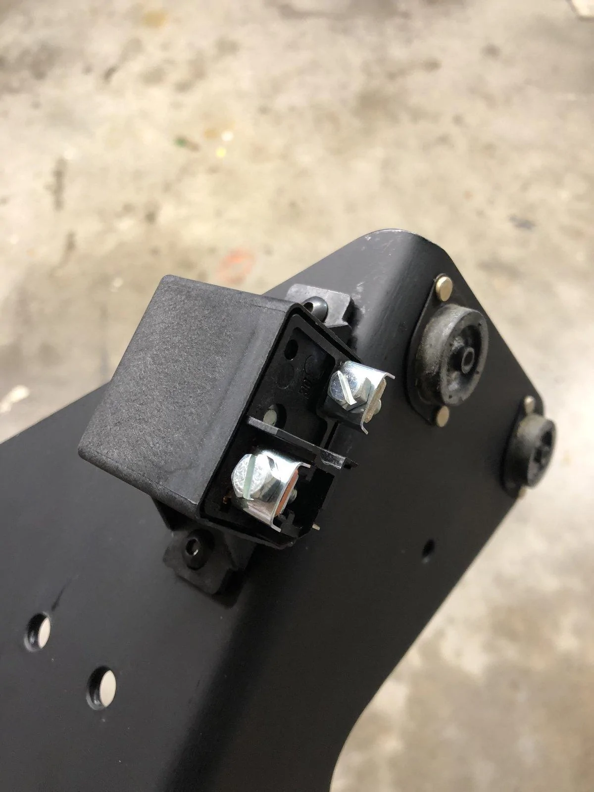

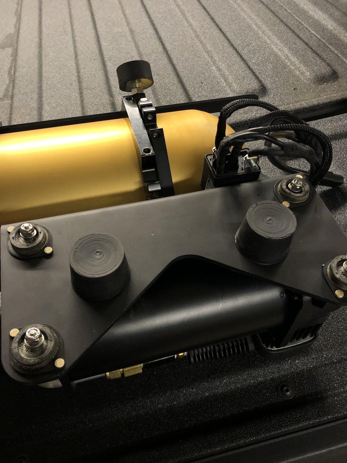

Relay mounted on the back of compressor mount.
Jeep Gladiator Project “Fools Gold” 6E095242-3F2D-4965-B271-753E967798FE
Jeep Gladiator Project “Fools Gold” AAAF8C8D-580E-48A0-81BC-23D7465E6353
Jeep Gladiator Project “Fools Gold” C486B4A9-B396-4C1D-B75F-DD5D07085D46

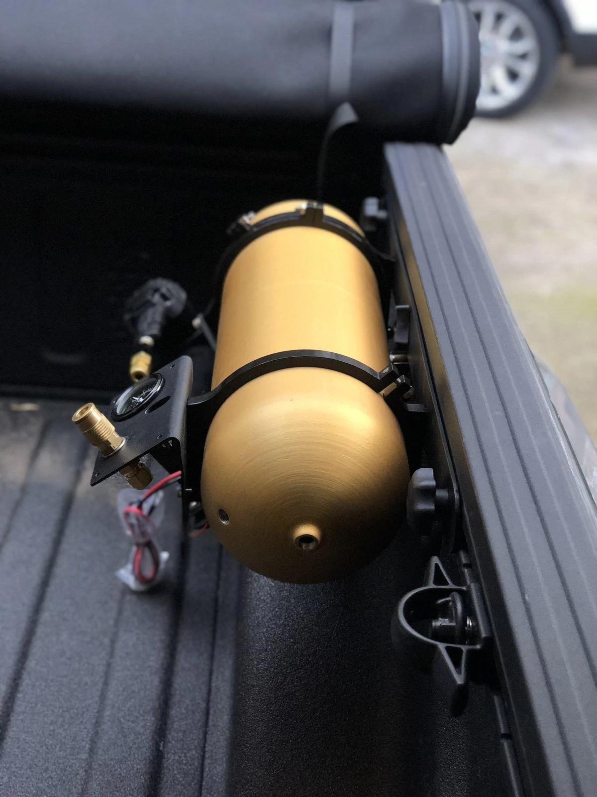

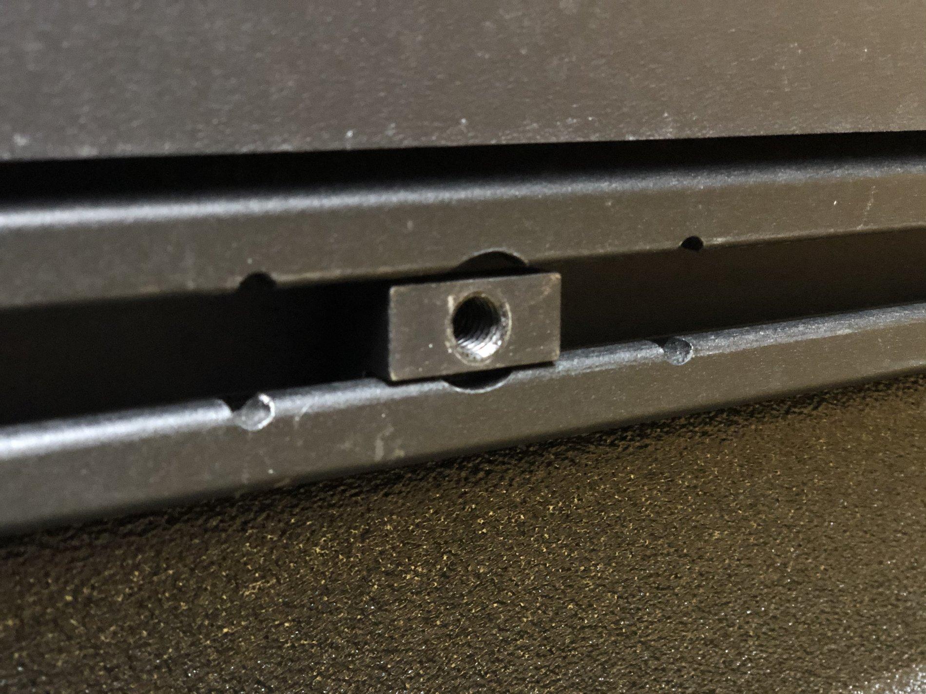

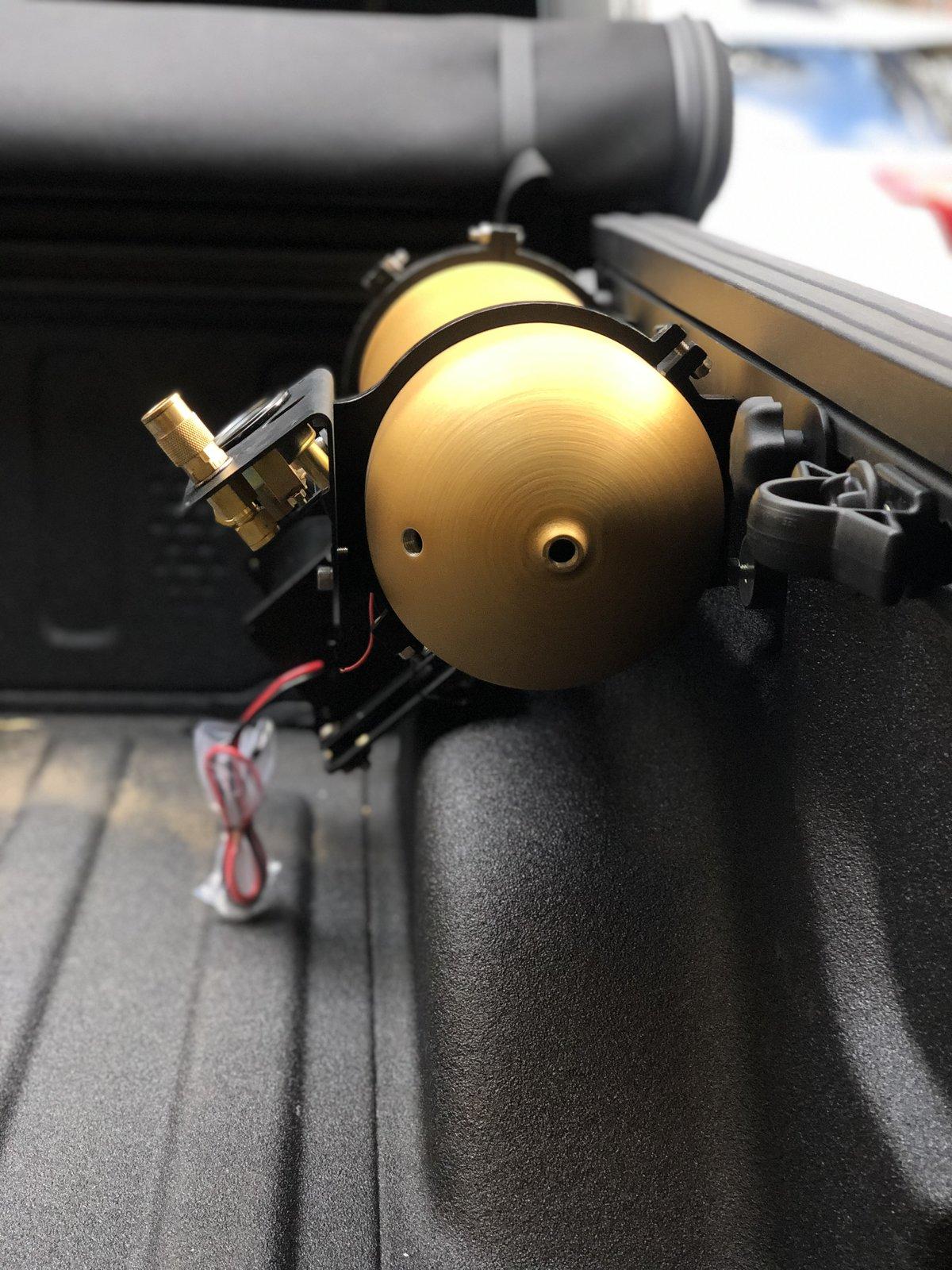

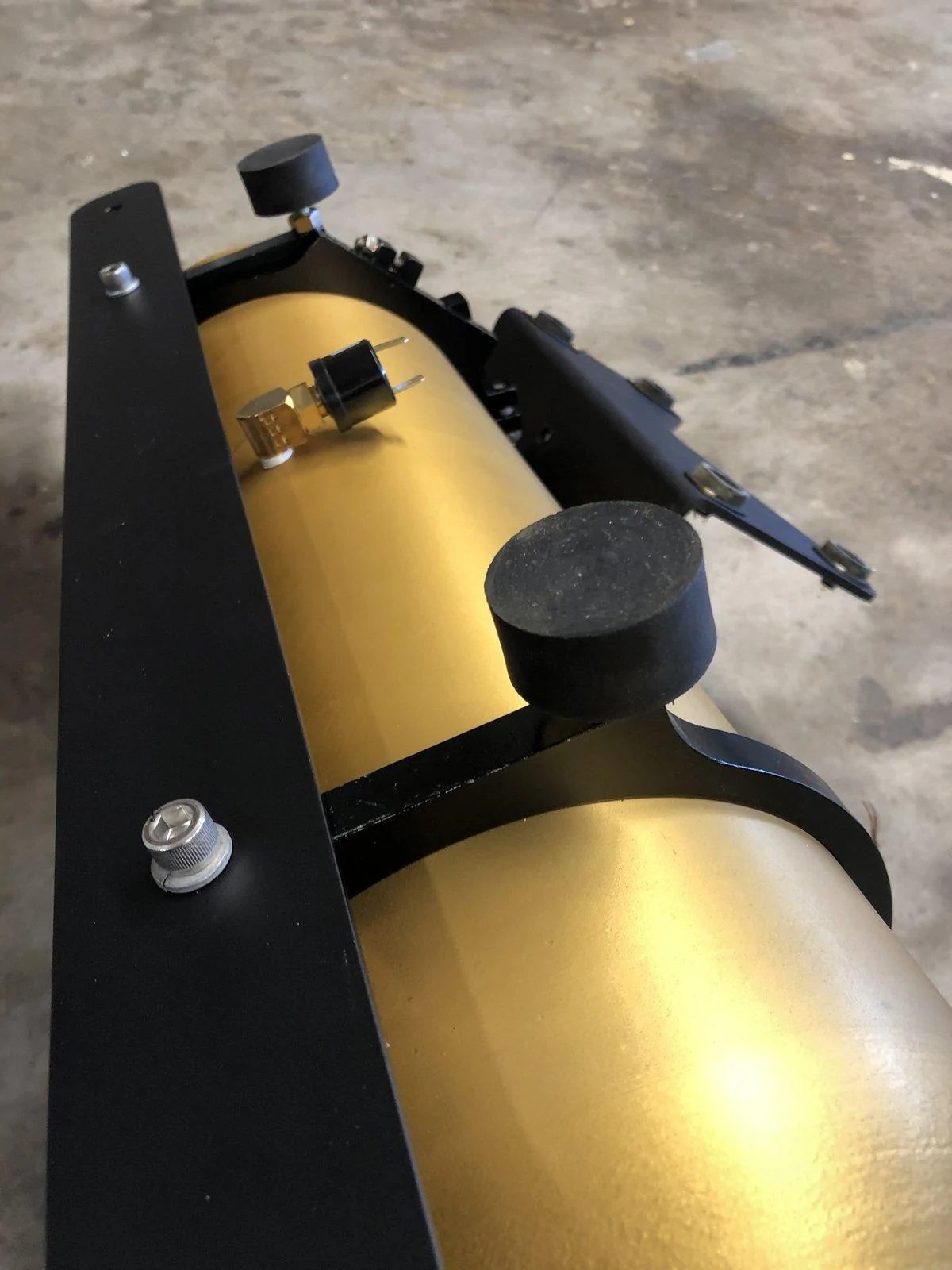

I plan on using the bed rack system so I made a aluminum bracket to allow it to mount using T slot nuts and screw knobs.
Jeep Gladiator Project “Fools Gold” 7C51A907-EA4C-4954-AEC2-213E9A47B17D
Rubber feet to help support.
Jeep Gladiator Project “Fools Gold” EA529D61-A218-440B-97BF-E2DF3E4A6FA1
Jeep Gladiator Project “Fools Gold” 604EB8BB-BD7F-4DCB-A635-0B48F6C5CDE4
Little mock up and test fit.

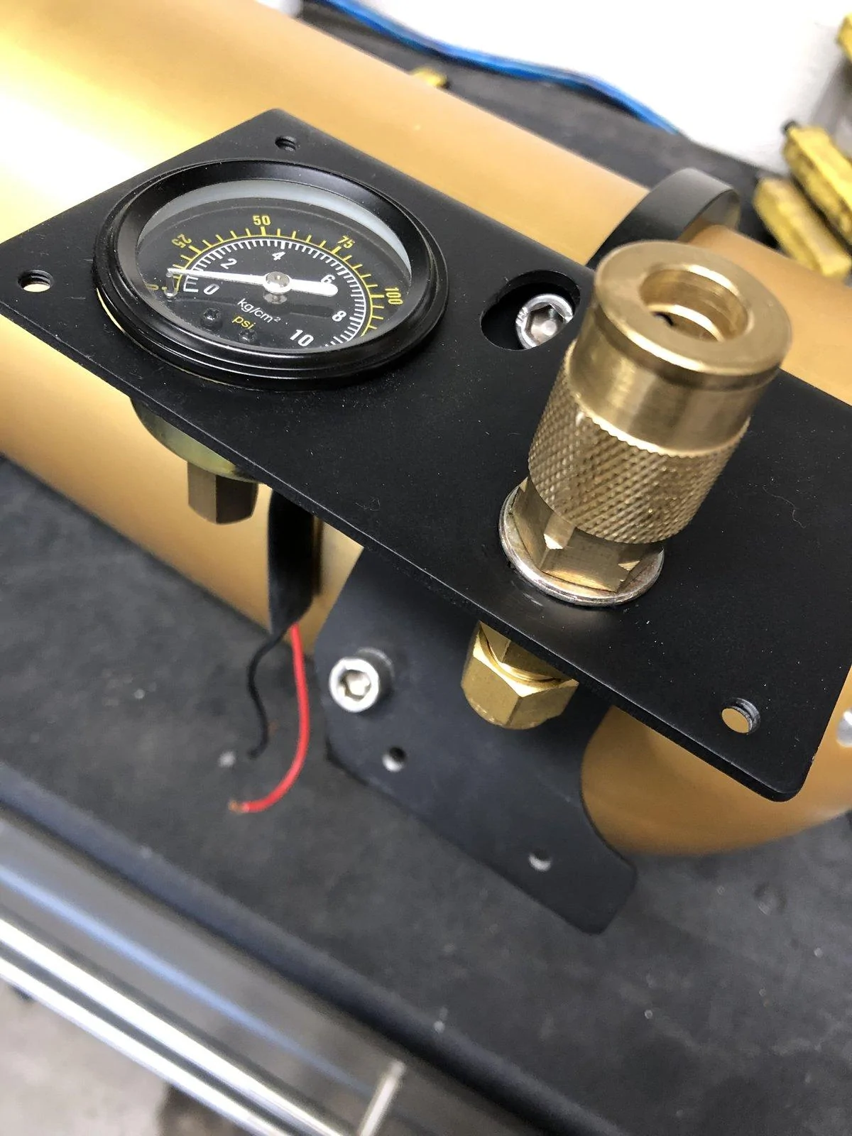

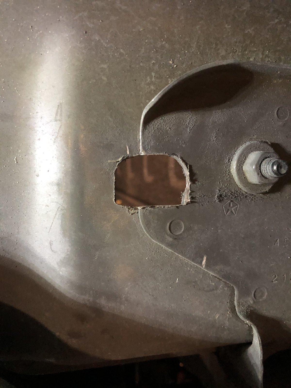

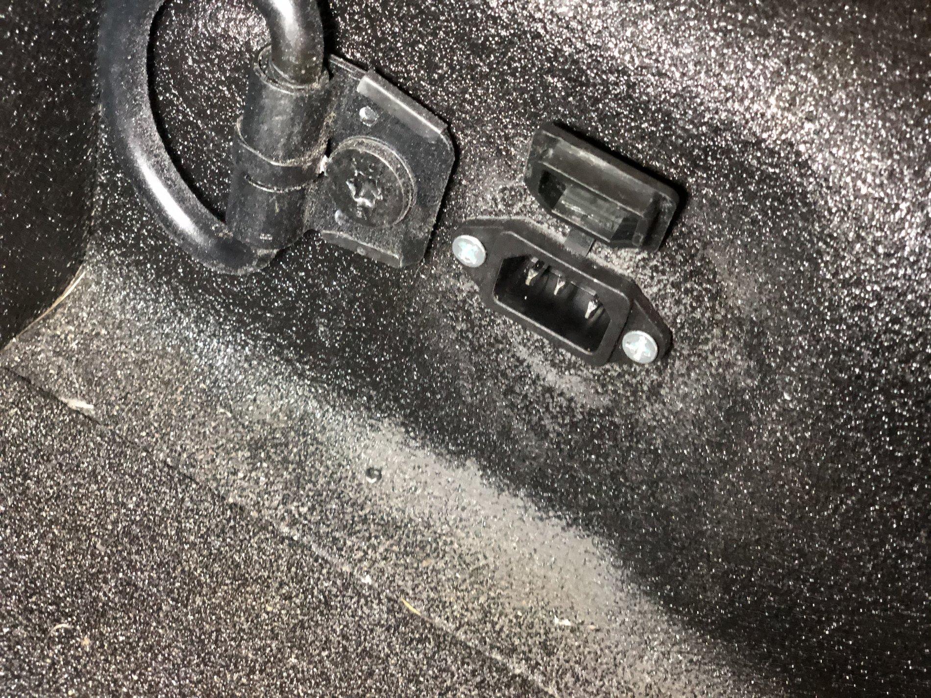

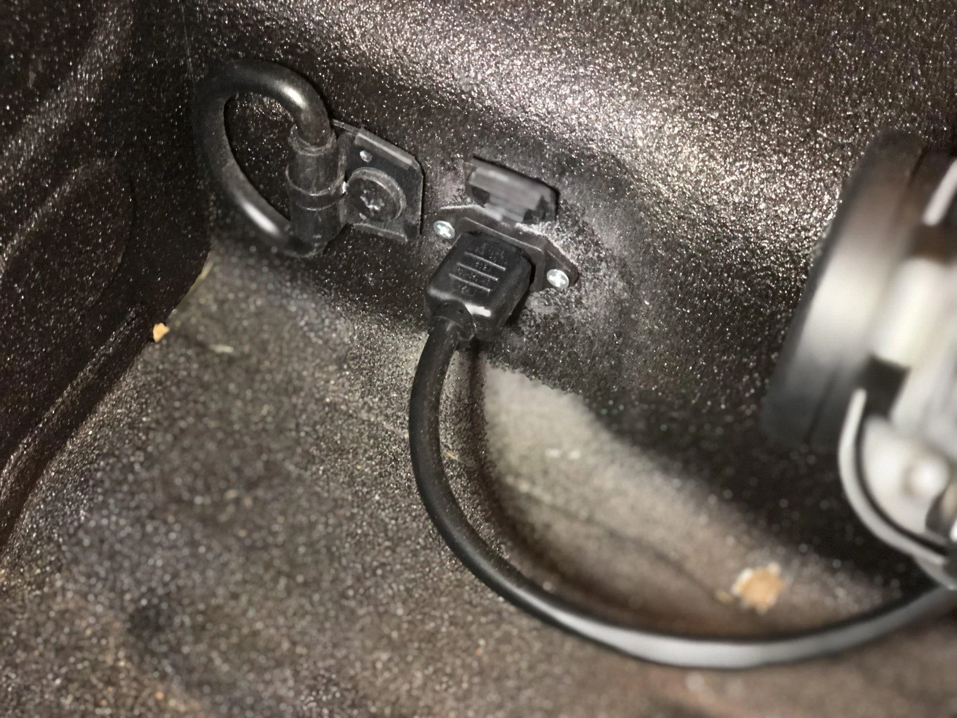

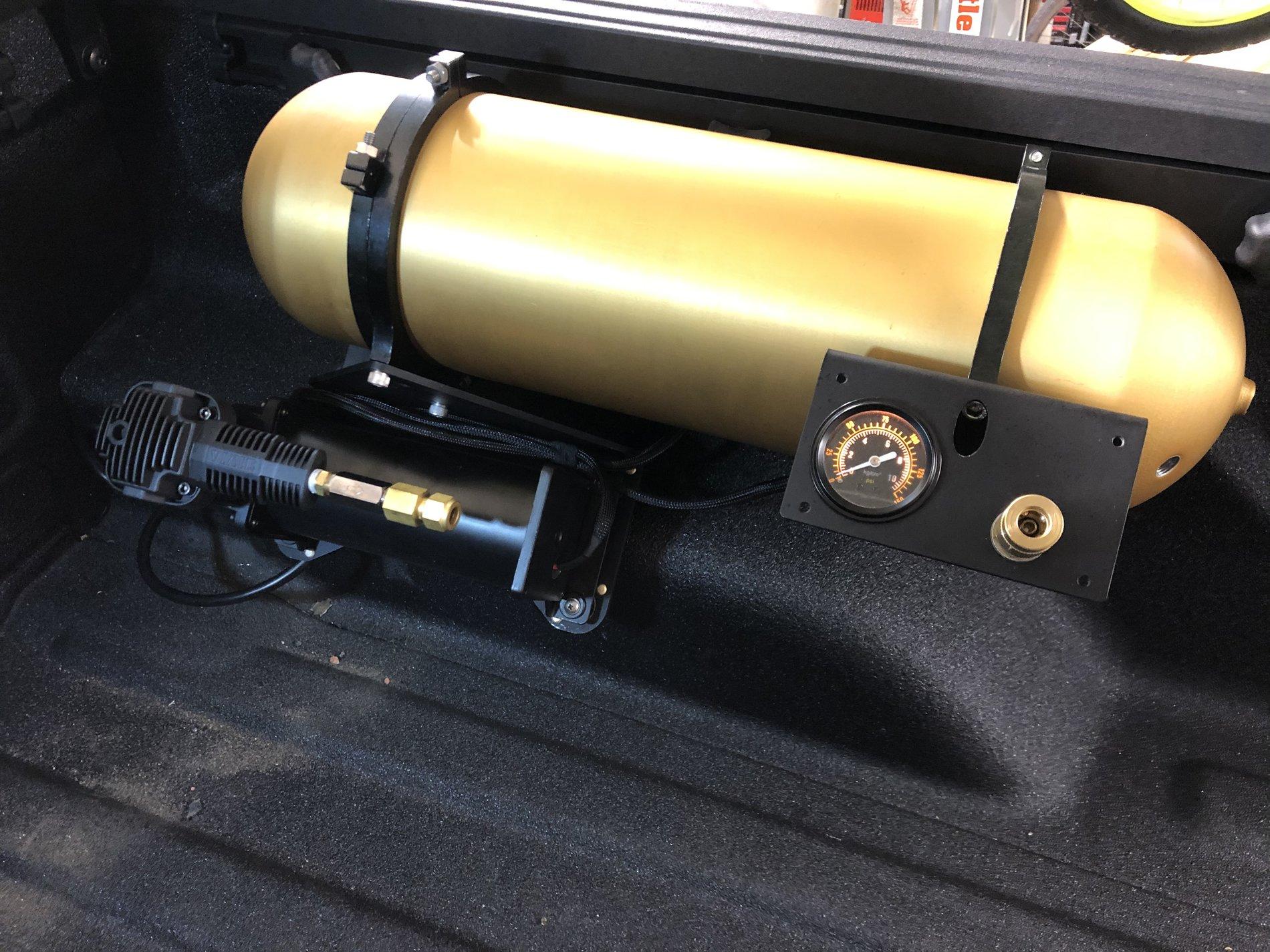

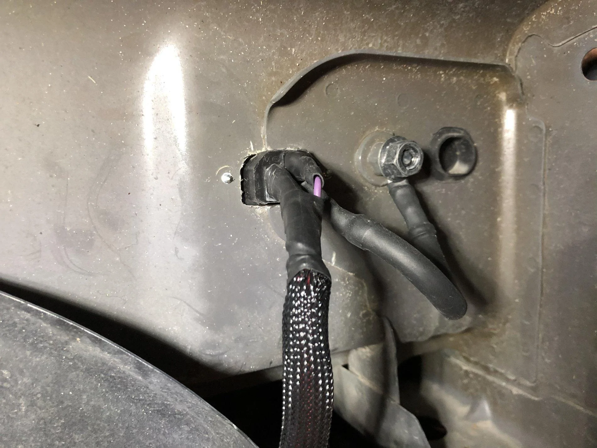

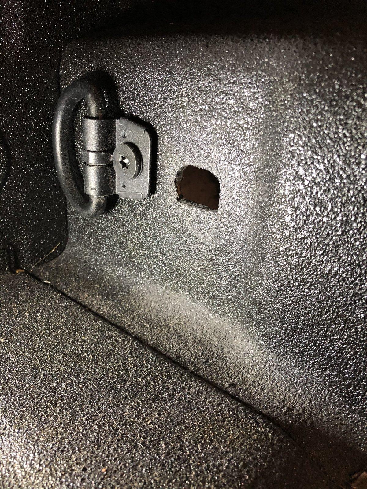

Cut hole in the side of the bed to mount plug.
Jeep Gladiator Project “Fools Gold” 59A9A4AE-5D40-4160-8B46-A40477FB73A1
Jeep Gladiator Project “Fools Gold” B8FA051F-4866-4C0A-8834-36A3A74FB630
Jeep Gladiator Project “Fools Gold” 5B54C436-93EC-4DF9-93F9-9FDE6D7E640E
Jeep Gladiator Project “Fools Gold” A70A1E62-249F-448F-9829-1630C80AE6FB
Jeep Gladiator Project “Fools Gold” 567C822A-797E-4EF4-8C04-7D3A6FBC85B0
Jeep Gladiator Project “Fools Gold” 0D65F872-166F-4E63-B390-26713FB3C1CB
Jeep Gladiator Project “Fools Gold” 1896F0F4-3CC5-4837-9D10-D22386D78383
Jeep Gladiator Project “Fools Gold” 50DF16D5-64E4-44D4-90F7-B17655843B65
Jeep Gladiator Project “Fools Gold” BC1F2897-7033-4A51-AAC1-01848D139561
We have power.
Jeep Gladiator Project “Fools Gold” 8B60CE84-16E4-4894-93A0-8C21839D4ECD
Jeep Gladiator Project “Fools Gold” D49D1DB2-6952-4D3A-84C8-216FFE00F5AF

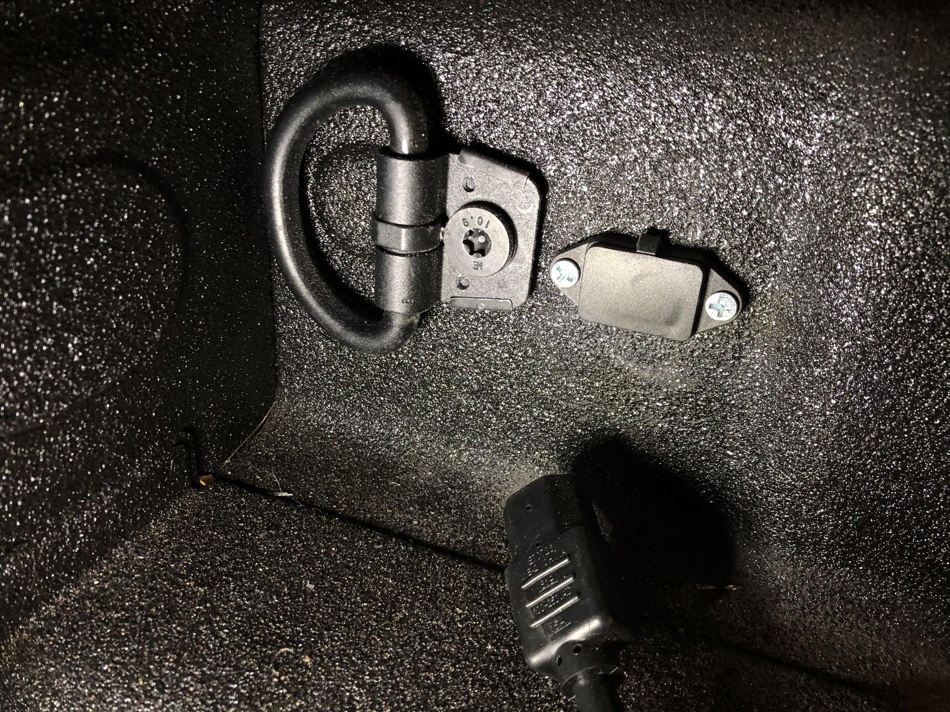

looks great. Interest in knowing more about plug set up if you care to share.
Thanks. I used a HD C14 panel mount and plug. I’ll get more pictures of the it this weekend when I wrap it up.

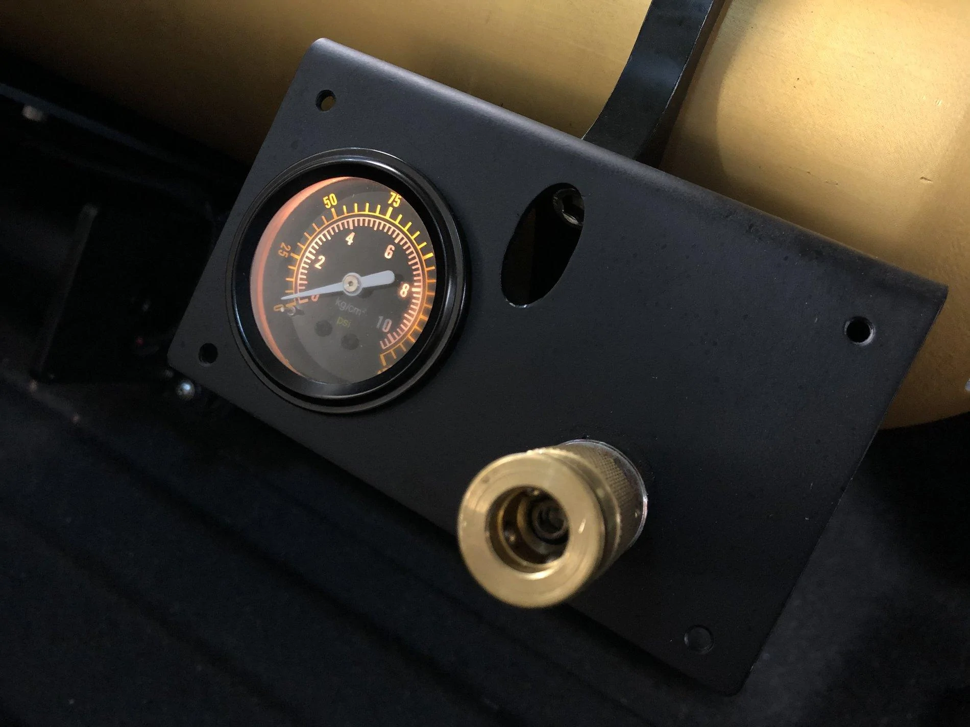

All done.
Need to add a pressure relief valve and changing the pressure switch to 175.

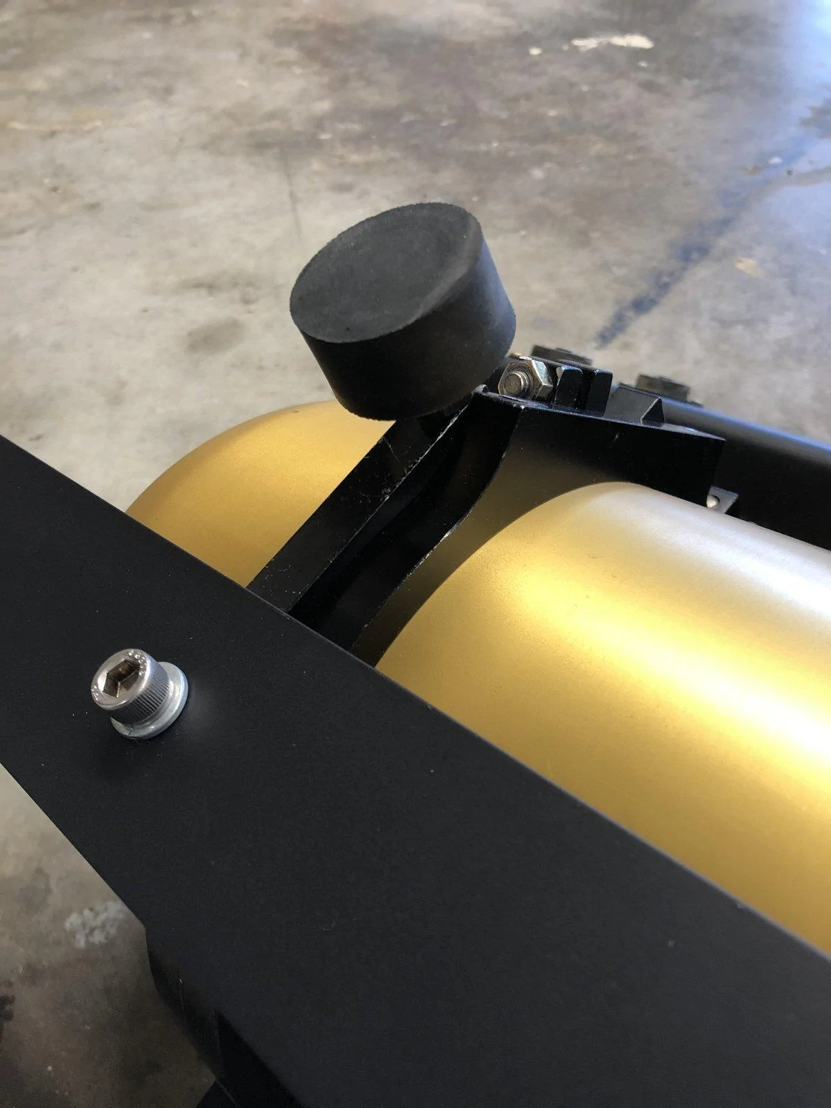

Also added some rubber feet to the compressor mount to add some additional support.

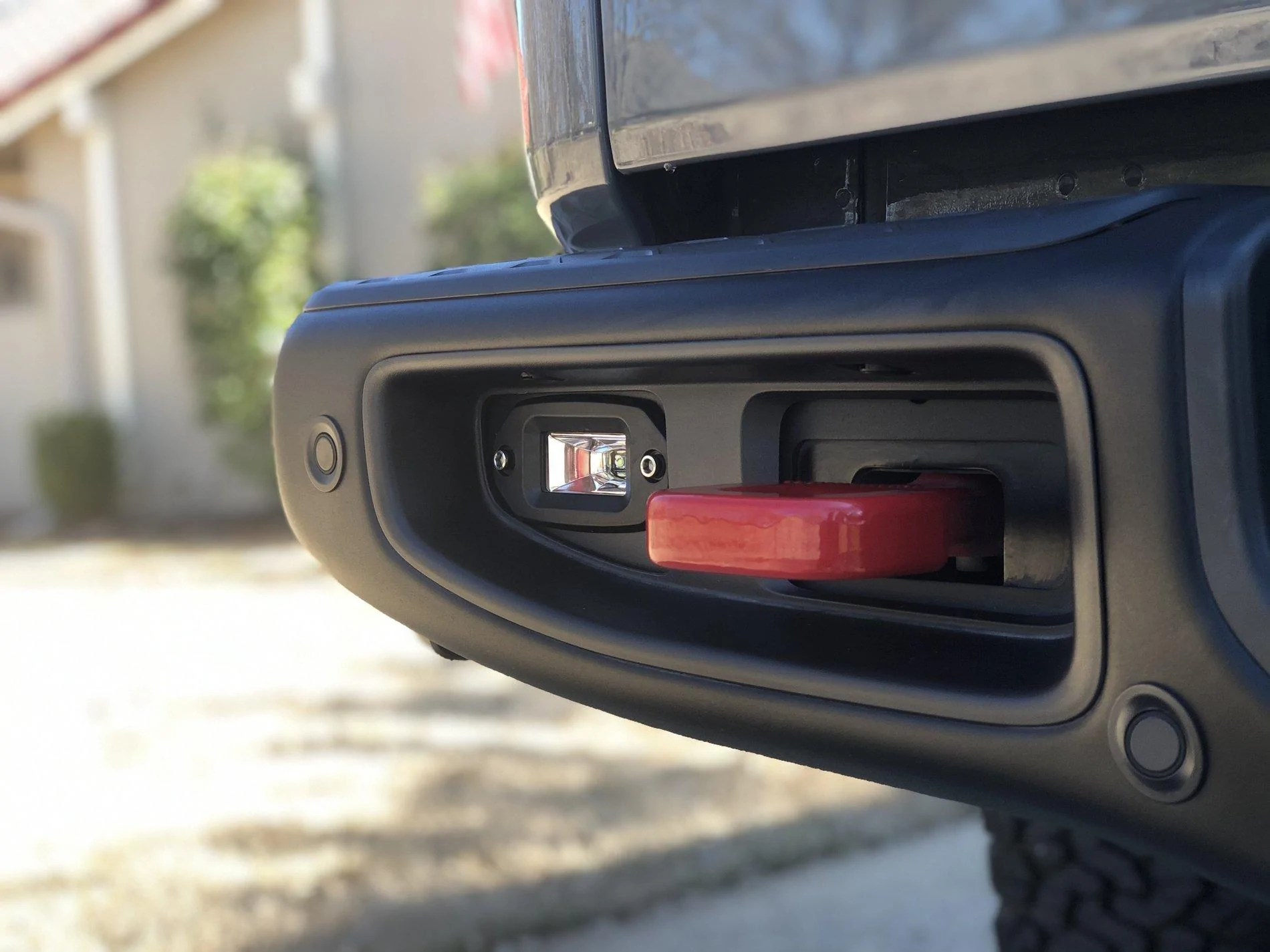

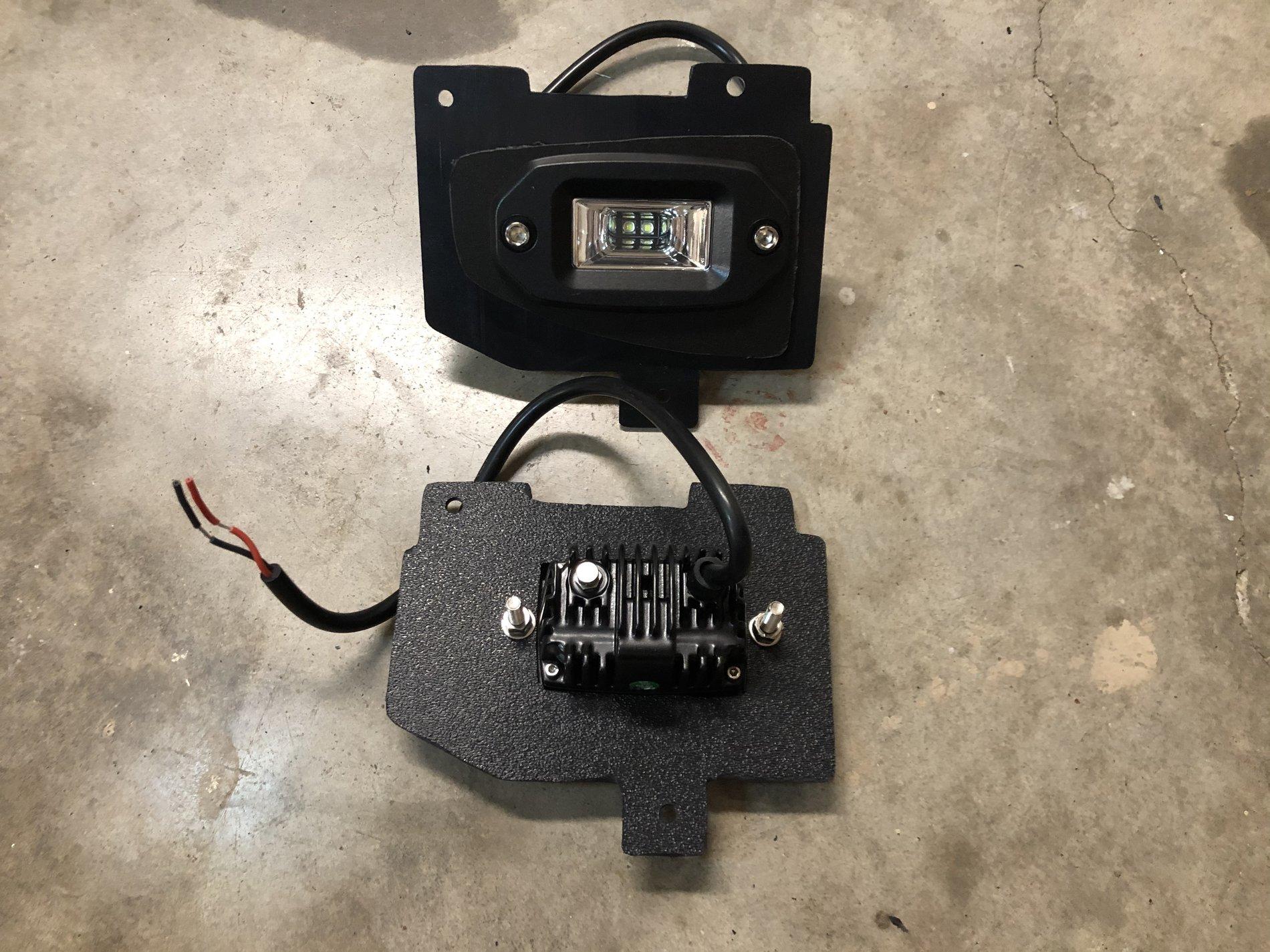

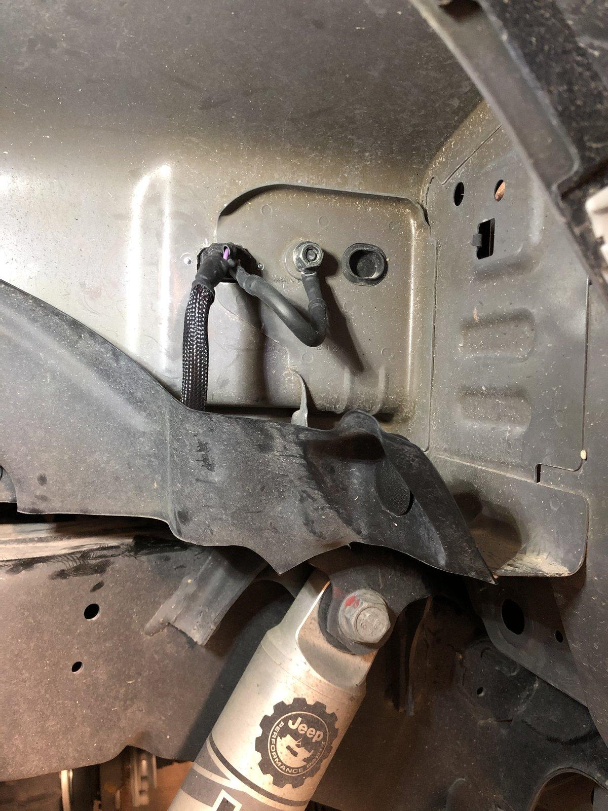

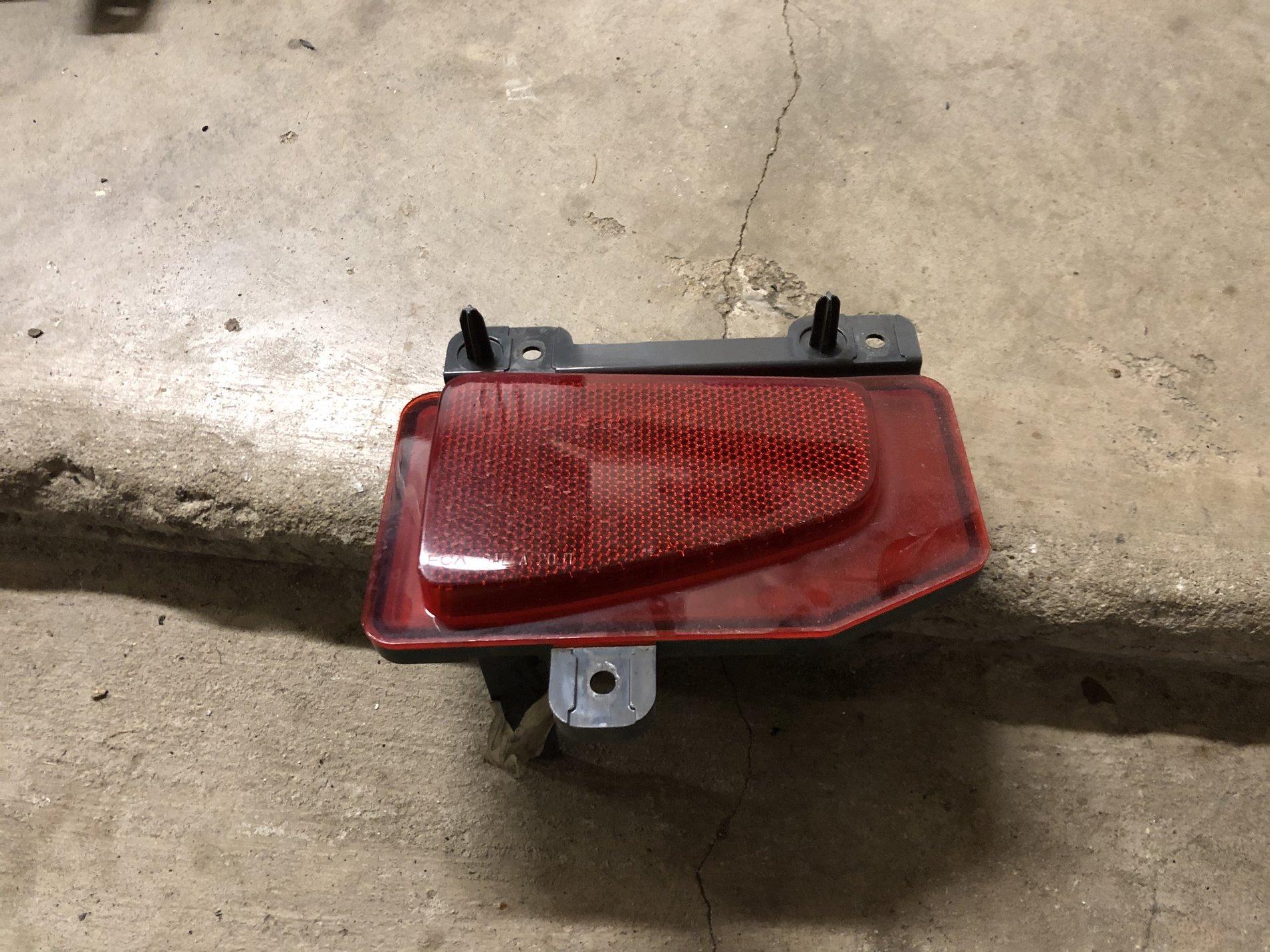

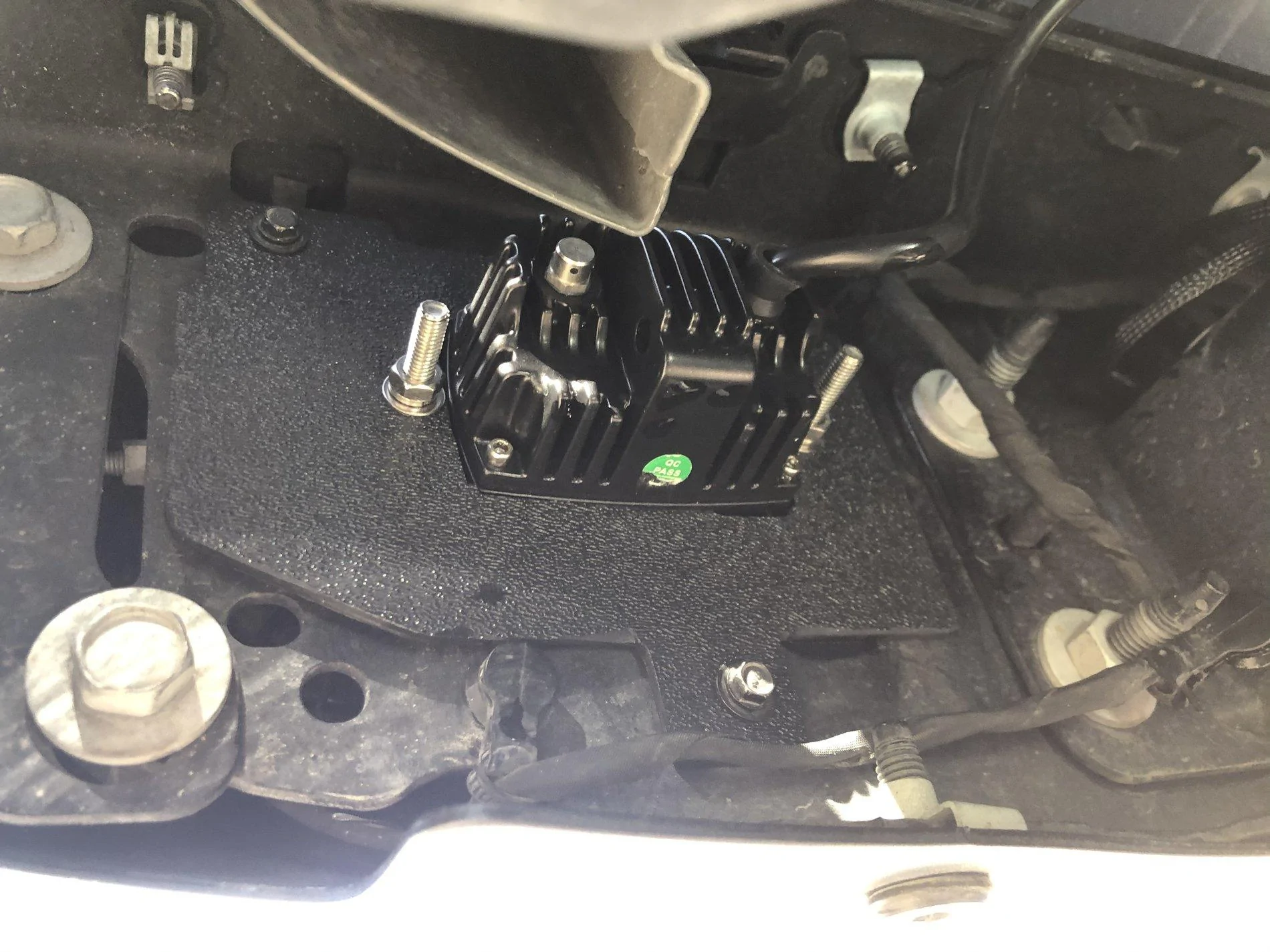

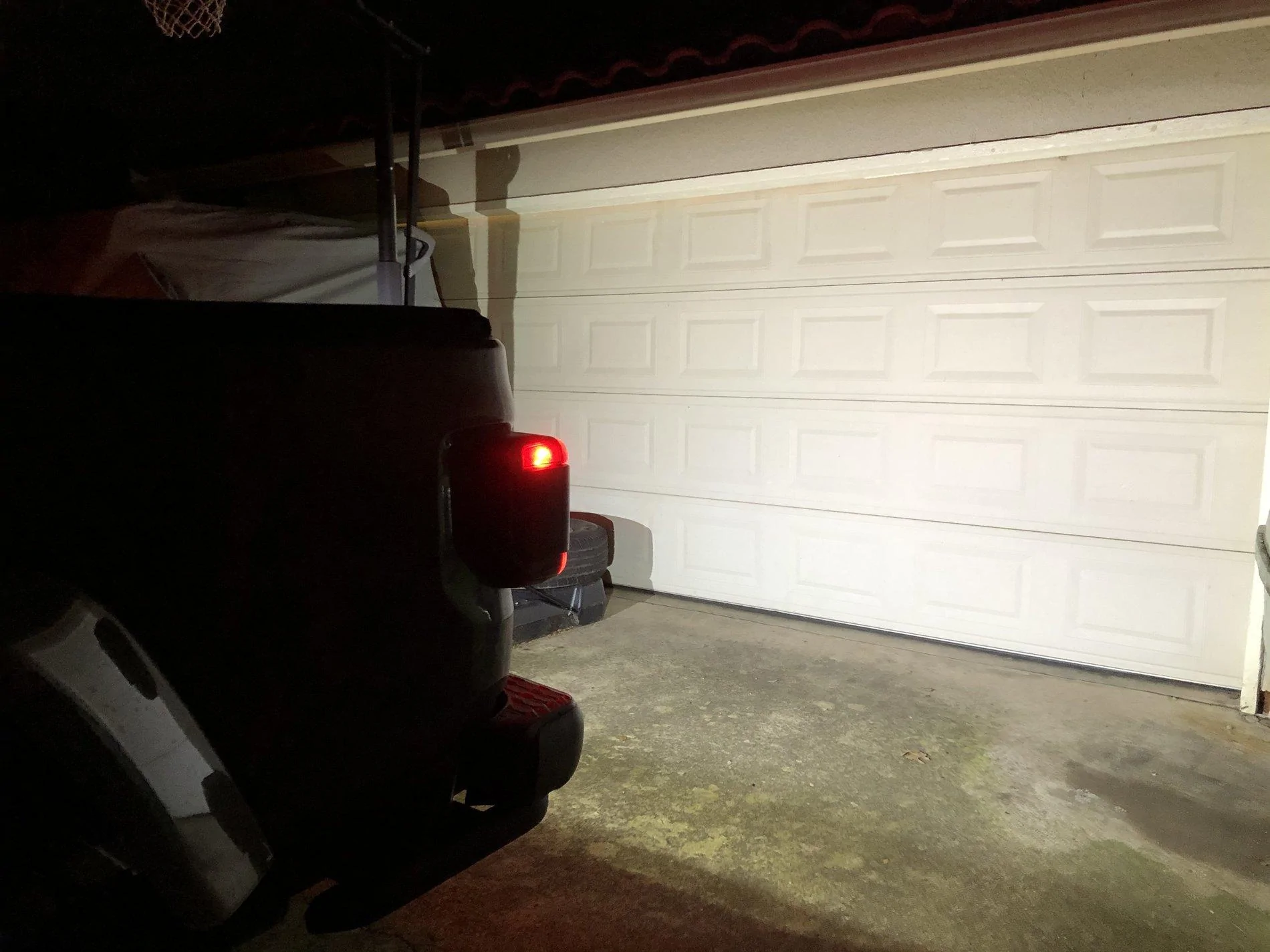

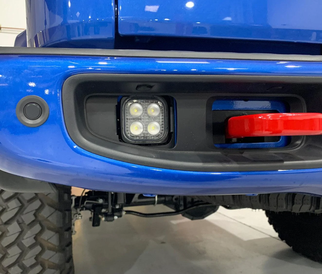

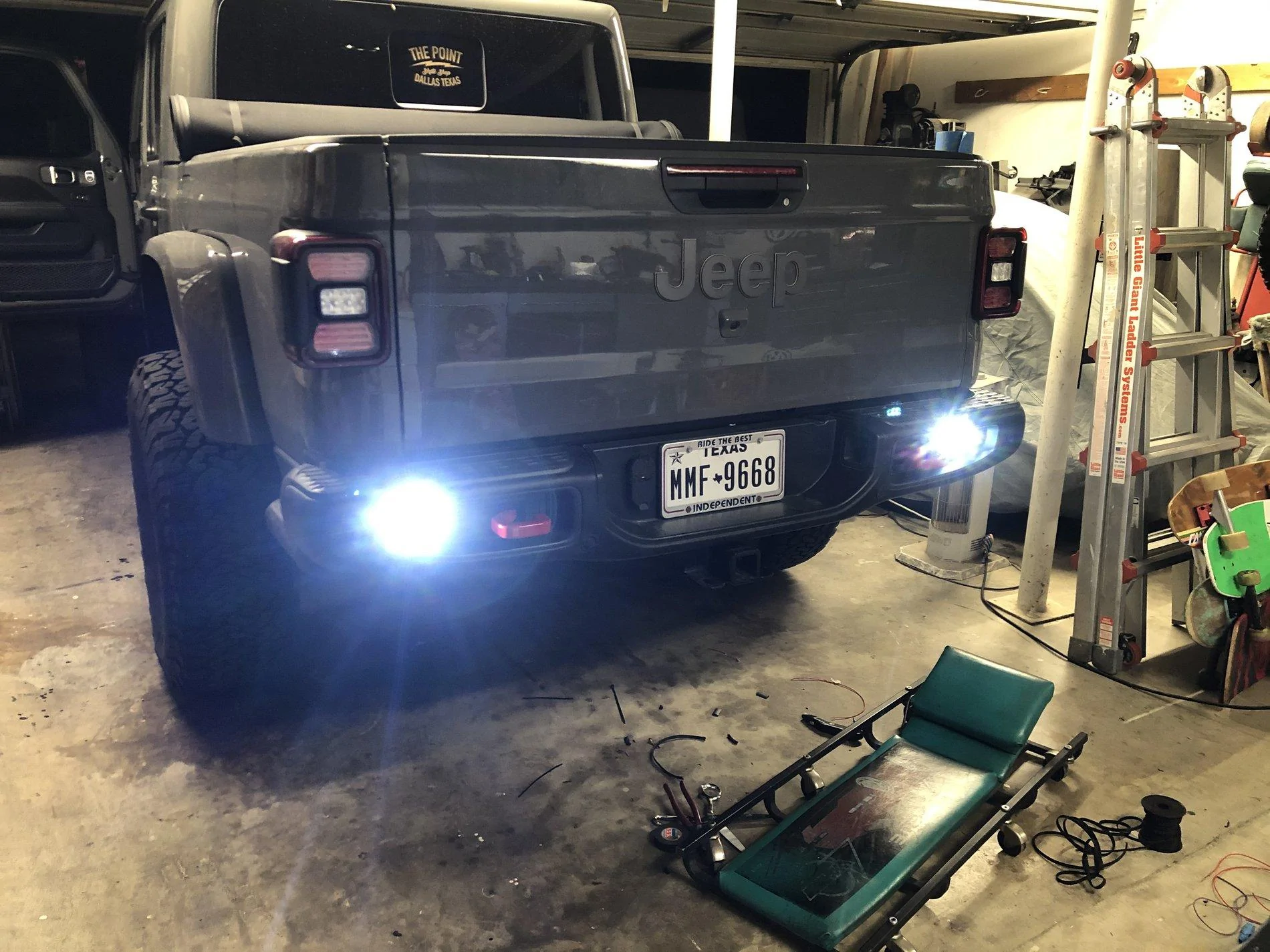

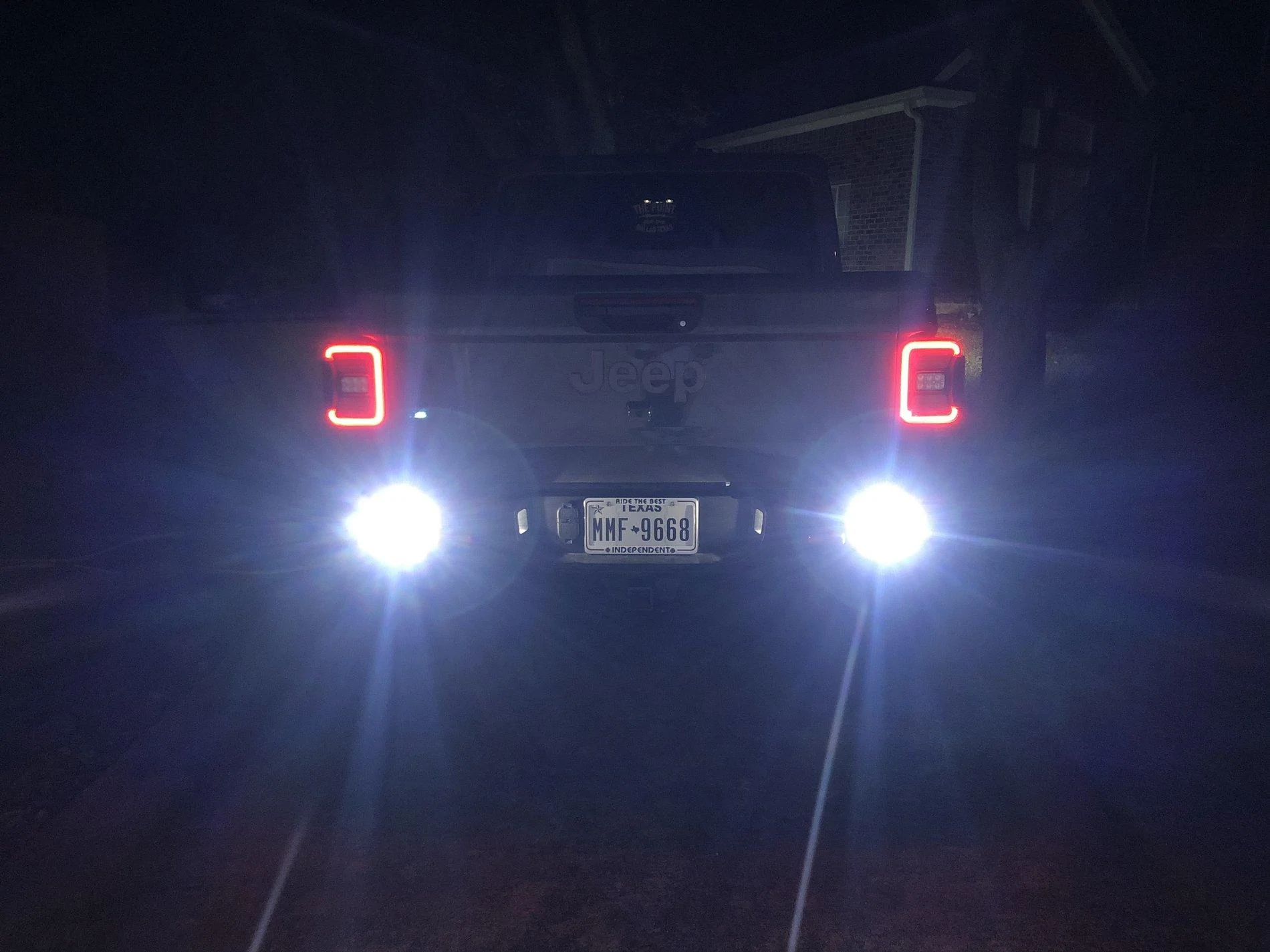

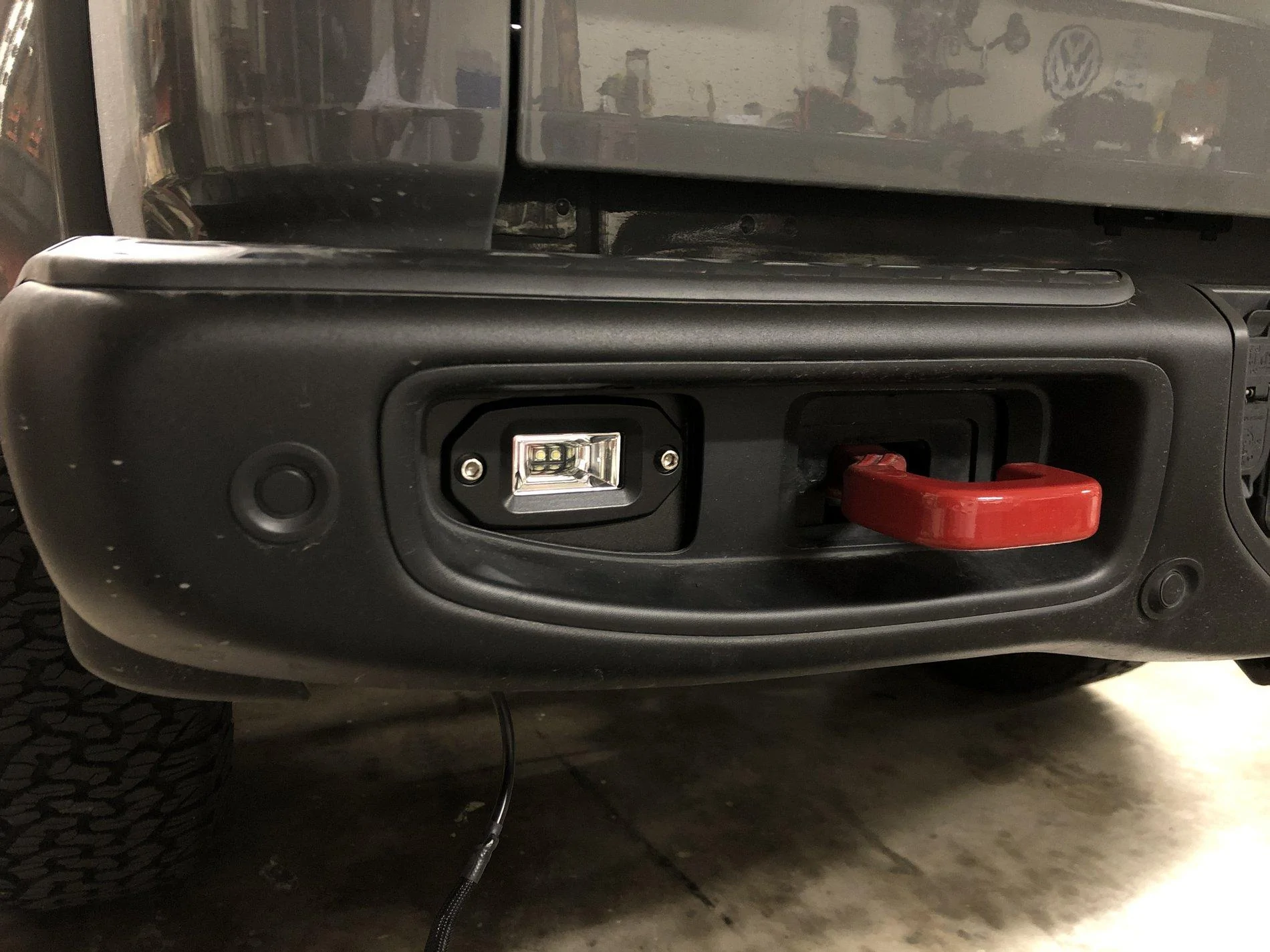

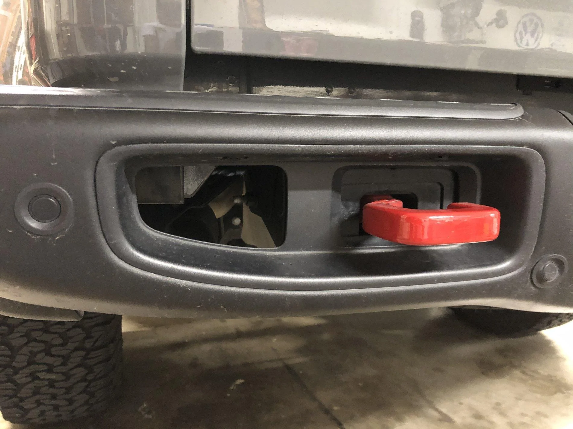

Dropped the rear reflectors out of the bumper and added some rear utilities lights. what a difference! Now I can see when I am backing up.
It was more of a challenge then I expected because the reflectors are tapered. I wanted try to recreate that as best as possible so the lights sit flush and not have a gap. wired it in to the auxiliary 4 button in the cab.

Looks great, plus you can flash any tailgaters. Of course, around here if you did that they would start shooting!

Great build thread. I love what you did with the lights. Nice clean setup. What are the lights?

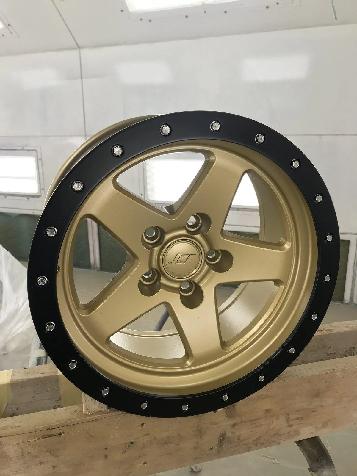

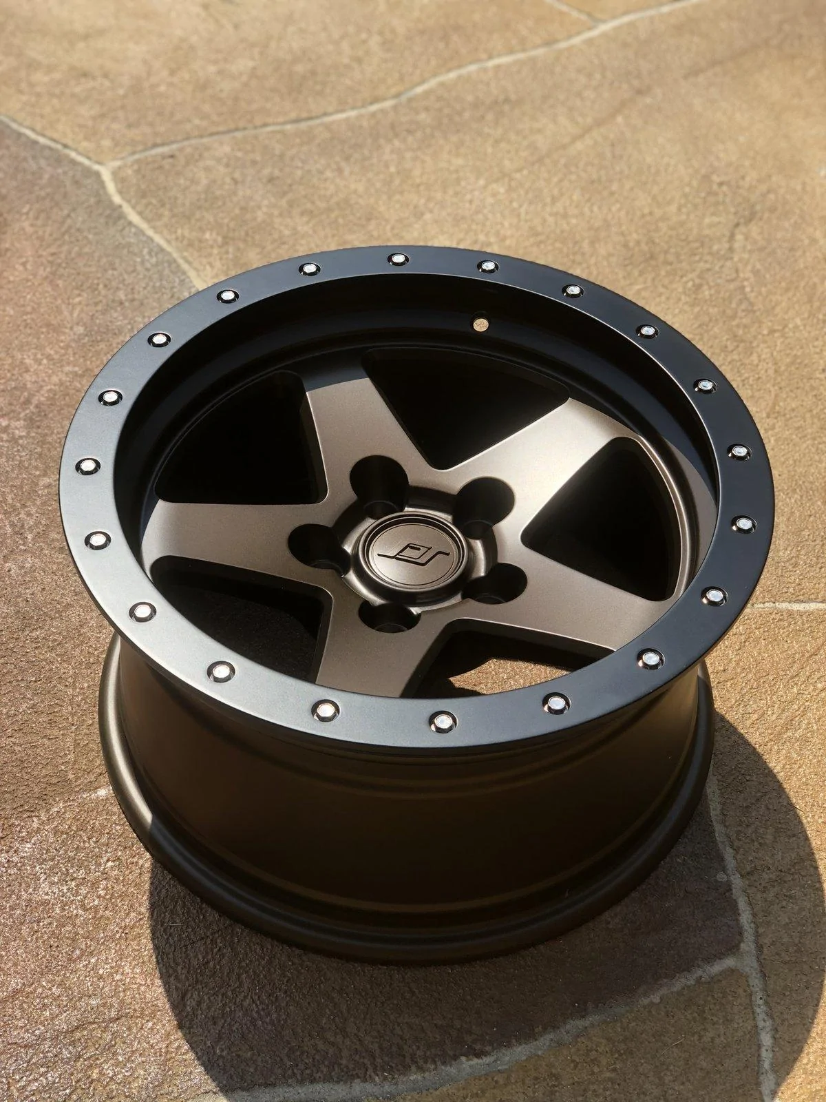

About a month later a went with the Mopar 2” Lift, SCS 17” wheels and 37” BFG A/T’s.
The wheels were originally bronze in color and decided to change it to a matte gold.
Wow i never knew stealth custom series made wheels for jeeps i always thought they were for tacomas and all that since i previously owned a 3rd gen tacoma used it for overlanding(had the ray 10's on it btw) but i no longer have the taco and i now own a gladiator of course but wow i never knew this

This OBA system is the slickest install I’ve ever seen. Very nice work. Are those black brackets and the tank custom? I’ve been looking for a nice aluminum tank for my own project. I found a company called BCFab who makes some nice ones.
