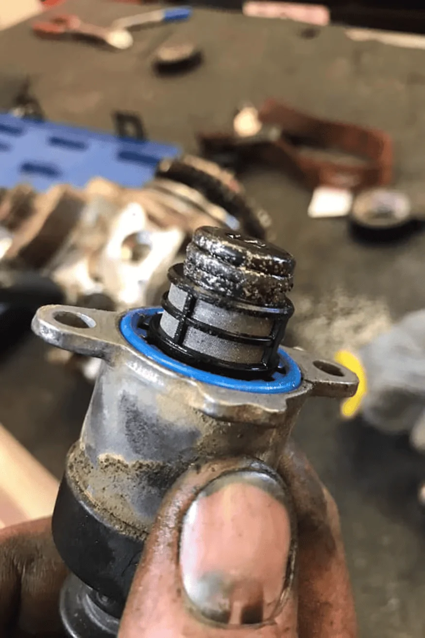

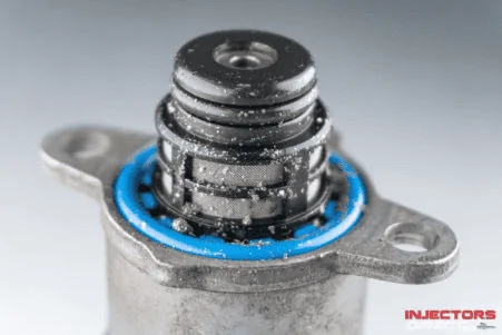

Pull that sensor on the fuel pump to make sure that your pull is going south.

Not following ya here Rusty.
Couldn't think of the right name for it at the time. It's the fuel pressure regulator that sits between the 2 pistons on the pump. If it has crap on it, then yes your pump is failing.

Yep. I went to do that the other morning but it’s not easily accessible. It sits below a ton of hoses, wires, and plastic parts…
I would love to see it, but I don’t have a shop manual for tearing down the front of the ecodiesel.
Anybody have any tips?
