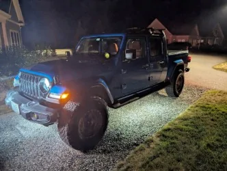

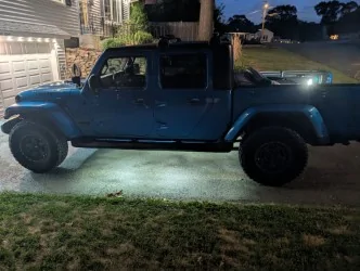

They came out awesome.
Ill try and remember night pics to share.

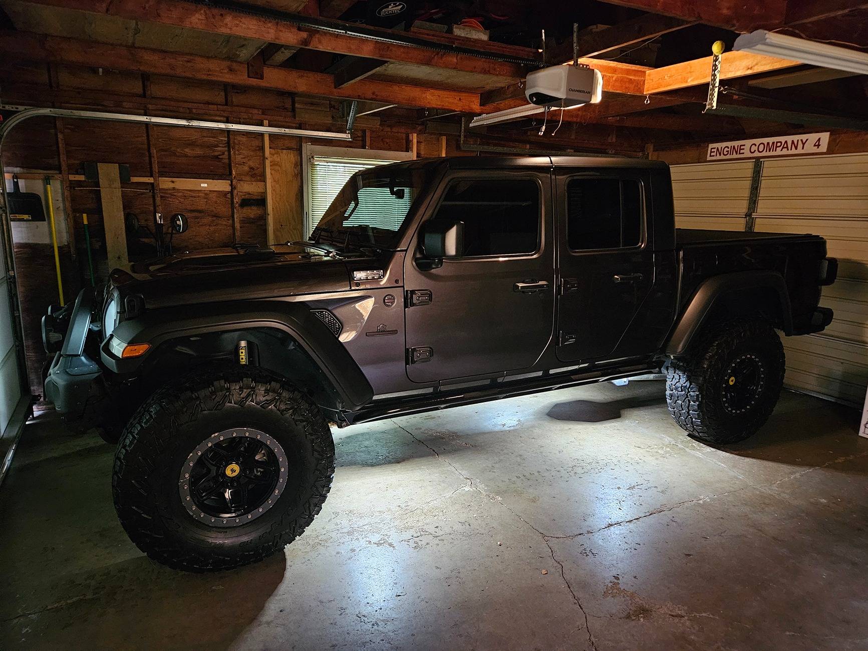

I did this several months ago, one under each door, and wired to the bed lights so every time the
bed lights come so do the curtesy lights!
