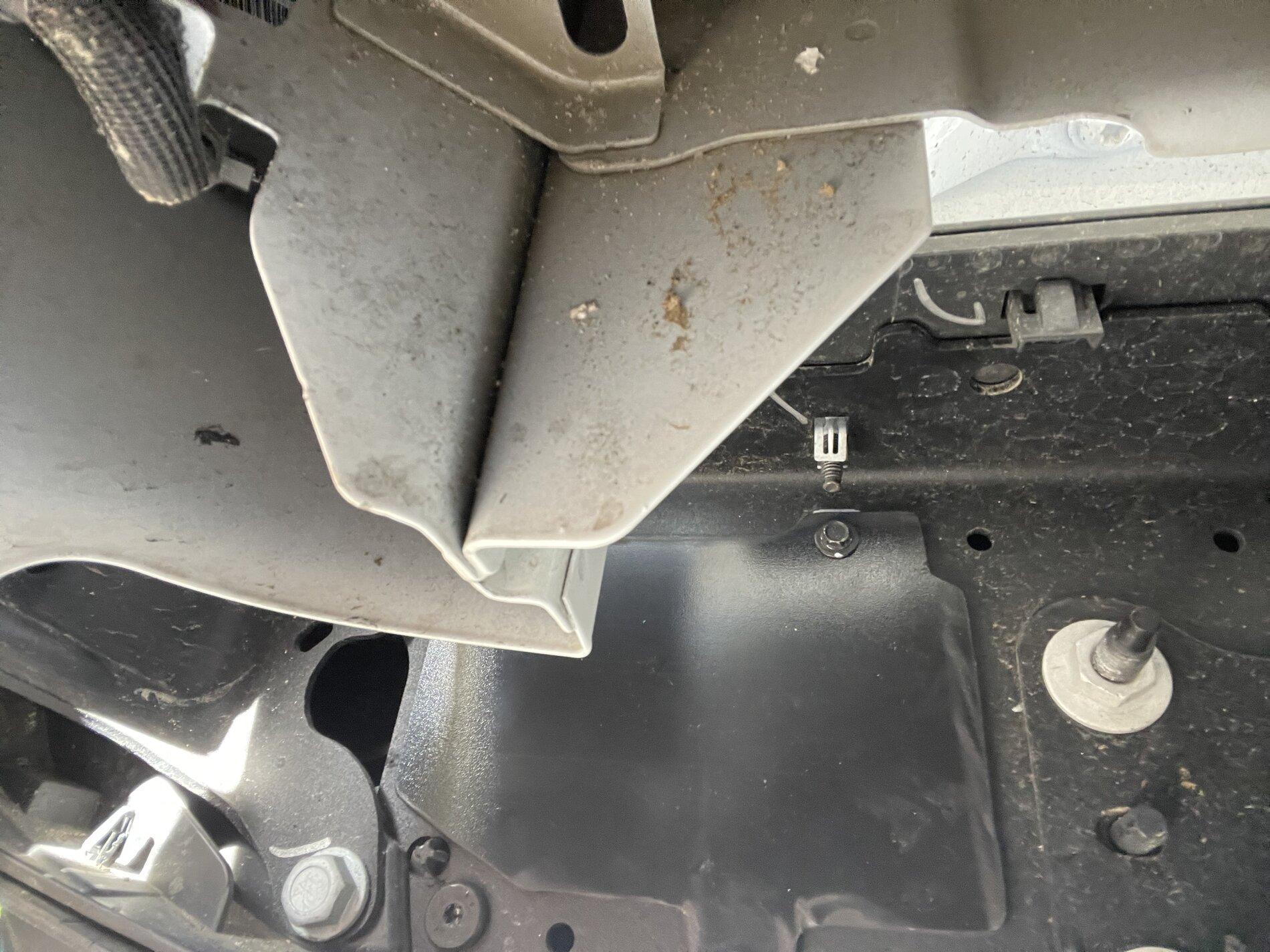

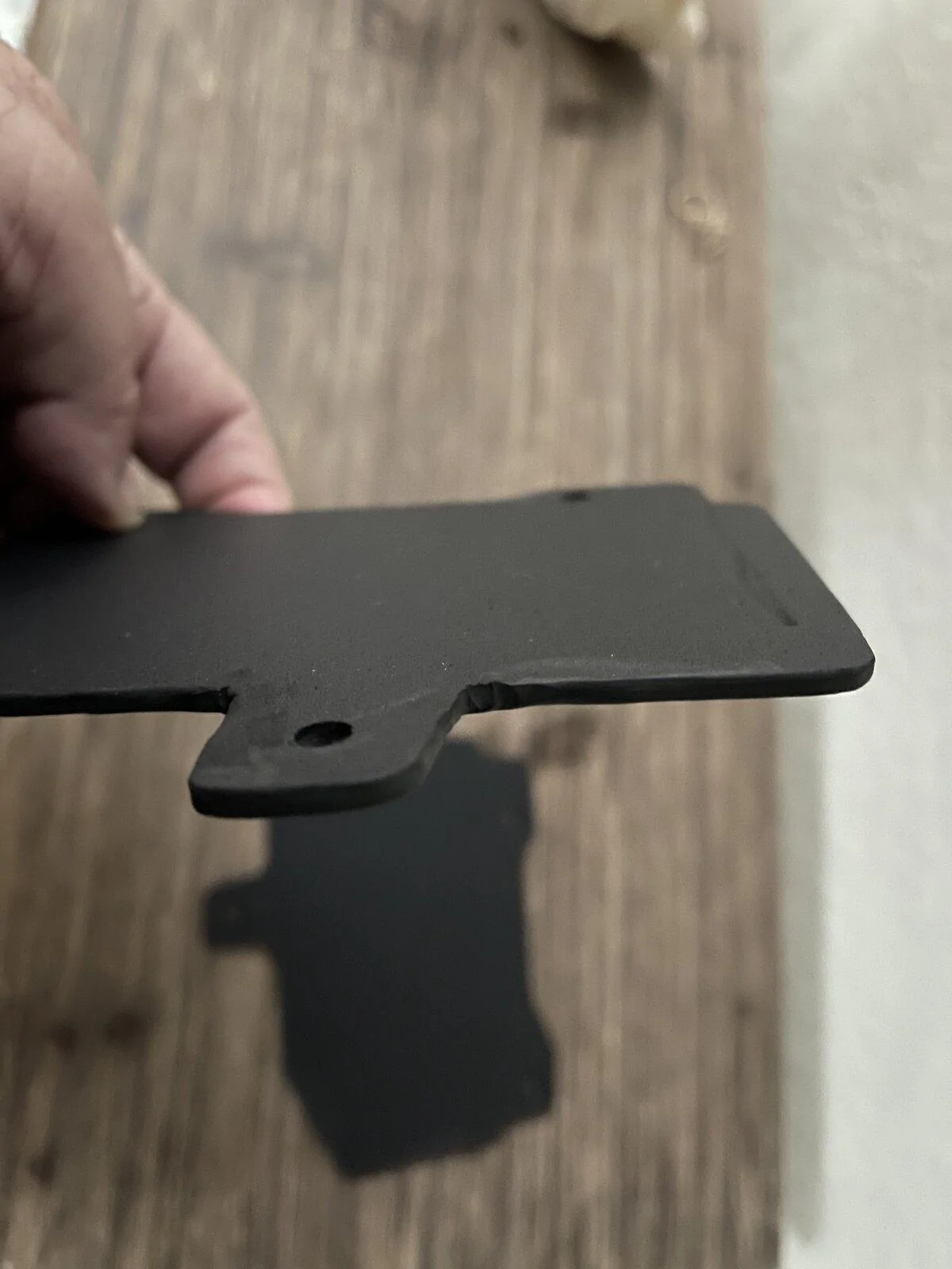

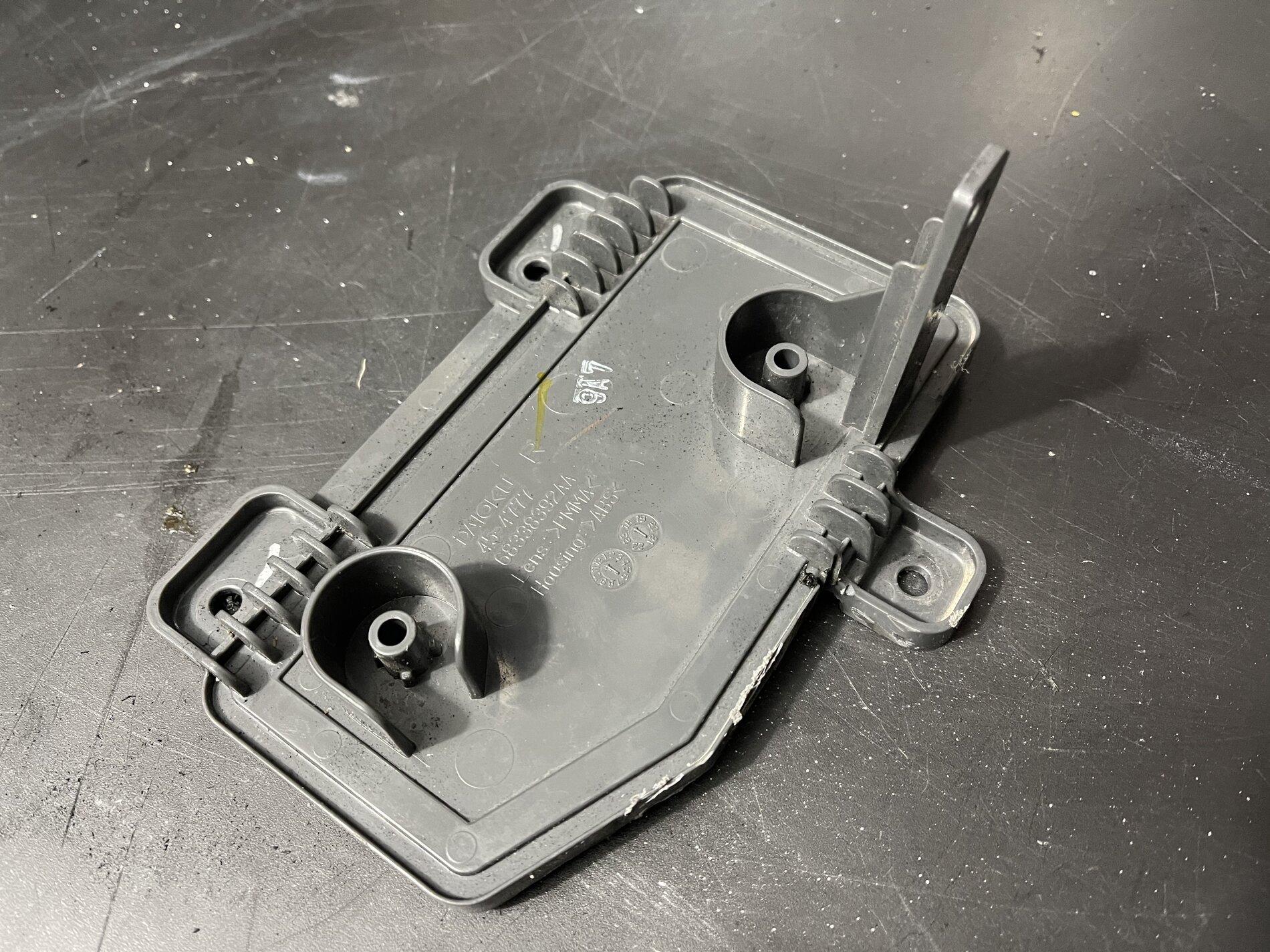

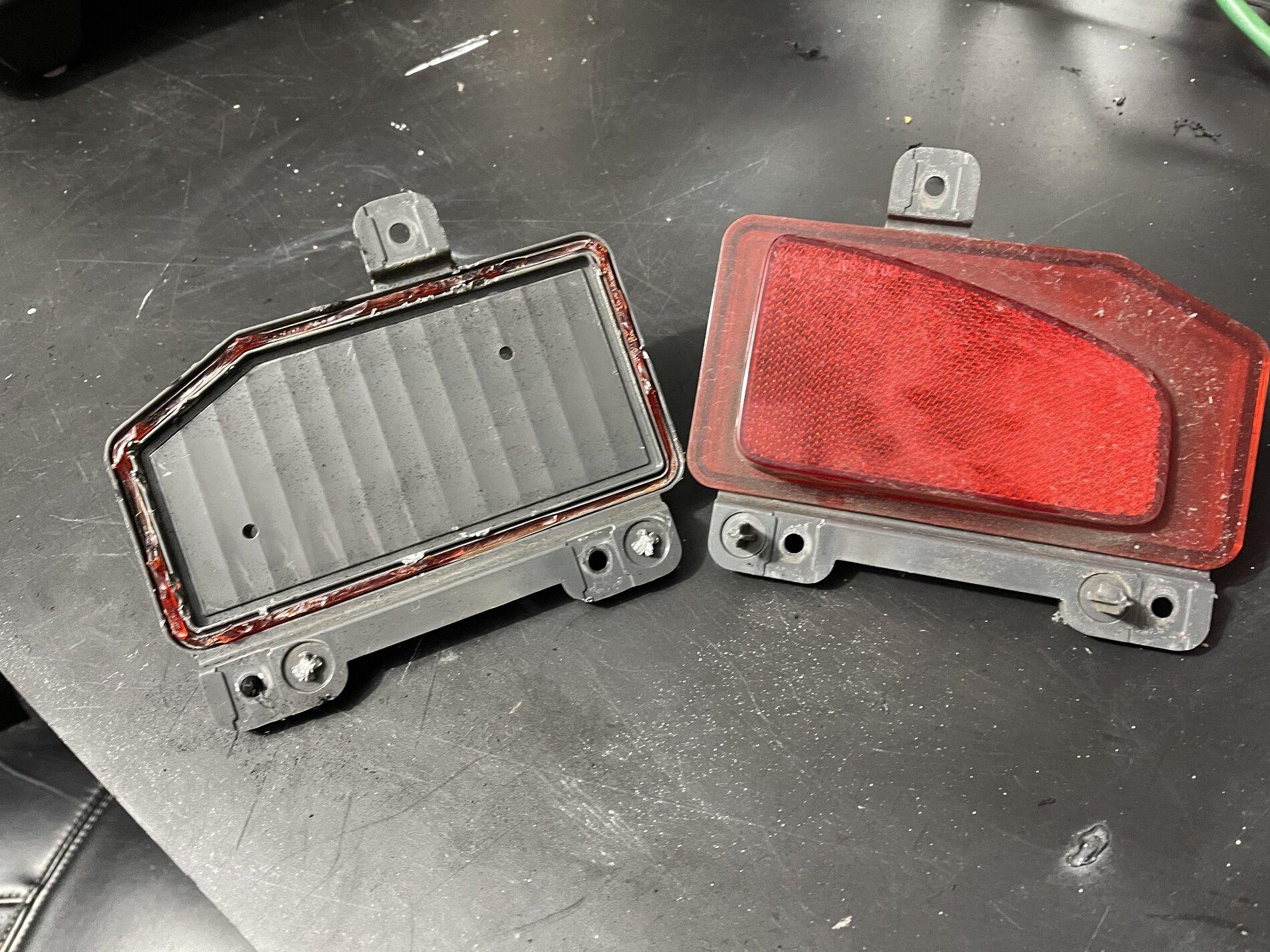

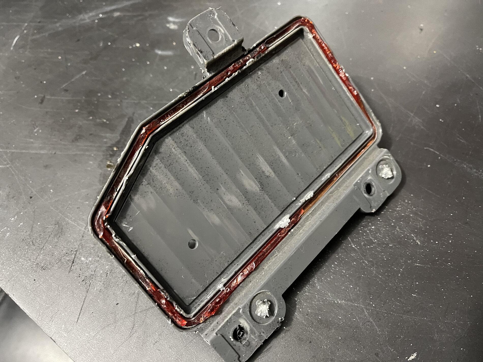

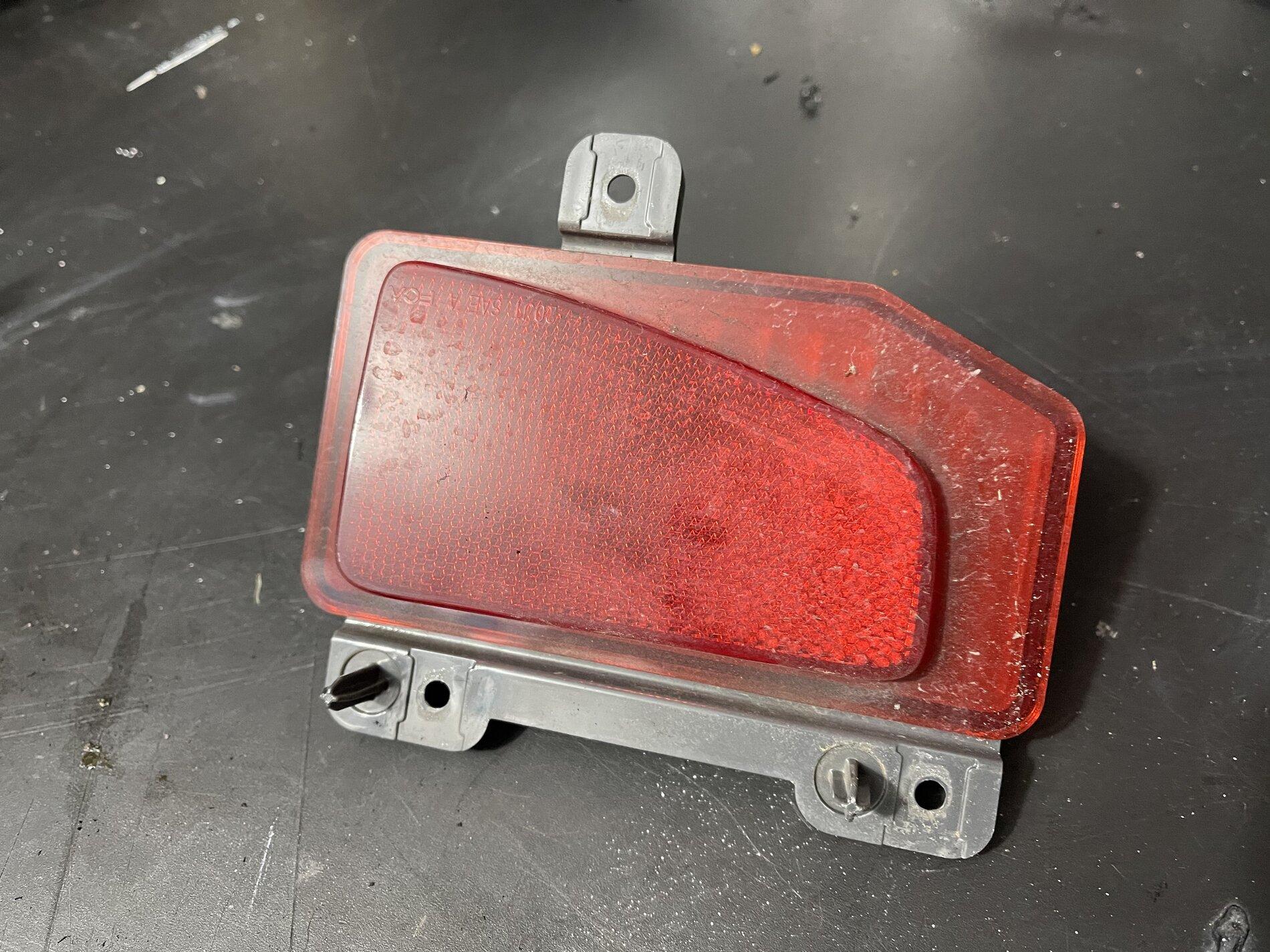

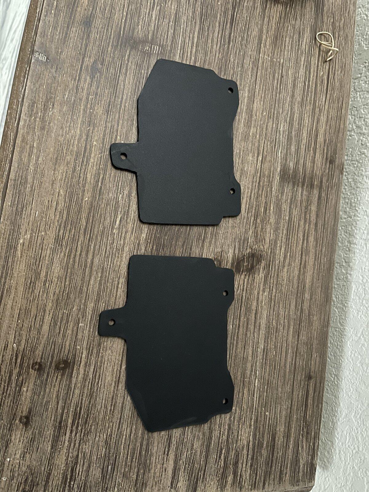

Ok pictures of the plastic way.... remove old reflectors. Break one up so the red reflector is all gone, so it will lay flat!
Lay flat on surface of your choice, steel kydex, or whatever.
Trace and cut out.
Finish em up paint or what have you and install. Tip. After laying the piece flat on your material clamp and drill holes then insert plastic wall retention screw hangers (used to hang stuff on your wall) through both pieces and then you can actually trim with a power tool using the original piece as a guide similar to routing. This will make it immensely easier than cutting out the shape and trying to locate the holes afterwards.
I did this with a Dremel and the project start to finish was about an hour and a half. The lights arrive tomorrow after I install I will post a picture of that as well

Bottom line for me is if this holds up and holds up I like to look it looks factory as far as the texture if it doesn’t hold up I can always replace the cutouts with steel not a difficult project. However this Kydex/PVC is very very tough stuff. Also not being steel is probably less prone to passing vibrations. That I don’t know cause I’m not an engineer

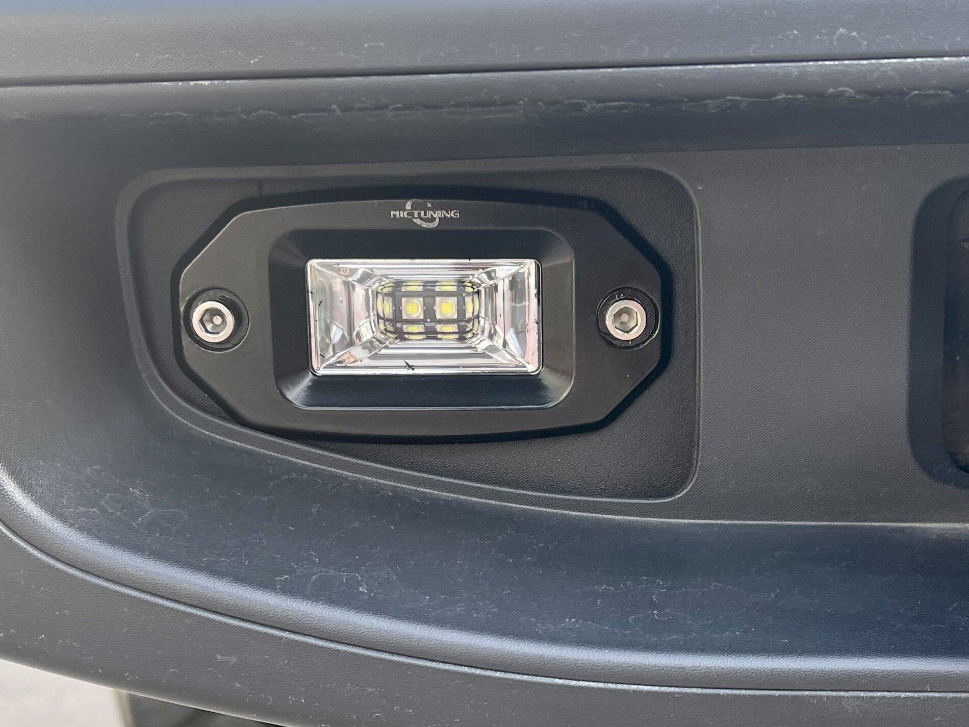

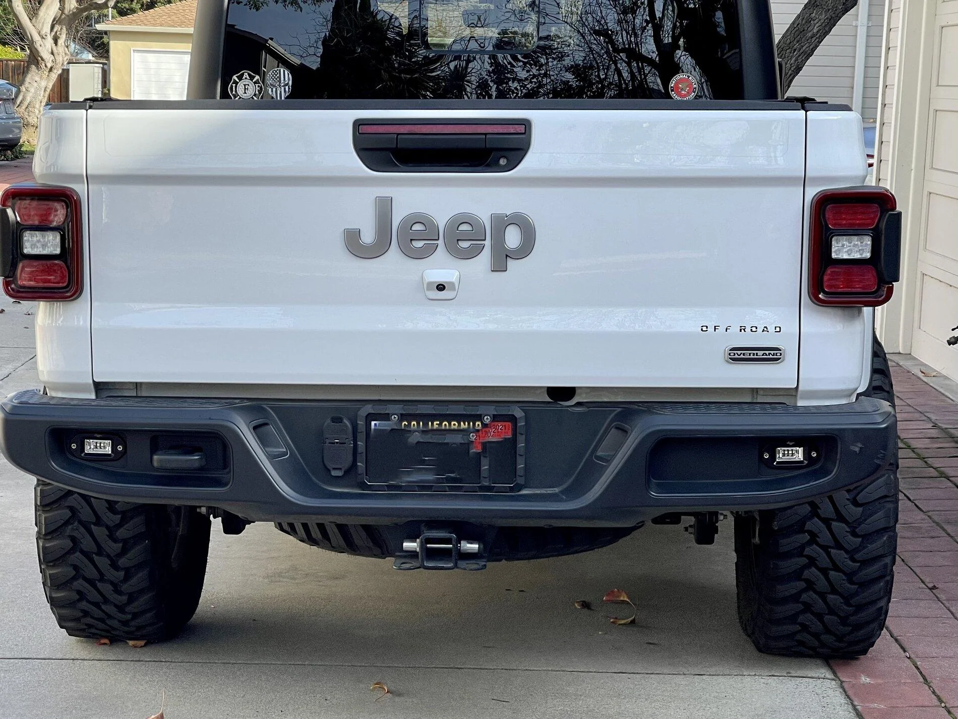

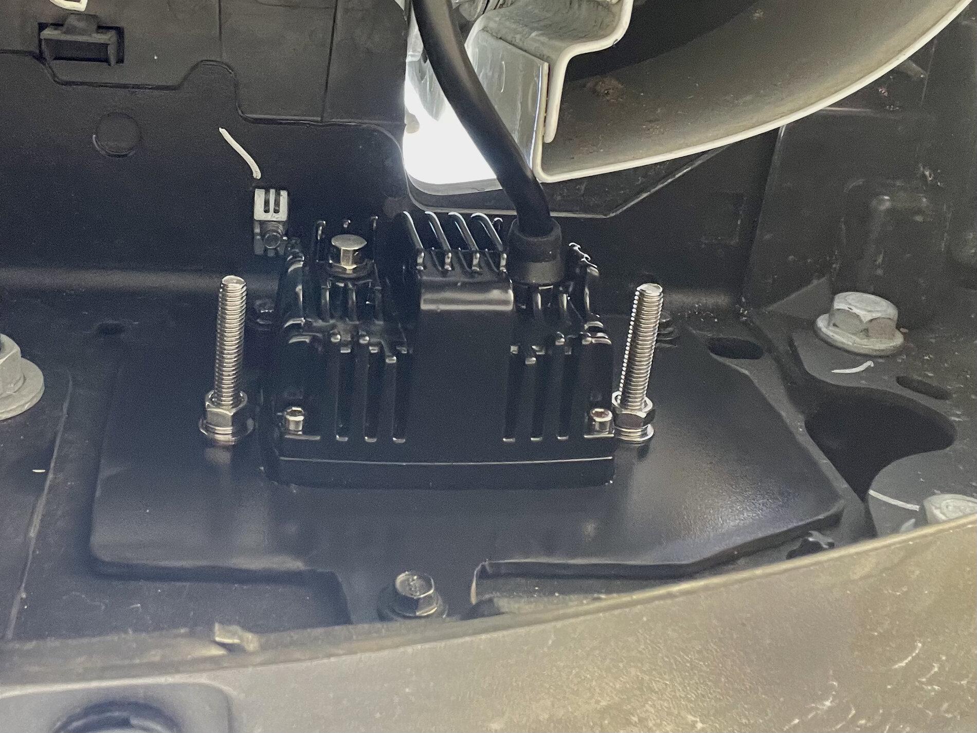

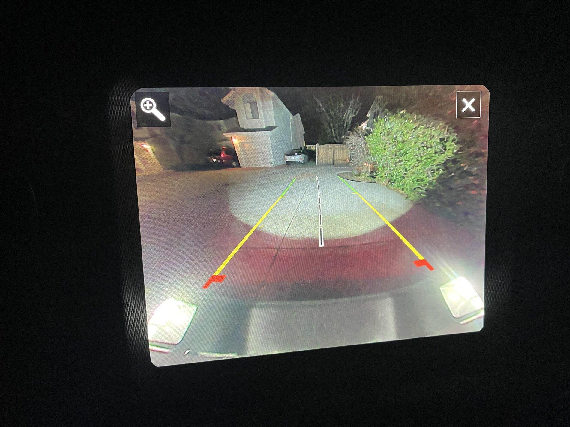

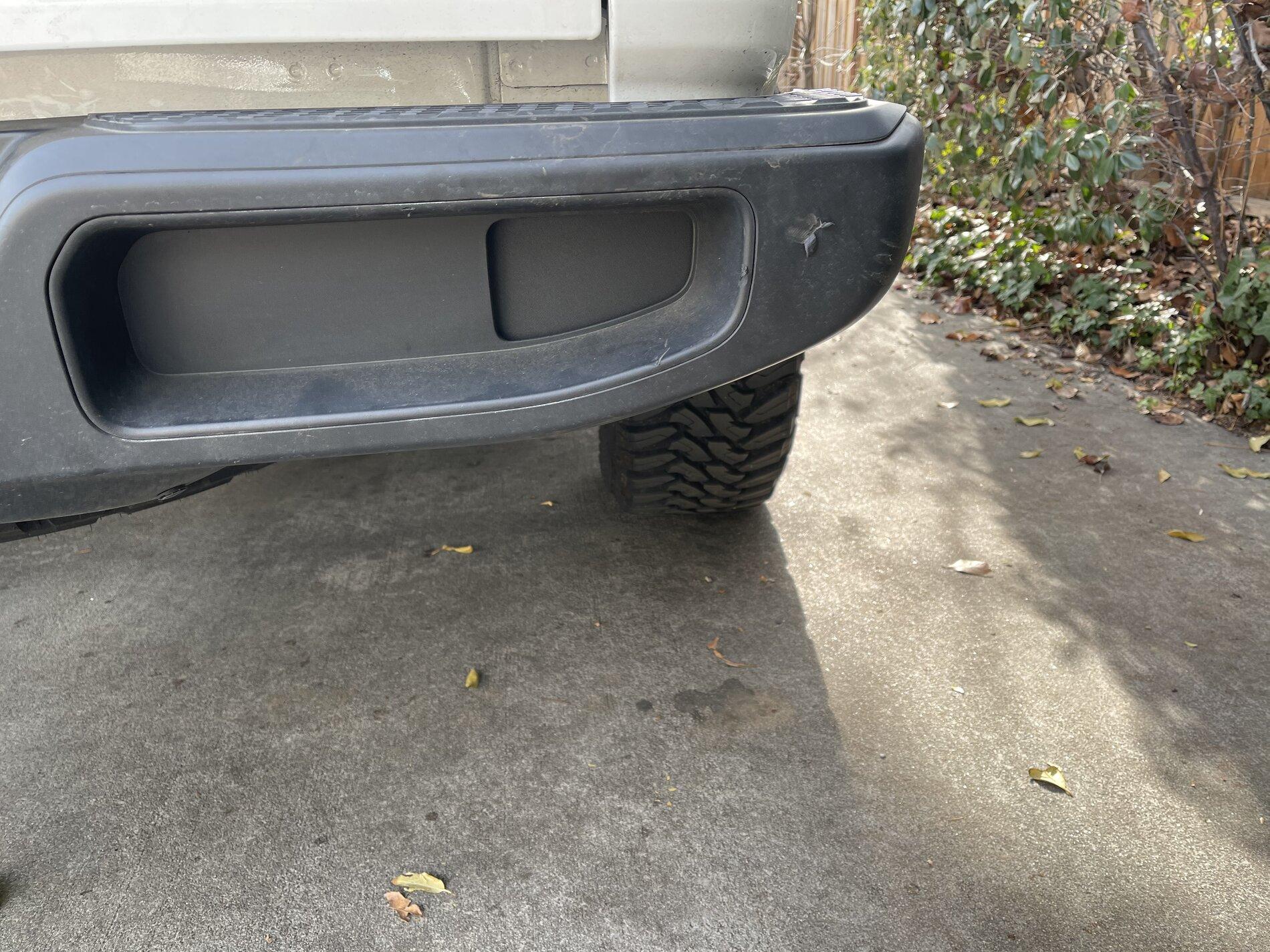

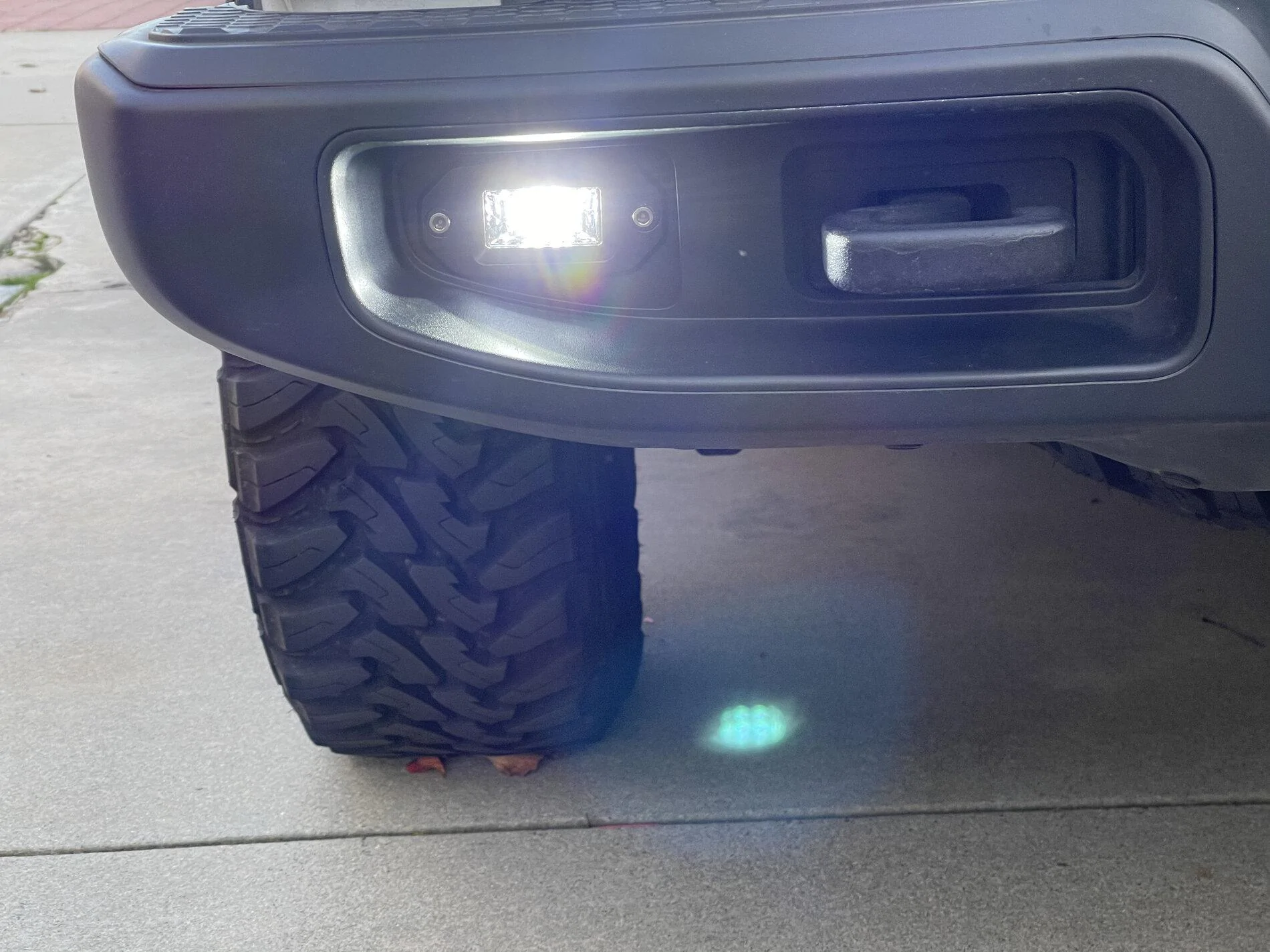

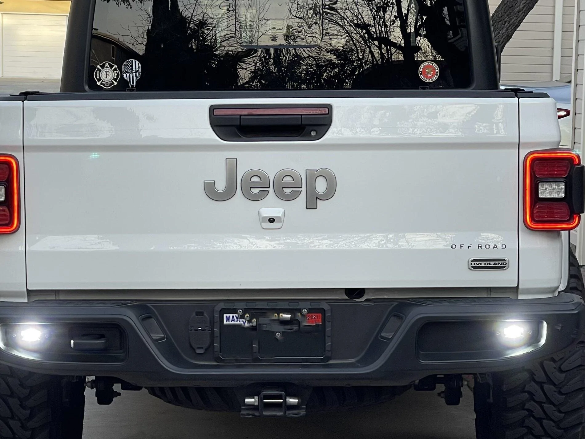

Here is the final results. I decided to go with mictuning lights. Delivery was overnight so I installed this am and took pictures.... this post is the install, the next one will by night pictures
Jeep Gladiator Question for Non-US Owners- Rear bumper reflectors 4125E79B-2794-4617-8CB8-74D82FB1BF2A

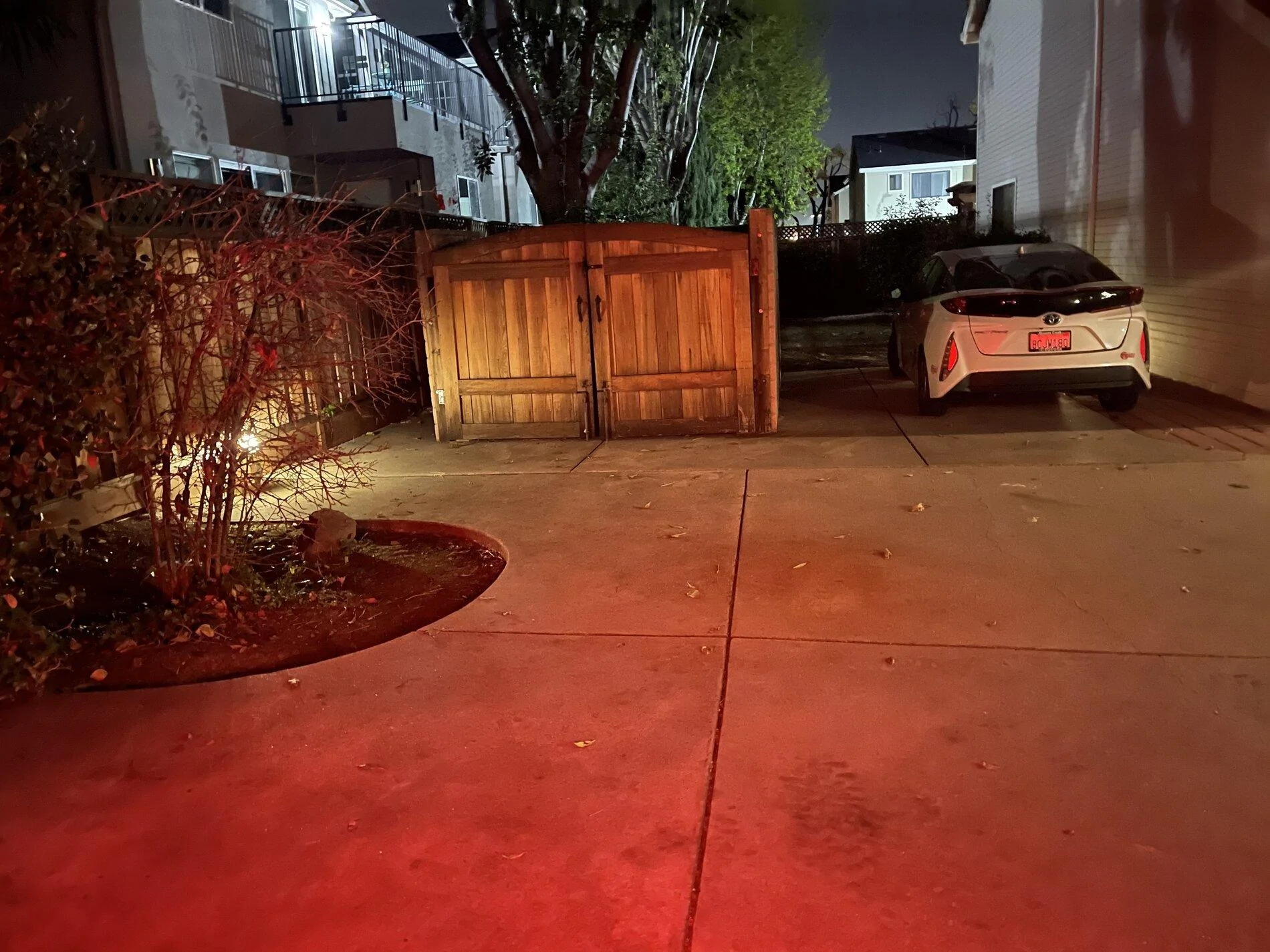

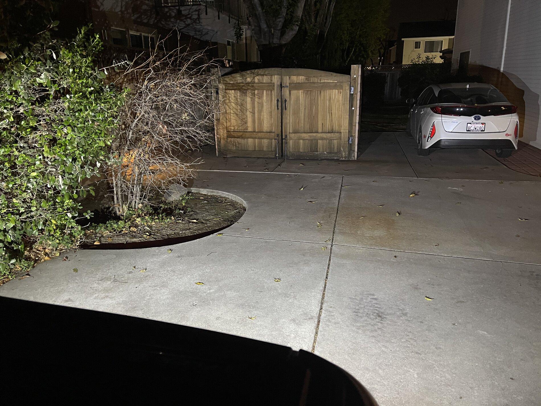

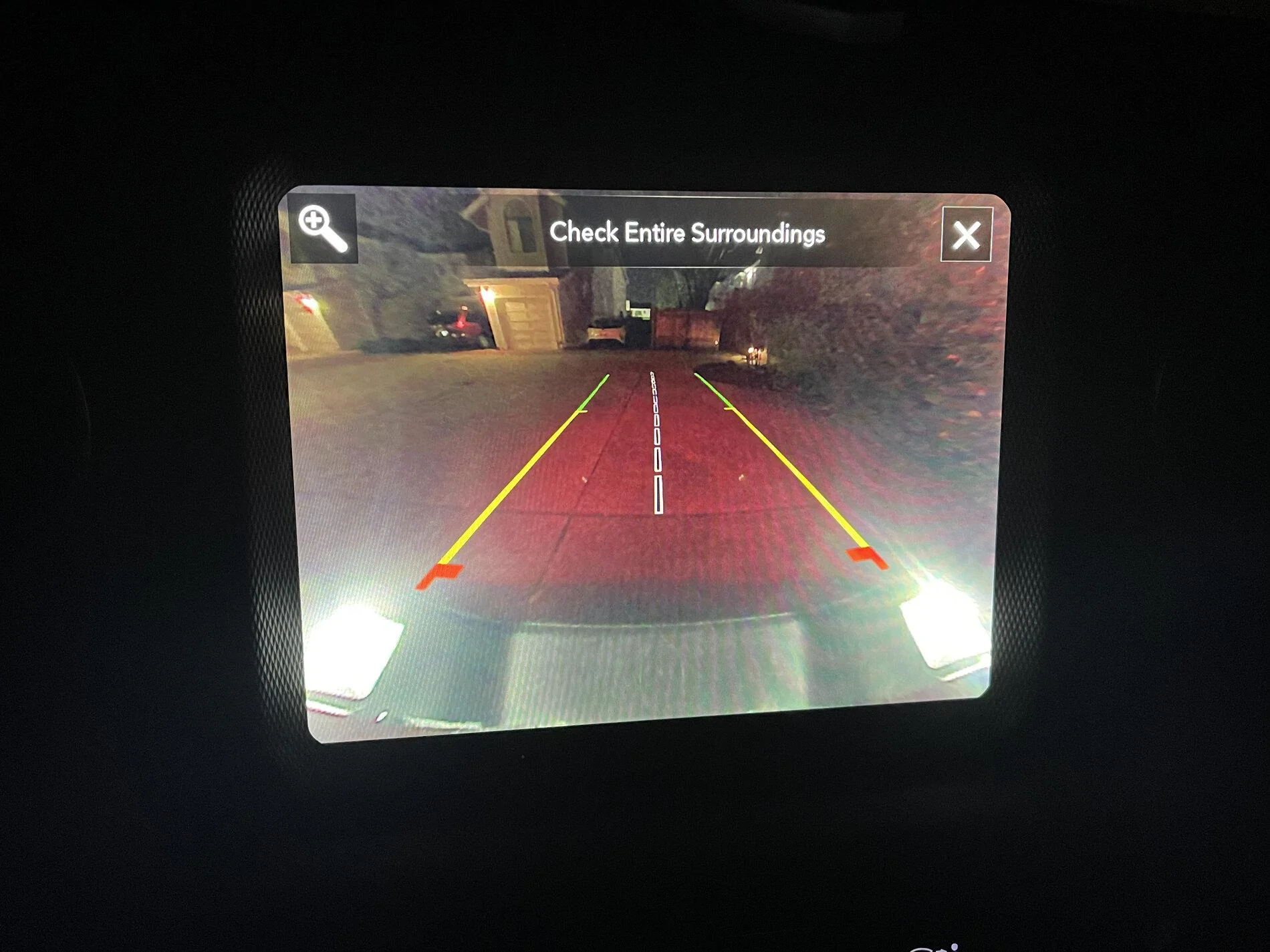

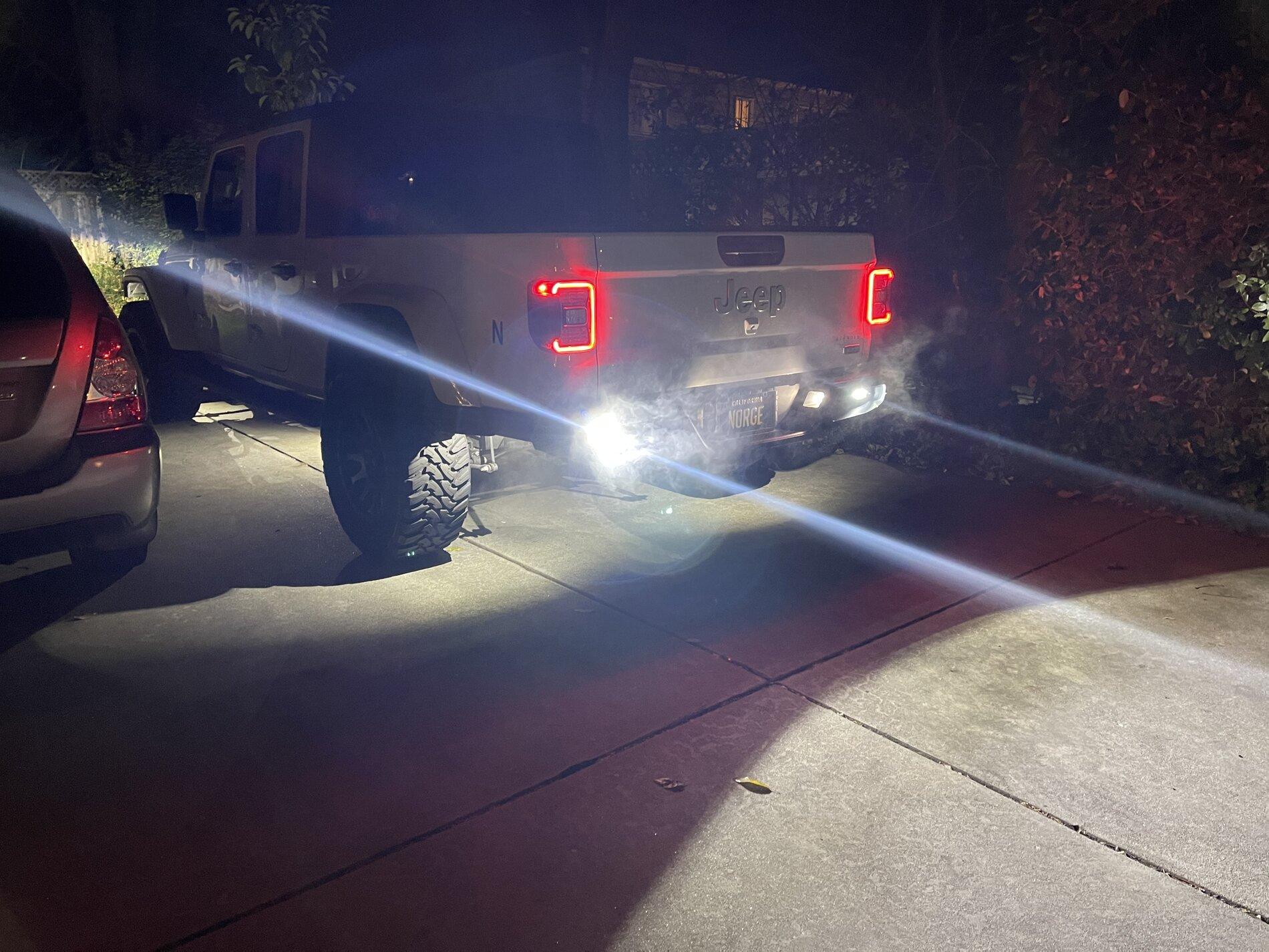

This is night pictures. Exterior and through the back up cam. Note I did not put in reverse for the backup cam... no reverse lights (stock) were used or harmed during production.
Jeep Gladiator Question for Non-US Owners- Rear bumper reflectors BB11B704-02D5-4A2C-AFFF-C8E3EE47694E
