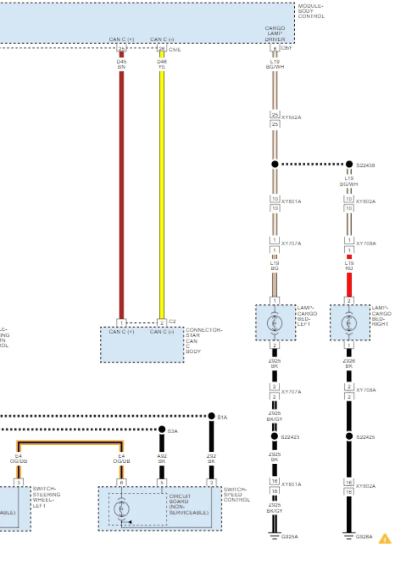

I've found a couple of topics related to this on the forum but don't think I ever found the answers I'm looking for (although my apologies if my search-fu is failing me).
There are some lights on the roll bar I will be installing (not huge lights, just two smaller square LED lights facing backwards into the bed). I was originally thinking about adding the aux switch module and using an aux switch to be able to turn them on and off manually, but I think I'd really like the ability to have them come on when the bed lights come on. And since I also have that bed lights switch button already in the jeep, that would let me turn on and off all of the bed lights together with that switch.
Looking through the forums, it sounds like those bed lights aren't on a separate circuit and use the same fuse as the interior lights (30A maybe?). So I guess my first question to the community is, is that right? I'm not sure how much headroom I have on that 30A fuse because I'm not sure how much all the interior lights normally draw.
But, if that is true, I suppose I have two options - I can either tie the lights directly into the lines that power the bed lights and see if it all works. Another option might be to just tie the signal from the bed lights to power a relay so I can draw power from some other 12V constant source.
So my second question is, if I go with option 2, is there some constant 12V power in the bed wiring that I could tap into? For example, I think I have the trailer hitch wiring on the bumper so presumably there is a constant 12V power line in there? I'm not sure what wires I should use or what the gotchas on that might be so I figured I would ask folks here before I start experimenting. Maybe there is other constant 12V power that is closer to the bed lights?
Thanks for any help, wiring diagrams, personal experience, suggestions, etc.!
