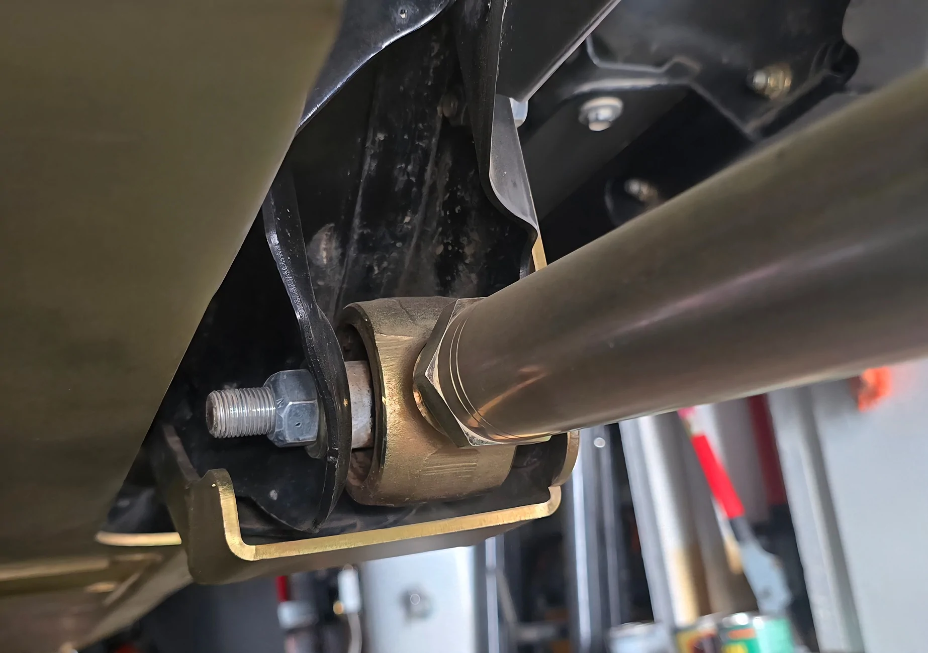

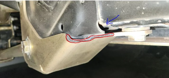

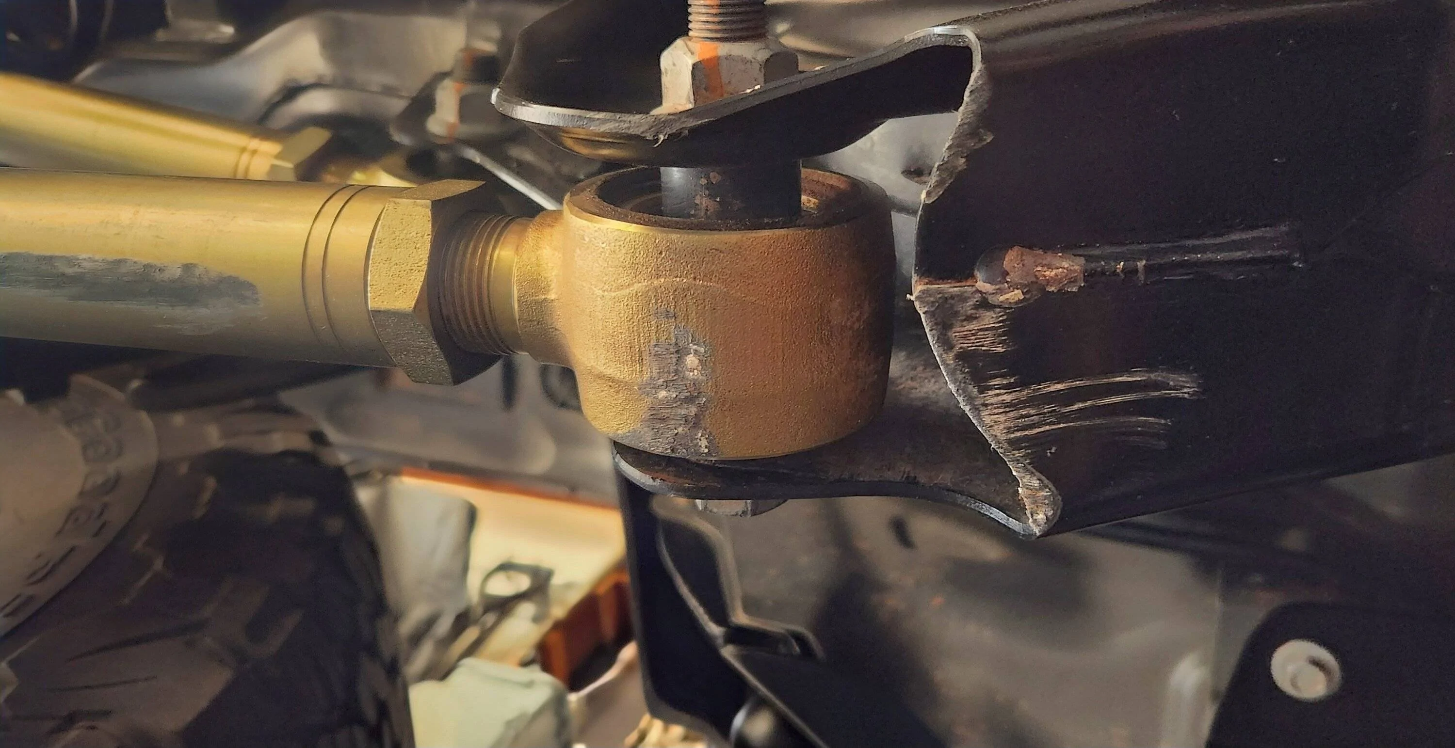

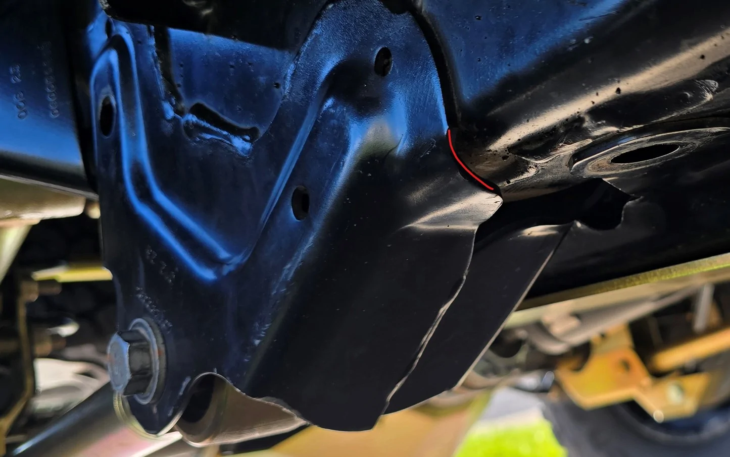

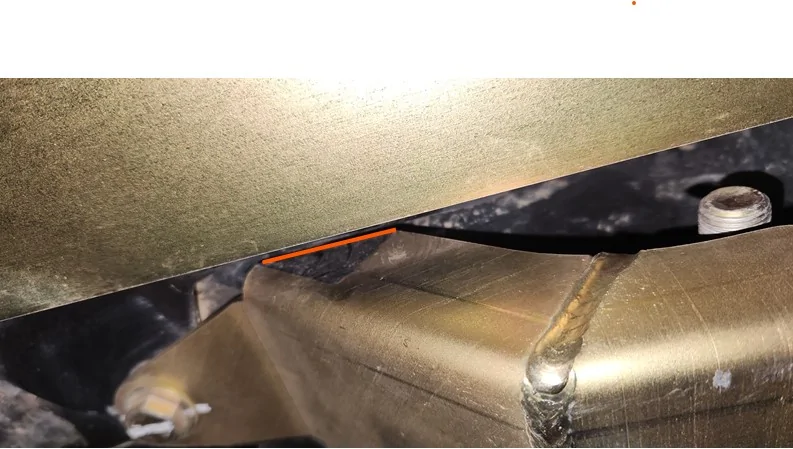

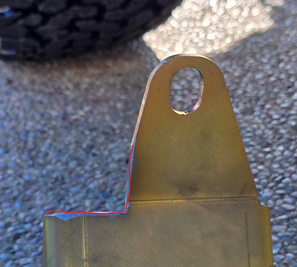

Ok, I was able to recover the deleted photos. The first two photos show the bracket challenge. The thrid should part of the modification. I had to do an additional mode on the other side as well, marked in red.
Thanks for the additional photos! My frame has the same gap as seen in your first two pics, both sides of the truck. The last pic shows the mod I was expecting to see based on the review I read, and looking under my truck.

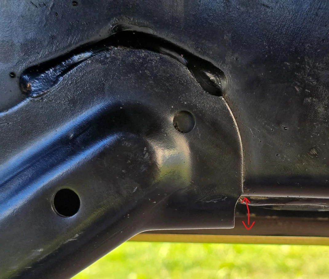

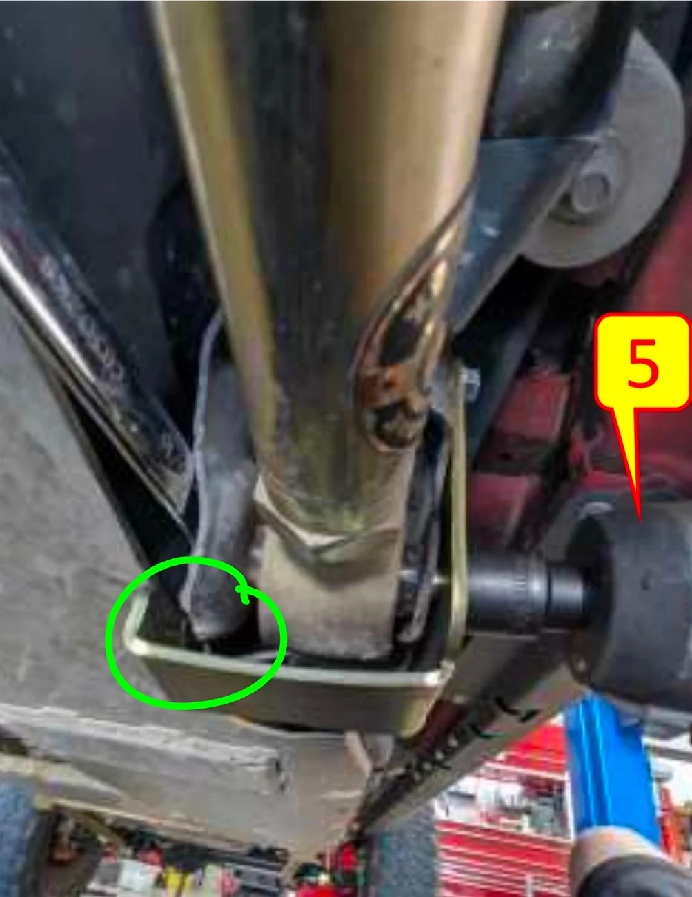

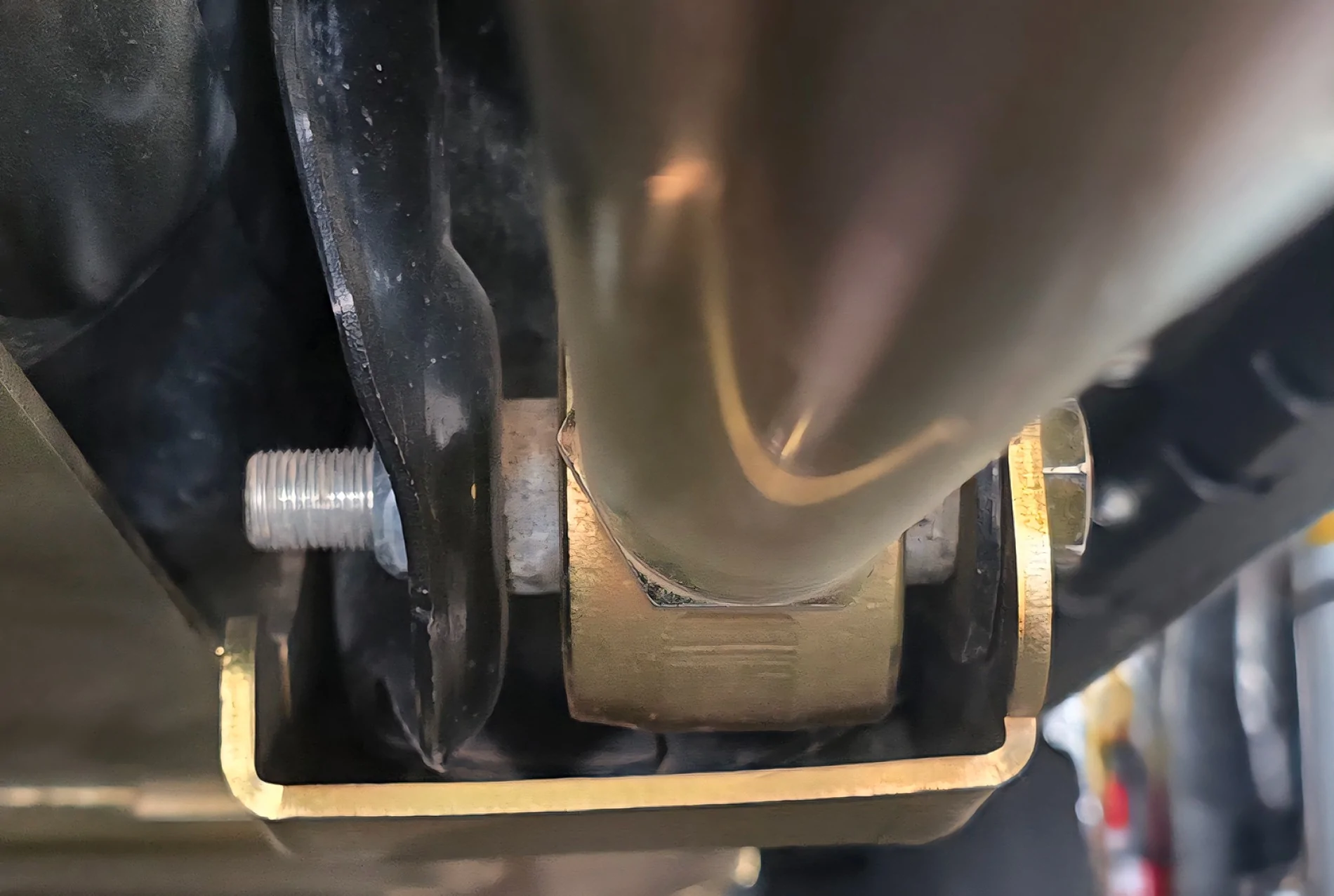

Can you please comment on my question from post #10? I'd like to know if the inner side of the MC bracket touches, and is therefore fully supported by, the factory, black lca mount. Or if it floats in a cantilevered fashion. See pic for location of what I'm referring to (an untightened example, so I don't know if it lifts to touch).

Even if the skid touches, it might still be vulnerable to horizontal twisting forces if you slide it on something. I haven't installed a skid at this location for this reason. About the only solution that comes to mind would be a spacer and a longer bolt to hold onto the skid at both sides.

Here are two photos for the other part of your question.
Thank you very much, greatly appreciated!
That confirms my suspicion, it's cantilevered. I can't say that's definitively a problem, but I am an overthinker and wonder how it would treat that bolt if a heavy force pushed on that cantilever. It wouldn't just be simple upward pressure. Takes a rare precise event I suppose.
I haven't heard any reports of it being a problem though, and I suspect most are like that.
Yeah, maybe. Takes a precise event like I mentioned above, but even more specific.
