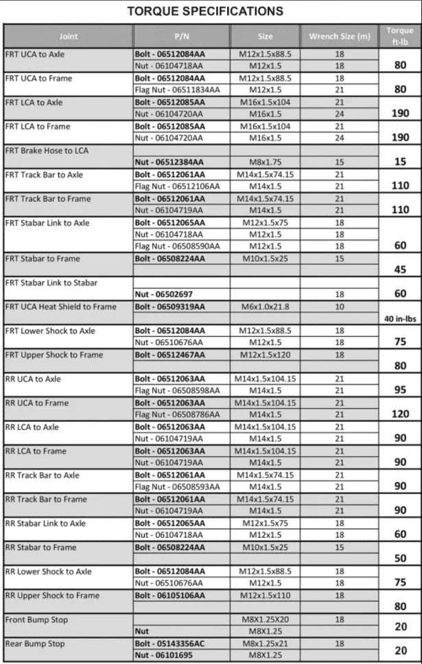

This is a helpful resource I've seen posted here before

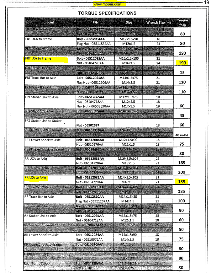

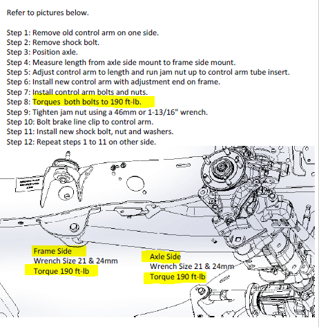

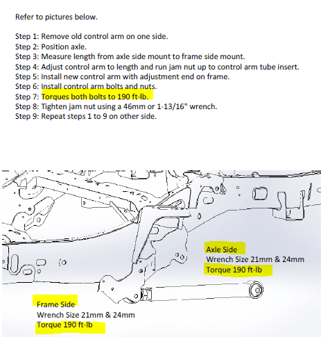

@JTBurns this torque spec chart doesn't feel like it's for a Gladiator. Those RR LCA specs are really low. According to both Clayton and the OEM Mopar lifts instructions the LCA's are 185-190 ft/lbs for the JT. Attached are the screen shots from Clayton's lift kit and Mopar's. I personally use these as they coincide with one another... the mopar.com one is just hard to read. Clayton's instructions are very clear and concise.
@Oneshotlucky I'd recommend going to Clayton's website and pulling down their instructions.
Clayton's online instructions
front:
Jeep Gladiator Rock Hard LCA Skids 1639337328534
rear:
Jeep Gladiator Rock Hard LCA Skids 1639337252720
mopar.com
Jeep Gladiator Rock Hard LCA Skids 1639337396179
front:
rear:
mopar.com
Nice, thanks for clearing up my misinformation. I torqued my Rusty's LCA skids to 190 and then thought I did it way too tight after I saw my previously posted chart, so this makes me feel better too! Saving that image
