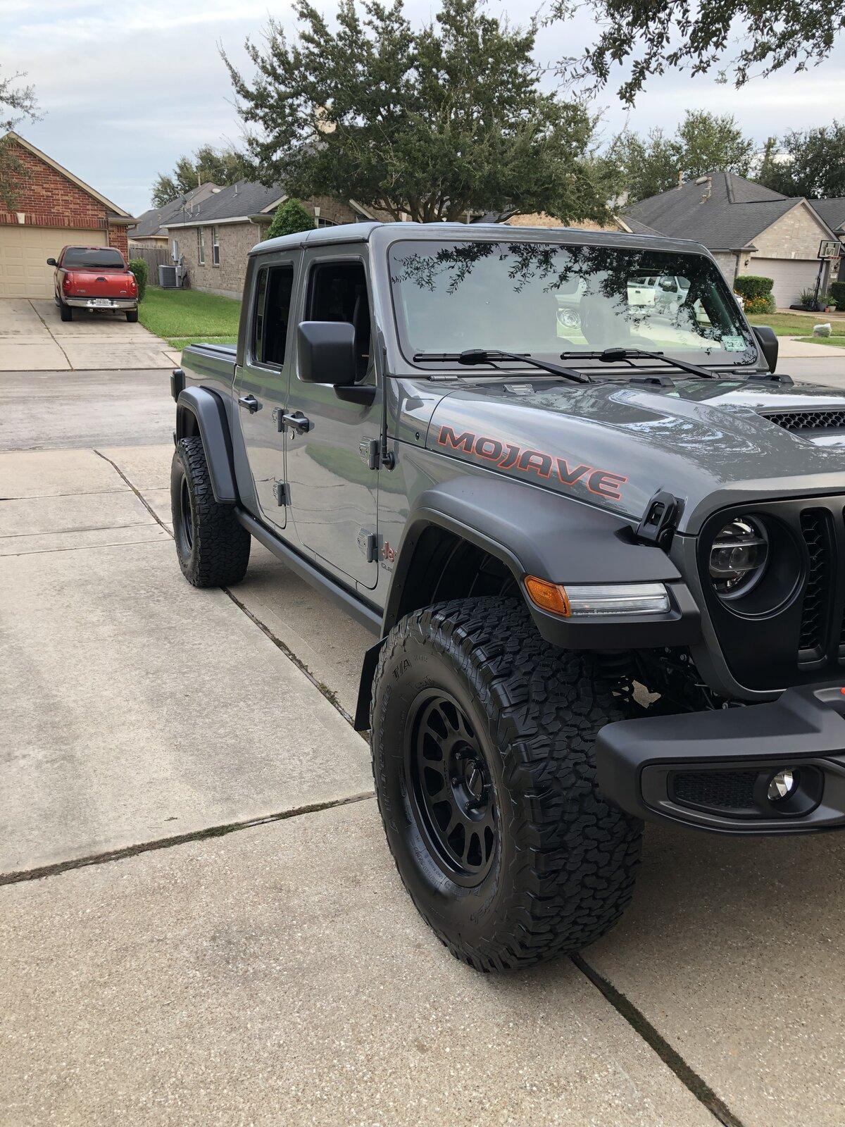

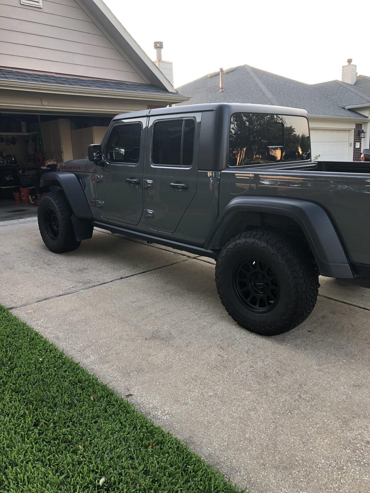

35’s in stock height Mojave and haven’t torn anything up yet. Have not disconnected the sway bar but with it attached no run at full stuff.
Looks awesome! I don't understand what you mean about disconnecting your sway bar. Are you planning on installing a disconnect for this?
Thought about installing manual quick disconnects, but if I do it will be later. It does fine the way it is for now.

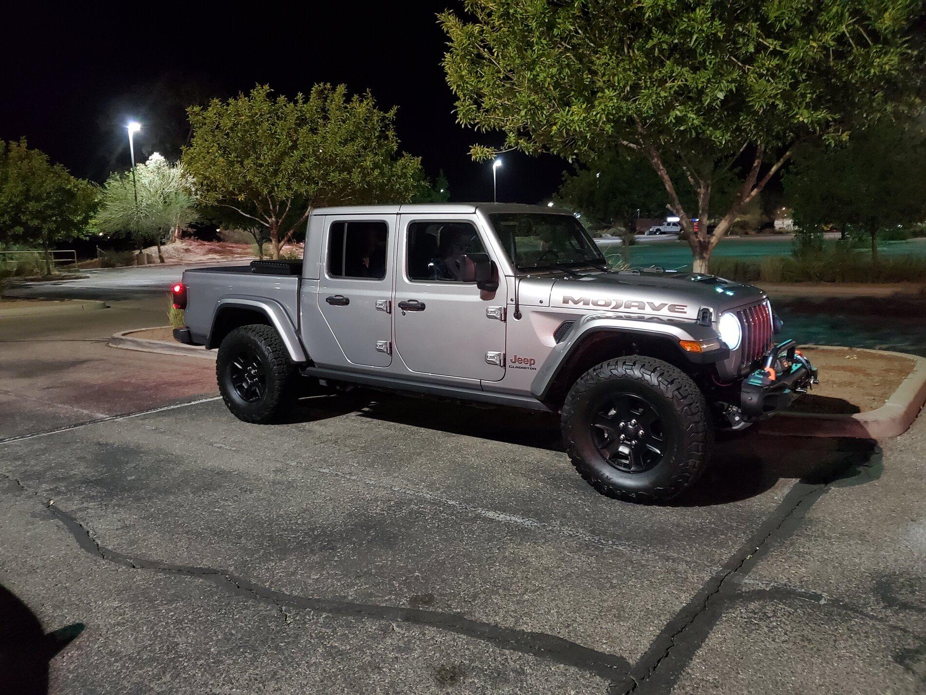

Stock height Mojave with 35's on stock rims, love it. I won't do a lift, thinking about quick disconnects though.

Thank you, no, its the knock-off Ebay Metal Bumper. I do like the looks of the Arcus though. To the OP, I have not taken the Gladiator on any real tough off-roading that required heavy articulation yet, but just light off-roading and daily driving it has not rubbed at all.
Thanks for the info. It looks great. I'm trying to prepare as much as possible, so when the factory Falkens need replacing, I am prepared with what I'll need to be doing.
