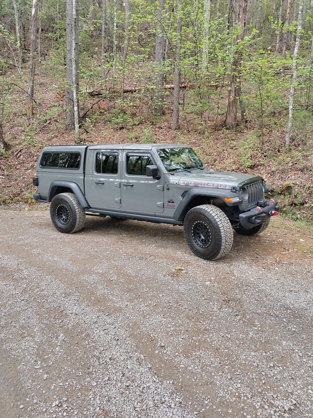

I already had that!
Jeep Gladiator Questions and opinions on minor lift and tire size IMG_20240420_155651

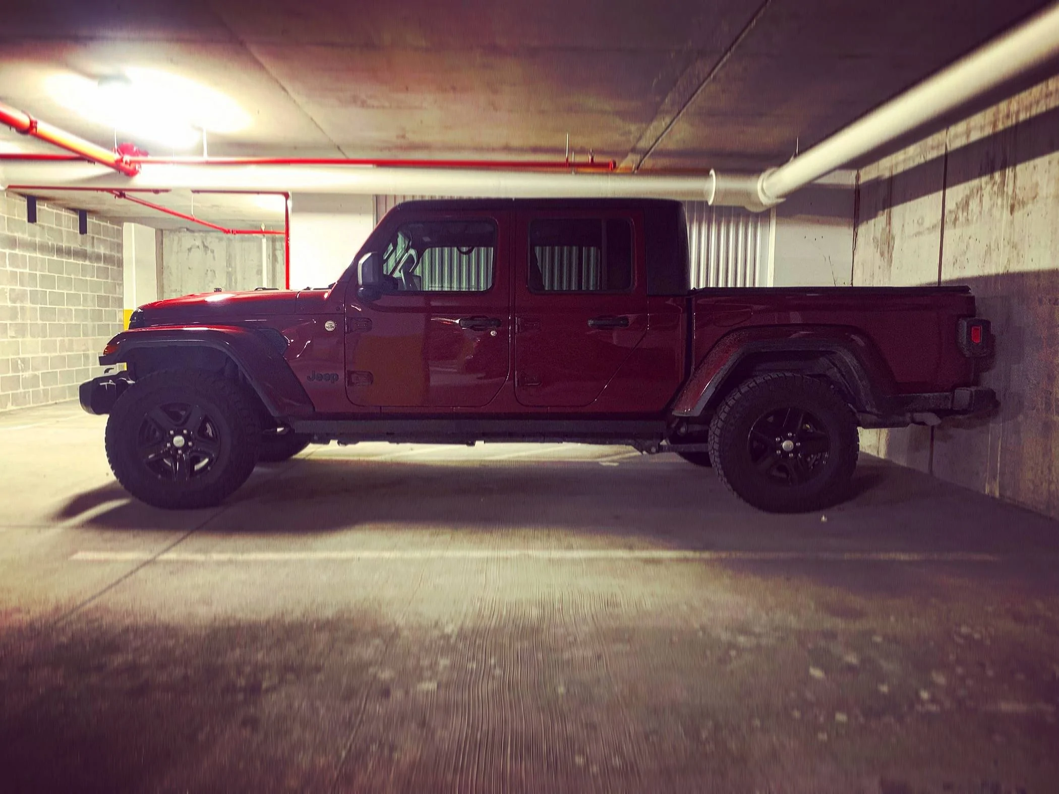

My max tow with my old 33s and 1.5” front teraflex spacer. It was a perfect setup with 33s imo. I ended up with 35s and a bigger lift though
Jeep Gladiator Questions and opinions on minor lift and tire size 02DAA73B-2EC1-4939-BDD5-774E46B4D6F2

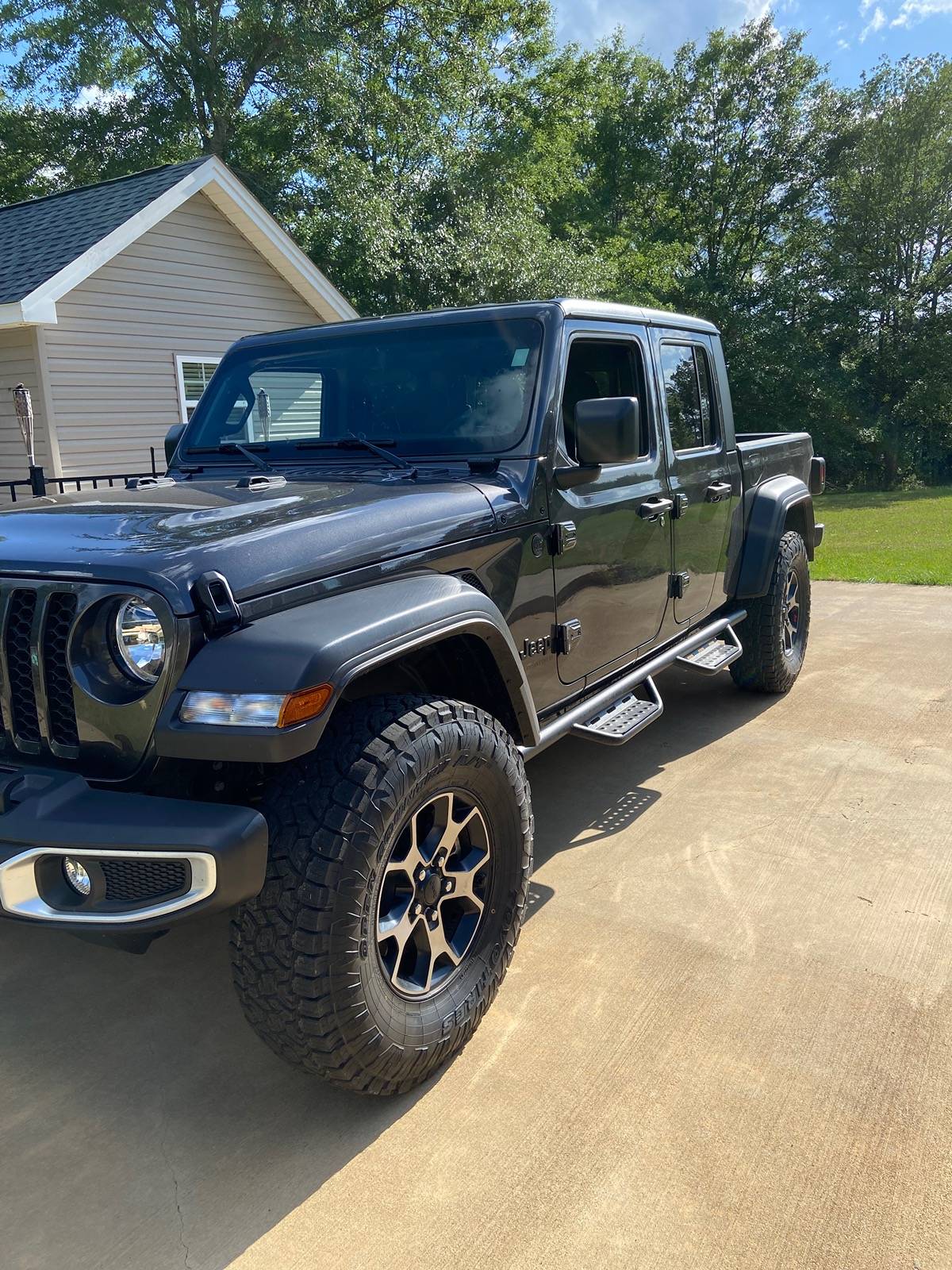

You can go look at my build thread, there are pics of mine in there on 285/75r17 and freedom wheels (same wheels different finish).
35x11.5x17 is also an option to toss into you list. Depends what you're after in the end.

Thanks for the picture. I have lifted many vehicles and have ran tires up to 42.5. I always went in stages. I always started with 33's and to be honest other than looks I always felt like I should have stayed with the 33's for 97 % of my driving. How much of an impact on performance and economy for you? Thanks

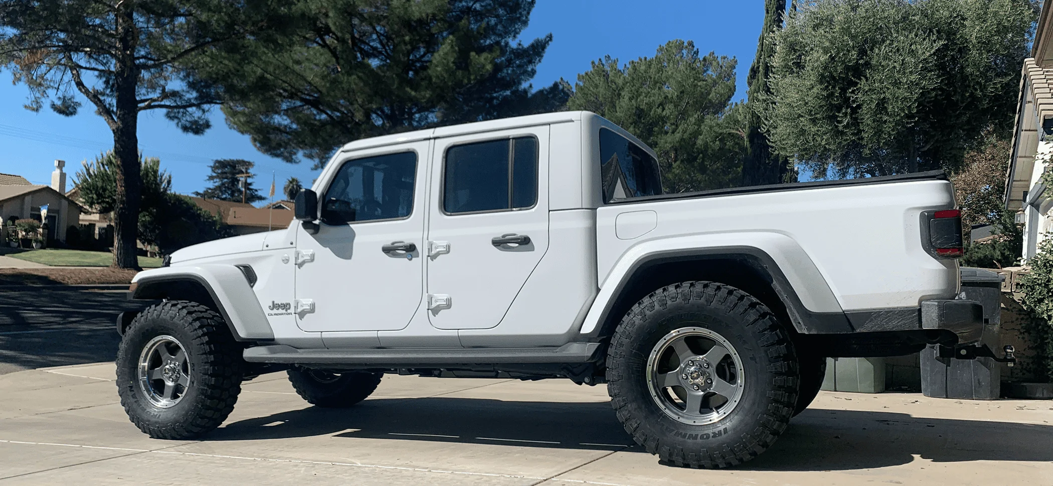

2” spacers in the front, nothing in the rear on 37s. Standard, non high line fenders
Jeep Gladiator Questions and opinions on minor lift and tire size IMG_2733
I'm not a fan of economy LOL I kid I kid.
From the 245's that were factory max tow I was getting 21-22ish hwy. That dropped to 17-18ish with the 285/75's. That dropped to 15-16 w the supercharger.
I thought at first to just do small and leave it so just did 1.5" front and 3/4" rear w the 285/75's (34"). I ran that for three years. After 2 trips to Moab I'm now of the mid set I should have just gone with a lift from the out set. I've done most of the easy trails in Moab and to do more with out a) being that guy slowing the group down or b) scraping every thing every where. I need a better foundation. I'm not going to do a 6" lift with 40's. So 2.5" (really 3"), locker up front, and 35's when these 285's need replacing.
I'm not one that thinks 37's look good on a stock or spacered JT, I think they look weird. I know I'm the odd guy out on that around here. :lipssealed:
