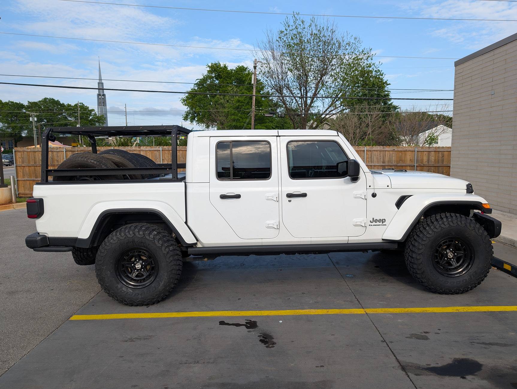

I'm running BFG 37's on a Mopar lift. It works with some rubbing on the fenders at full flex, which I don't mind. With that said, I would go with the 3.5" lift.
