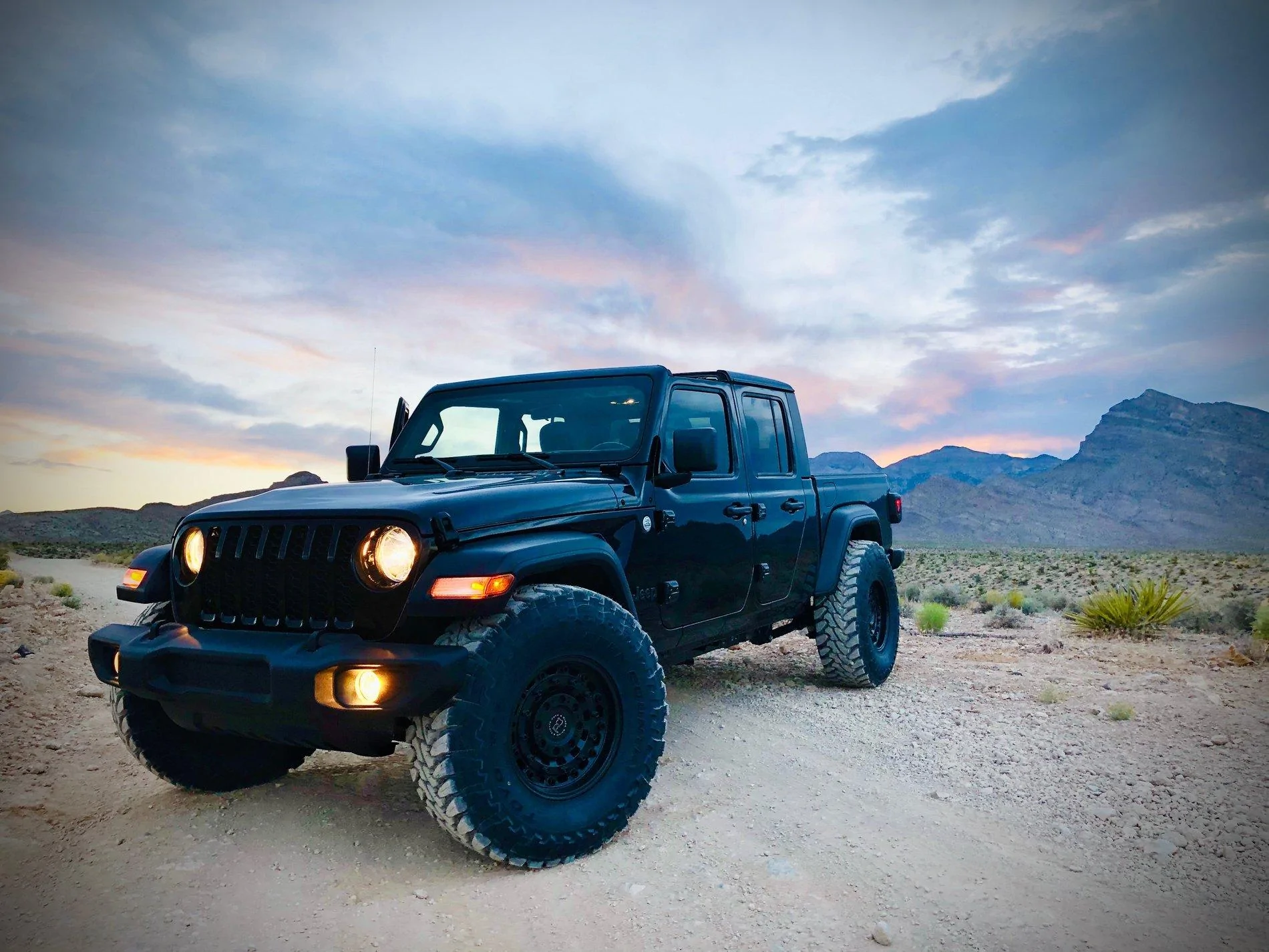

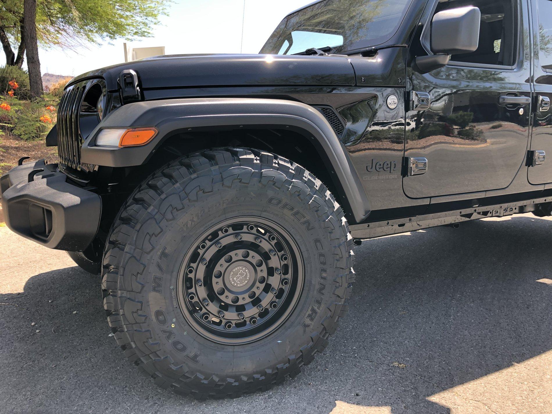

For the Sport S owners out there...I just picked up my JT on Monday and added 37x12.5/R17 Toyo Open Country M/Ts on Black Rhino Arsenal wheels NO LIFT.
I just removed the plastic that connects the bumper to the fenders with a utility knife in 5 minutes.

I like, and appreciate, the "stuffed" look, because I try to practice that myself on all of my builds (most tire, least lift, but still maintaining good flex and clearance). But damn! Hit 1 good speedbump too fast, and you're buying new fenders... I'd at least toss a 1" to 1.5" spacer front & rear...
Yea, a lift of some kind is needed long term. There is definitely rubbing on the passenger fender if you aren’t careful. 2.5ā€-3.5ā€ Rubicon Express Lift with a Fox Shocks is getting installed next week with a Fab Four Stubby Front Bumper. I just couldn’t take the stock look any longer!
