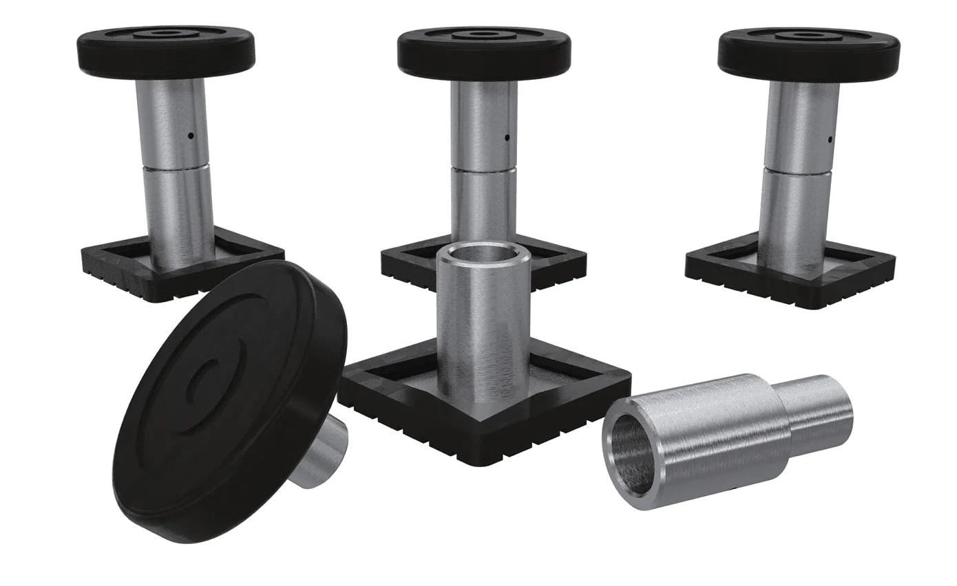

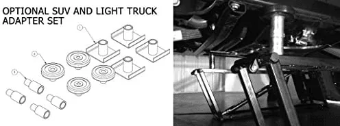

I have one and it works great on the Gladiator with the truck height adaptors.
A lot of people are giving their opinions here without ever having used a QuickJack. I haven't heard anything negative about them from actual owners.
THANKS. This is what I thought, Having used them many times on cars I figure SOMEONE here would have one of the 7k's for the trucks. You will soon have company (ordering).

You could probably get away with using the 5k on a lightly modded JT. I've seen videos where they test it with a sheetload more weight than they rate it for.

I used this exact lift to change my suspension. You will need those block adapters, posted earlier, as the quick lift by itself is intended for unibody frames. With that said, the placement of those block adapters at the rear of frame are hard to place, and very sketchy at times….
