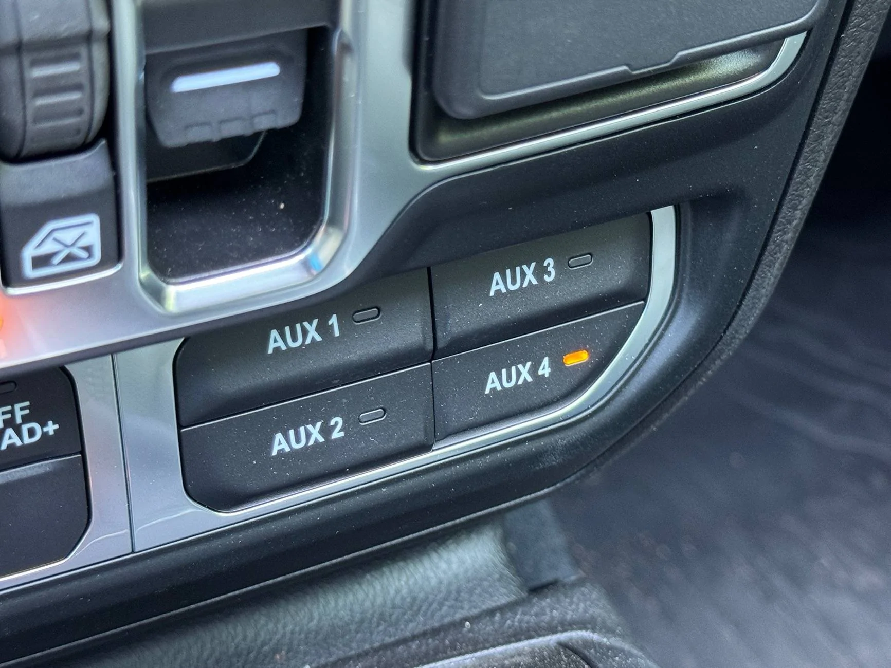

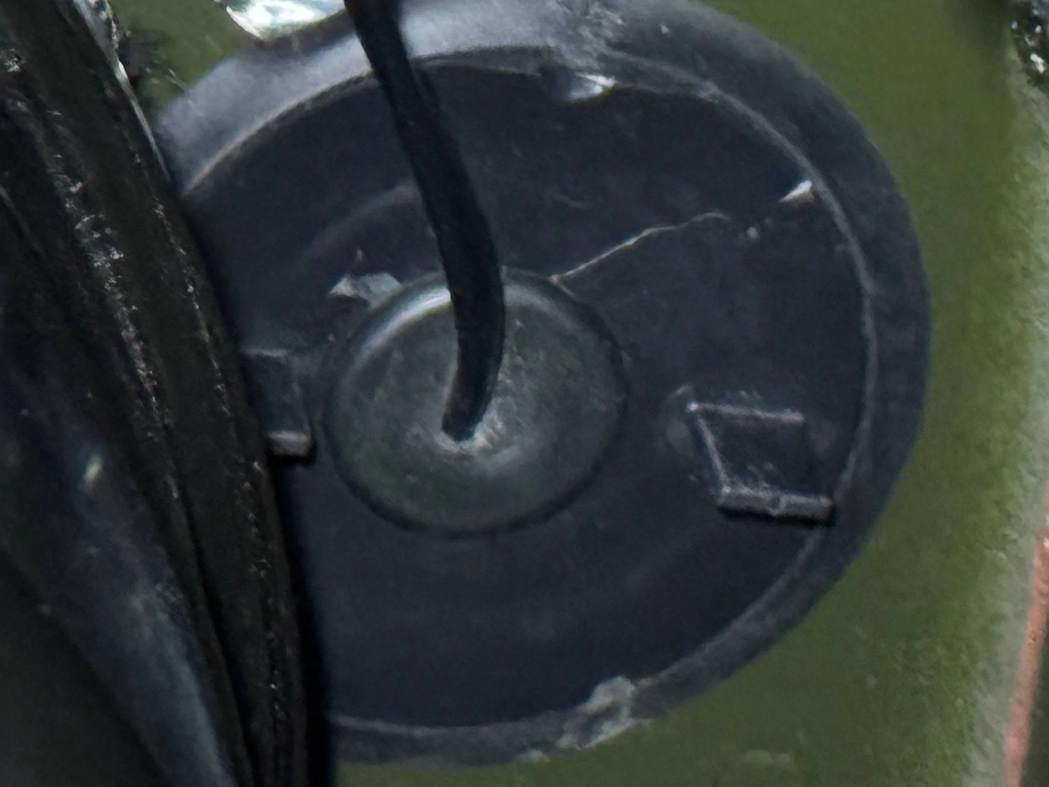

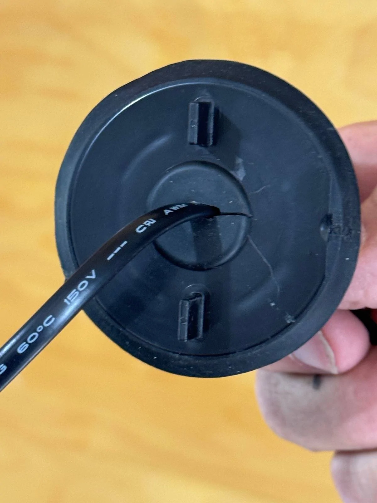

Would it be feasible to hardwire it to one of the aux switch wires in the passenger floor board? Would that work?

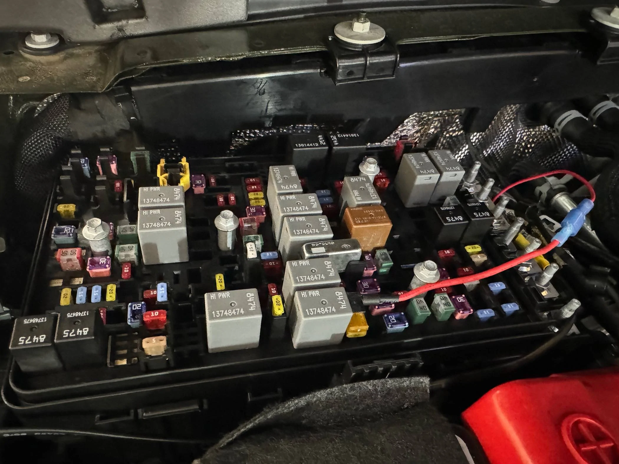

Neat idea! I'm new to this, but I do know that there is a bundle under the hood of 4 positive wires for these switches. Looks like it's next to the fuse box, so I think I will move my wire from the fuse tap to an aux. Not sure if you can just get a positive from the switch in the cab, but, in my case, I ran the wire already so I will just stick with connecting under the hood.

You should have the same bundle of wires in the passenger floor well. I was just trying to avoid punching through the firewall

Fyi - with a factory installed aux switch system, there are 6 wires in the passenger footwell: aux1-4 plus batt and ignition (these are in addition to the 4 next to the battery)

Man, I really need to check here before searching Youtube! The videos I found were under the hood connections to the Aux. Seems I took the long way around! 👍

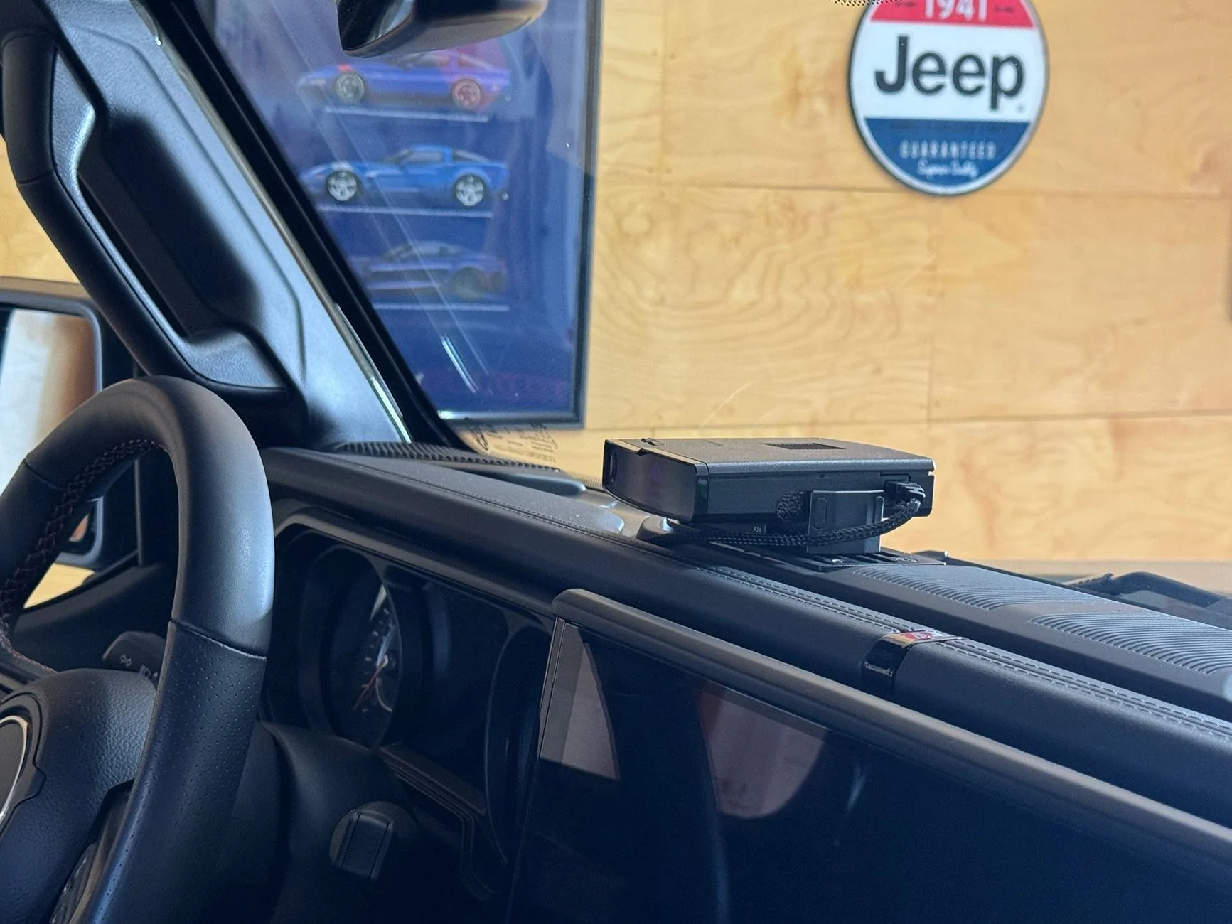

Aux-4 thanks you all. Just changed from Fuse-tap to Aux 4. Clean and no wires show!
Jeep Gladiator Radar detector hard wire project IMG_8229

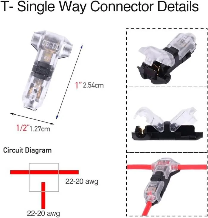

1) Power Source and Means --- If you have a newer option-heavy Jeep or other vehicle, you likely have connectors/wire looms in the center upper windshield mirror module/ceiling area, that a 20-24AWG micro t-tap can be use to pull a 12vDC low amp +/- power source from.
Be SURE to test the tap/wires for voltage/continuity with a volt meter BEFORE commencing full reassembly, connection projects are not 100% assured. We use a pink striped 12vDC+ wire and black negative 12vDC- (rear view mirror wiring loom) to power the detector in a '24 JTRX. Options vary for other years and models. A needle-nose plyer will help closing the tap clamps effectively, especially in cramped assess areas. If you have the four Aux Power Switch Cluster option, you can alternately run power wires up from either the glovebox area or engine compartment area (depends upon model, year).
A note --- we've had less/diminishing success in recent years with the "mirror tap" push-in pin-type fused taps, as vehicle connectors sizes and tolerances have gotten smaller/tighter, esp. some w/water resistant connectors used in lower /external areas, in JTs/JLs. The water resistant connectors have internal rubber modules the wires are routed through, and the tap pins slide in easily but then back-out losing their connections.
The T-taps bite into the wire insulation and hold the wire/connection preventing any reversal. We still used the pin-tap product harness, but had to snip off the push-in pins to allow use of the wire ends (no need to strip) w/the micro T-tap.

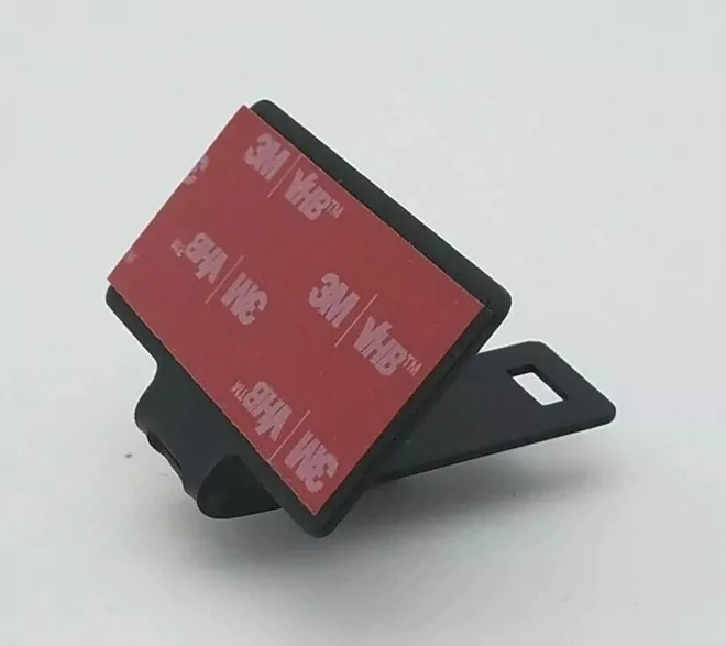

2) Radar Mount --- Small "permanent" metal radar mount w/3M VHB (Very High Bond) tape can be very flexible WRT placement and avoiding visual blockage, when GPSs, dash cams, and detectors, (and ...whatever else) all competing for windshield/ dashboard real estate. Our JTRX has a VHB mounted detector bracket directly to the windshield glass directly below the rearview mirror console housing. Note - If you frequently experience broken windshields (many jeepers do) a "permanent" VHB mount would have to be removed, and new VHB tape re-applied. to re-mount the bracket/detector.
Note: most permanent metal VHB mounted brackets are mgf and model specific so BE SURE to procure one that is dimensionally/physically compatible with your detector mgf. and model.
  • Additionally, Re. VHB tape if you live in an area with extreme summer heat, as a backup, you may want to consider/opt for one of the clamping hardware type mounts compatible with your mirror system and your detector, some mentioned in this thread, and/or in other forum threads.
  • Note that we have had NO issues with a properly mounted VHB radar bracket in moderate/high temperature areas.
  • Be sure to clean the glass mounting areas thoroughly with 90% alcohol, and let the mounted bracket sit a day/overnight w/o device weight on it, to facilitate maximum VHT to glass bonding strength.
  • 3M specifies the ideal application range for most VHBs is 70 to 100 degrees Fahrenheit (21-38 degrees Celsius) and the minimum application temp 50 degrees Fahrenheit (15 oC).
  • These steps are usually mentioned in the VHB product instructions, but may not be included with the specific mount product, and even if so, the instructions are rarely read, or followed, resulting in bond weakness/ failures.

Jeep Gladiator Radar detector hard wire project 20-22 AWG Mini T-Ta

Jeep Gladiator Radar detector hard wire project VHB permanent low-profile metal radar mount

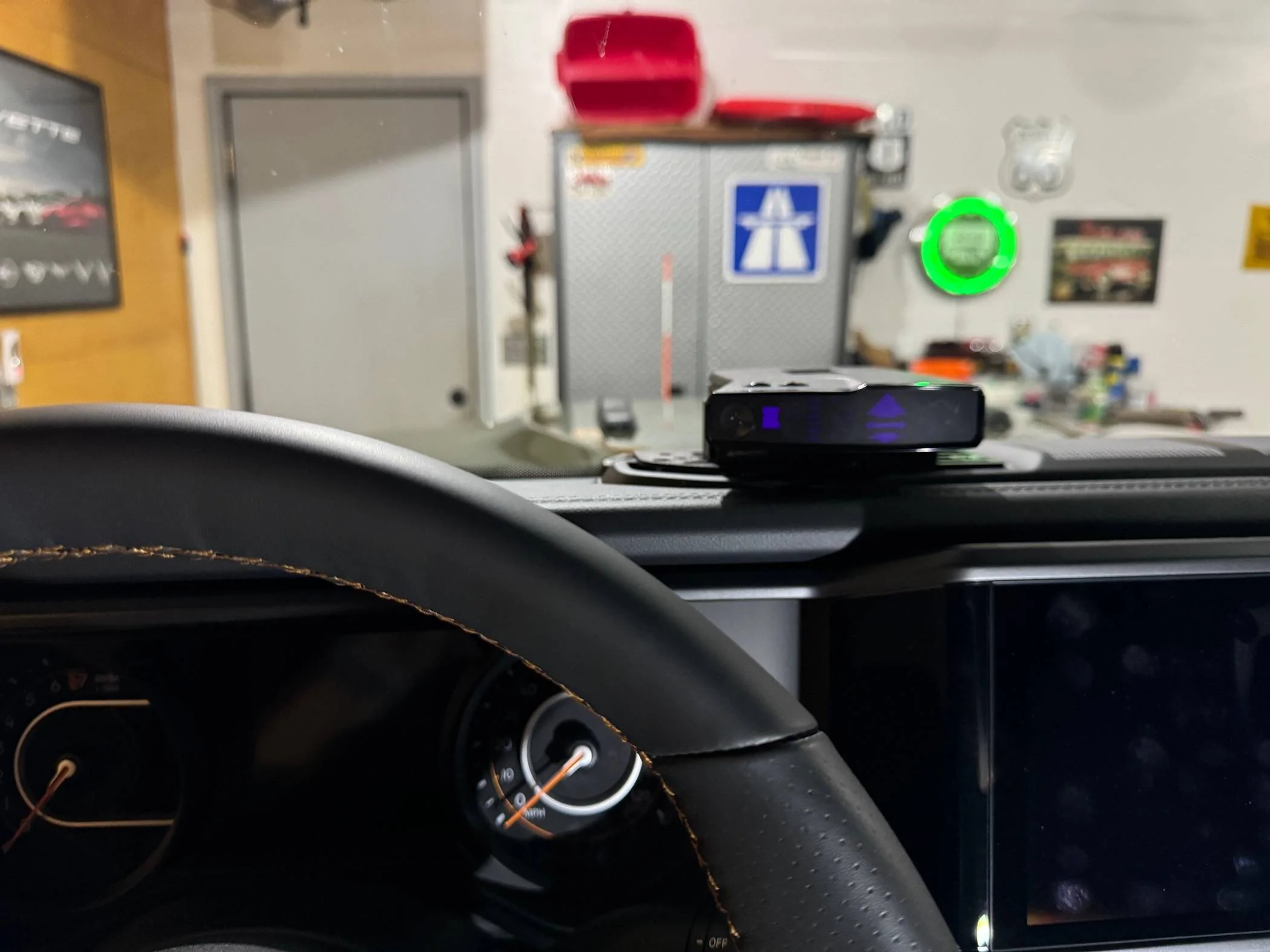

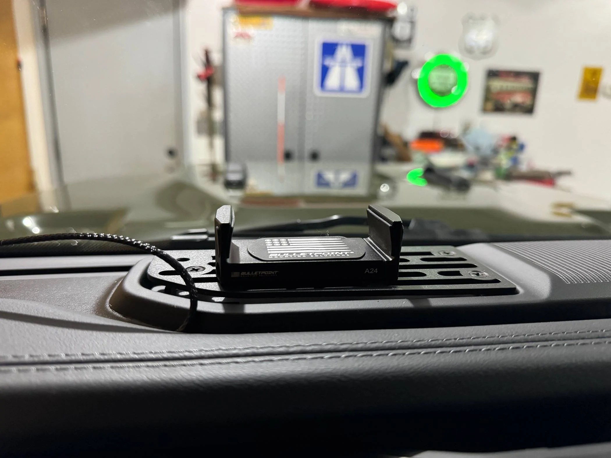

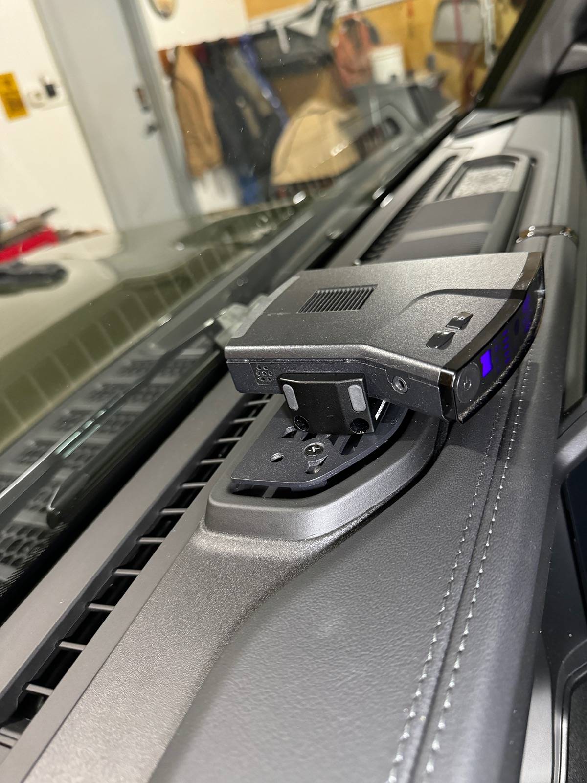

OP here . . . Still a little embarrassed about taking the long way around for wiring, but really happy with the mount and location. Years ago I mounted high near the mirror. I'm tall, so it cut into my vision a little. It's also in a very annoying location to mute. Finally started mounting on the dash. In this case, the detector is about 5 1/2" below where it would be with a mirror location. No loss of visibility at all. Perfect location to mute, but it's in such a good location for visibility that I run at close to zero volume anyway. By the way the 2nd gen Valentine has amazing range.
Not a speeder by nature, especially in the Jeep. I tend to go with the flow (which is by definition about 5-10 over the limit) But I can miss a sign or two as speed goes from 55 to 45 in small town MN . . .
Jeep Gladiator Radar detector hard wire project IMG_8957
