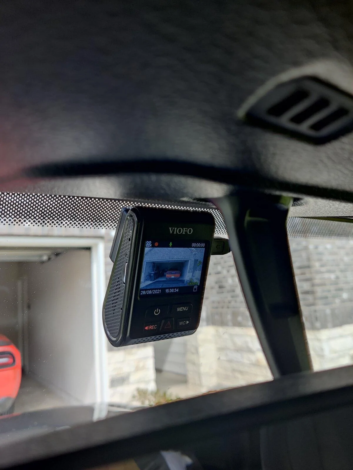

I have a Viofo A119 V3, it's reasonably priced and had some good reviews. Hard wired it to a Aux switch (used their kit), was a simple installation, clean with no exposed wire. My first dash cam so I didn't know what features I would like, this unit is pretty basic. So far so good.

I’m also running a Viofo A119 V3, hardwired to the fuse box. Ran the wire along the top of the windshield, down the passenger A pillar, folded the windshield, and ran the wiring under the cowl to the fuse box.

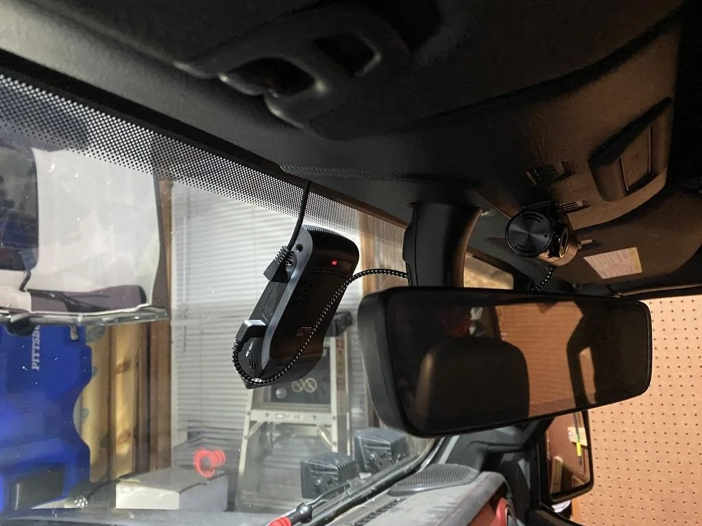

I just installed a Thinkware U1000 with their ODB hardwire kit. Ran the cable from the odb port up the drivers side a pillar and out near the rearview mirror. So far works great!
